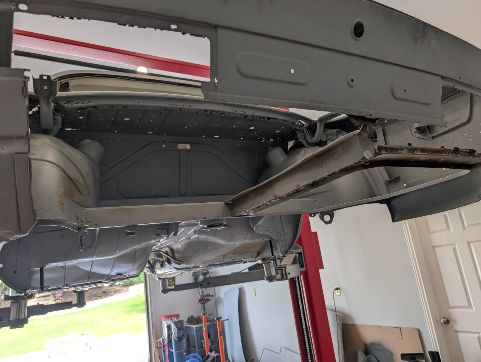

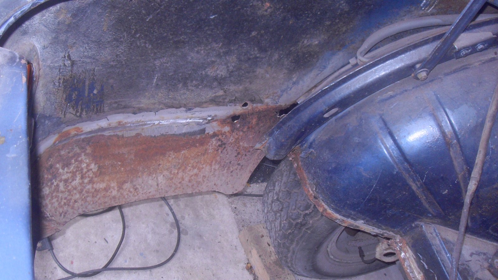

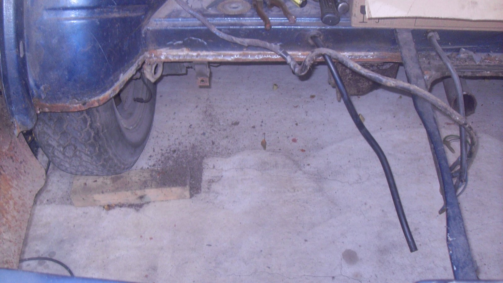

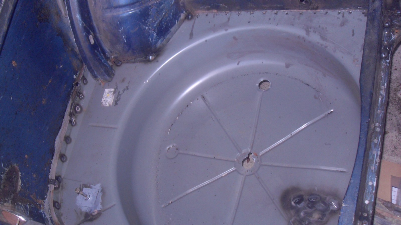

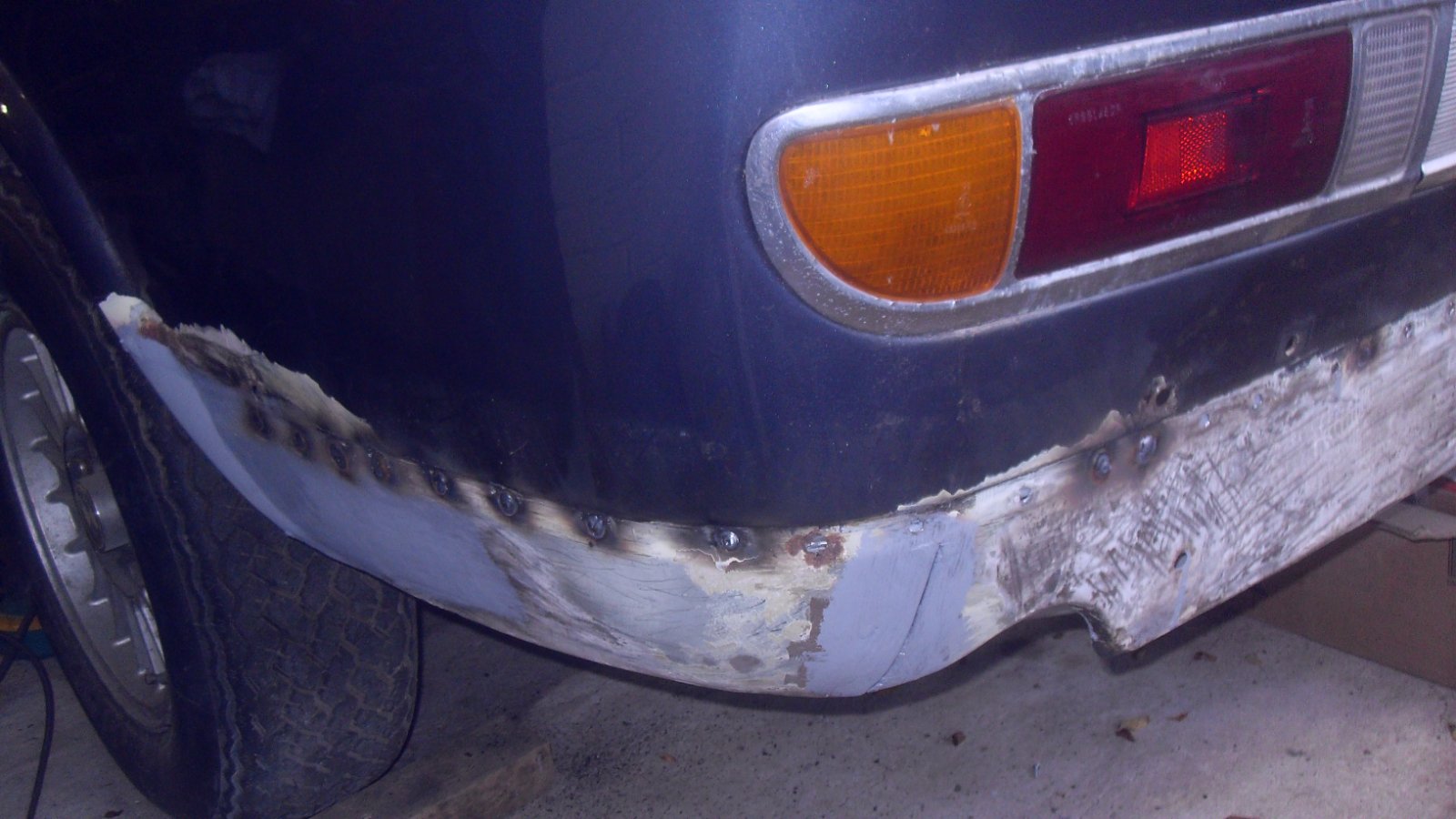

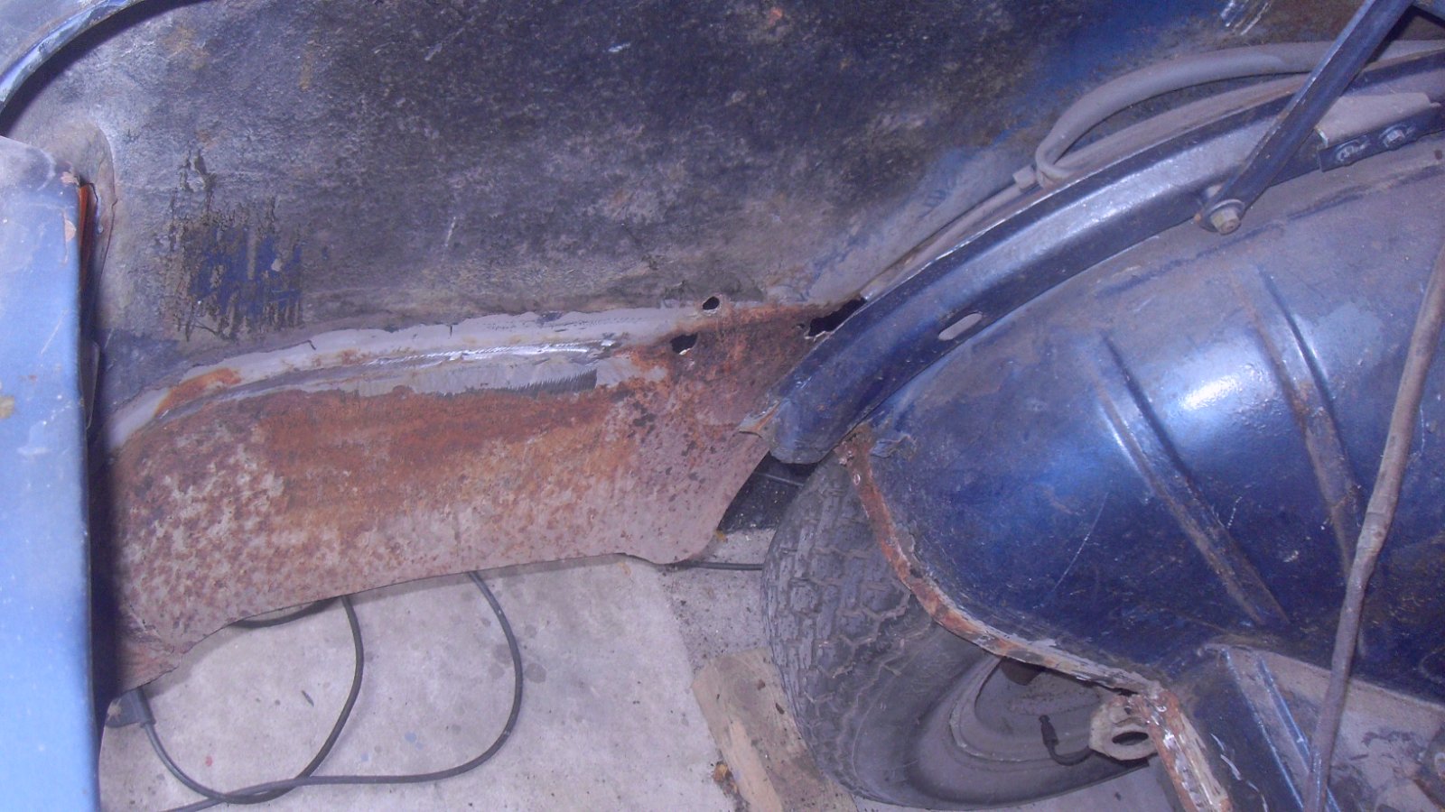

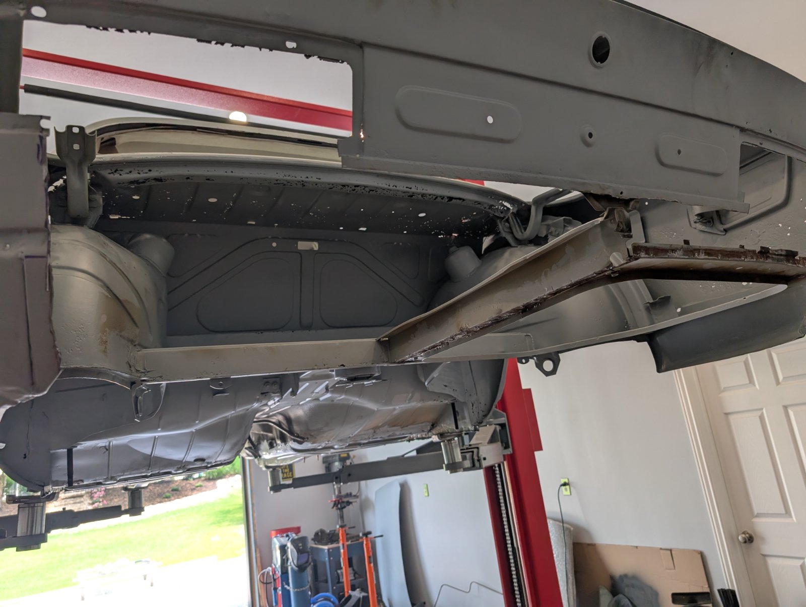

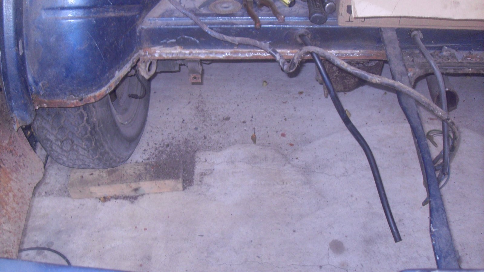

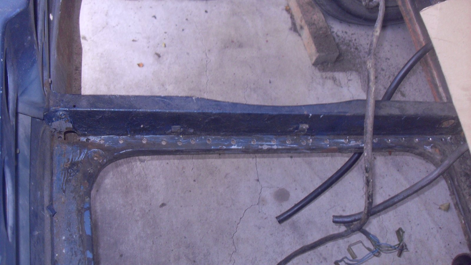

Have done his job also - it's satisfying replacing such a large piece in one go and the W&N part is good and fits well. Here are a few photos for inspiration:
As Erik says, there are half a dozen or so brackets to come out and be swapped over once the new panel is in. It is a great opportunity to also fix any holes in the lower quarters and/or clean off surface rust. also worthwhile to open up the seam between the back panel and the rear quarter panel as they're always rust lurking in there.
I plug welded my floor back in - most welding done from the outside as easy to clean up afterwards.
View attachment 206172 SDC14377.JPGSDC14378.JPGSDC14379.JPGSDC14384.JPGSDC14385.JPGSDC14727.JPG

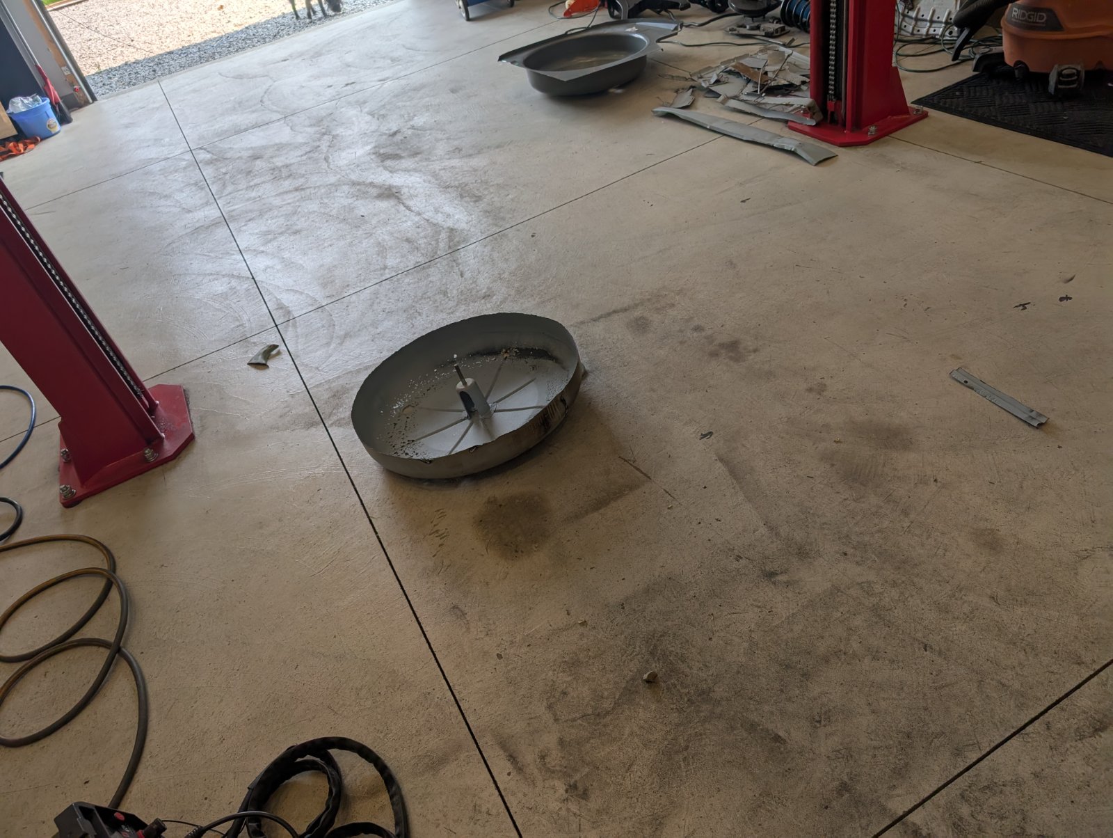

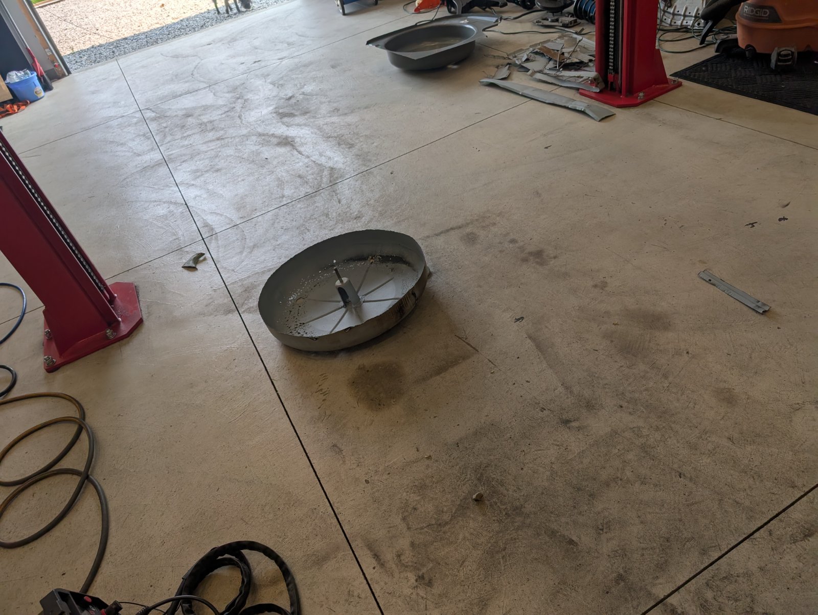

And yes... Cut the tub out first. I used a plasma cutter but a cut off wheel will work just fine.

Hal the tub can easily be cut out with side cutter wheel, the pneumatic offset flange tool that I was telling you about will work on this as well…

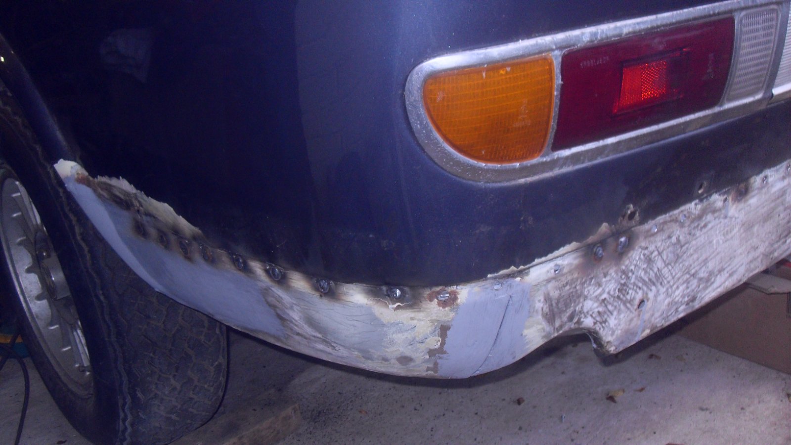

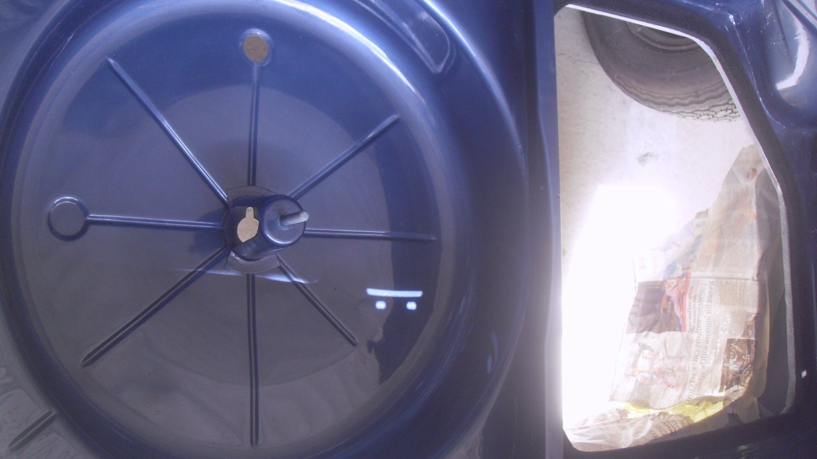

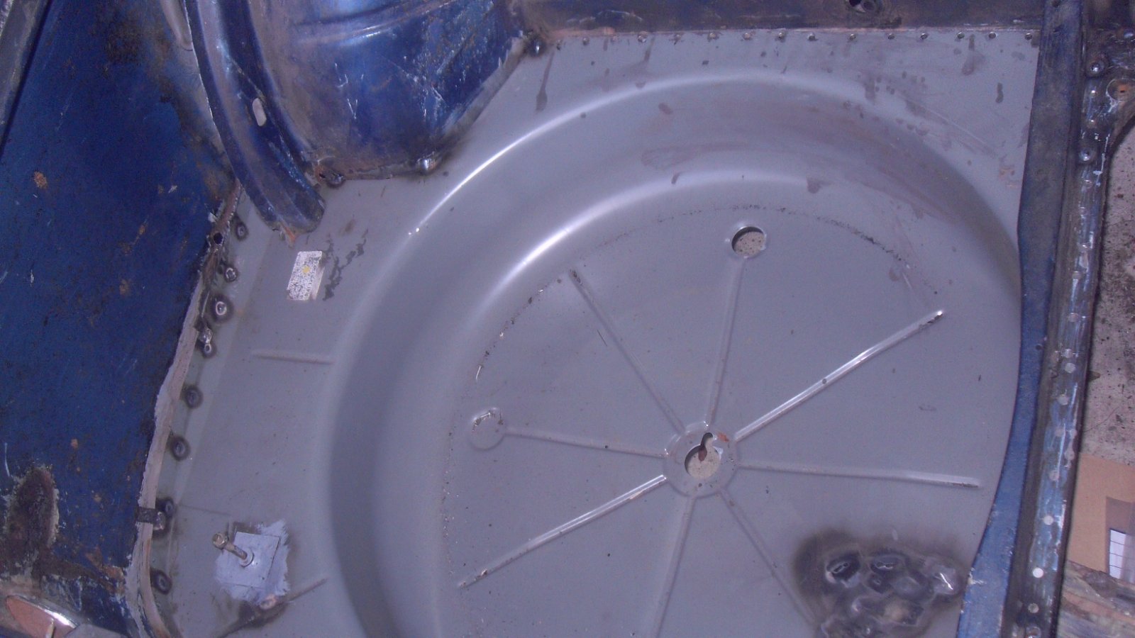

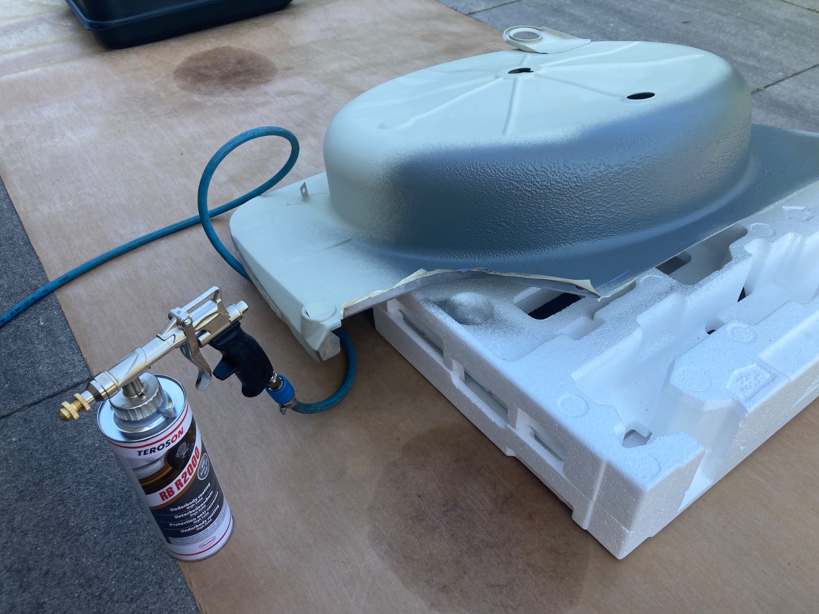

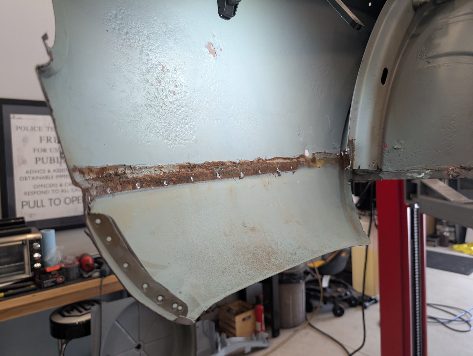

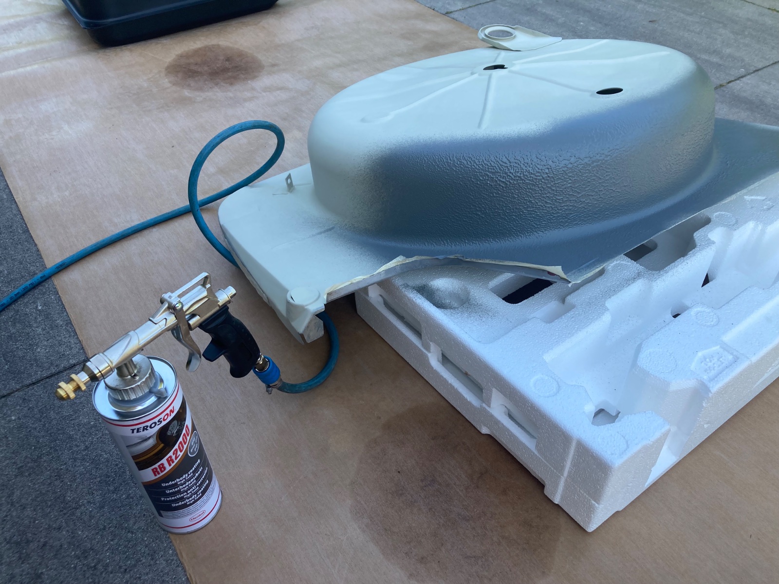

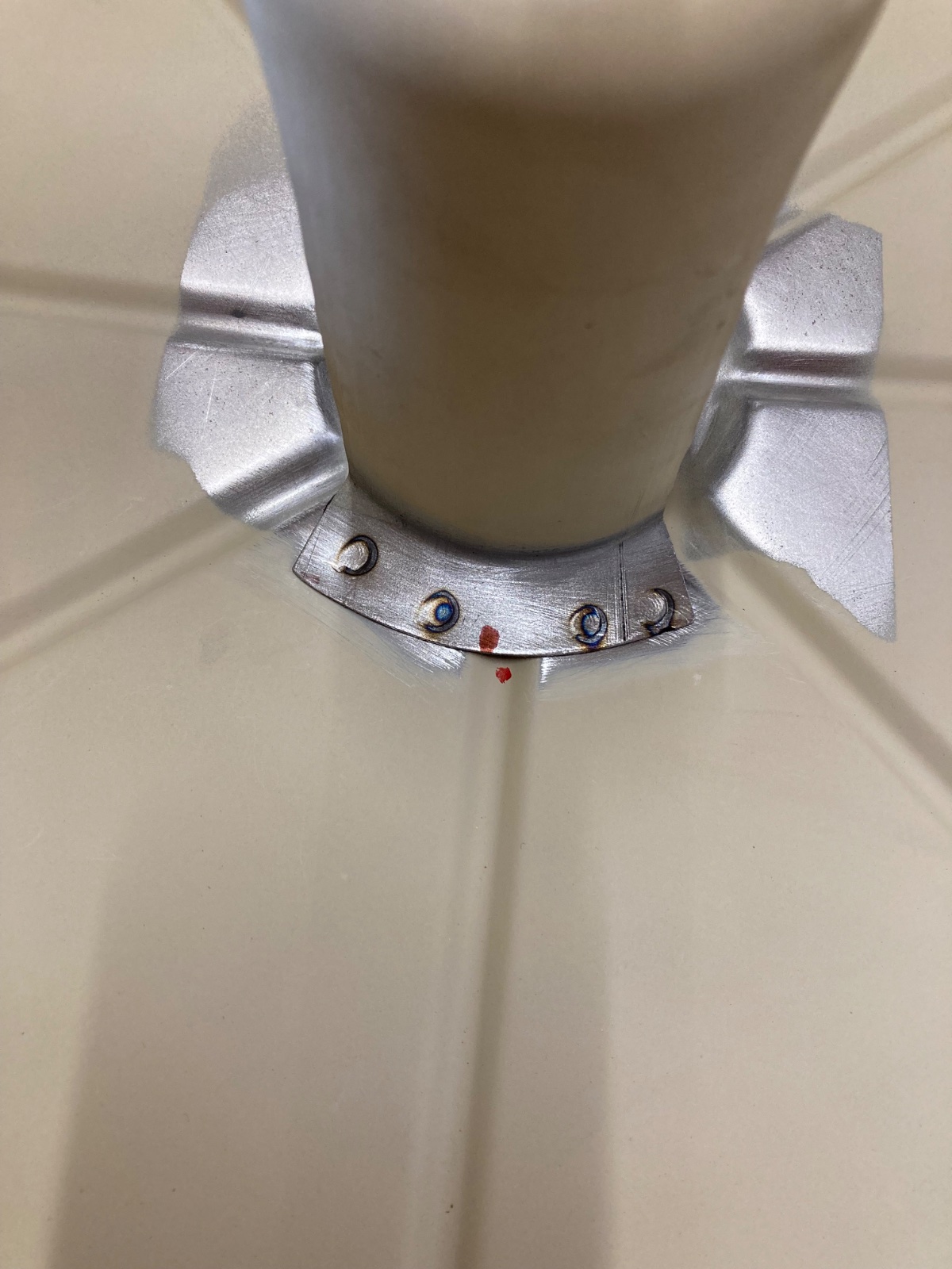

I had to cut off a few 2-3 millimetres of the pieces to made it perfect fitted. Tip: spray the underbody coating pre fitted. So you can spray it at the right angle (easier).
I made the bold and welding plate for jacket off stainless steel.
Also remove the temporarily coating from W&N. (It’s not bonded very good to the metal). Use an epoxy primer. I used “stripper”. In Dutch called “afbijt” :-)

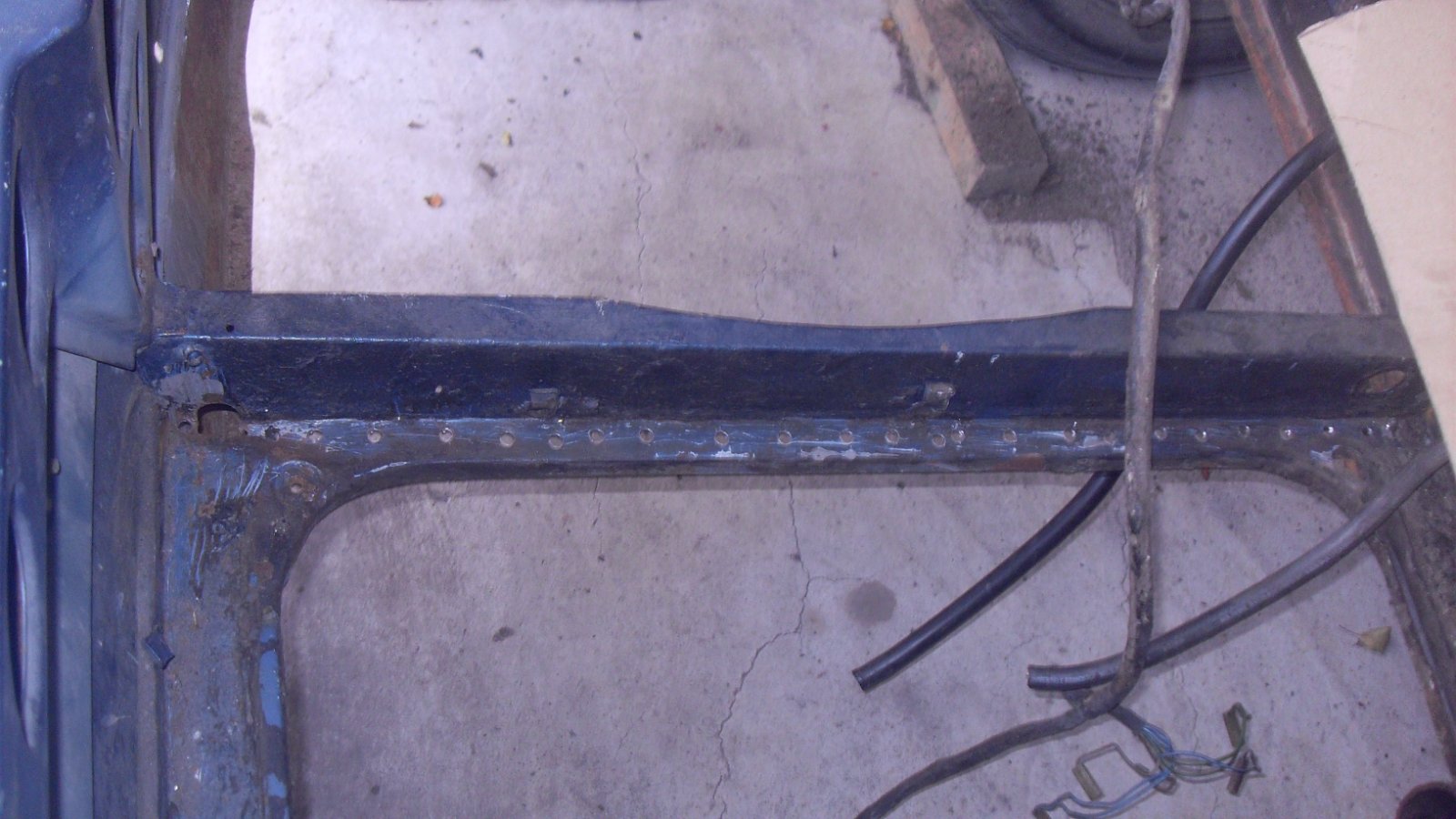

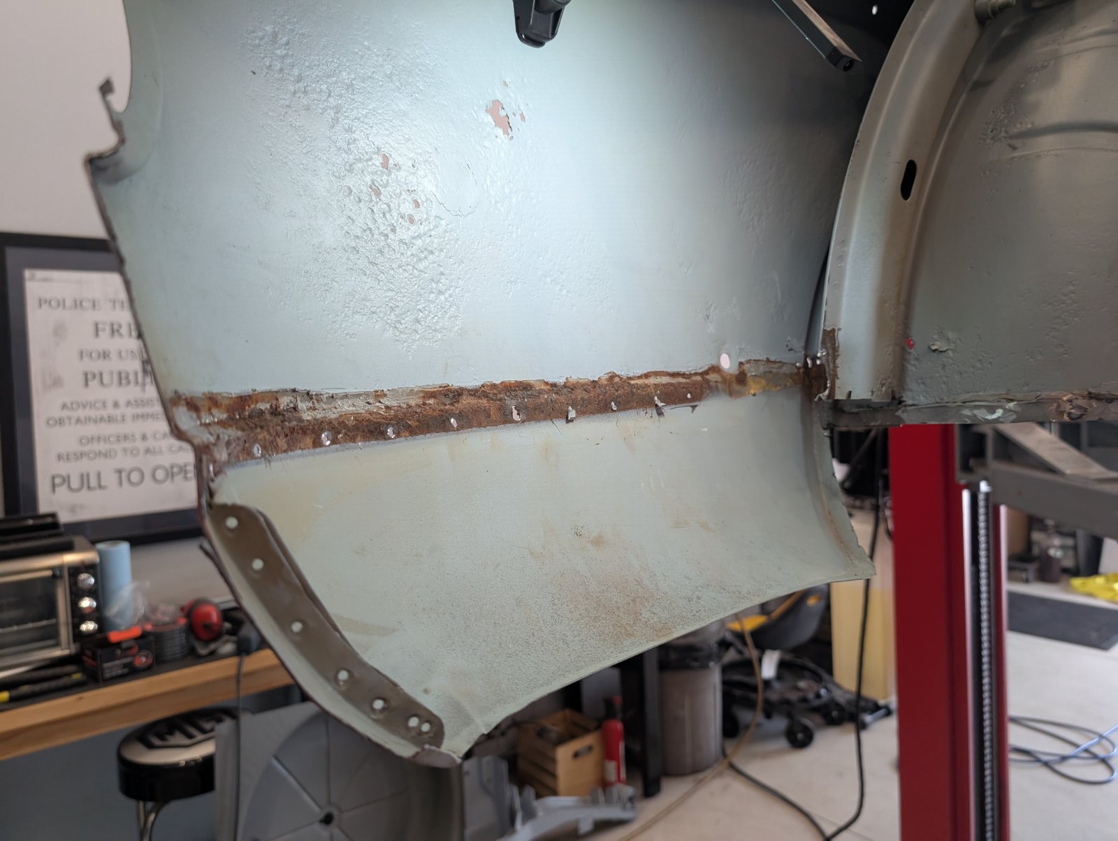

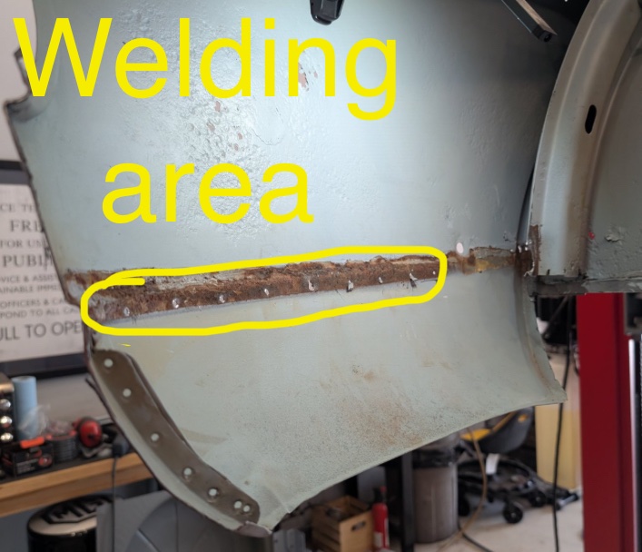

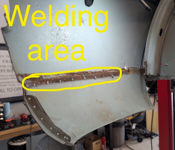

Please note that the welding area at the side fender stops nearby the hole for the bumper. The area between the hole and the wheel arch is only filled with kit. Original!!
(If you should welded and thus pushes the part together, the metal sheet of your fender will misalign).
