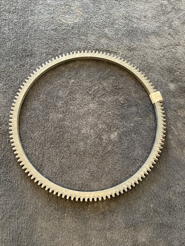

Hello, Just about to get started on exchanging my four speed transmission for a five speed. While I have the transmission out, I am planning on inspecting the flywheel/ Clutch for any needs. The starter makes a occasional noise like turning on the starter while all ready running. Suspect gear tooth damage to either the starter or flywheel ring. I can find a starter motor just about anywhere,
Does any body have a flywheel ring in good shape for a 1972 BMW Bavaria with a manual trans? If so , How much with shipping to Venice, Florida. 34285 please.

The ring gears have been NLA for quite some time, there was a fellow out of Turkey that had some but that was a least a couple of years ago. I think the best that you can do is get another used flywheel and ring gear also, engines usually stop in the same six places all the time, you could try removing the ring gear and remounting it in a different spot IF you can't find a used one'
Thanks, Rick
You don't have to do any real machining to remove the ring gear. You drill two holes into the ring gear 180 degrees apart and then strike it with a hammer to break it in half.
Put your new ring gear in the oven after your wife has gone shopping and once it is hot use some heavy leather gloves like welding gloves to handle it and place it onto the flywheel.
