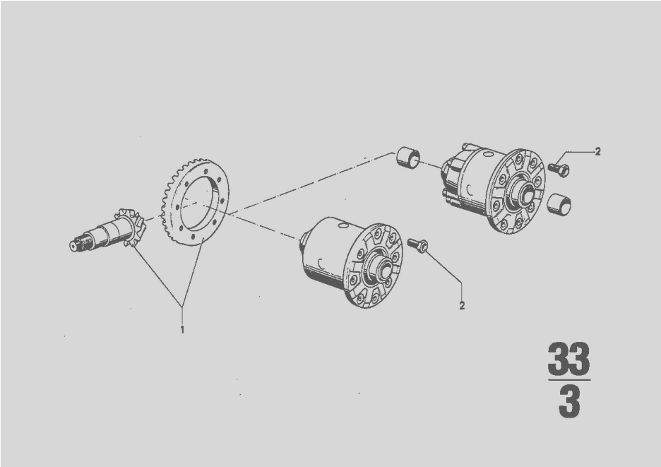

  • Screenshot 2023-08-19 at 20-01-22 RealOEM.com - Online BMW Parts Catalog.png

It looks like you are seeking a 3:45 set, correct?
You may have better luck seeking an intact differential. Most folks here don't disassemble differentials out of concern for our ability to properly reassemble them.
WN list this as good for 2800cs & CSA. I can't be sure it's also good for a 3.0cs.

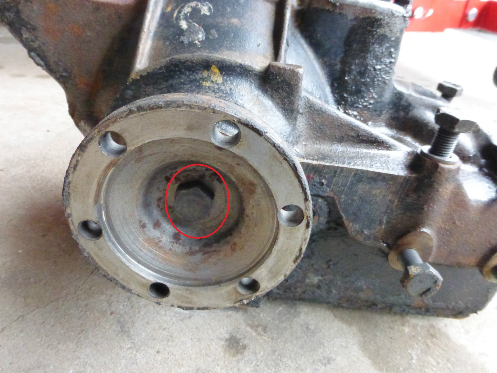

It's all about your current differential type - early vs. later.
Eearly have 8 bolts crown gear & later have 10 bolts crown gear
W&N have the early one;
You can check it by that bolt on the half shaft mount - early side-loader have that additional bolt, later doesn't.
Main mechanical parts - early vs. later are not interchangeable, even the case itself is slightly different.

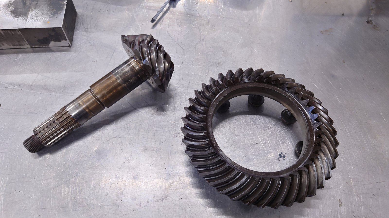

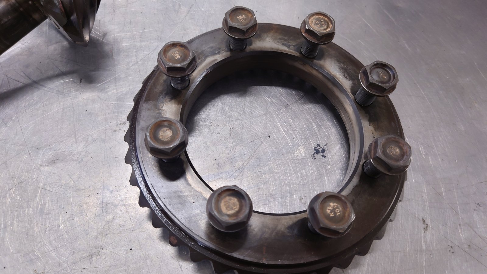

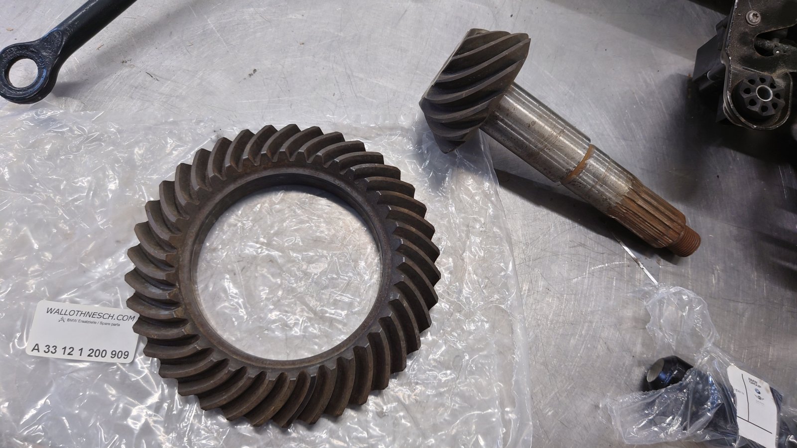

This Jon, turned out to be the correct answer as I can confirm and experienced first hand. We used the earlier M10 crown gear in our later differential using larger bolts. Both had eight bolts.
We have now setup a smooth and quiet final drive as road tested, very pleased to have found the parts.
How did you use "larger bolts" with the M10 crown gear?
Did you re-tap the M10 crown gear for M12 bolts?
