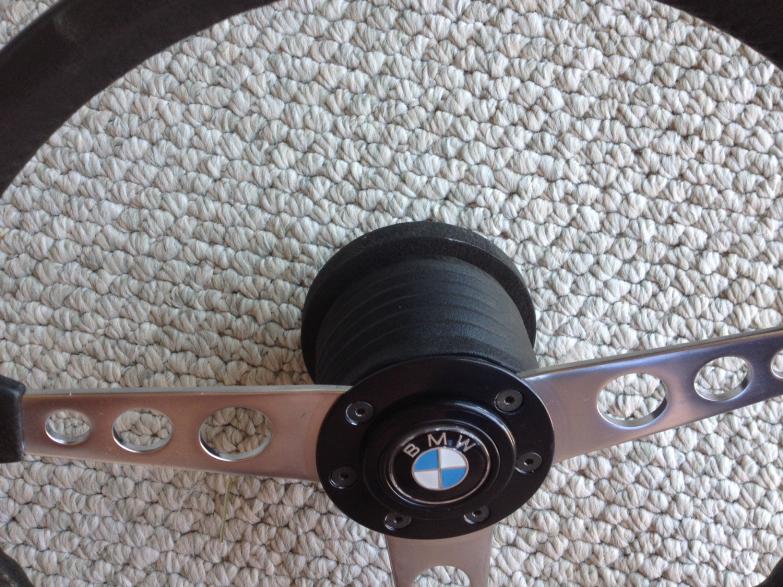

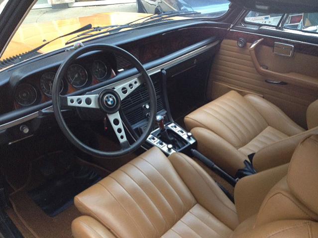

The Nardi hub works great and they look Pretty Good.
I am not saying the Nardi hub is better or I would want that over the originial but in a pinch the Nardi hub works great and they look pretty good. And once on the car the difference is not really that noticeable...

looks good to me. it bolts right up? Or do you have to drill and tap the adapter?

Oh wow, ok, I had no idea that bolted right up. I don't have a concourse car so that my be the trick, thank you!!! So, is there a model number I need to ask for? Where did you get that? Thanks again!

You will have to drill/tap new holes.
The mounting holes for the Petri wheel will not align with those on the Nardi or MOMO hubs. These are radially symmetric (the holes are equally spaced) while the Petri holes are not - this is most easily seen by comparing the spacing between the top two screws and the bottom two.

You will have to drill the 5 holes... Very easy to do.
To convert the Nardi hub just rotate the wheel on the hub a few degrees past the 6 Nardi holes and mark then drill the 5 Petri holes. Tapping the hub works but because the metal is thin I also added nuts on each small bolt...
