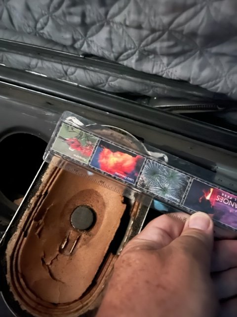

I'm restoring the dashboard on a 1967 2-liter coupe, and need another radio speaker (NOS or modern replacement) or a recommendation as to who might rebuild a speaker with a damaged cone. See photo, speaker sitting on dash frame. Thank you. Robert, [email protected]

You're really better off replacing it with a modern two-coil speaker. Plenty to choose from and inexpensive.
The other option is go to an amplifier/speaker shop and have it re-coned. A quick Google shows there are several in Hawaii.

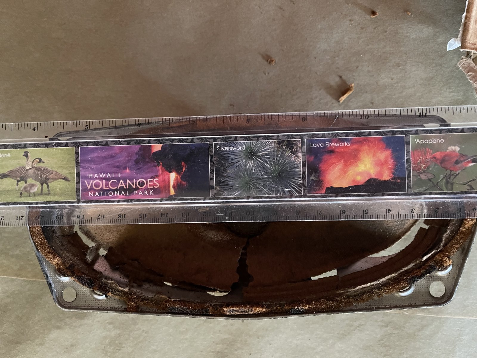

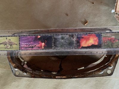

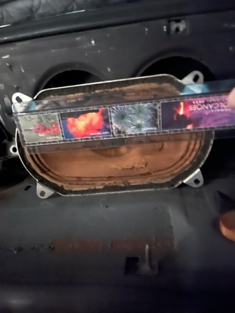

Okay, getting dark here, but I took some lousy pictures of the front speaker, below. The mounting ears have fastener attachment holes that are roughly 17.5 CM apart lengthwise, on center. The ears are 10 CM, on center, in height. The total length of the speaker cone oval is 15 CM, and the height of the oval is 9 CM. The depth of the speaker is between 4.5 and 5 CM. Note the information stamped on the back. Thank you, Russell! Robert

Here's an update on my earlier post. I also discovered that there's a rear factory speaker, so more details on that later! My true need is for the front speaker that mounts behind the dashboard (but, towards the front of the car). When the dashboard is installed (likely a windshield out job) the speaker is effectively buried. Also, the speaker fasteners seem to have a modest role in keeping the dashboard stable. This arrangement on the 2000 series coupe is unlike the 2800 coupes, in that the slats are an integral part of the dashboard face, as opposed to being a separate slatted cover.
See photos below. The length of the mounting ear holes, on center, is 17.5 CM. The height of the mounting ears, on center, is 10 CM. The total length, out to out, of the speaker cone is 15 CM including case surround, and the total height of the oval is 9 CM. The depth of this speaker is between 4.5 and 5 CM, which may be critical since the dado'd speaker slats in the wooden dash are so fragile. I would not want to put any additional pressure on the dashboard slats by trying to mount a speaker that's too deep.

Yeah, the original speakers are an odd shape... if you don't find a place on the island here's a shop in SoCal that recones.
Dimension being roughly 4" x 7" modifying a modern unit to fit the mounting holes is another option.
