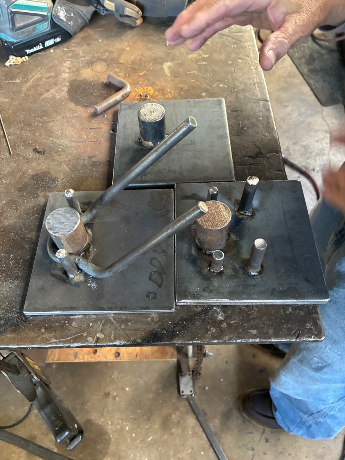

We are making tow hooks if interested
sfdon
10,047
6,877
sfbay area
We’ve been making Tow hooks for years one at a time but now we have the jig set up if there’s any interest.
Front tow hooks are welded on

For two decades, we have seen cars come in with tow hooks snapped off or mangled.
I believe it’s all caused by those darn concrete blocks in the parking lots across the planet.
We cut off what’s left weld up the cracks and weld on new tow hooks in the front only.
