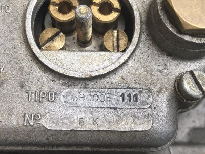

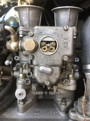

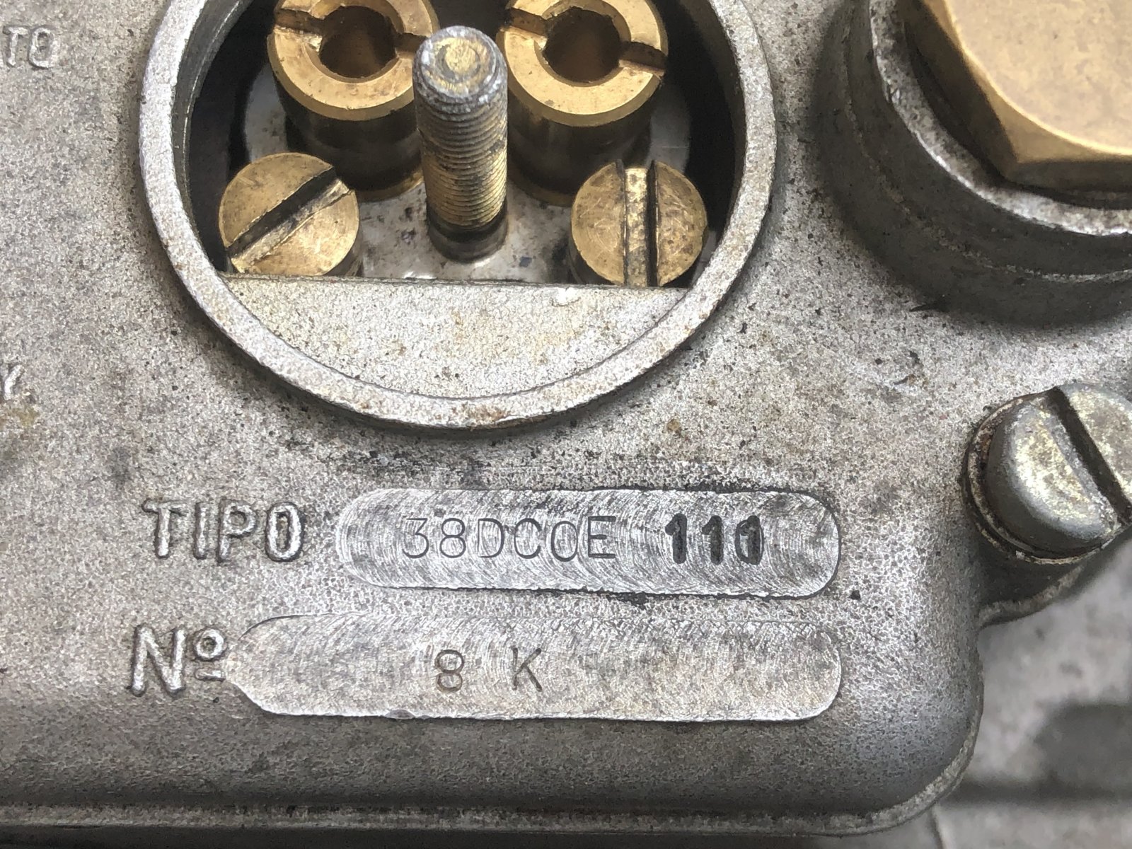

Carbs are Model 111 off a 72 GTC4. I could only get 3 of them to fit the E9. Six was too many.
Float level is slightly low, pressure at 2#s. Regular gas/stock motor. No air filters on at the moment.
Hard/full throttle is 12.8 to 13.5
Idle I can set anywhere from 9-13 with screws but above 10 it stumbles on tip-in.
At very small throttle openings/gentle acceleration (it's automatic) must be under 10.5 for actual drivability.
Stumble for a minute when cold (55F) seems right.
I can start the jet dance but without knowing what the tubes are, I haven't.
Thoughts most welcome.
Chokes 30
Idle 45 F23
Mains 140
Tube F41
Air 180
Pump 35

Ahh those are 38DCOE so I will do some research and check my notes and get back to you

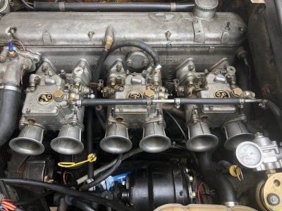

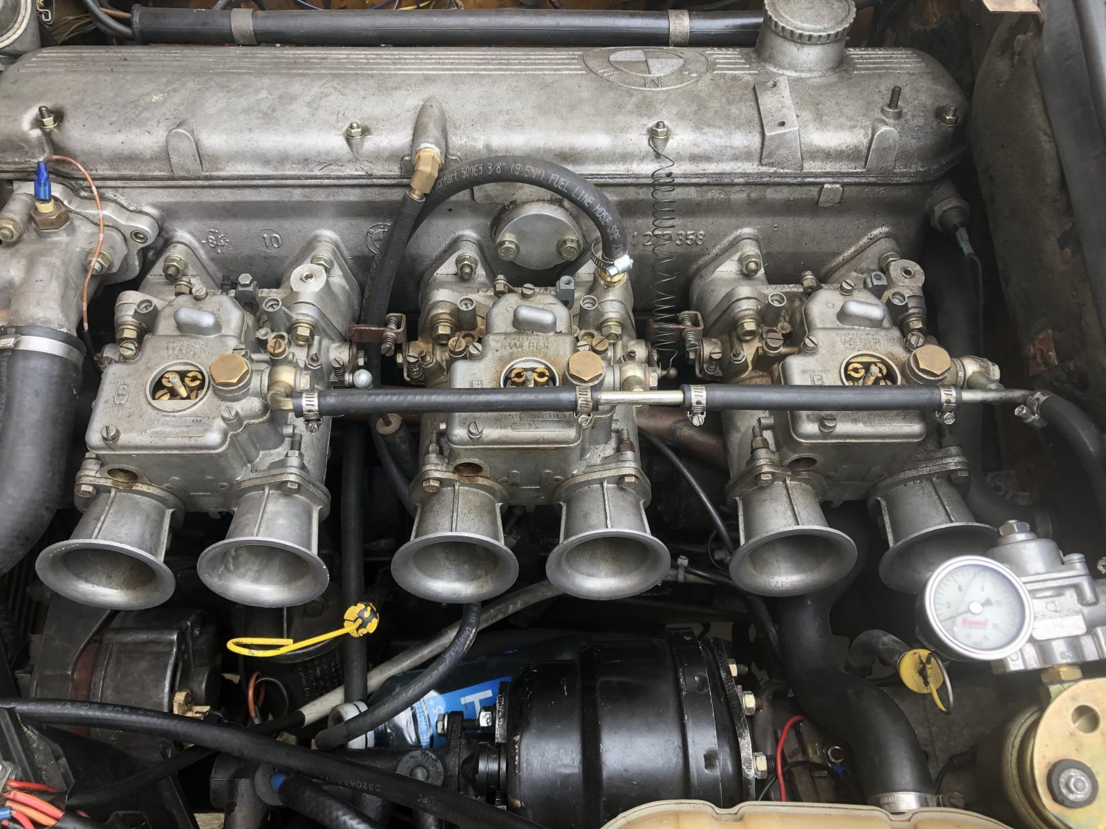

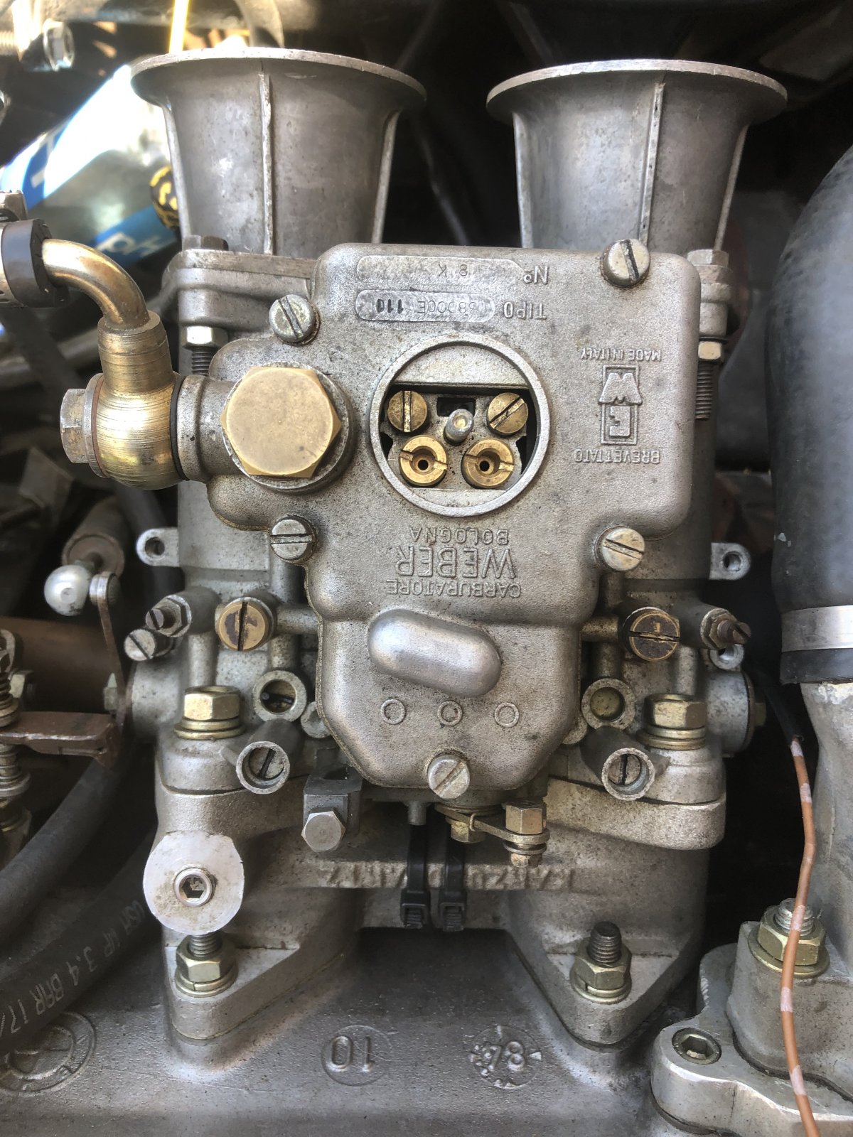

Aux is 4.5
Have a drawer full of jet drills going back to the 70s.
Have a drawer of mains and air correctors from other cars with Webers.
Have a new set of idles 45F11 haven't tried.
Have 35 pump jet
Problemo is no inspection port access on these carbs.
If you have a set of F11 tubes I can try, that would be great. All expenses on me. The tubes, for me, are the wild card.
I have kept the smaller chokes in deference to the auto 4HP22. High revs for this engine is 4K. Add that Ferrari was probably over 9:1 and I'm stock flat tops. 170# compression, but..

Cool carbs, looks like you have idle air bleed screws to balance the barrels - are these screwed in all the way? 30 chokes still seems small, they have a big effect on mixture form one size to another. Will report back on F11's.
