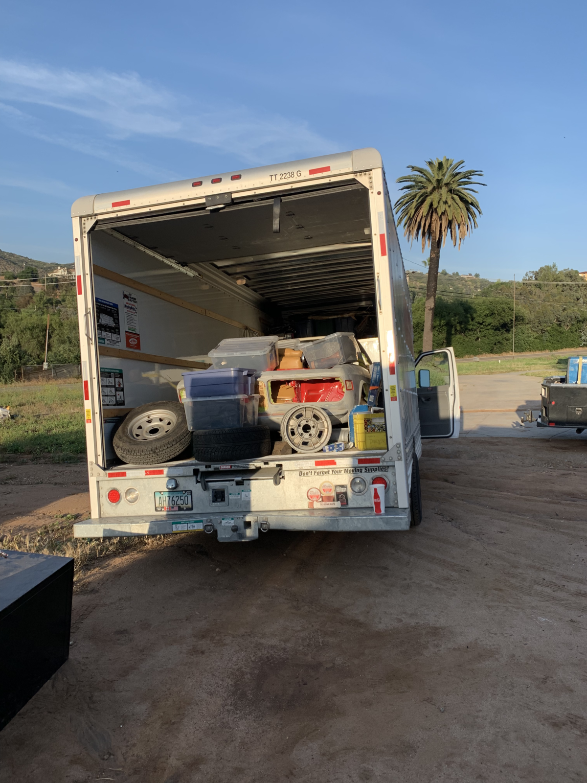

With the help of a couple other guys and a furniture dolly, I heaved one into the back of a U-haul truck. Not the recommended technique. 1603993279448.png

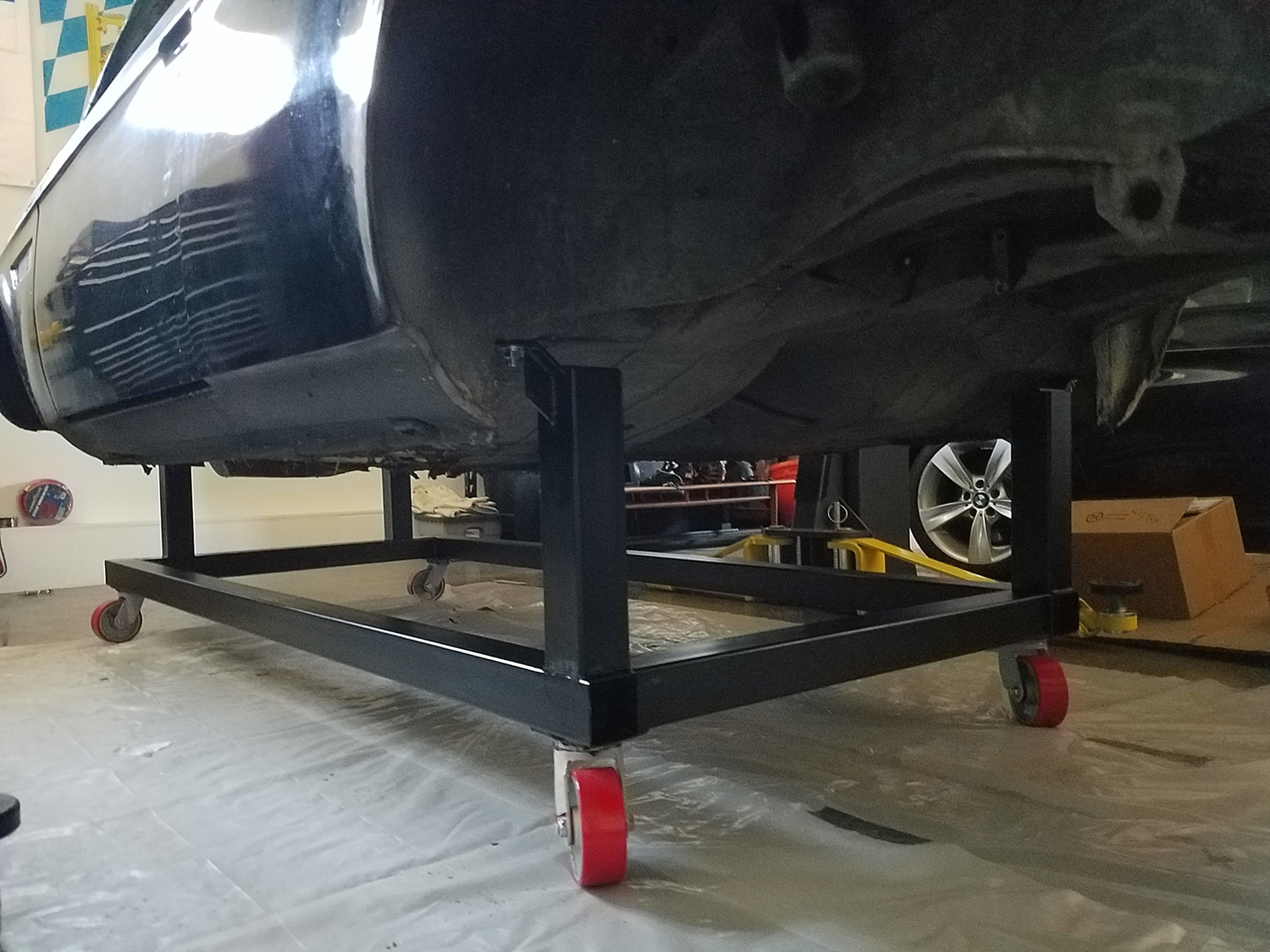

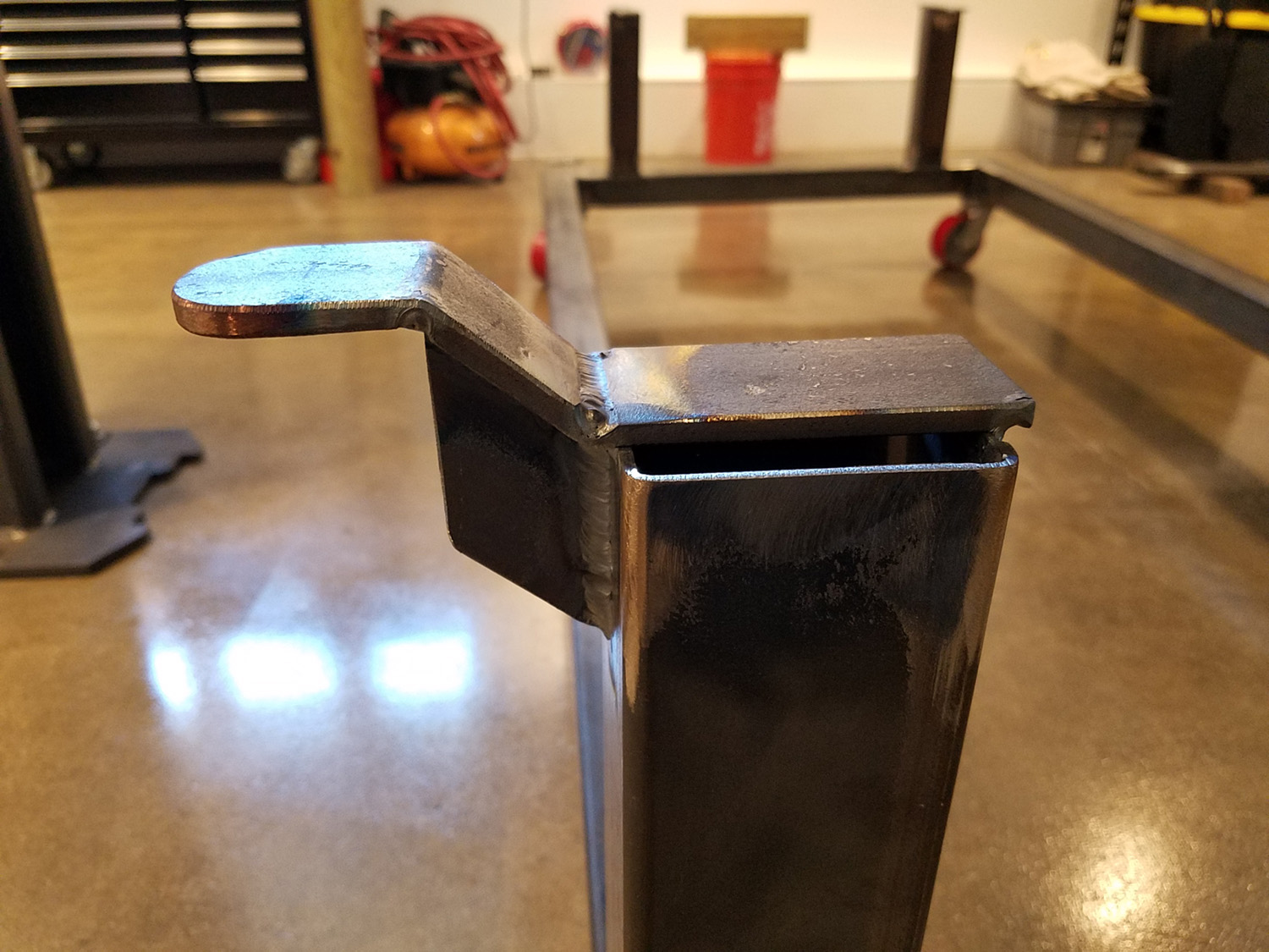

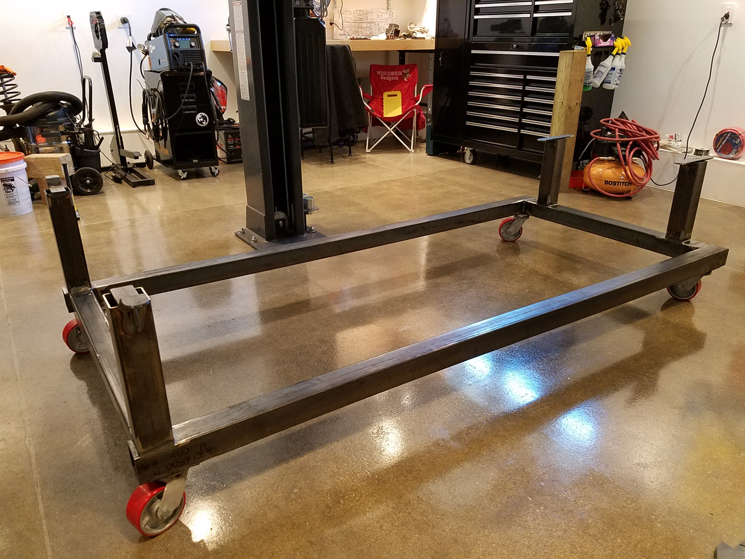

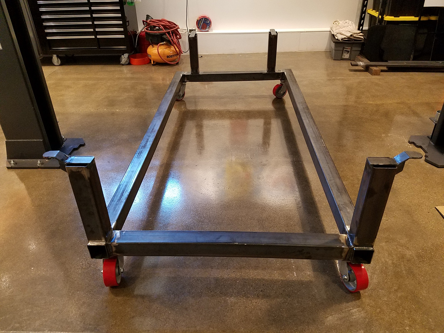

Even if the chassis is that light (800 lbs, 1,200 lbs, etc), I wouldn't cut the ratings so close. First, who knows if those ratings are that accurate? What is the duty cycle - will they roll freely and easily for a week, month, year at full capacity? How much of the load transfers to only one or two of the castors while you are rolling over bumps, obstacles? I used steel wheels with solid polyurethane "tires". I think the capacity is 600 lbs or 900 lbs each wheel.

Point well taken, like the dolly you used.
I see how attached at rear, what about the front.

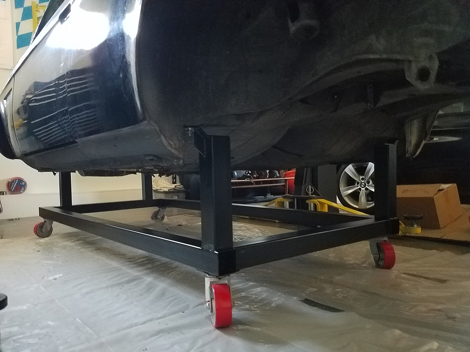

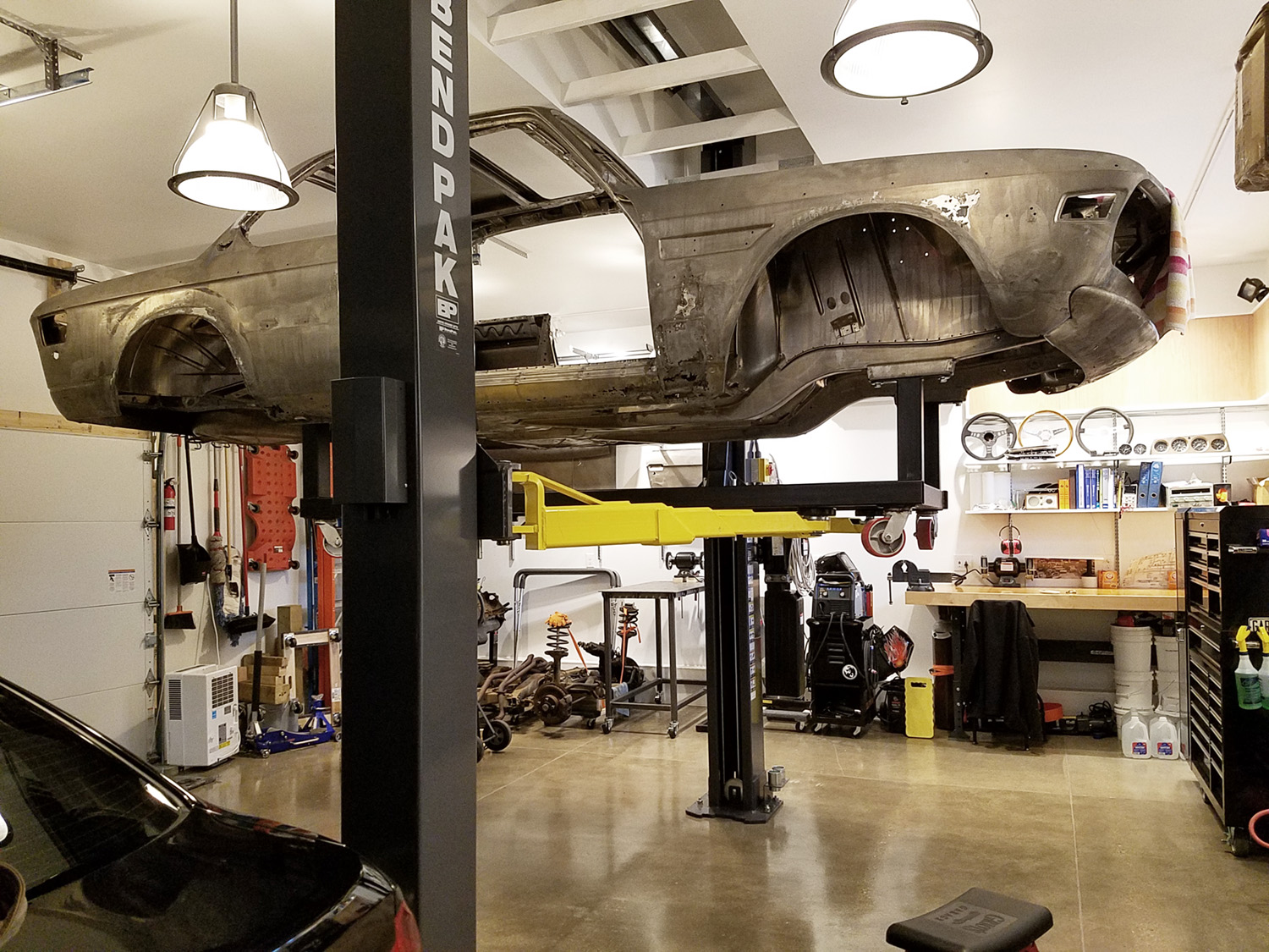

I actually don't anticipate ever working on the car while its sitting/rolling on the castor wheels. The dolly keeps my chassis points precise - but it will either be on the lift as you see below, or on calibrated "jack stands" for lack of a better description. This will allow me to level the chassis/dolly/geometry and measure precisely. And when I do need to move it around on the castors, I can get the car anywhere on these four spinners. ;)

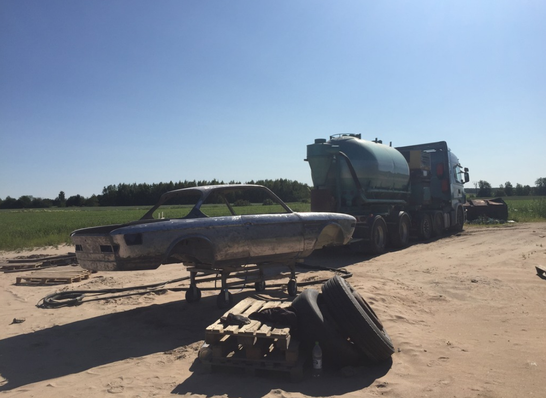

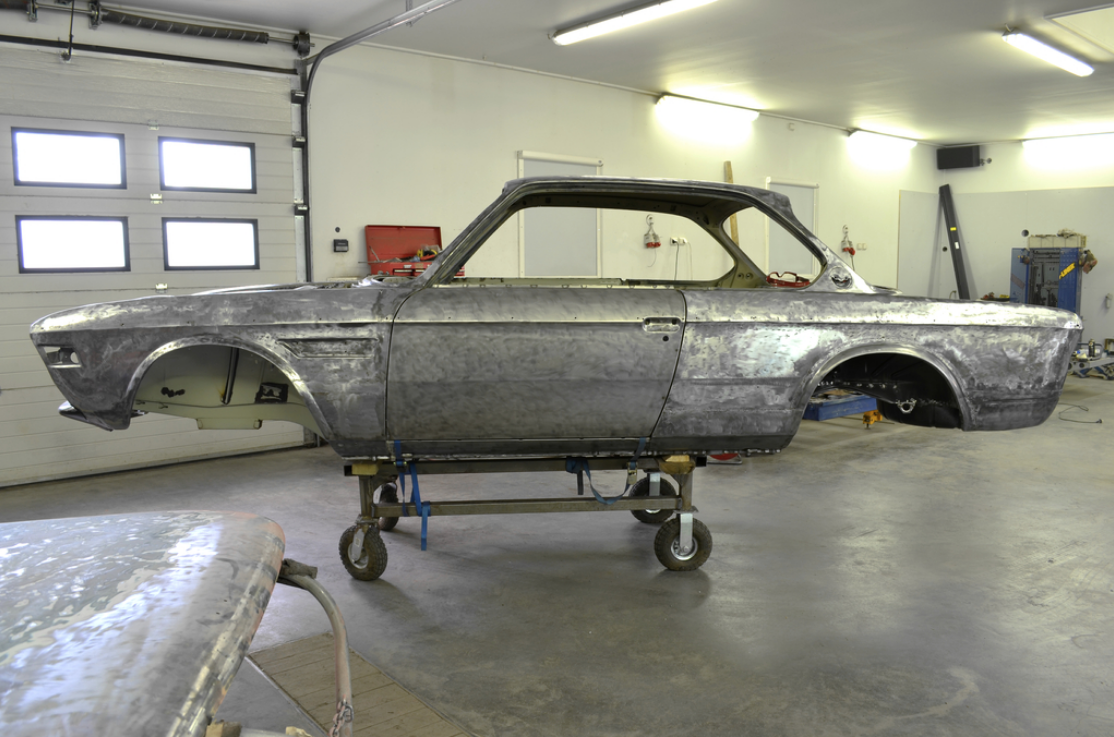

I used pneumatic castors and had no problems during the 3-4 years the shell sat on the dolly :)
The reason I used pneumatic castors was that they allow for an imperfect and somewhat dirty floor. The dolly won't come to a sudden halt if you hit a small rock etc.
And it was easy to move around outside of the garage.
Not sure what the castors were rated for, all I know is that they were in the cheapo range.
