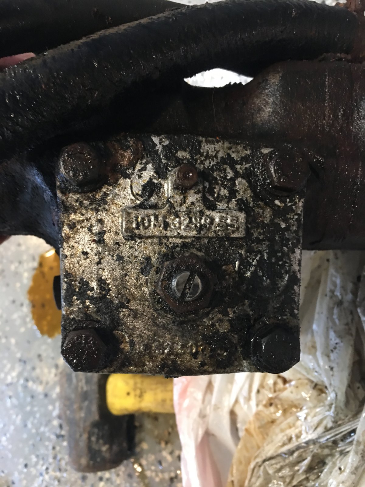

This left me no other option than to mess with the adjustment screw on the steering box. I loosened the nut while holding the screw in place, then turned the screw until I could feel some resistence (approx 20° in my case) backed off a tiny bit and tightened the nut. Went for a test drive and had a return to center problem. Stopped and backed off a tiny amount again - better but not good. I repeated the backing off by a tiny amount a couple of times until I didn't have the return to center problem anymore and now the steering feels like a new car compared to how it was before.
If you overdo the screw, it can/will lock the steering - so be careful if you try this!

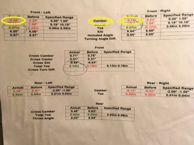

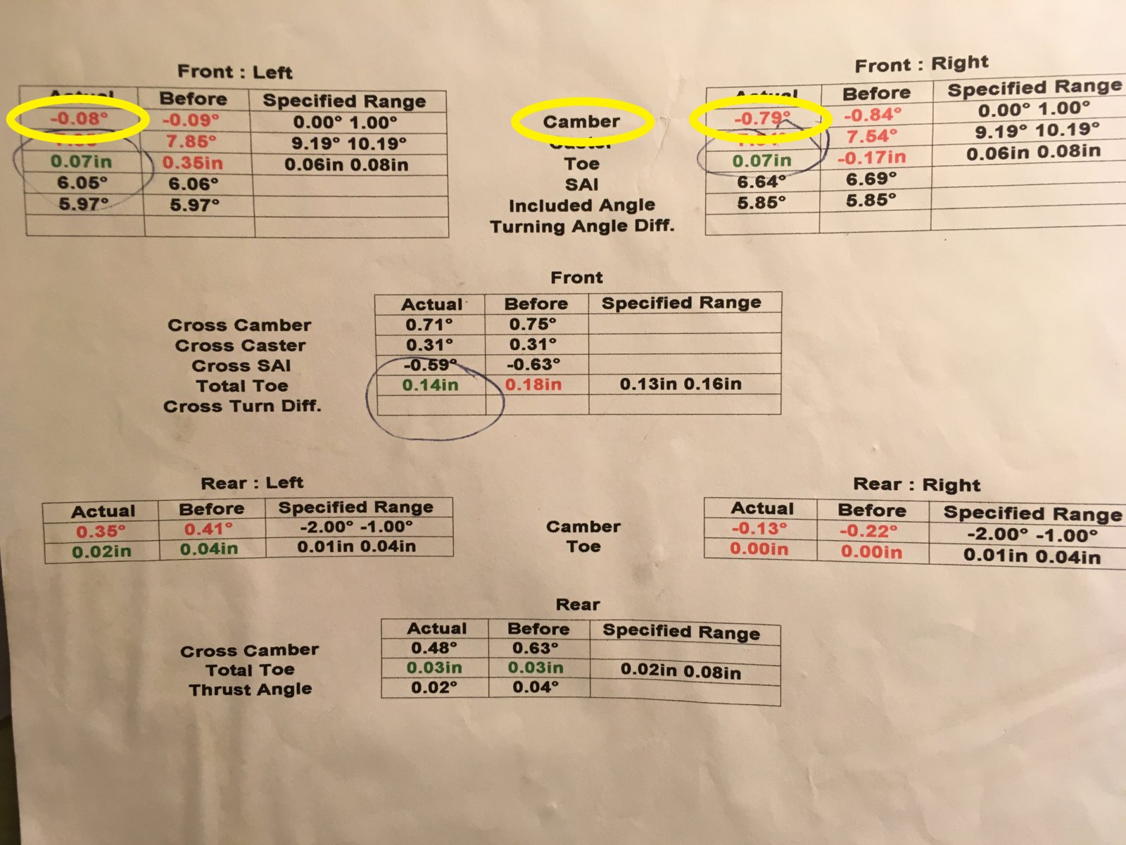

In the meantime, the plot has thickened a bit. I was aware that my right front tire has a bit of asymmetrical wear on the inside edge. I just checked the specs from the last time I had a commercial alignment, and the right front wheel shows substantially more negative camber than the left front. Granted, this was quite a while ago, and the car has had changes since then (Alpina 16-inch open lugs, 205/55ZR16 tires, and springs from which I cut a coil to settle the nose down), but I'm curious if uneven camber is what wore the right tire, and the combination of the uneven camber and the worn tire is what I'm experiencing. I think I'll start with a camber measurement and swapping the tire out and see where I am.

I had uneven wear on my right outside tire running fixes negative camber plates, after 9300 miles it was almost bald. VSR checked the measurements of the car & everything was in spec. The alignment showed the camber was not even side to side. It was corrected with adjustable camber plates to get equal negative camber on both sides. Left is -1°, Right is -1.6.

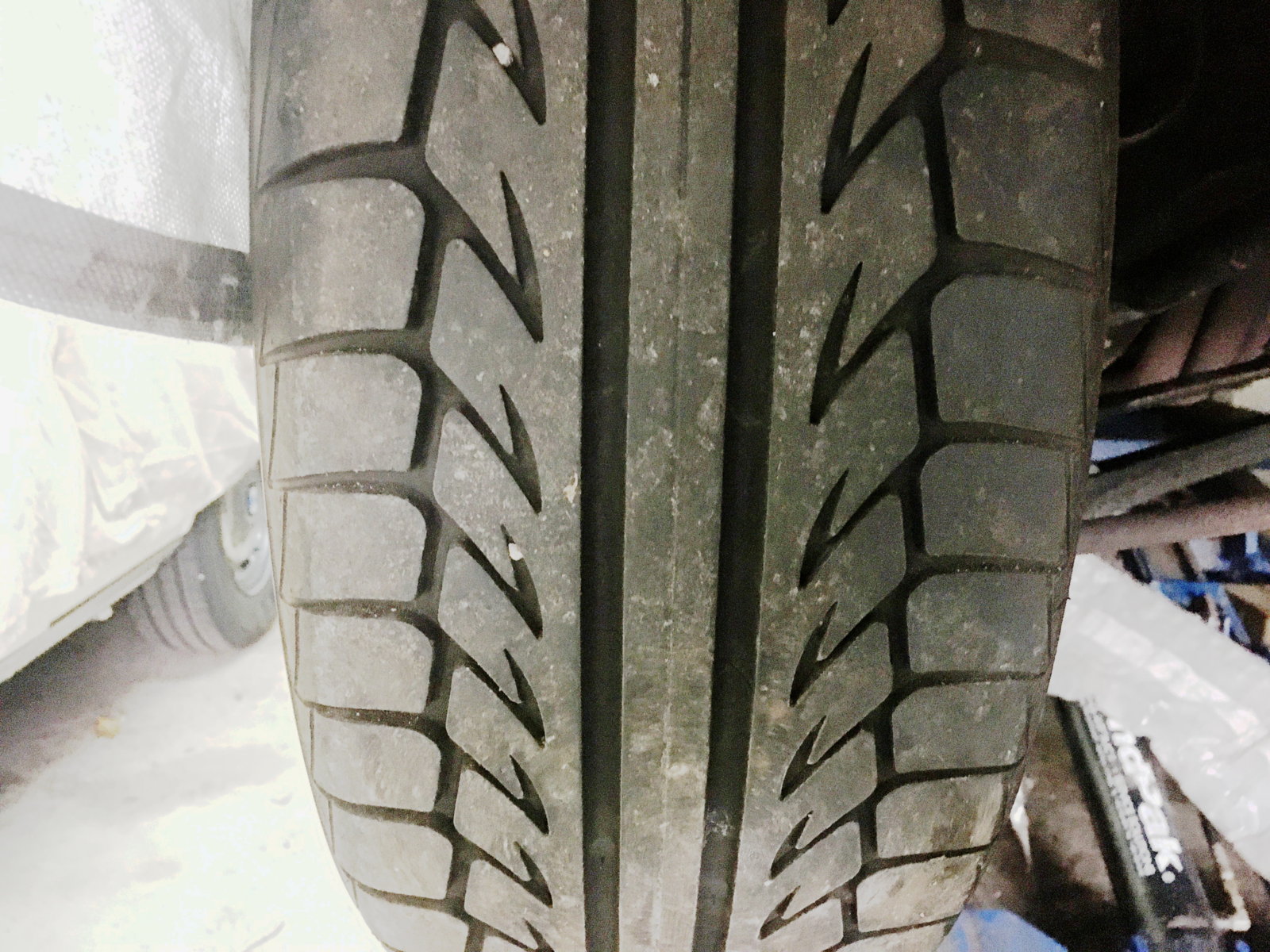

As requested, here's a photo of the right front tire showing wear on the inside edge. It's not that dramatic, but a tread depth measurement shows that the innermost tread groove has 5/32″ of depth, whereas the rest of the tire has 7/32″ or 8/32″.
I bought both an inexpensive camber bubble gauge and an inexpensive digital inclinometer and took some careful measurements with them using a straight piece of 1/2" square steel tubing cut to fit lip-to-lip on the outside of the wheels, and both gauges do indeed show that there's about a 1 degree difference in camber between the right front and left front (left is about -0.8, right is about -1.7). So it makes perfect sense to me that the uneven camber is wearing the inside edge of the tire, and both the uneven camber and the uneven wear are causing the dart-y feeling.
