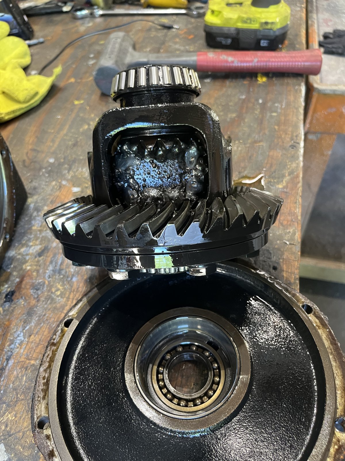

Represented as a “limited slip“ unit, the differential didn’t slip at all. Full lock , all the time.
We thought it might break loose. Finally, I removed it to discover it was welded-in-place.
3:64 internals. Does anyone have a limited slip gear set for sale?
Thanks in advance for your help.

Back in the day, did you weld it?
