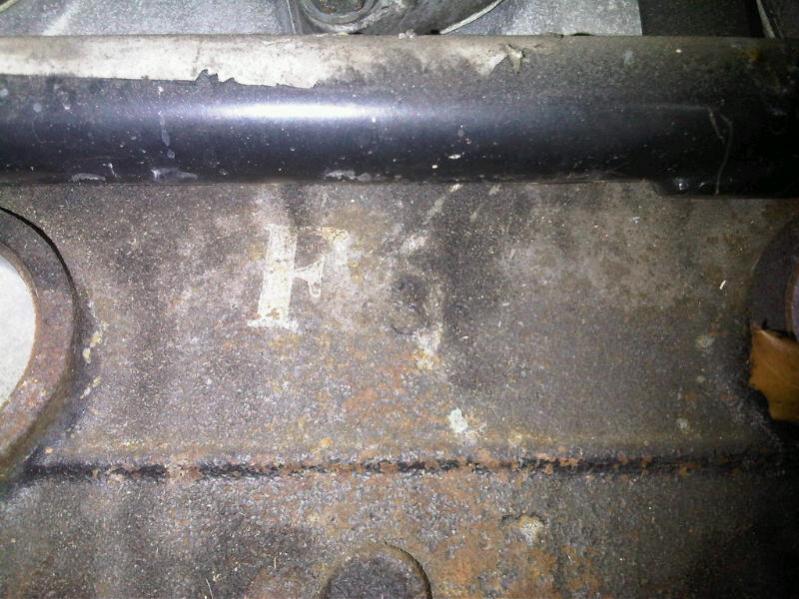

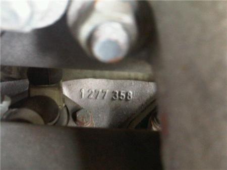

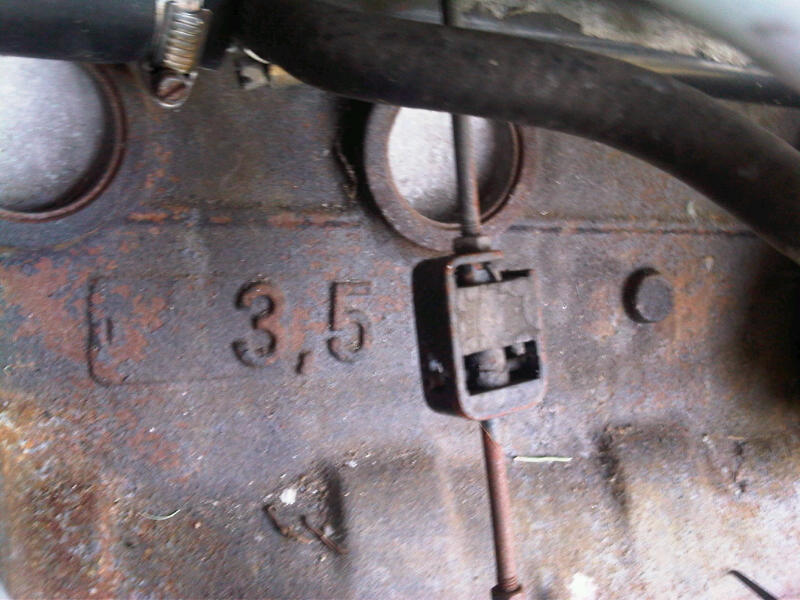

Hi, I have this 3.5 euro type engine and it has a very clear F painted on the side near the 3.5 stamp.
I am sure it is an M90 engine, but any idea what the F means??
Please see pics.
Thanks for any info. I have asked this question before, but am gearing up to put this engine in after preparation and rebuilding as required.

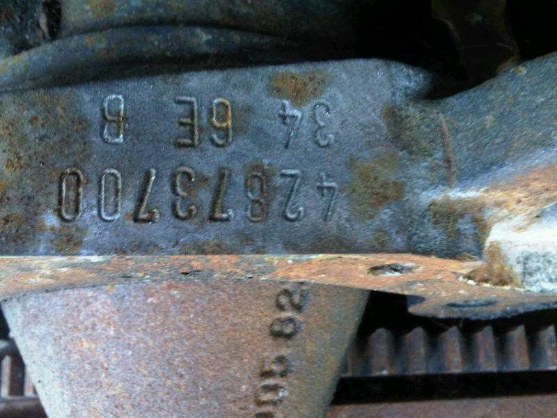

Hi OZCSi,
34 6E B means it is a M30B34
In other words it is the 3430ccm (86x92mm) Motronic unit, with 218ps.
It was used on the 635csi and 735i between 5/1982 and 1986.
The M90 (84x93.4mm) has a white L painted on the block.

I am so confused by this ....and thanks for your reply. The engine doesnt have typical motronic, so am really going to get into this with as much info as I can give for the board.

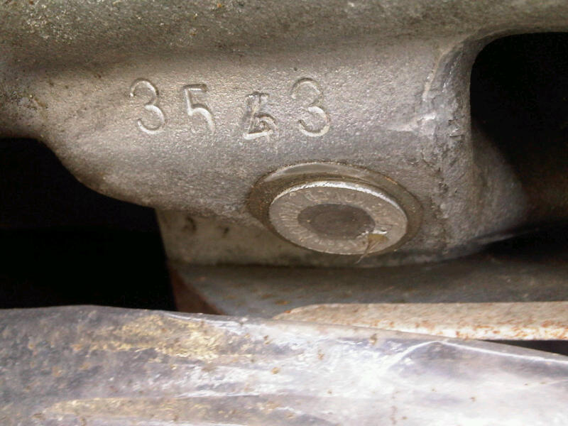

Although it is not clear in the picture, it is almost assuredly has 3543 stamped on it in the pictures. This doesnt really macth anything, but is stamped in, so maybe just an engine number??? ( 3453cc i would understand !! being cc etc)But it is just so hard to get any info here on these engines in terms of other details that are apparent.

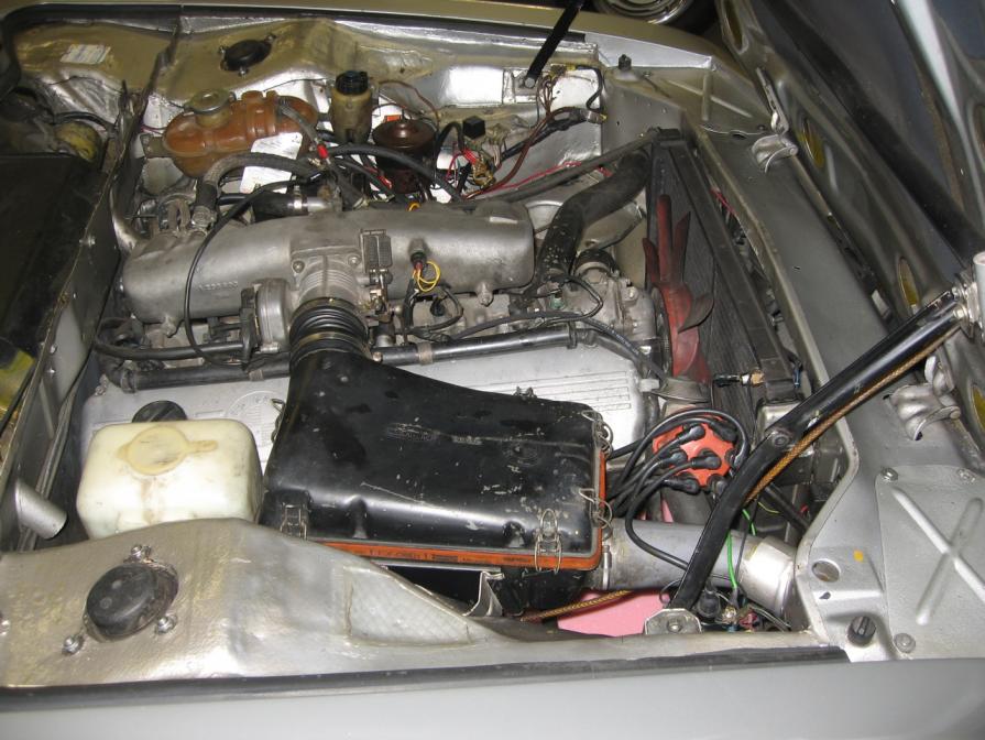

This engine has the log type manifold with I am sure L jet injection as it has a distributor!!!

Remanufactured engine?
It appears the 3542 stamp is next to a round after market rebuilder identification tag. I've seen similar tags on engines remanufactured here in california. Perhaps that number was added by the rebuilder.

This engine is mated to a 5 speed with mechanical drive for the speedo.........
I am doing a lot more checking and am also sure that it is not an M90, but may have been reworked with a non stad stroke/bore etc. The guy I bought it from who has sadly passed was a genuine tinkerer!! Now I need more info, he can no longer help me, which is a shame,because it may have some mods!
Cheers and best wishes
I dont think you could really identify the engine from the ancillaries unless you pulled it from a car with the same chassis number as the engine. It might have been a bare long motor that "the tinkerer" has added those bits to.

Still looking at that F painted On block and wonder what it means.

It has 3.5 cast into block
It has the m30b34 on starter area of block.

Need pic of left side of block.
Need pic of numbers stamped above starter.
