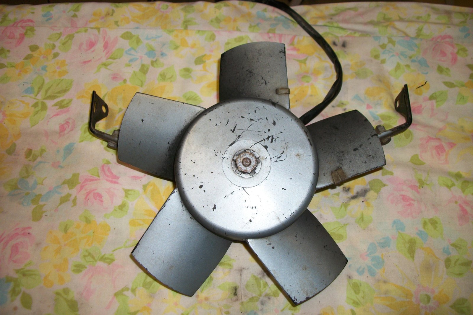

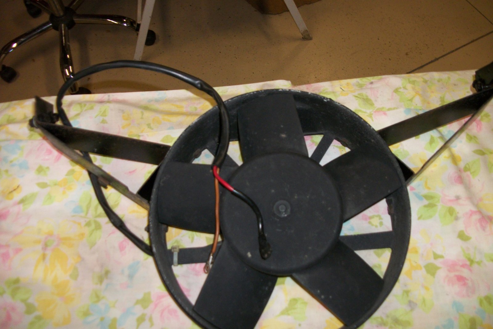

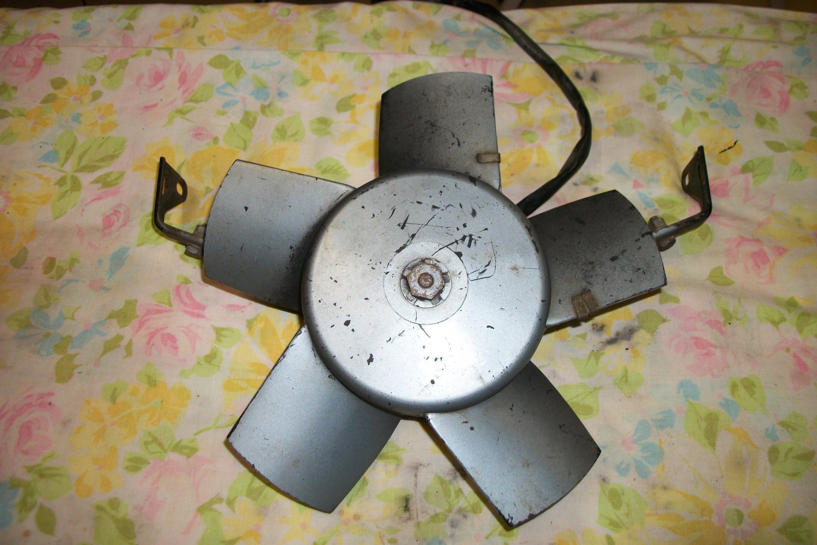

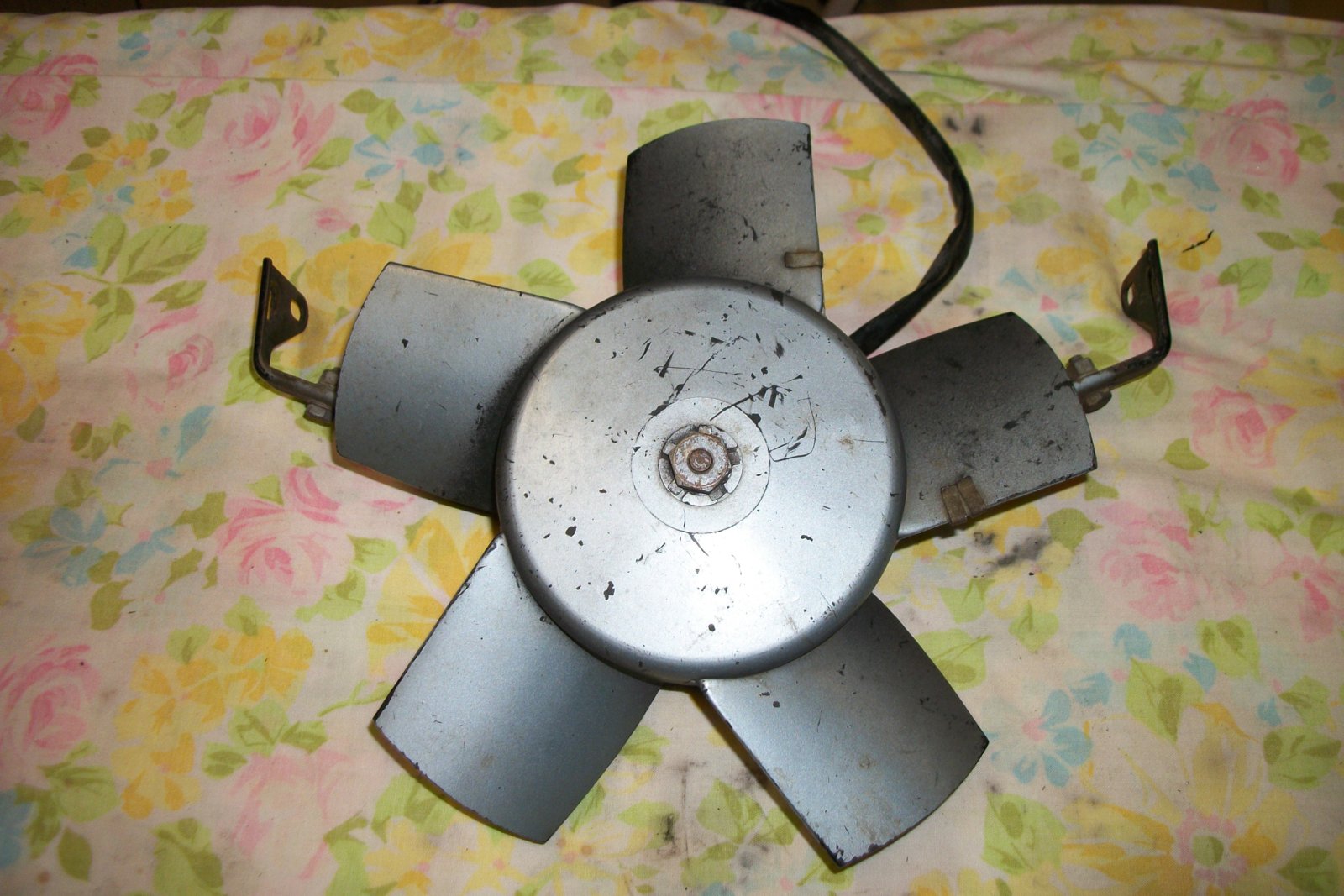

Our 2800cs is all apart for restoration. We installed AC from a donor car many years ago. The condenser fan we used is the one that came off the 72 donor car. It is the one with the frame around it. We have another one which seems to have the same fan but with a different way of mounting. Seem like the one with out the housing surround might be a better way to go but no sure how it gets installed. Could it be from a E3 as we did have a system from a E3 for parts.

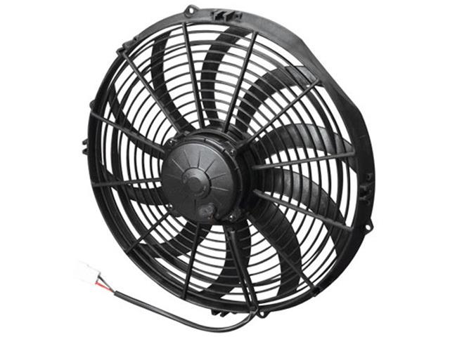

We are also considering using a spal type fan attached directly to our new parallel flow condenser, but are not 100% convinced they are any better in pushing the air.

Comments and where did the the sencon fan come from and how does it mount?

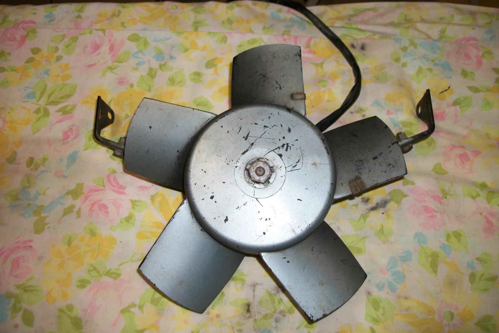

Thanks for all the replies and we are pretty sure going to stay with stock fan, but which one?
Those of you who are running the stock fan, is your fan the first photo with the shroud around it and the large brackets?
Or is it the 2nd fan with just two arms coming out.
The Blue book covers the installation of AC in non AC cars and it shows installing the 2nd fan, but not clear what brackets it attaches. Seem like the 2nd fan might be better because of less brackets to impede the air flow, OR is the shroud around the first fan actually a help.
Any answers?

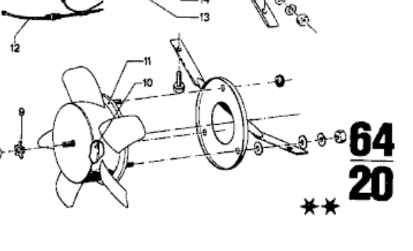

Our 71 2800CS has a condenser fan mounted in front of the condenser. You might look through this section.
The shroud is the latter version. Improved!!!!
Junk.

Are you saying the fan with the shroud is improved!!! but is Junk? Or are you saying the fan without the shroud is Junk? and the fuirst one is okay?
Thanks a confused
