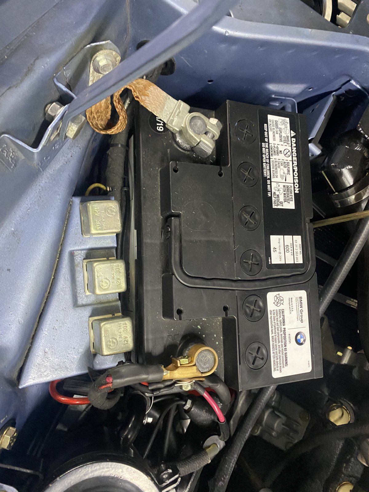

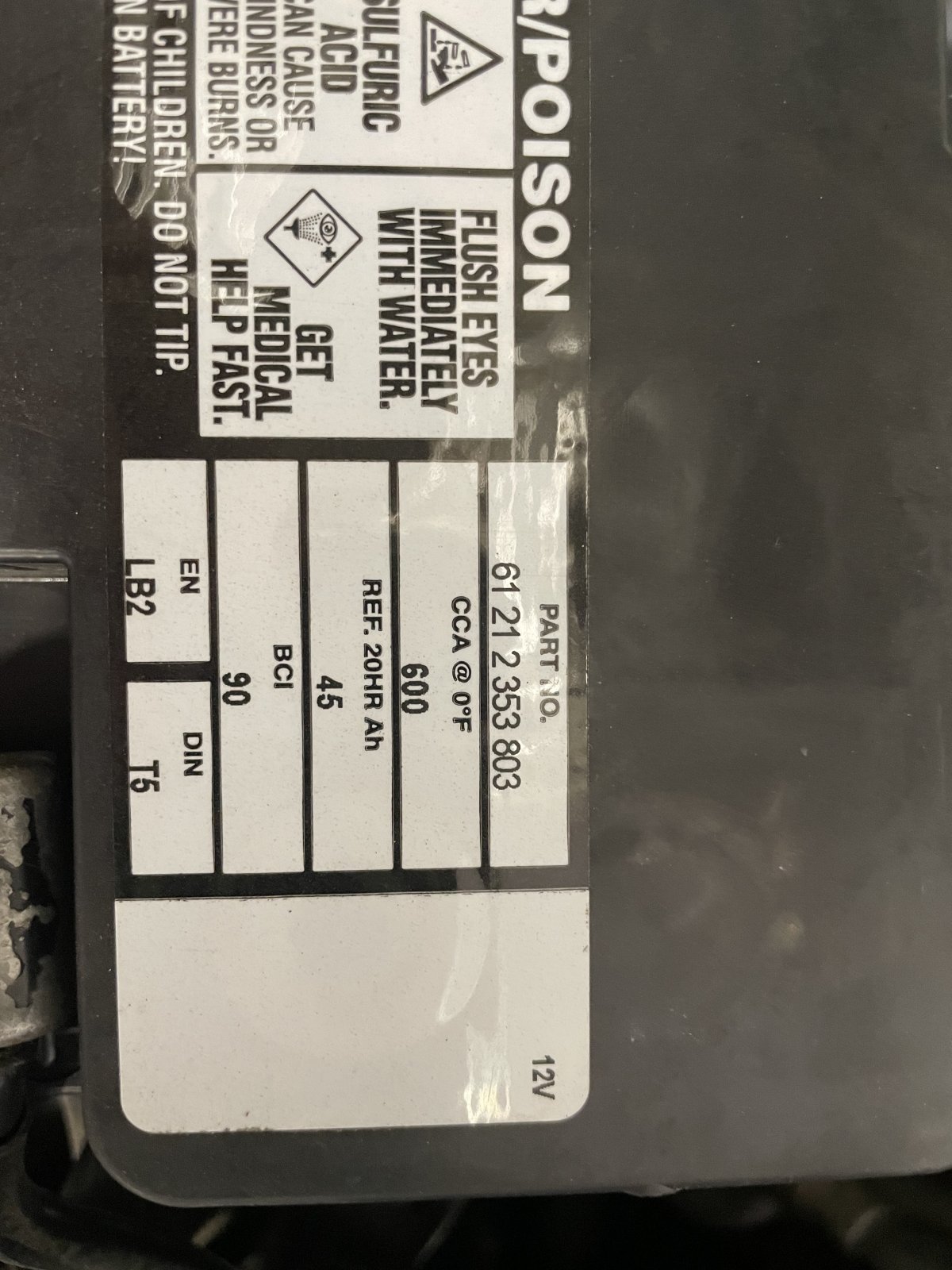

Ordered 61 21 2 353 803 from BMW of Beverly Hills. $145 list. Supposedly it is a rebadged East Penn battery. 45 Amp Hour 600 CCA. (Previously wrote 50 Amp Hour as one of the internet sites had it written as such)

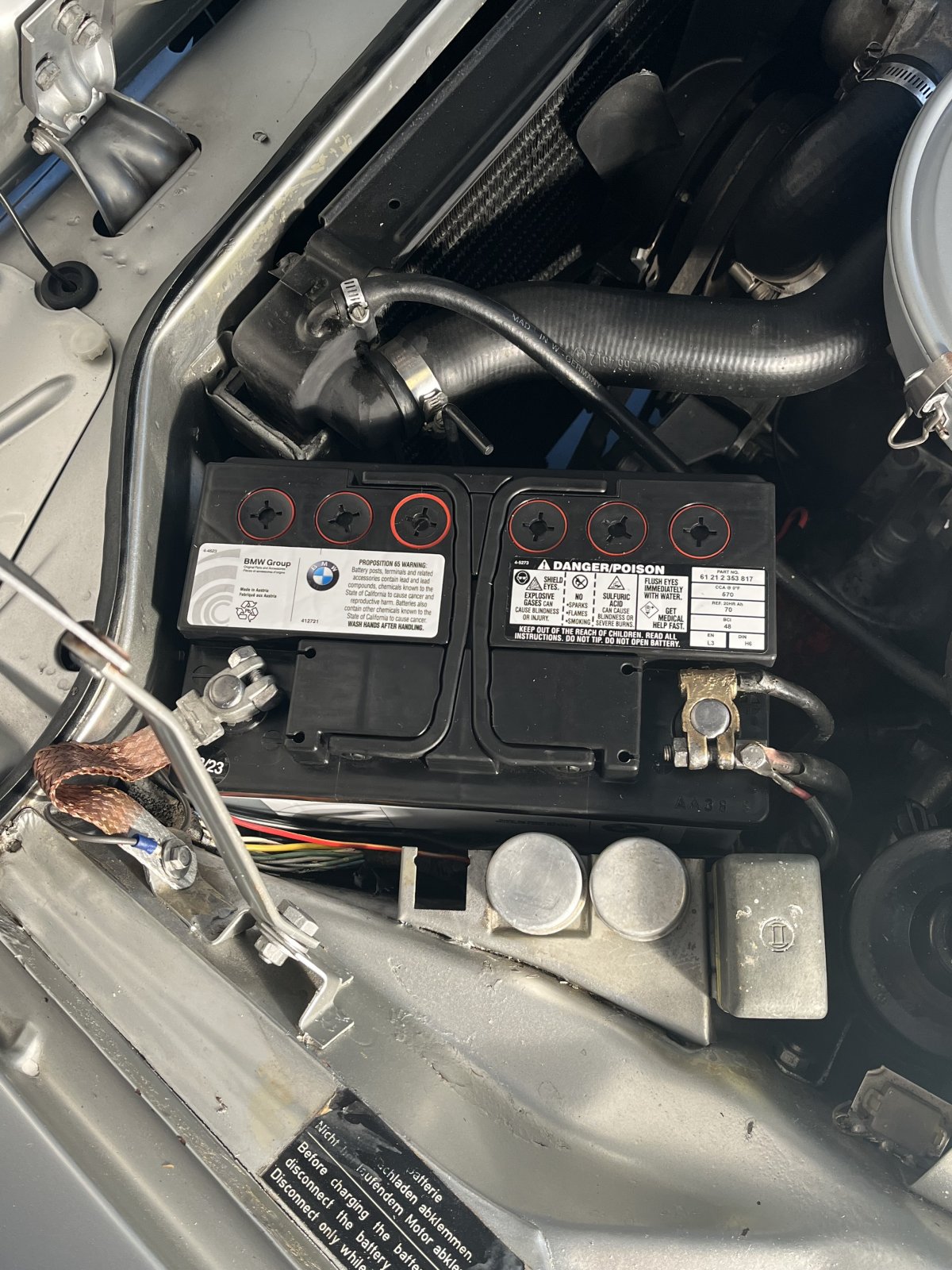

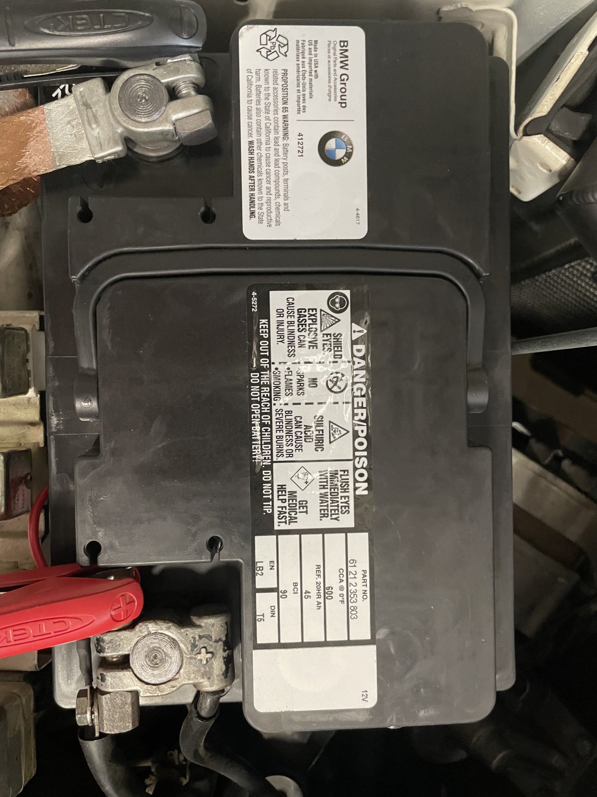

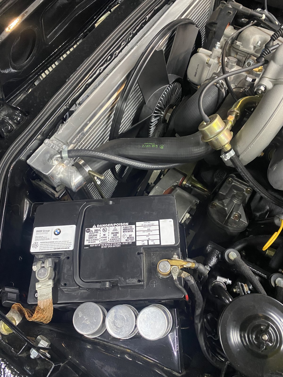

Here’s the one I got from SFDon. Part number ends in 803.
I bought a white one April 2020, 61 21 2 353 817 at a Mini dealer I think. You have to Dremel off one of the feet on the short side as it is a bit long. The battery ending in 803 fits and is Black. I think the white battery came along later perhaps and was made by Varta. BMW has switched battery suppliers many, many times.

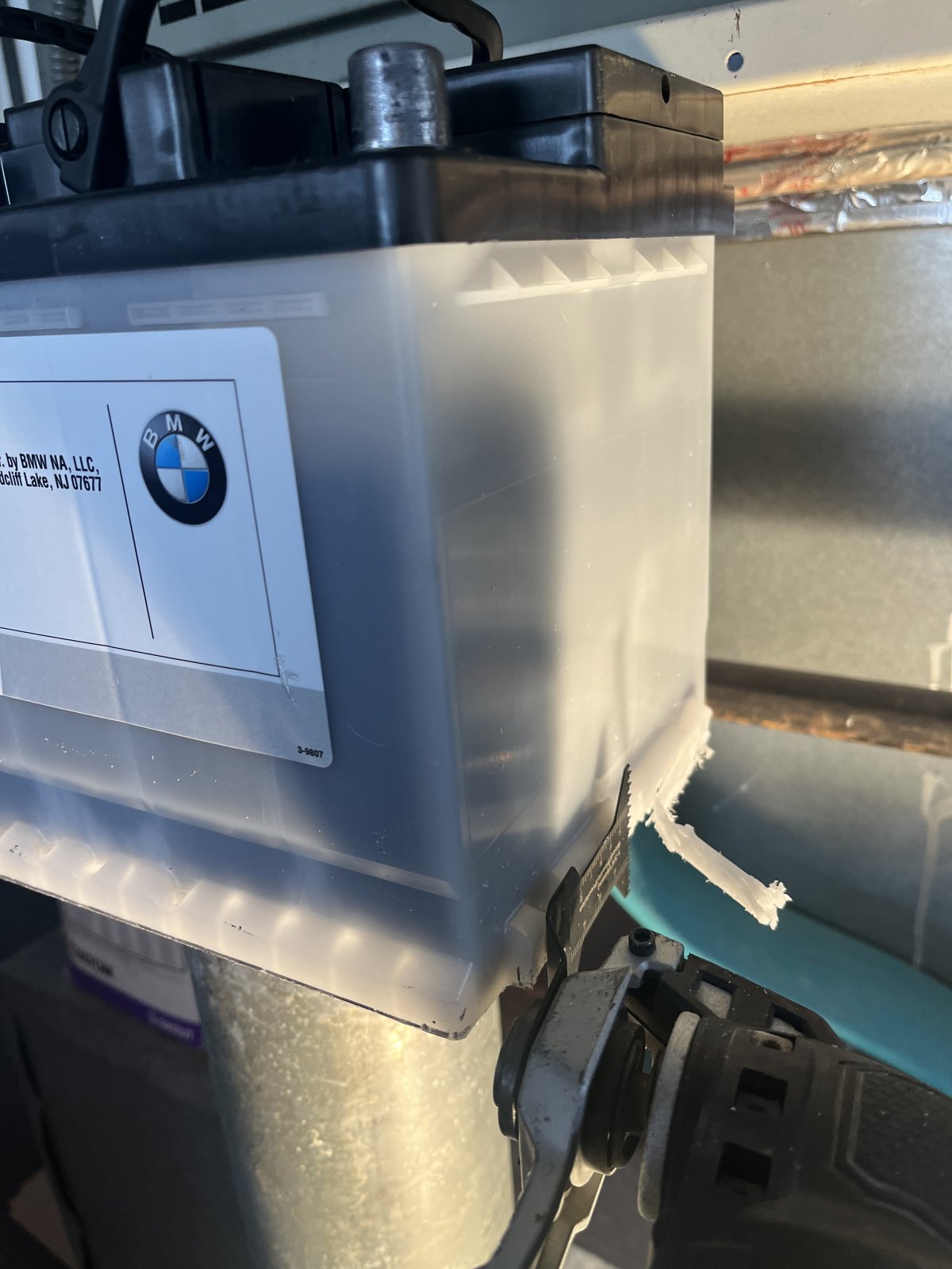

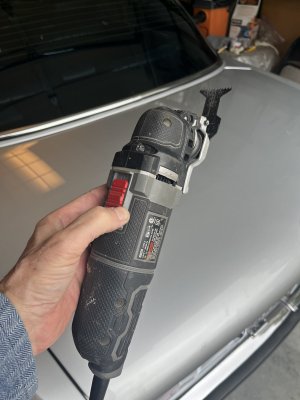

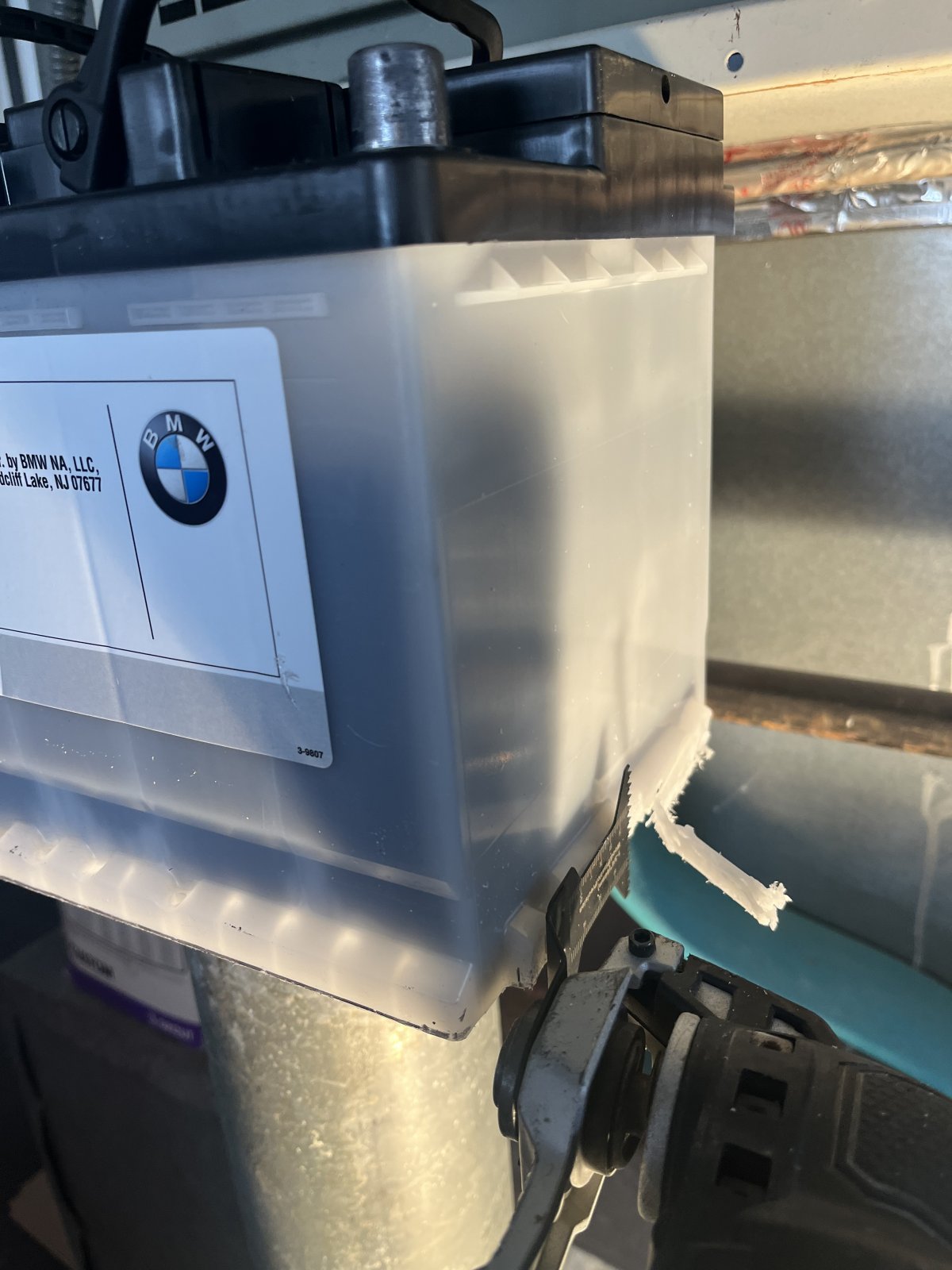

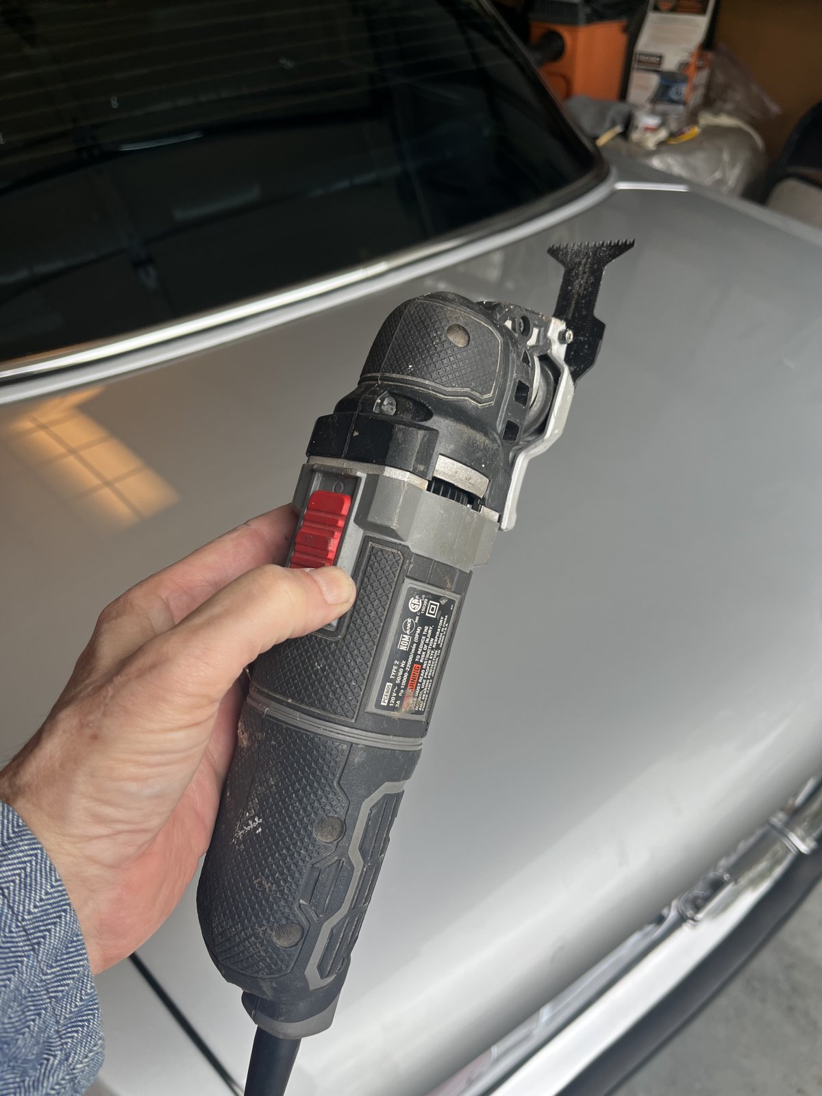

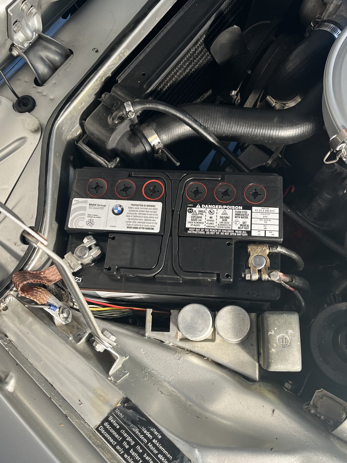

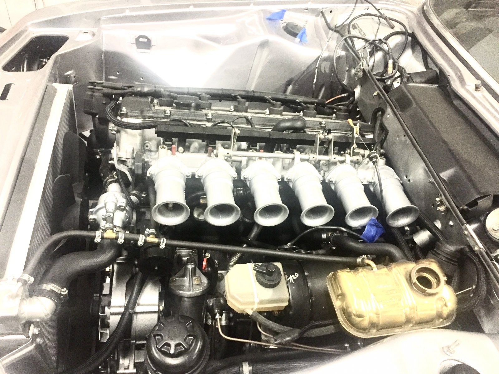

UPDATE- , thank you to Chris and Terry for helping me with this project. The current BMW/Mini Battery you want is 61 21 2 353 817. I paid $177.90, I asked for a discount and Peter Pan BMW, Burlingame gave me a 10% discount. The battery just a little too big and Chris recommended to Dremel the foot off the long side. I found the Multi tool* worked far better and I was easily able to saw off the foot of the battery making a perfect fit
*on a side note if you do not have a multi tool. My brother in law, the contractor bought me one, and it is life altering, I use is ALL the time. Used it yesterday to fix a fence

Why not just buy the battery that fits?
Where we going with this? Why do you need a Dremel to modify the wrong part?
