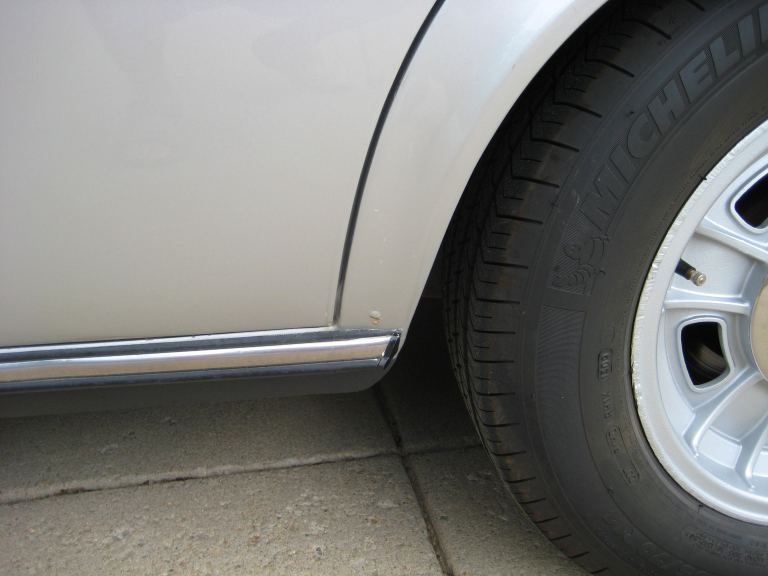

Found this on Craigslist. The car is outside of Denver (Lafayette, CO). I'm in Sacramento, CA. I was very interested until I got some additional pics of rust in rear wheel wells and near back bumper.
http://denver.craigslist.org/cto/3871429537.html
1. I know you can't tell much from a picture, but...what do you think about the rust and possible repair? Owner says car is otherwise rust-free?
2. Anyone in the Denver area want to look at it and report?
I can get a pre-purchase inspection from a reputable shop in Lafayette, but I'd hate to plunk down the $265 just to be told what could be obvious.
The car is an old restoration, but looks decent. Any help (even if just gut reactions) is appreciated. Owner seems like a straight-shooter, but this rust seems a little ominous. Thank you. Brian

Bavarias are a great deal. I'd only buy a rust free one. It will be the one that holds it's value and is easy to sell down the road .That one could look a lot worse in 5 years and they are not cost effective to do a proper body restoration on.

The rust is in the usual spots. Need to pick up the rugs and look at the floors, trunk around the gas tank (sponge gasket holds water, tank may rust enough to hold gas but allow fumes out), shock towers, all wheel wells, bottom of doors. These cars are much like the E24 where they rust.
For an E3 is it a bit costly with that rust but given its upgrades, 4500 would be fair. Adjust as you discover more rust. Frankly, these cars are getting more rare and are fun to drive.

If it was updated with a 3.5L engine, then they had to pull the head off the 3.5 to install the cam from an earlier engine, as I can see in the pic of the engine compartment that there is a distributor on the front of the engine!. 3.5's came with motronic!
Also, If I was going to brag about a paint job, then the rust would be a major worry as where else is it? Almost all E3's have some rust along the bottom of each door and the front ends of the hood due to water pooling! This one probably has it also, but under that wonderful paint job!

That could be some pretty decent rocker rust in pic no.4.
No one can say unless it's seen in person by someone who knows what to look for. If I lived in CA, I'd wait for something truly local and dry to turn up. They are out there...
