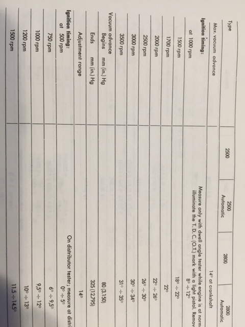

the distributer markings on the side and report back which one of possible 6 distributers that I know of. The end numbers are what I look for- 001 or 005 which equals an advance curve and they aren't the same. There were euro, US, emissions, etc. So they aren't all the same if we're going to get downright picky.
Vacuum advance can range 8-12 degrees. So being 4 degrees off is with BMW's written program. ( I can't believe I said that.) Disconnect the vacuum, hook up your light and check the movement in the timing window is a good gut check.
But if you have a vacuum pump like a Mightvac, you can actually check advance by the amount of vacuum applied. 115hg start to 280 stop would tell you if you can guage the crank/ flywheel movement. ( Timing tape, flywheel teeth, etc.) That's how the factory did it.
You can do it by rpm but first you have to be certain which model distributer is in the car.
My bluebook has the program tests in the front. It's missing on the registry website. 25 pages I think with all the technical information on tune up.

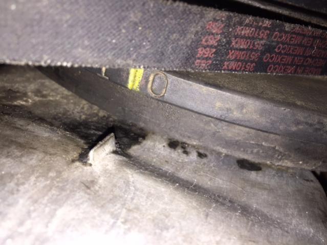

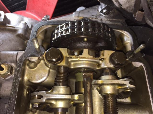

Checking cam timing. Pulled off valve cover. Pointer on timing cover on OTmark,
flywheel window has OT ball showing. #1 valves closed, TDC right? Indent on cam sprocket is at about 5 o'clock instead of 12 o'clock as shown in picture. Can this be right or did I screw something up. Can't believe it could be this far off and run at all. Thoughts?

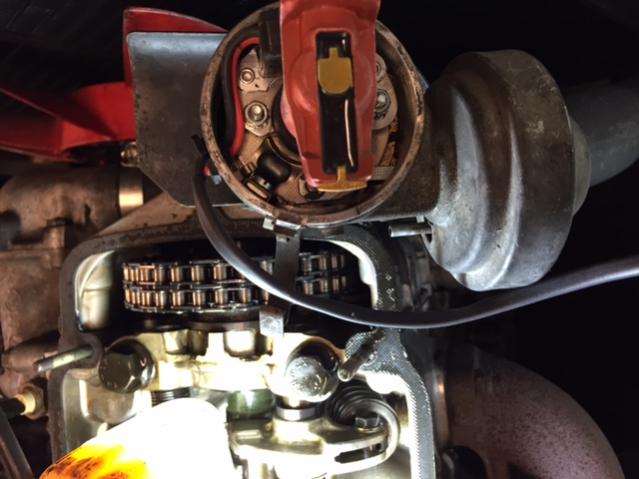

your distributer cap and see if the rotor is pointing at a scribe mark on the rim of the distributer body.
Cam wheel bolt lines up with center of boss. Unless you indexed the cam and know for vey certain what that mark means.

Looks like TDC, but yes check your rotor position on the distributor, should point to the scribe mark like 61P says. About 8 o'clock or so:

I get the cam timing now. I was thinking the ref point on the sprocket flange was the unthreaded indent not the bolt hole so I guess that looks fine.
The rotor is more at 9 o'clock, a ways beyond the scribe mark. I went ahead and pulled the distributor and disassembled it. Nothing looked completely out of order. The moveable plate that the points mount to didn't move super freely. I cleaned and lubed it and seems smooth now. Weights and springs seem OK. That thin fiber gasket piece under the weights is broken. Any ideas on what to use to replace this that is readily available. I saw DeQuincy used a circuit board but I have no idea where I would get one so thin. Is there a good reason to take the drive gear off. Seems to spin freely and has no play so I'm hesitant to drive the pin out since I don't have a replacement.
Vacuum advance unit seems to work. I don't have a mighty vac but it seems to move and hold vacuum just with human suction. Hmmm.
Dist is a 0231162002

Move the distributer to where the factory says. Your off. Make sure number 1 on the cap and the wires are not one off too.
002 is the right one for a stock engine. Vacuum off- all in advance is 31-35 deg. at 3500 rpm. When you connect it again at say 1000 rpm it should move timing 10-16 degrees. ( Low side/ high side) if you're off more than that something's wrong.
