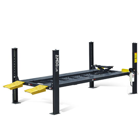

Not in the UK, but a 4 post lift is a nice addition if you have the height. I used to regularly use a 4 post lift to work on my cars in the maintenance shop at my work. Having front and back lifting bridges allows you to raise the suspension off the ramps and is very helpful for suspension and brake work.
Also - I am not in Ireland (or Europe for that matter) but I do have experience with both 2 post 'workshop' lifts and a 4 post 'storage' lift in my garage/shop. While I do appreciate the utility of the 2 post lift for actually working on cars, I do not ever store one on it.... I have my Mustang currently on my 4 post with my E9 underneath. The 4 post (where you drive on two ramps) and then lift is much more stable IMO over whatever ills may happen with the car 6' up in the air.
