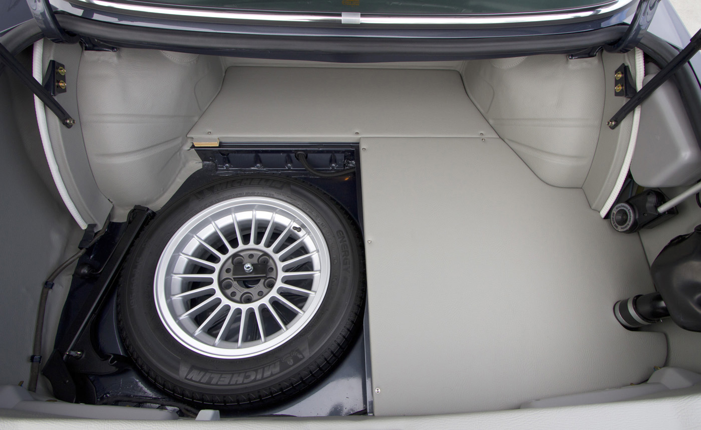

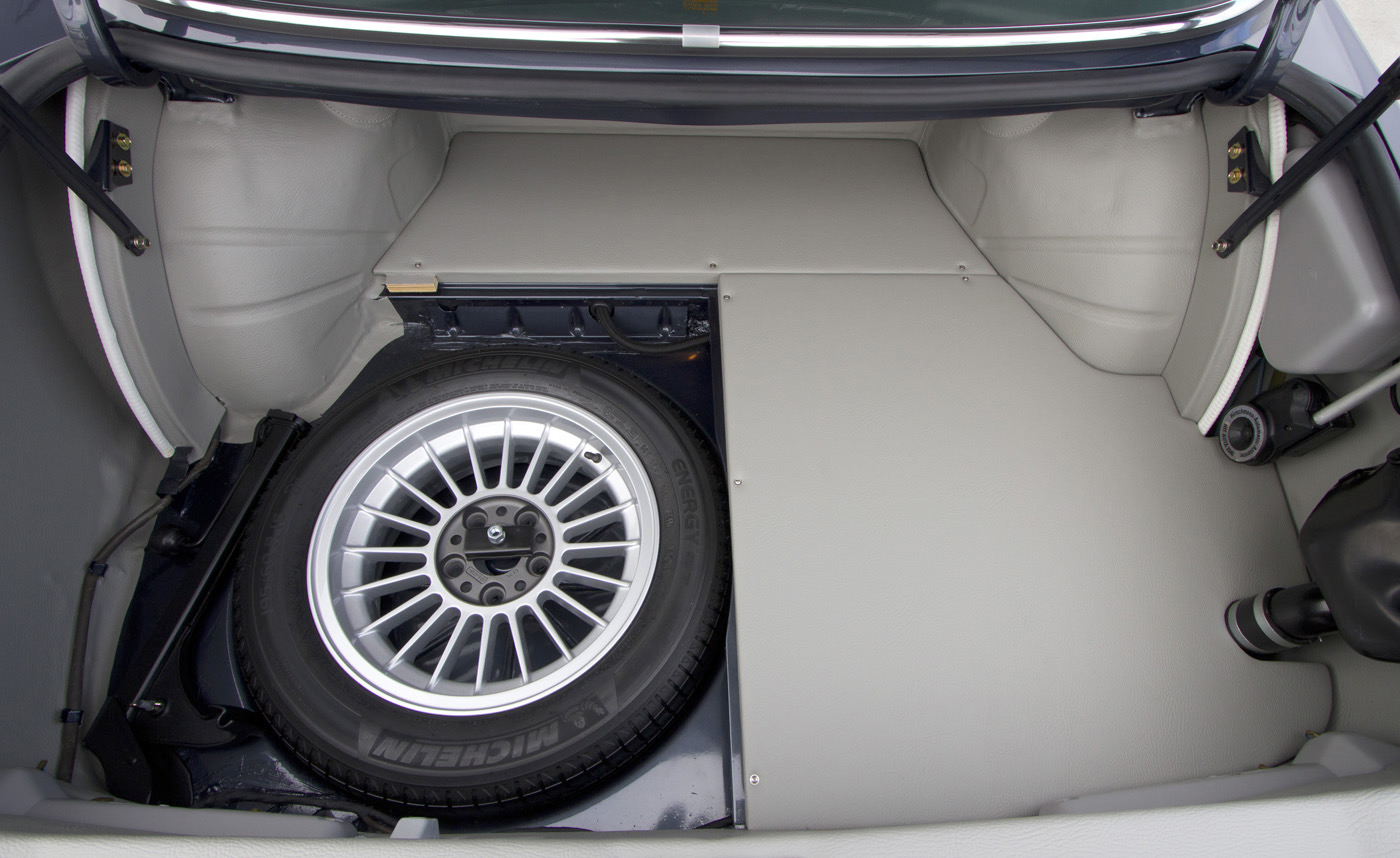

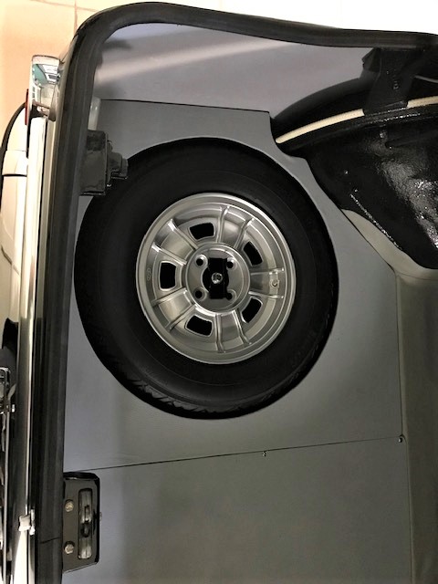

What size spare fits in the trunk / boot
Do I remember that the e24 well is an inch deeper?, or did I dream that? I bought one, cut from an e24, and sold it with another e9 a couple of years back (it went with the car), and I didn't ever check the validity of the claim. And I've slept since then...
i think that is correct Dave. i think some people have used it to deepen the coupe spare tire well.
You slept well? What if the deeper one was used to fit a well known Saudi journalist out of their Turkish embassy?

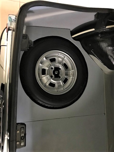

I just use the original 14” wheel with a tire that provides the same circumference as the 16” wheels.
I have done the same thing but there are two other alternatives. First, there are thin space saving spares that have worked in the past. I recall seeing an E9 using such a space saver on a front axle. I also observed this on an E9 being prepped for paint. The examples were likely from a Mercedes, but that is just a guess. Obviously, the bolt pattern has to be correct and equally important, the rim must have enough area to clear the brake calipers. The second alternative is my least favorite, but I recall watching someone deflating his spare tire trying to gain enough space for the trunk board covering the spare. I inquired what he was trying to accomplish and he explained that the spare fit when slightly deflated, and that he carried a 12V mini-compressor when and if the spare was needed.
Portable-Mini-Air-Compressor-Electric-Tire-Pump-12-Volt-Car-12V-PSI-Mini-Air-Compressor-Electric.jpg
here is an 8x16 alpina that I had cut down to 6x16. You could use a 6.5” wheel with a narrow tire. You’ll just have to raise the floor boards a 1/2” and adjust the size to fill in the gaps at the fenders.

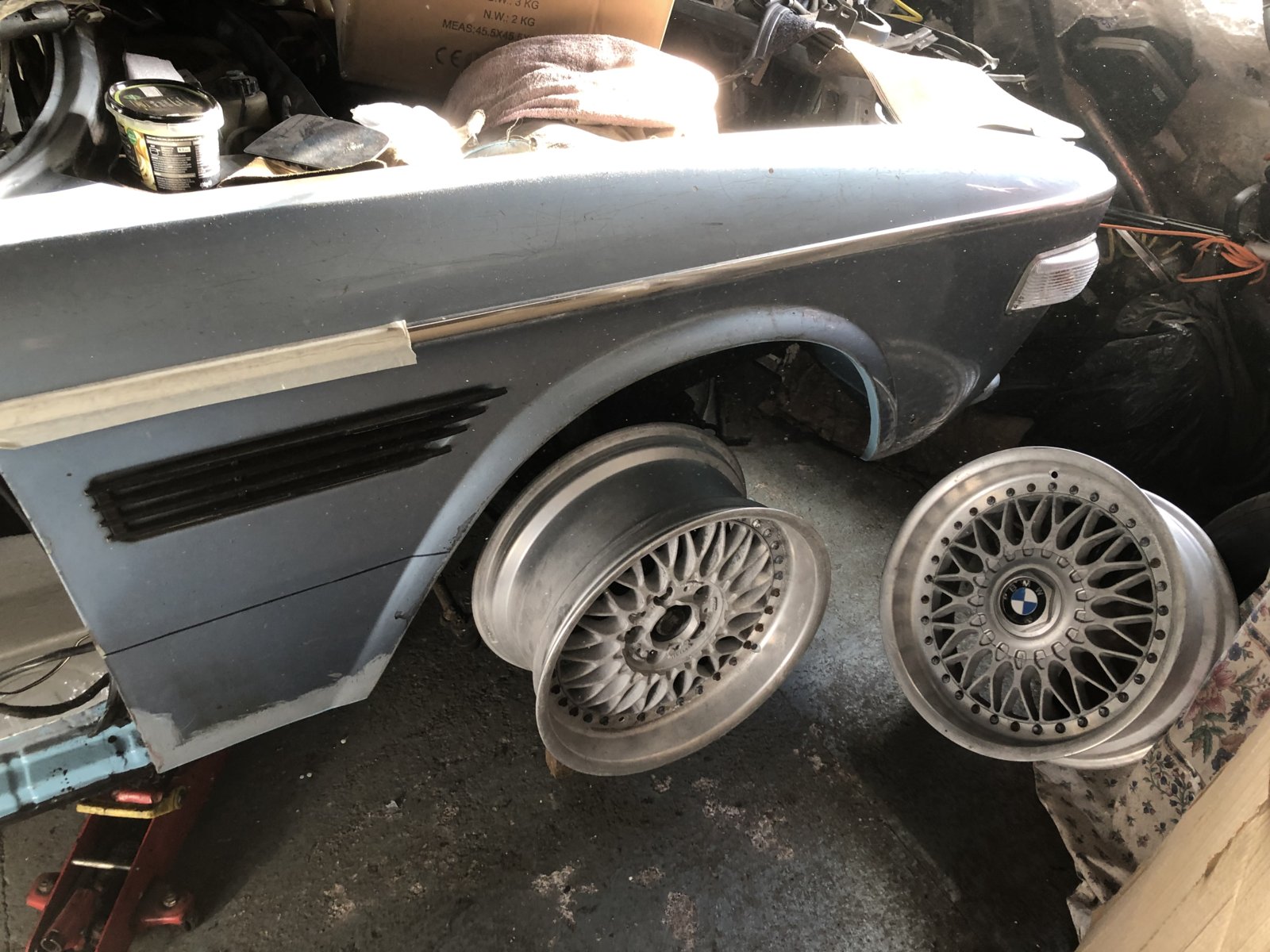

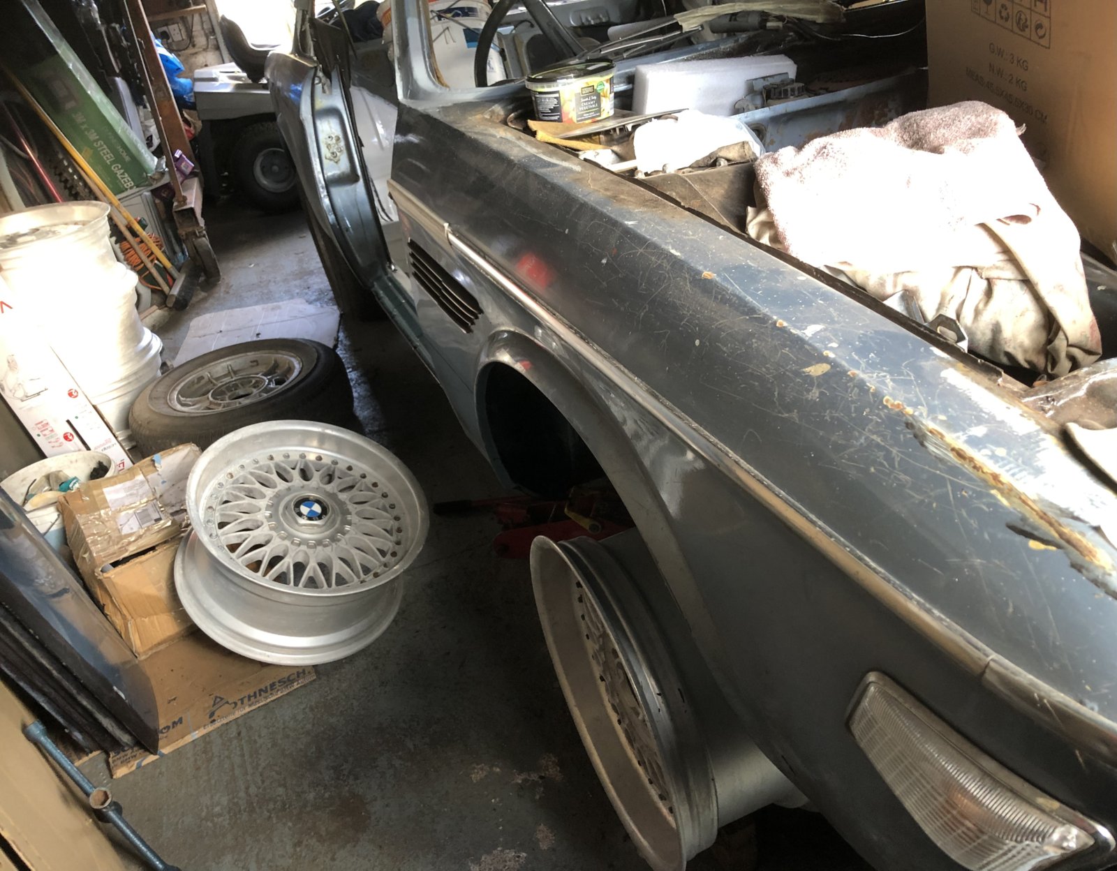

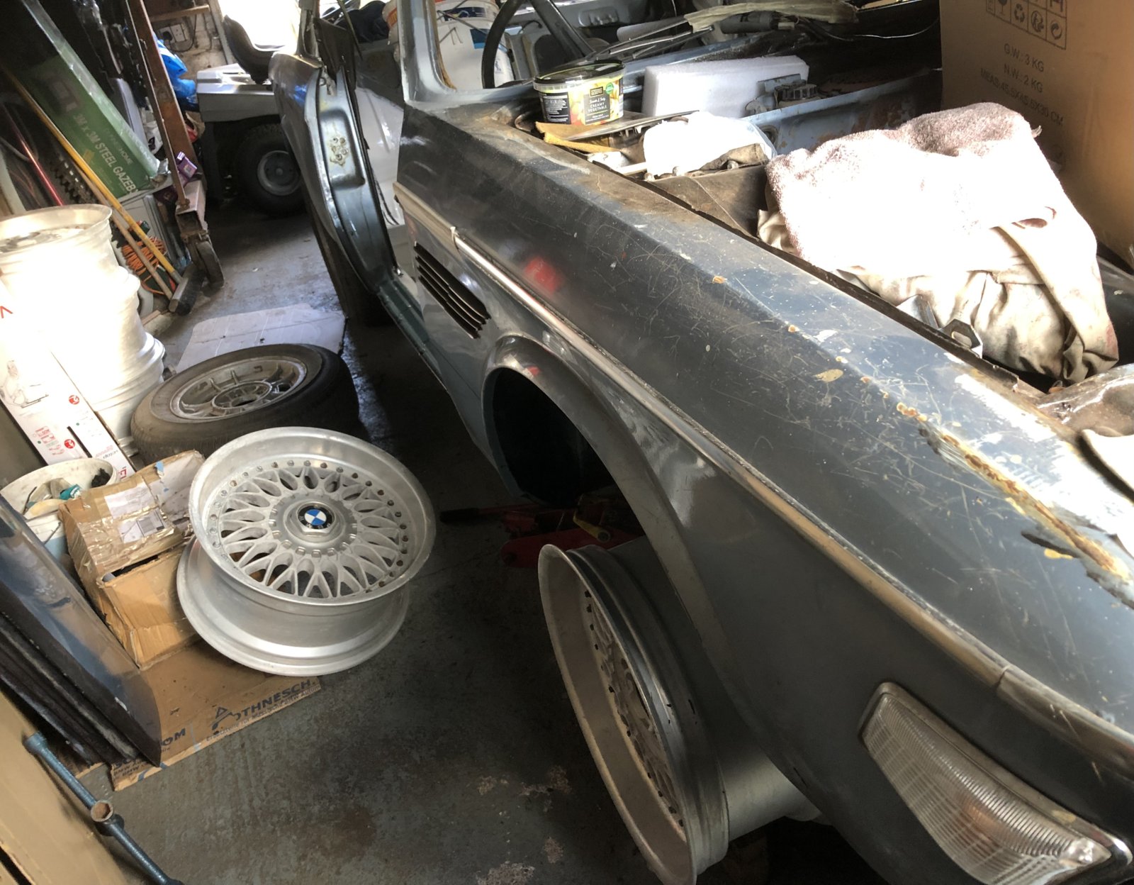

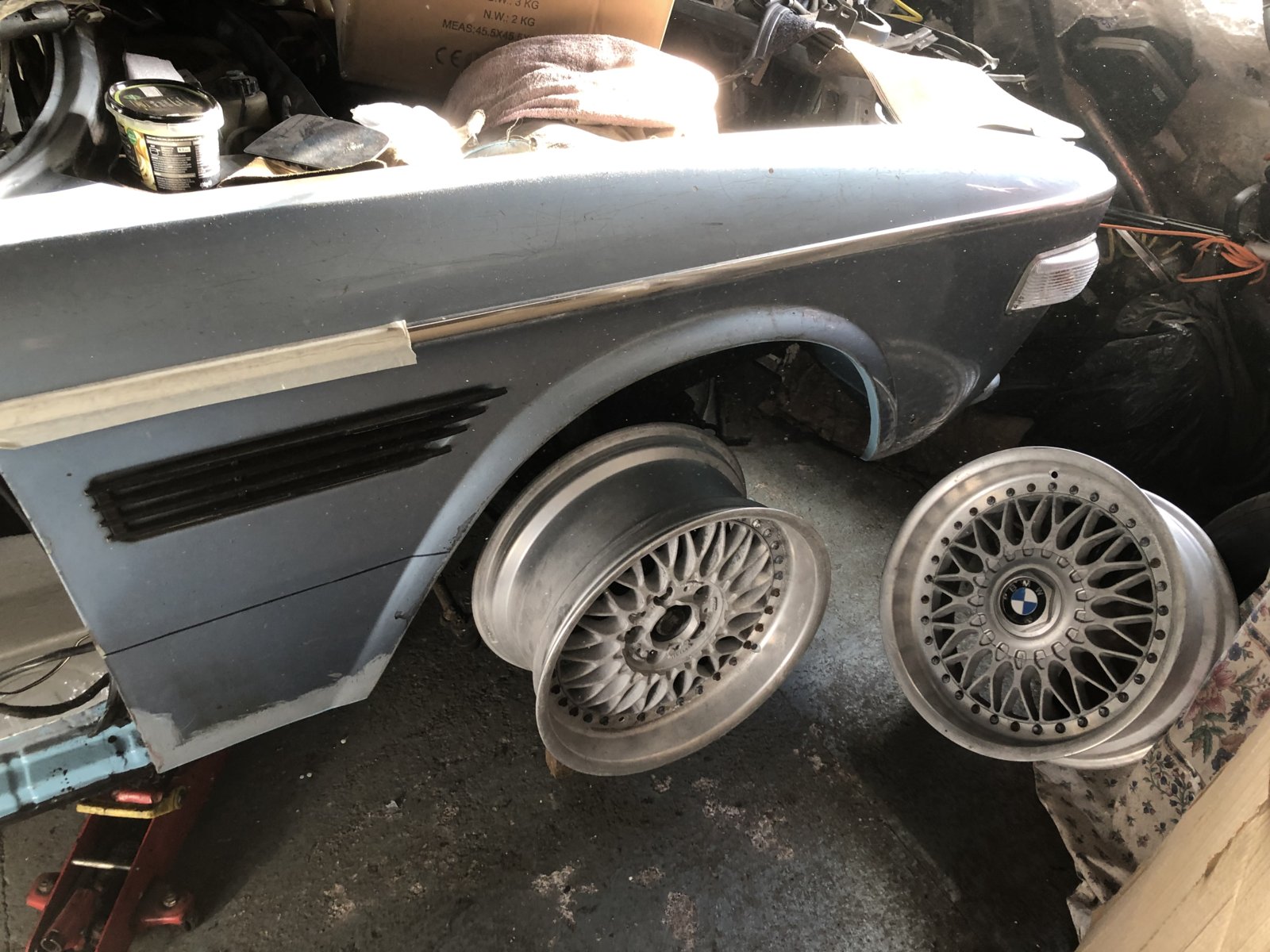

Hello, do you know what size of tire will feed on 16X9.5" wheel
Hi , my bbs rc090’ s are 17”x 8 and they apparently need 225 45 17 on the front and apparently can have 245 40 17 on the rear.
I have not yet fitted them with tyres yet so I have not actually fitted them to the car yet.
Yours are obviously wider than mine.@. 9.5” so honestly I am not even sure yours will fit , ( for you I hope they do )

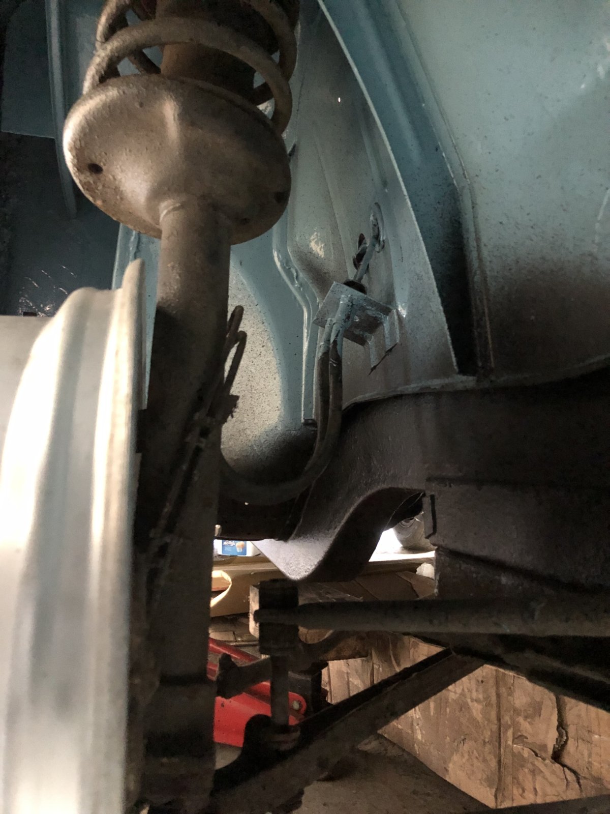

My rim on the inside without any spacers misses the front shock by approximately 6 mm, and I might need to roll the wing / fender lip on the outside, I will know more about that when I actually fit them onto the car.
At the rear , I believe clearance is good also , except you need to be careful as the inside of the tyre can foul / rub against the exhaust muffler/ silencer . ( which is obviously a no no !! )
Good luck, and let us know how you get on !

Hi , my bbs rc090’ s are 16” x 8 and they apparently need 225 45 16 on the front and apparently can have 245 40 16 on the rear.

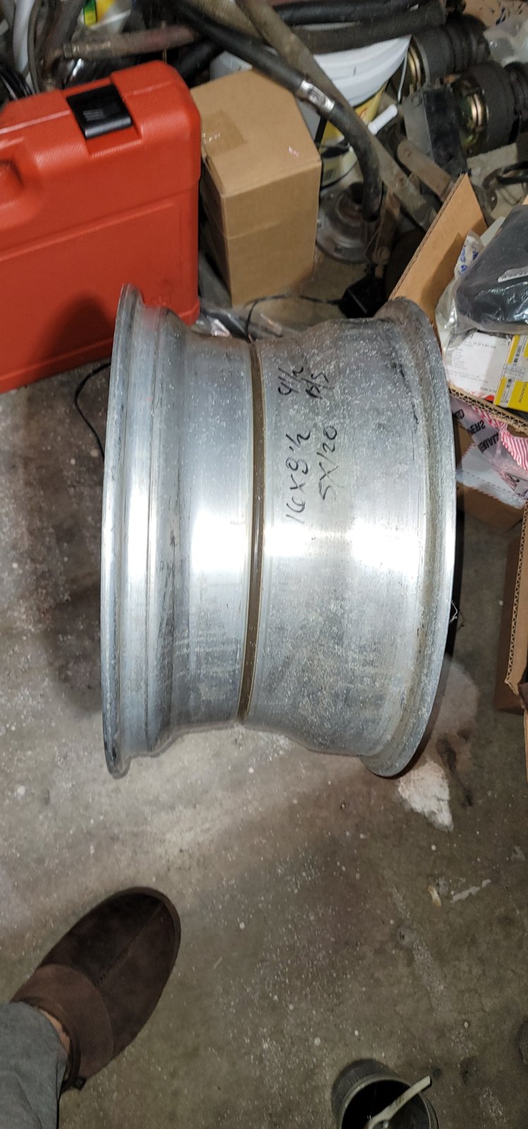

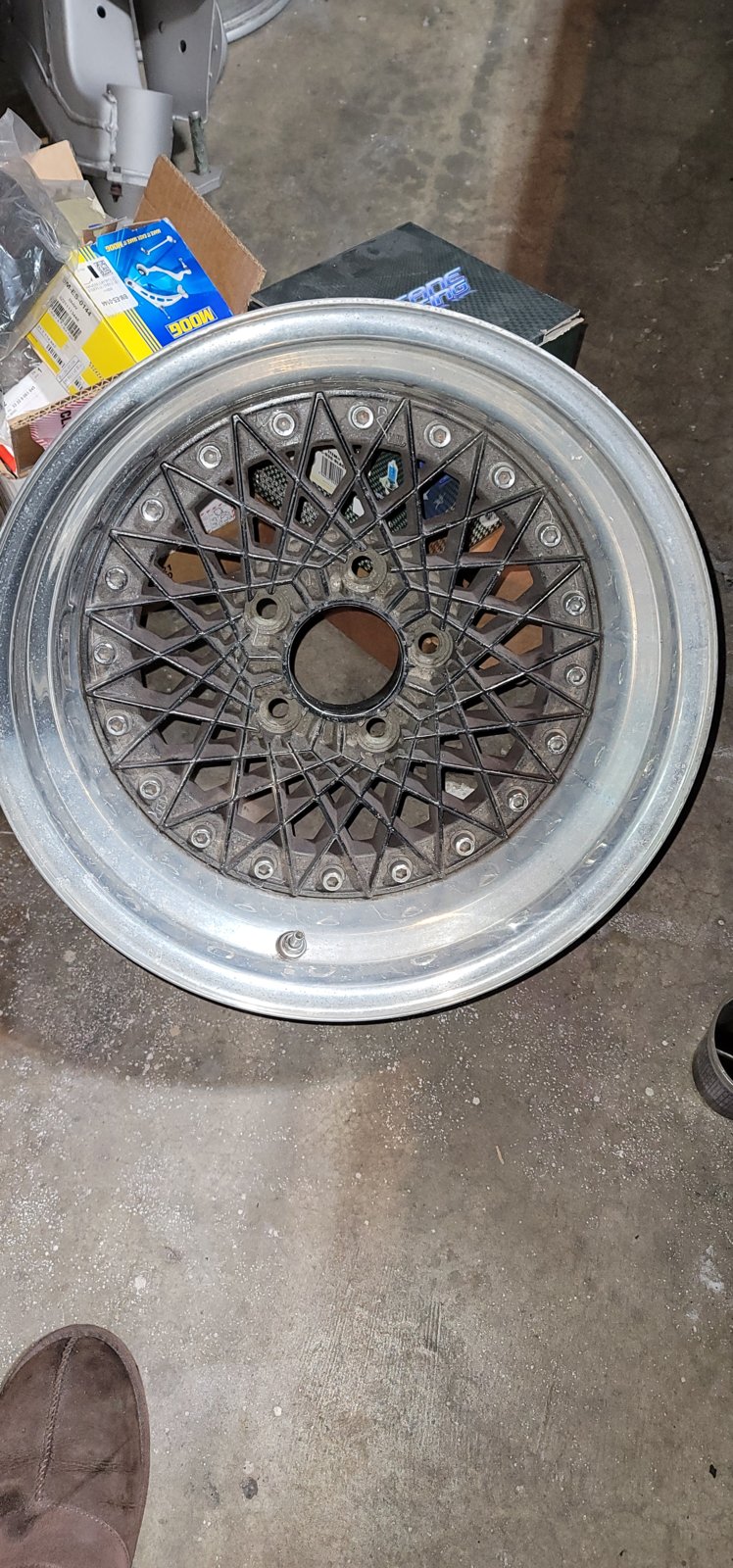

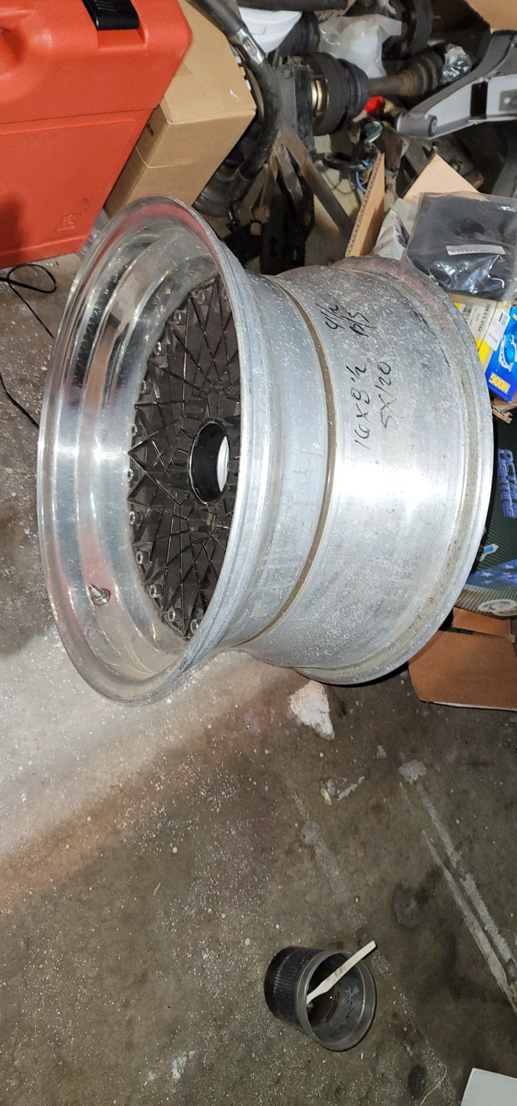

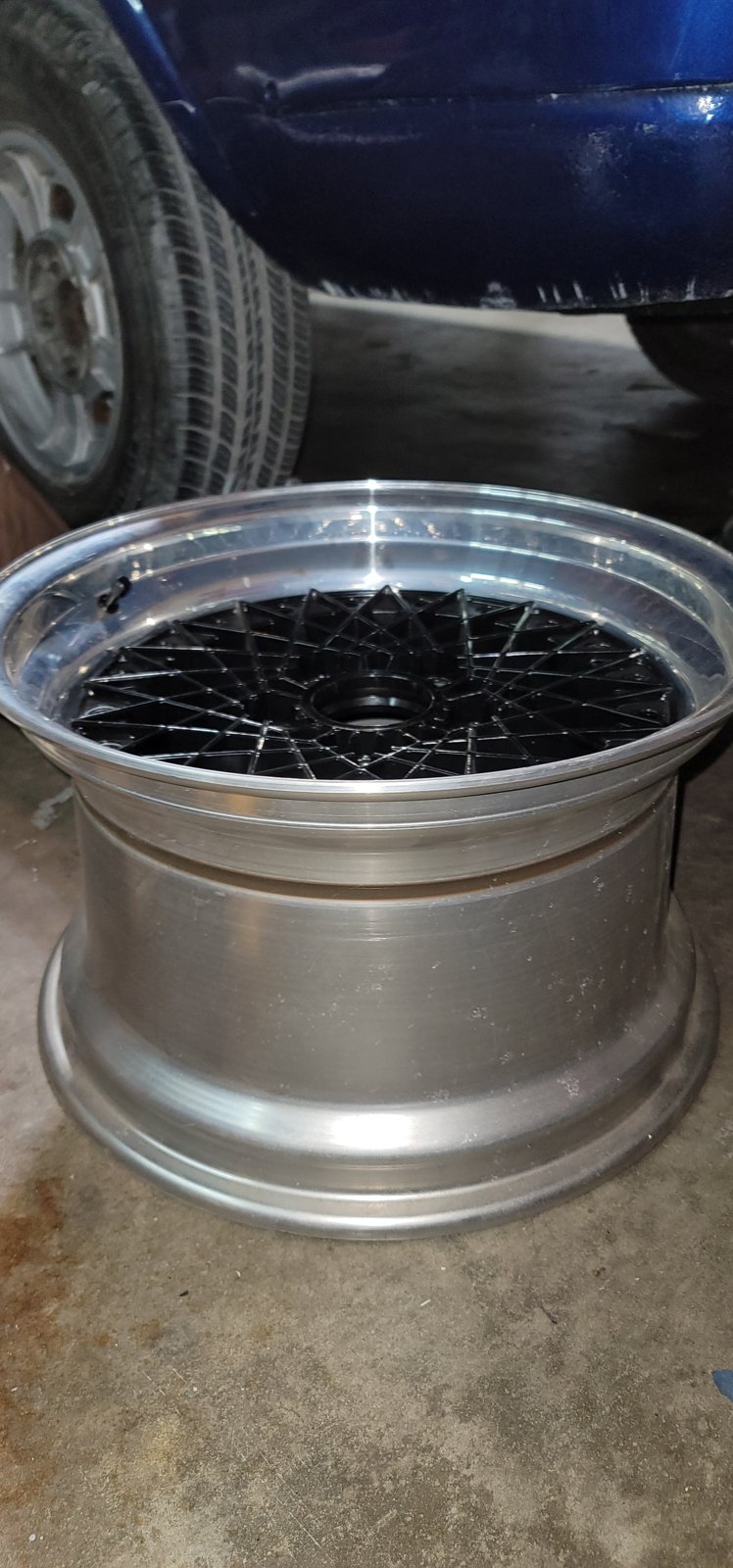

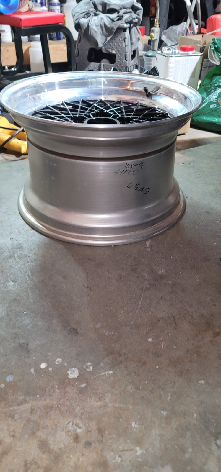

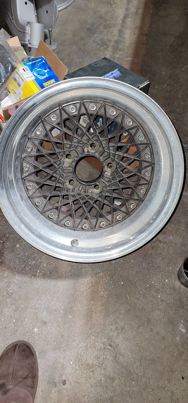

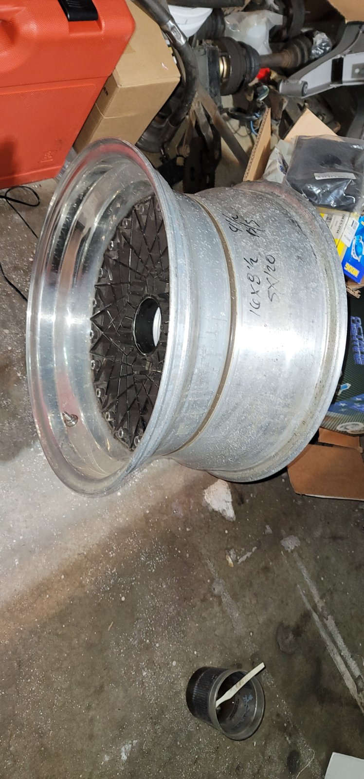

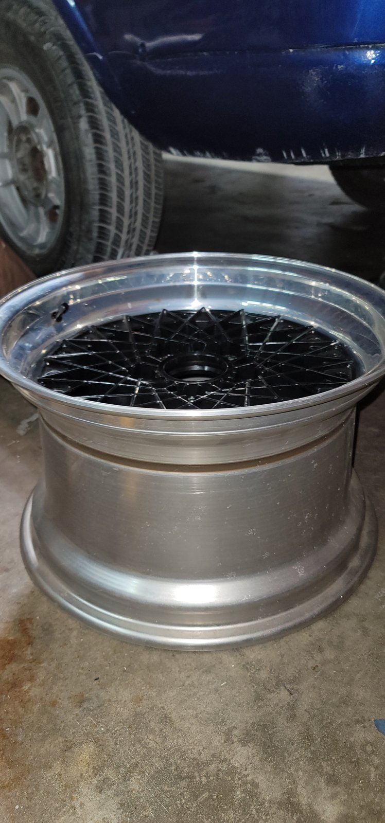

Hello my friend thank you for sharing your experience with me please when you fit it under the car take a picture and send it to me and the wheel are 3 peace wheel I can change the wheel leap with back wheel and make the front 8" and back 10" what do you think is it better or I am screwed any way $2400 wasted

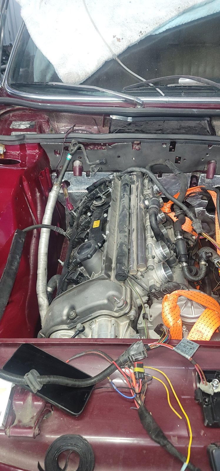

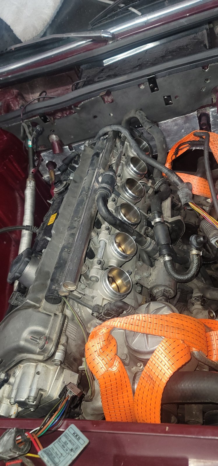

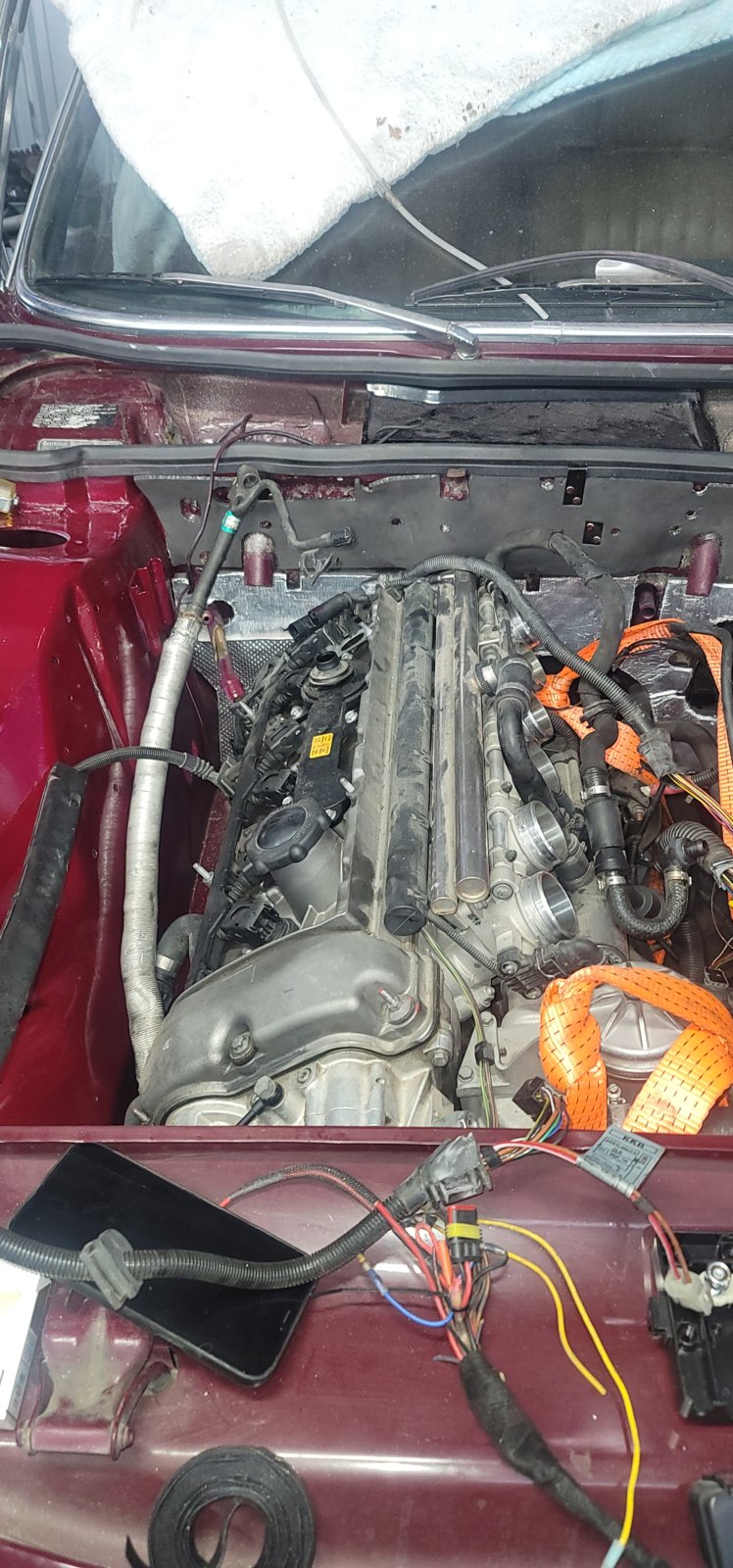

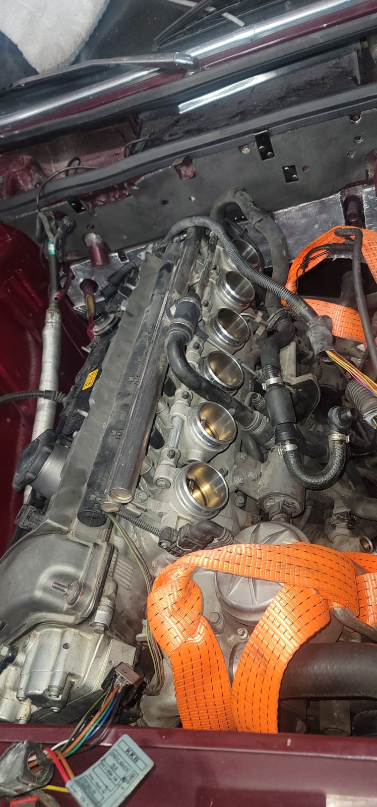

I am having 2006 M3 engine on the car and today we could put the engine on the engine bay have not started yet.

@Candia4441 who’s doing the work?
there is a guy near me he is a professional race car driver and he have many toys in his shop and his shop is not open to public when I was introduced to him it happen to have a free time and was his idea to do this, I wanted to repair its original engine but he told me if I do this he have a free time and he will do it for me and we started, we manage to put the engine in engine bay today and I am very exited to complete the car and drive it
I was going to rebuild the engine and sale the car but now I will keep this one and sale the blue E9 that I rebuild and upgrade the original engine with 3 weber that will have lots of power but now I am thinking to put it for sale after I complete the M3/E9
i may be wrong, perhaps BBS made more sizes that i am aware of, but my understanding was that bbs rc090's were 17" wheels. they were available as 8" and 9". 9" are very rare.
Hello my friend, my wheels are not a BBS it is Epsilon 16X8.5 and 16X9.5 and it is 3 pieces and I can play with it like I can make the front one 8" and back 10" just change the lip with one another cense one is deeper than other if 8.5 is to wide for front I can make it 8" but I dont know if 10" will work with back
Okay , I have to hold my hands up .
Mine are 17” not 16” you are correct.
I will edit what I posted yesterday, in case I confuse people incorrectly.
Thanks for letting me know !!
