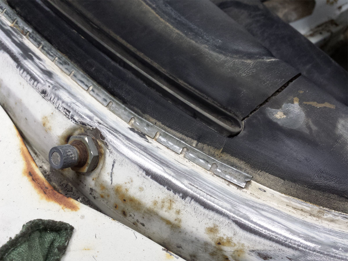

Also, the headliner was attached using small metal clips, an attachment method I've never seen before. I was having some water leak issues around both seals and wonder if these have anything to do with it. Should I remove them?

Finally, some of the headliner seems excessively over-wrapped. Back to the water leak issue, should I trim these down?

To your original question, the headliner and black vinyl should not cover that edge. The edge should only be covered by the windshield rubber. The metal clips are not supposed to be there.

I personally don't believe that this statement is correct. I think that the overlapping vinyl as well as the metal clips are factory. I encourage others to chime in on the subject. I wish I had more pics, but both the pillar vinyl as well as the roof vinyl overlapped the windshield frame. I've seen many examples of people using binder clips on the windshield frame, including @Gransin. I have also had a conversation with @Roger S about the vinyl spring clips on his car.

I think you are actually right Markos. And that im wrong on this. It was just how it was in my car, which i believed was factory condition, but i was wrong. I just read some other threads (I'm trying to figure out how to remove my the headliner) and they all showed me i was wrong in this.
Which also means that I cannot just put everything back the way i found it, it might be incorrect. i have to start digging...

Well, just for fun I looked in the parts books. E3 and 2002 use four of these clips, there is no clip in the e9 book.
Does the 2002 book have the long clips? I honestly can't recall what my CSI had, but I did have a conversation with Roger about them. He described them more like what is seen below. I specifically recall *not remembering the clips and having him describe them. 2002FAQ seems to suggest that they changed over time. Perhaps they disappeared in the production run.
2002:
E9 (@bimmerboy73):
2002s definitely changed with those strips. The parts book showed four small clips only and that part didn’t apply to e9. The e9 book shows nothing that I could find.
