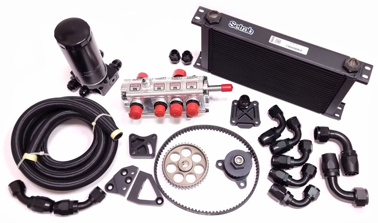

Schaper Automotive, a German firm that makes a dry sump kit for the M30 & S38 motors:

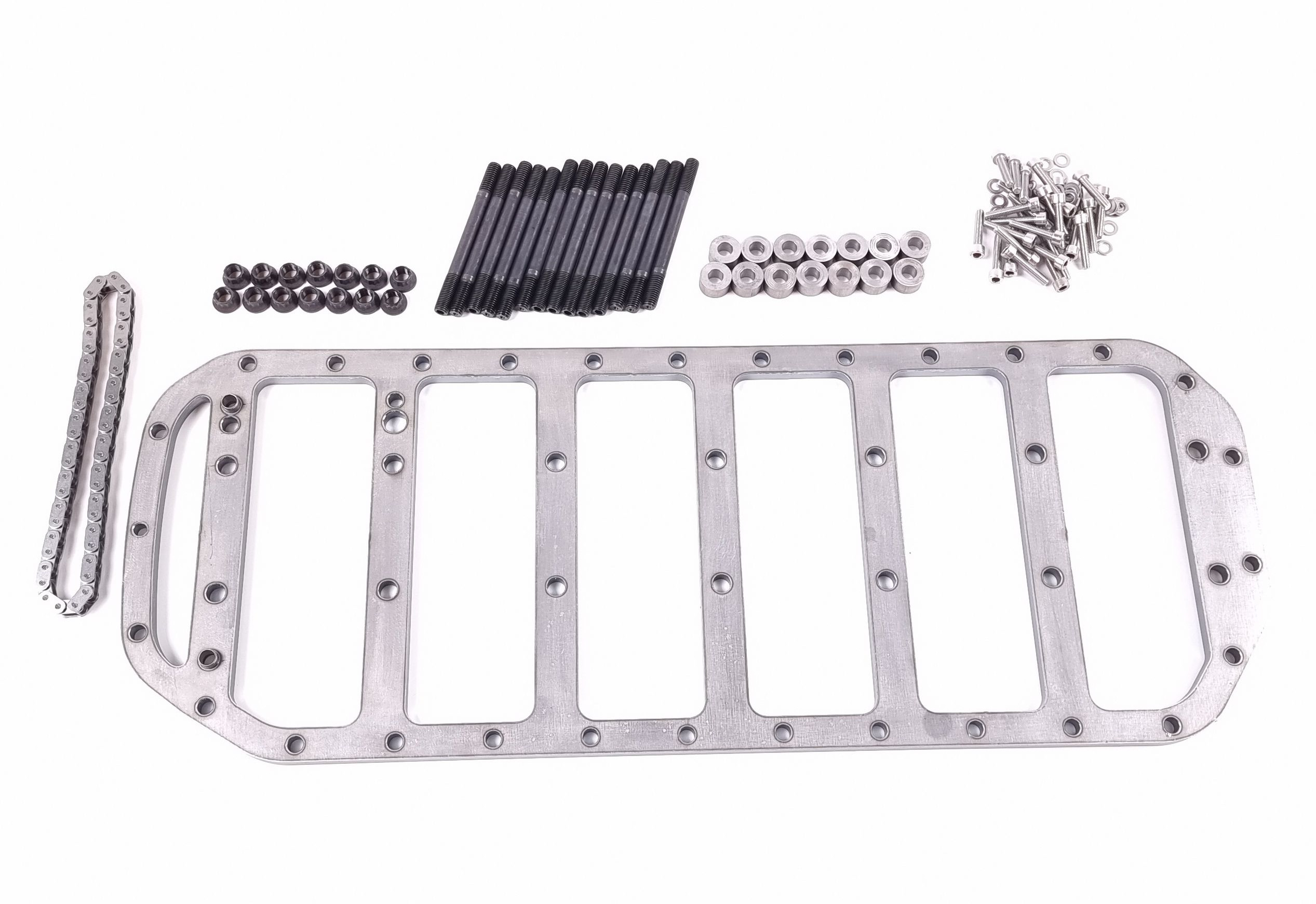

Schaper also makes a M30 block girdle which goes between the block and oil pan:

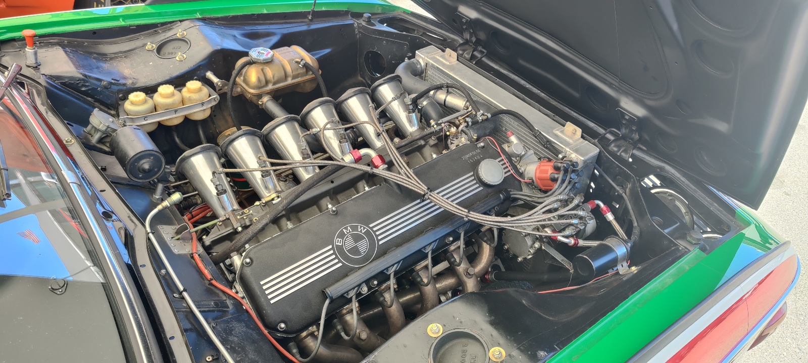

@Lucas : Do I see a Kugelfischer mechanical fuel pump on that Group 2 engine? Individual fuel lines running to each velocity stack (trumpet) ? This motor reminds me of the motor in the Luigi CSL I see at Laguna Seca Historic racing.
YES!

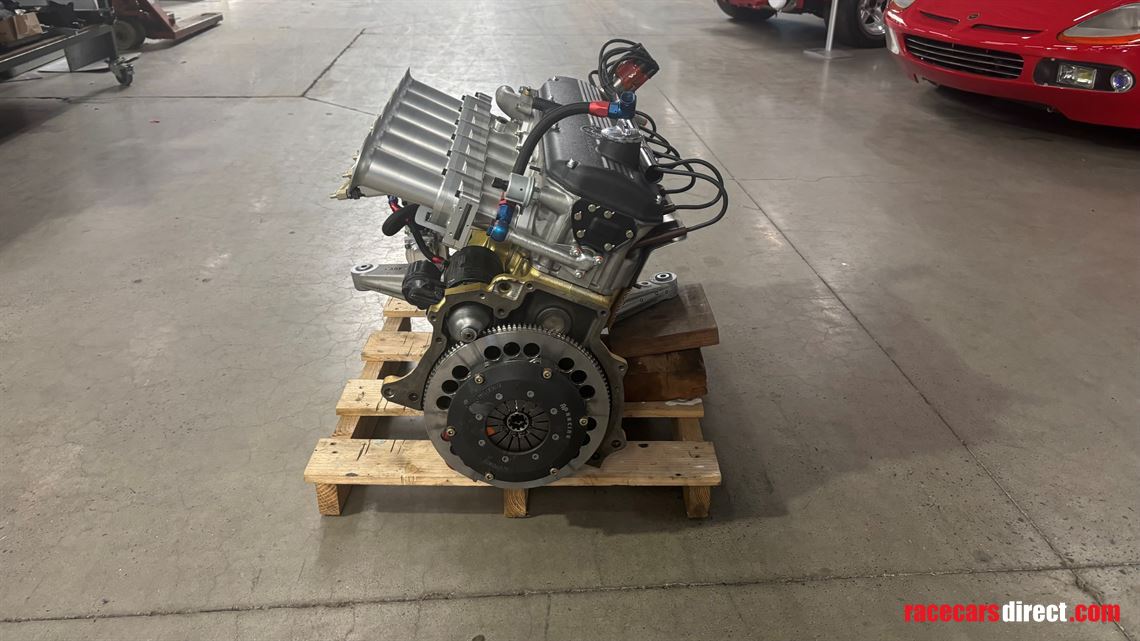

Below is the guys' response to my inquiry about the engine some time ago.
"Hello,
The engine has been completely rebuilt with new parts. The engine has just been run in. The cylinder head is from 1981, and the engine was built in 2023.
Yes, we can sell it without accessories. Do you need the mounting plate for the Kugelfisher or not?
The price of the engine without accessories is 25,000 euros."

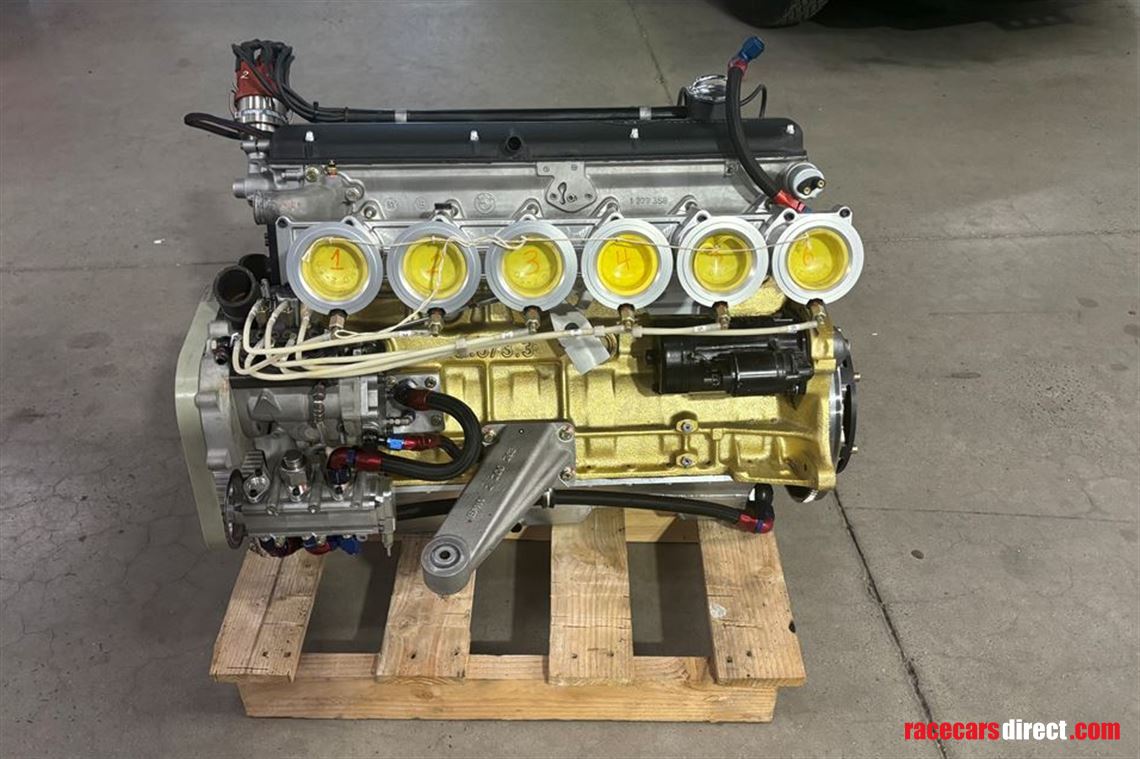

Additional inspection of the GRC motor photos reveals the red & blue NPT fittings and hoses of a 3 or 4-stage dry sump oil pump just below the kugelfischer fuel pump..

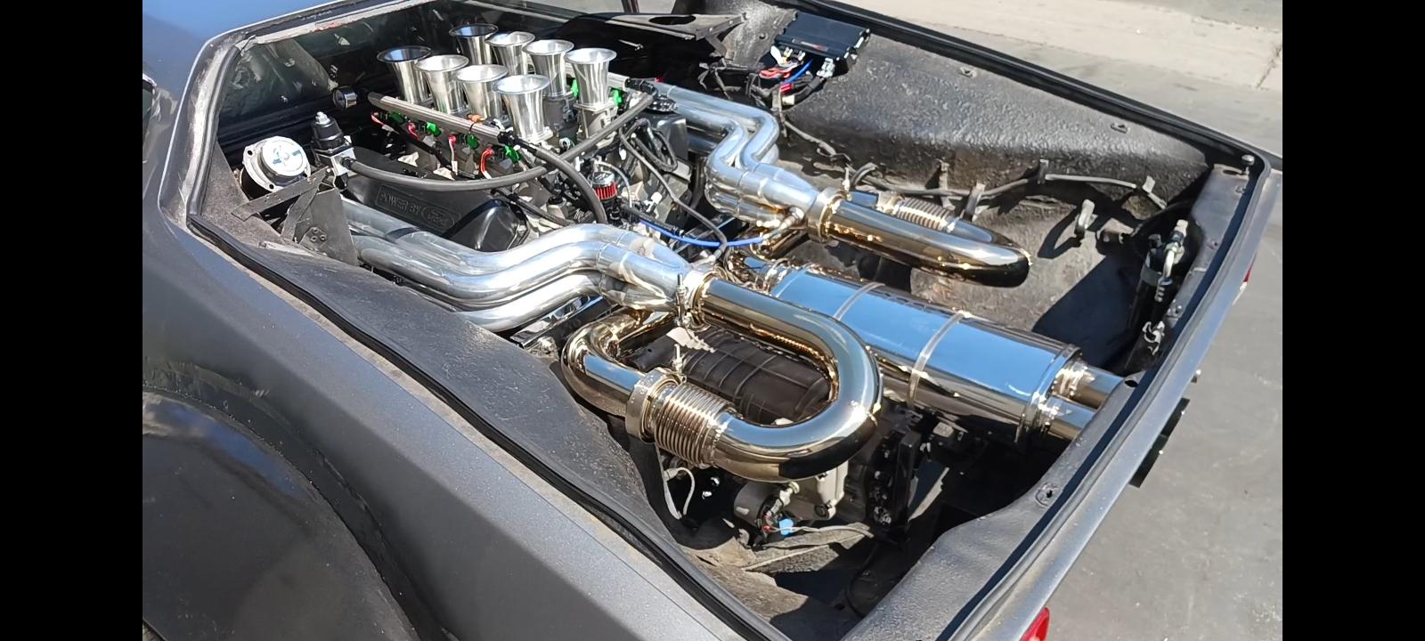

The fuel injectors on this GRC motor are located in a different location than the injectors on the Luigi motor. The GRC motor has injectors at the very top of the trumpets, whereas the Luigi motor has the injectors placed at the bottom of the trumpets, where the trumpets connect to the short intake runners. (Also note the Luigi motor has the kugelfischer pump in a different location than the GRC motor...)

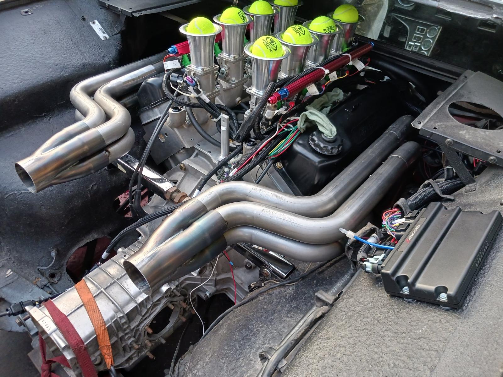

My friend is duplicating the Luigi fuel concept and placement in his '71 Pantera V8 motor. (He is a mechanical engineer and extraordinary machinist. He fabricated the entire exhaust system and the trumpets.) He's using MSD-controlled ignition system.. so those are EFI injectors, but their placement is quite similar to the Luigi injection locations.

  • 4 & 5: V8 Pantera motor w/ individual velocity stacks per cylinder
One wonders if the injector placement in the trumpet affects overall horsepower? There could be a minor affect on fuel-air mixing... hmm...

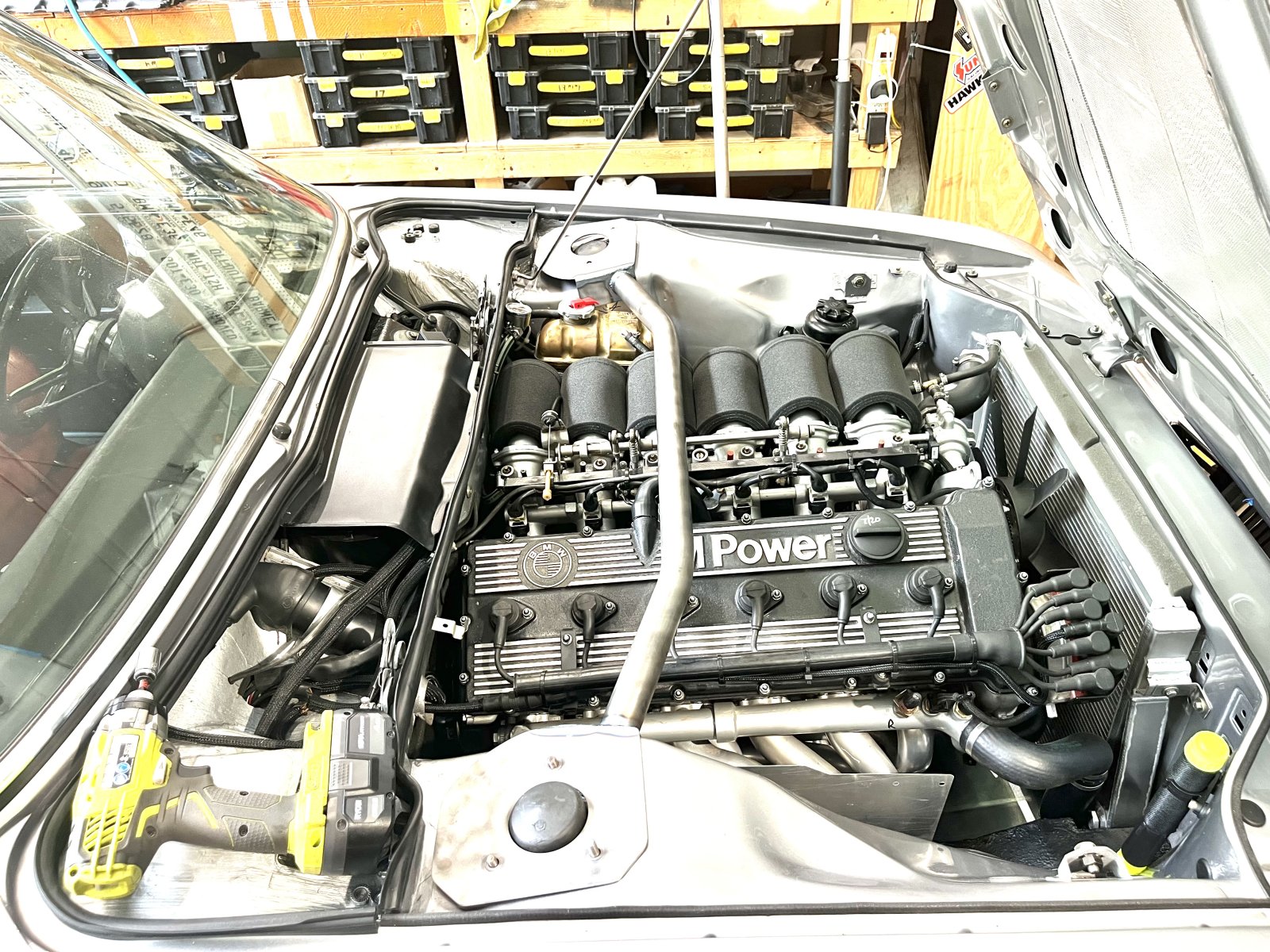

Having had a bit of experience now with the M88/3 in my E9 for a while now it does deliver power much different to my E24.
E24 is a barebones euro spec 86 635 with an OD 5 speed and a 3.07. Gearing is long but deceptively quick due to the wave of torque, makes motorway/continental trips a breeze. Above 5000 you can feel it starting to run out of puff though and for spirited driving a 3.25 would be much better suited.
E9 also has an OD 5 speed but with a 3.25. Below 3000 and in town the E24 definitely has the edge with usability even with it's longer gearing it doesn't need as much as a prod on the pedal. Past 4000 it starts to open up and at 5000 where on an M30 I would be looking to change it has really come on song.
What will be interesting is in the next few weeks when the standalone ecu gets fitted onto the M88 and it goes on the dyno for mapping. They've had a few and whilst peak is around 320 to 330ish bhp, there is massive shift in power and torque bringing it in much earlier with gains of 50+bhp along the plot which is what i am really interested in.
End of the day we all have our own preferences in power delivery and how we drive our cars, but it is quite hard to go wrong with whatever lump you pick!

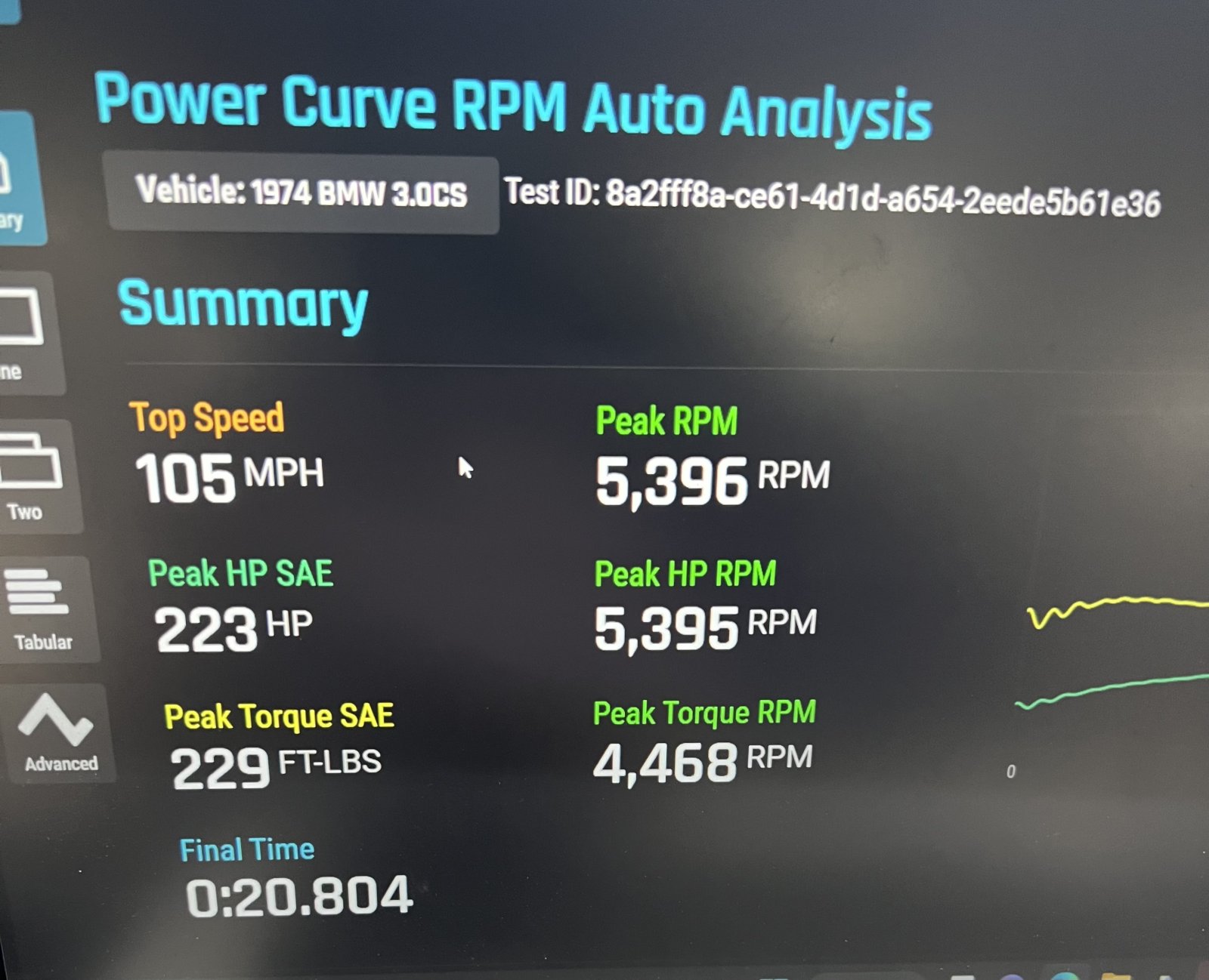

What's the best 3.5L block + head combo? - THIS ONE! :​
Power curve from M88.

Stunning. That must be an amazing E9 to drive. (And it reminds me of staring into the engine bay of my '85 Euro E24 M635.)
You have individual throttle bodies with EFI ? I think I see the throttle linkage, fuel rail and injectors right above the M-Power logo.
Stunning. That must be an amazing E9 to drive. (And it reminds me of staring into the engine bay of my '85 Euro E24 M635.)lmost” period correct.
Correct, RB. Thanks for the kind comments. A worthy repower for all to consider. “Almost” period correct.

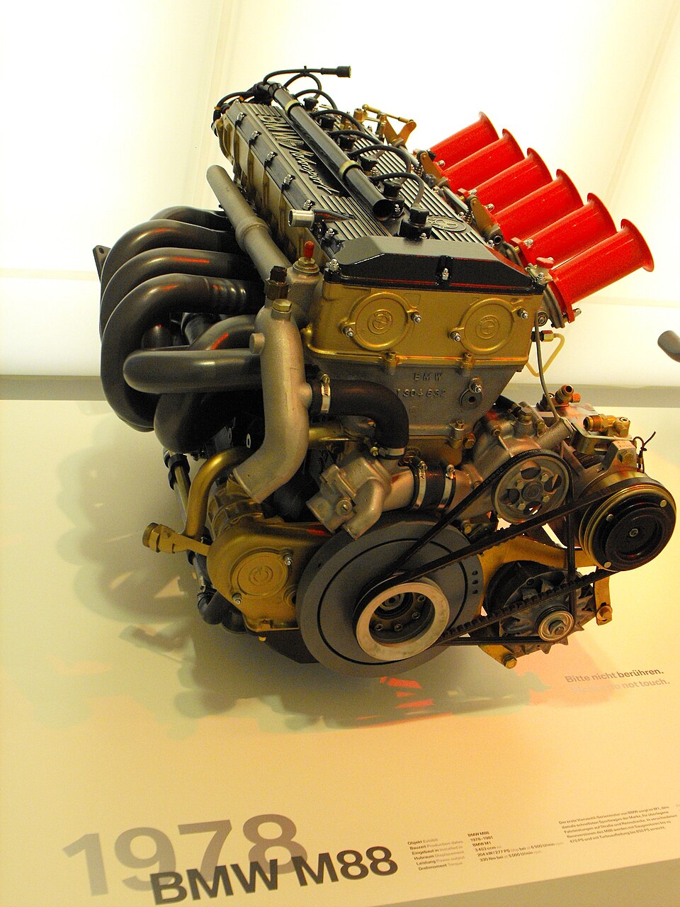

2. I know the S38 motor was DOHC, used EFI and individual throttle bodies (ITB)... Out of curiosity... did anyone ever build a carburated DOHC motor ? Or use kugelfischer mechanical fuel injection with S38 DOHC heads and velocity stacks? (This would make the motor quite similar to the engine in the Luigi CSL.. although I don't know if the Luigi is SOHC or DOHC...)
Edit: I'm going backwards in time... The M88 motor in previously posted videos was DOHC w/ mechanical fuel injection. Photo:
(Comment: the RB26DETT and other 90's JDM motors bear remarkable similarity to the M88..)
