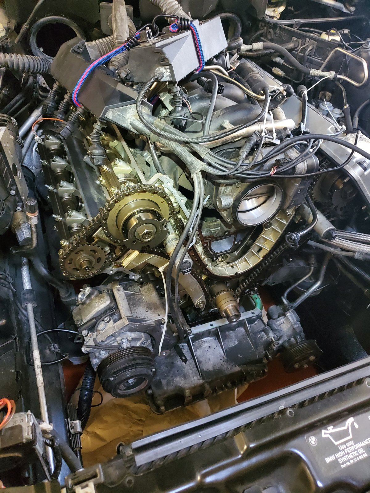

The list is long, but the dumbest had to be my e39 alternator install. The e39s have water cooled alternators, which means that the alternator installs into the lower timing cover on the M62 engine. I purchased a remanufactured alternator, and whilst this baby was being remanufactured they repainted the body of the alternator without removing the gasket that installs between the alternator and the face of the lower timing cover. Thinking there was no gasket in the painted body, I mashed another gasket over the top of the painted one. When I tightened the little 8mm bolts around the perimeter of the alternator, I snapped one of the ears off the lower timing cover.
Wayne - When I busted the timing cover, I had Tom look at it to see if there was any magic mechanic trick that might save me from replacing the lower timing cover. He looked at my car, and said "The lower timing cover needs to be replaced, and if you have to take that to somebody, that's a $5,000 mistake."
To replace the lower timing cover, you need to remove: the airbox and MAF; entire cooling system; the belts and tensioners for the alternator and air conditioning; the vacuum lines and purge valve for the evaporative control system; the cam position sensors; the harmonic balancer; the dipstick tube; both valve covers; and both upper timing covers and then the busted lower timing cover. And along the way, you need to disconnect about a dozen electrical connections, and the loom to the injectors. That leads to this:

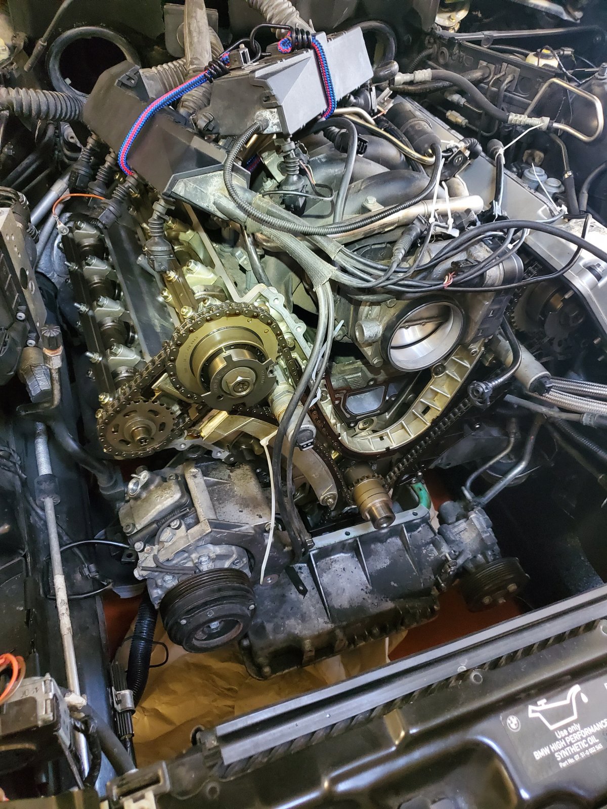

This is why I promptly sold the one and only bmw v8 I ever owned. I count myself very very lucky to have dodged the botched bmw v8 bullet
