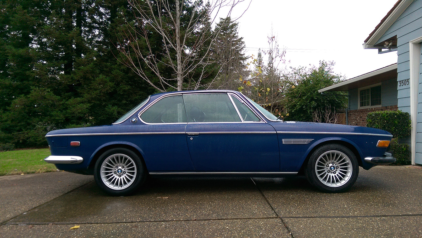

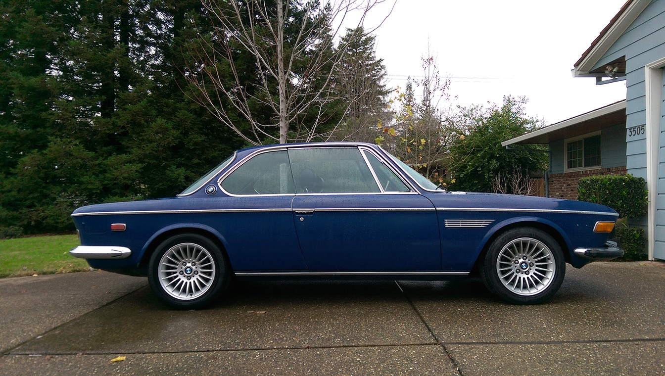

I run BMW style 61 wheels that are 7.5" wide with a 20mm offset. In the front, they are just inside the fenders. Like you, I have Carl Nelson springs and I run adjustable camber plates. Front fenders are rolled. I'd think a 7.5" with 7mm offset or an 8" wheel with 13mm offset (like you mention) would stick out of the fenders, which wouldn't be very attractive and probably even rolling the fenders would not be enough to prevent rubbing.

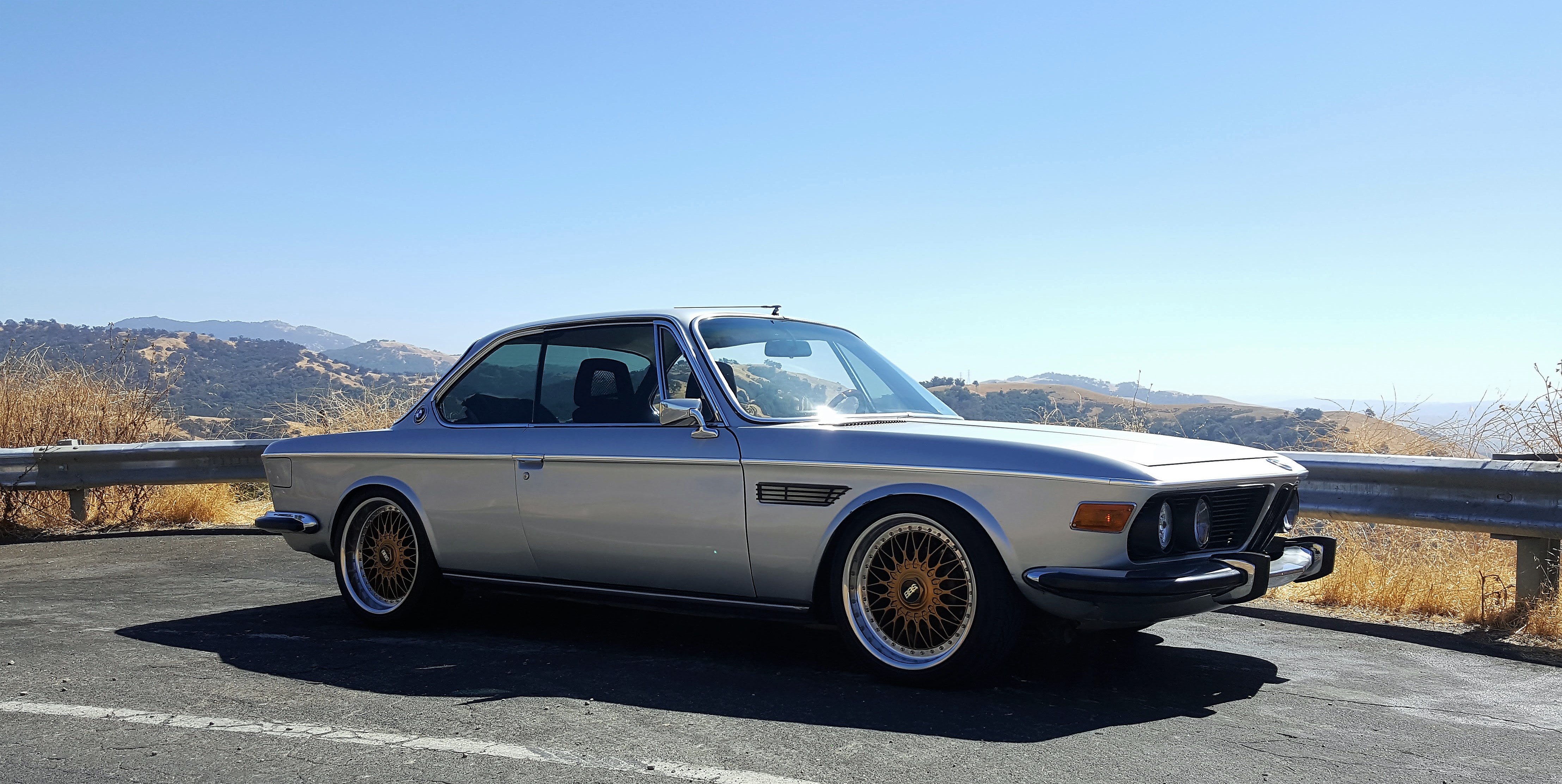

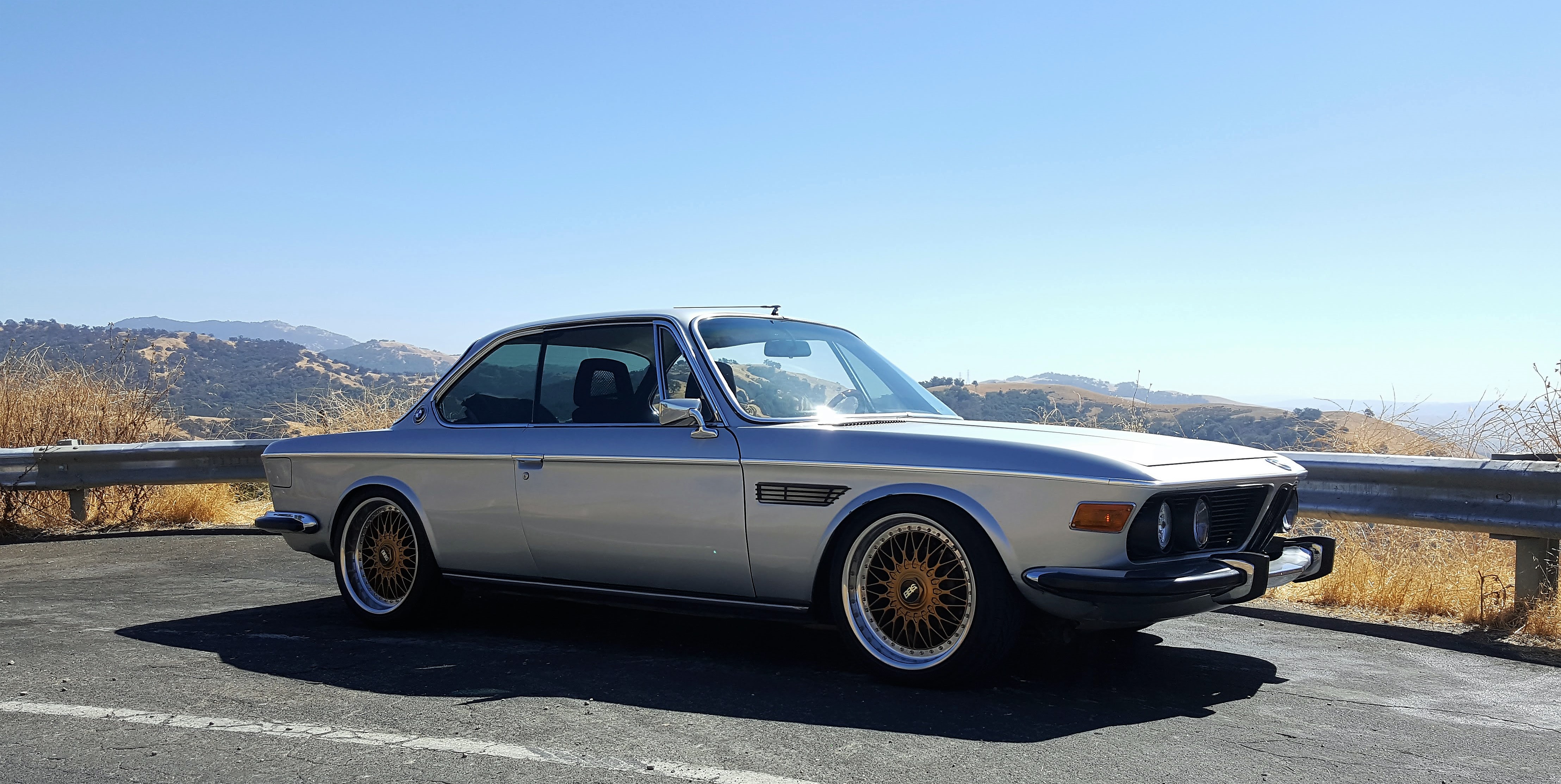

I'm using a 8" (+20mm offset) wide wheel up front with a 215/45/18 tire. Front end is lowered on a custom coilover suspension setup.
On the rear, I'm running 9" (+22mm offset) wide wheels that's lowered on factory CSL rear springs. Using a 245/40/18 tire.
Car is a '70 2800CS with BMW Style5/BBS RC060/061. Fenders rolled at all 4 corners. Hope this is helpful.

Could you possibly post a pic? I would expect that the rear could still come out just a bit more with that set-up?

Thank-you for the pics of the rear wheel... what a tease! I now want to see the whole car :D Looks like a sitting ride! With the rolled fenders do you get any rubbing? Was there much rubbing before rolling?
I run BMW style 61 wheels that are 7.5" wide with a 20mm offset. In the front, they are just inside the fenders. Like you, I have Carl Nelson springs and I run adjustable camber plates. Front fenders are rolled. I'd think a 7.5" with 7mm offset or an 8" wheel with 13mm offset (like you mention) would stick out of the fenders, which wouldn't be very attractive and probably even rolling the fenders would not be enough to prevent rubbing.View attachment 21261
I forgot to mention, those style 61's with lower profile wheels than originally used on the E38 look really good on the E9. I think this is the first modern wheel I have seen to work really well with the car, probably due to the Alpina-esque radial spoke design... just with a nice modern twist and gentle concave... Nice!
Car is a '70 2800CS with BMW Style5/BBS RC090. Fenders rolled at all 4 corners. Hope this is helpful.

I'm told that it's an uncommon version of the Style5 wheel. Found on the Euro-model E38 Sport edition. The wheels have not been re-barreled.
Very nice stance. Now that I see the 18's on the E9 and with that amount of lowering, they suit the car superbly. So under the cap it says RC090 and it is 18"? I tend to agree with @Markos that the 18" setup are the 060/061 wheels but am confused if yours say RC090. They certainly don't look rebarrelled because if they were, then you would have to have a stepped lip to account for the extra inch diameter.

You're right. They are the 2pcs wheel RC 06* in 18x8 and 18x9. Factory BMW wheel made by BBS.
I stand corrected. Thx WISE9UY! Appreciate the comments.
