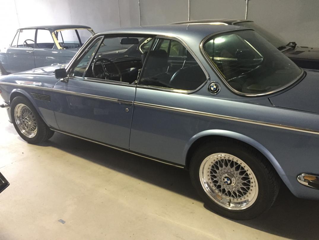

Yes it will, I wax my wheels regularly. Keeps the brake dust easier to wipe off. Not that any of my wheels get very dirty, with my fleet I have a lot of wheels to clean too.
Wheel wax is good, wax the inside with a coupe coats before mounting on the CS.
