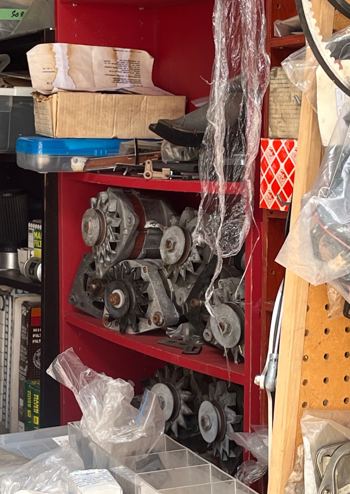

I just started digging in my sea can, I think some of these are new. I see around 10 of them.
Makes sense.
I’ll look closer and see if I can home bench test the ones that look new.
May be useful for someone upgrading.
A rabbit hole for ANOTHER day. They are heavy have been waiting patiently for decades.
I thought they might be useful at a trunk swap meet?
