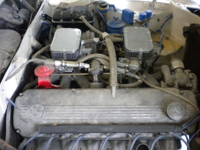

I have recently joined the group on behalf of a 69 2800CS falling into my lap. I had the car inspected by a local bimmer mechanic who has been restoring new and old cars for 20 years and who assures me there is very little rust due to a major restoration performed in the late 80's. I am just beginning on this journey of restoring this one owner car back to its glory and would appreciate any advice you guys can give me. As you can see from the pictures I need a host of parts and have begun assembling a list but any recommendations you might have would be greatly appreciated.

Post some more pictures.
For example, the rocker cover vent seems to be tied into the manifolds from a T connection. Take that off and cap the manifolds- you're loosing vacuum and likely will run much better. A picture from the other side will help.
The painted red vacuum control that used to be the damper for the original carbs isn't needed since you have webers.Those parts aren't available any way.

What are you going to do about bumpers? From your photos, looks like they're missing. The underhood shot also shows a missing air cleaner. The stock unit will be quieter than those VW aftermarket things, as well as look more correct. And, I'd lose that steel braid radiator hose in a heartbeat - a bit too JCWhitney-esque for an e9!
