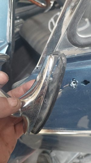

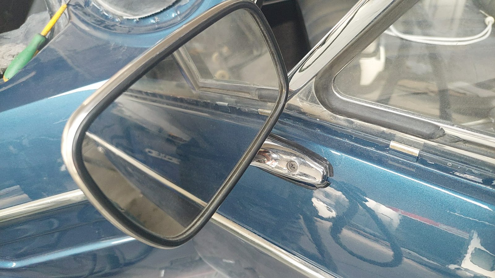

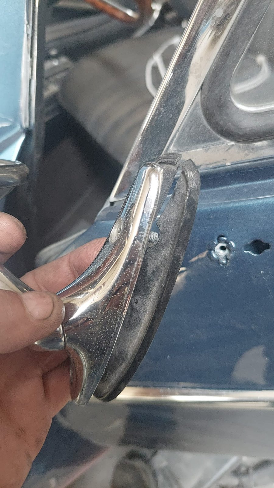

hello everyone,

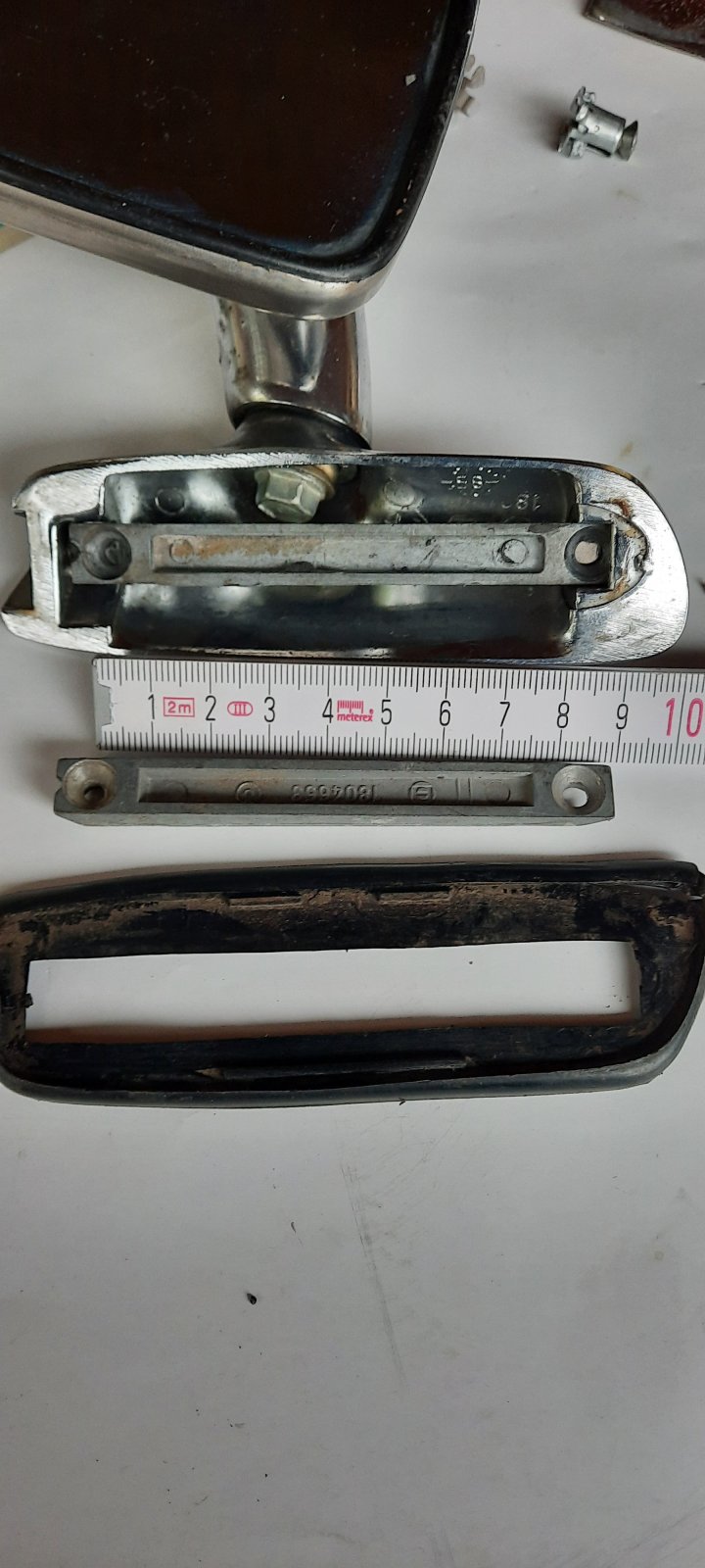

i have this mirror model on my e9 ansd i don't find the rubber to change it, do you know if it's an original mirror or not ?
thanks

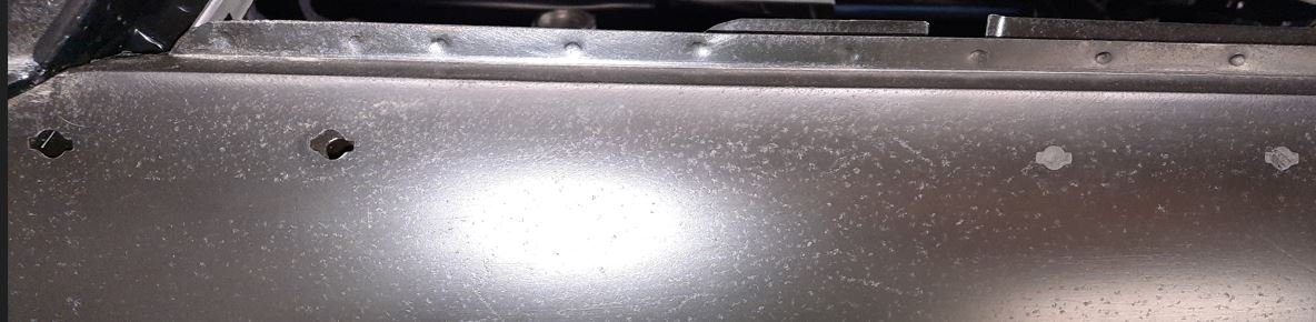

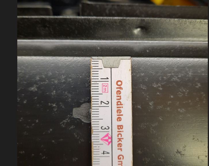

Obviously a new hole for the left screw was made, left to the original opening. Before you go for a new mirror you should be sure that the left hole will be covered by the new mirror.
Let me find a mirror to show you the proper dimensions, will be back!
TomHom
344
260
Germany
The distance for the holes of a E9 mirror is 82mm.
The distance from the left fixing point to the edge of the mirror is 15mm.
With an E9 mirror you will not cover the left hole.

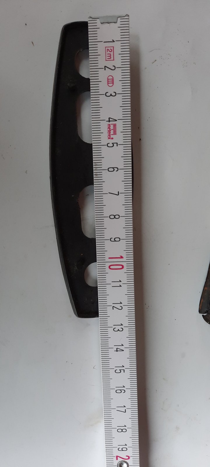

I found this rubber, please verify the size.
remydedez
85
1
Lyon, FRANCE
Better to use the installed mirror with it's rubber.View attachment 169274

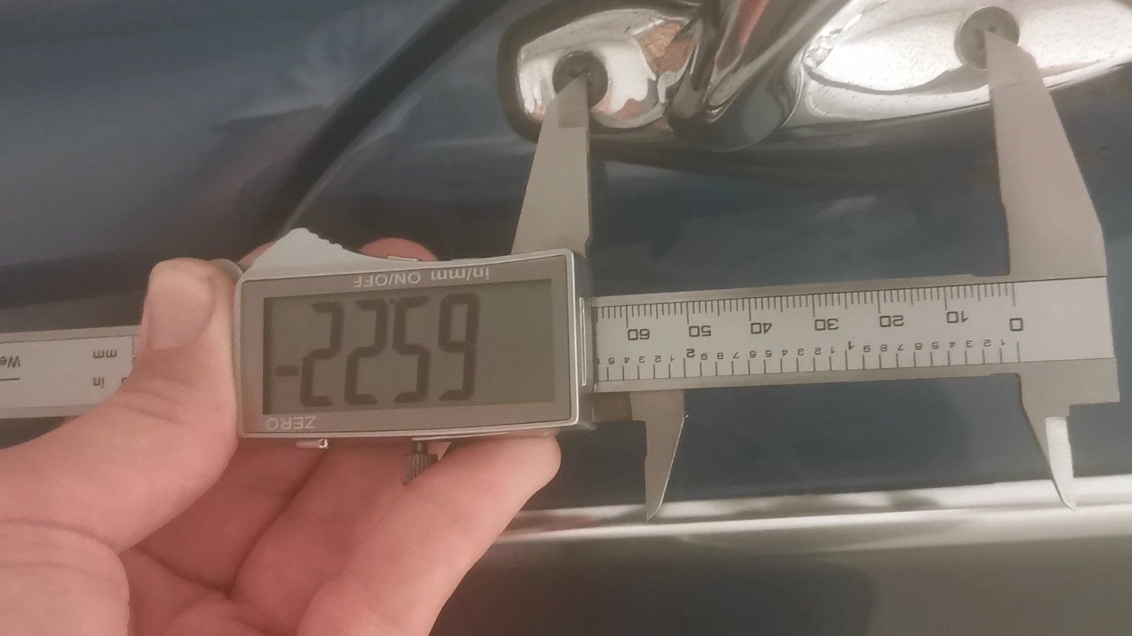

Here the entraxe size of mine 65.22mm

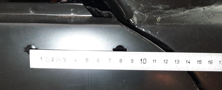

Hi,
as already shown above the distance between the two holes of the mirror is 82mm.
There are two possible positions for mounting the mirror on the door. At the triangle window of further back.
This photo has been taken from a left NOS-door with the backwards position marked by the manufacturer.
The holes at the triangle window have been cut by myself.
The postitions for the holes are shown here (on a right door:Position Spiegel.JPG

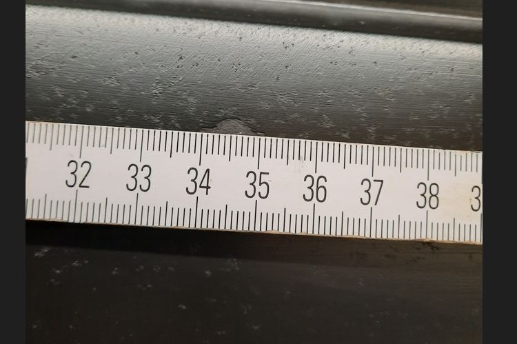

For the backward position 34.5cm is the distance from the edge of the door to the first hole.
It´s also very important to observe the vertical position from the top line of the door:
Regards
Thomas

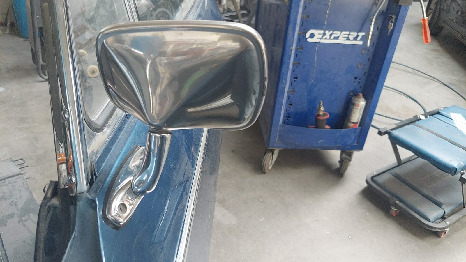

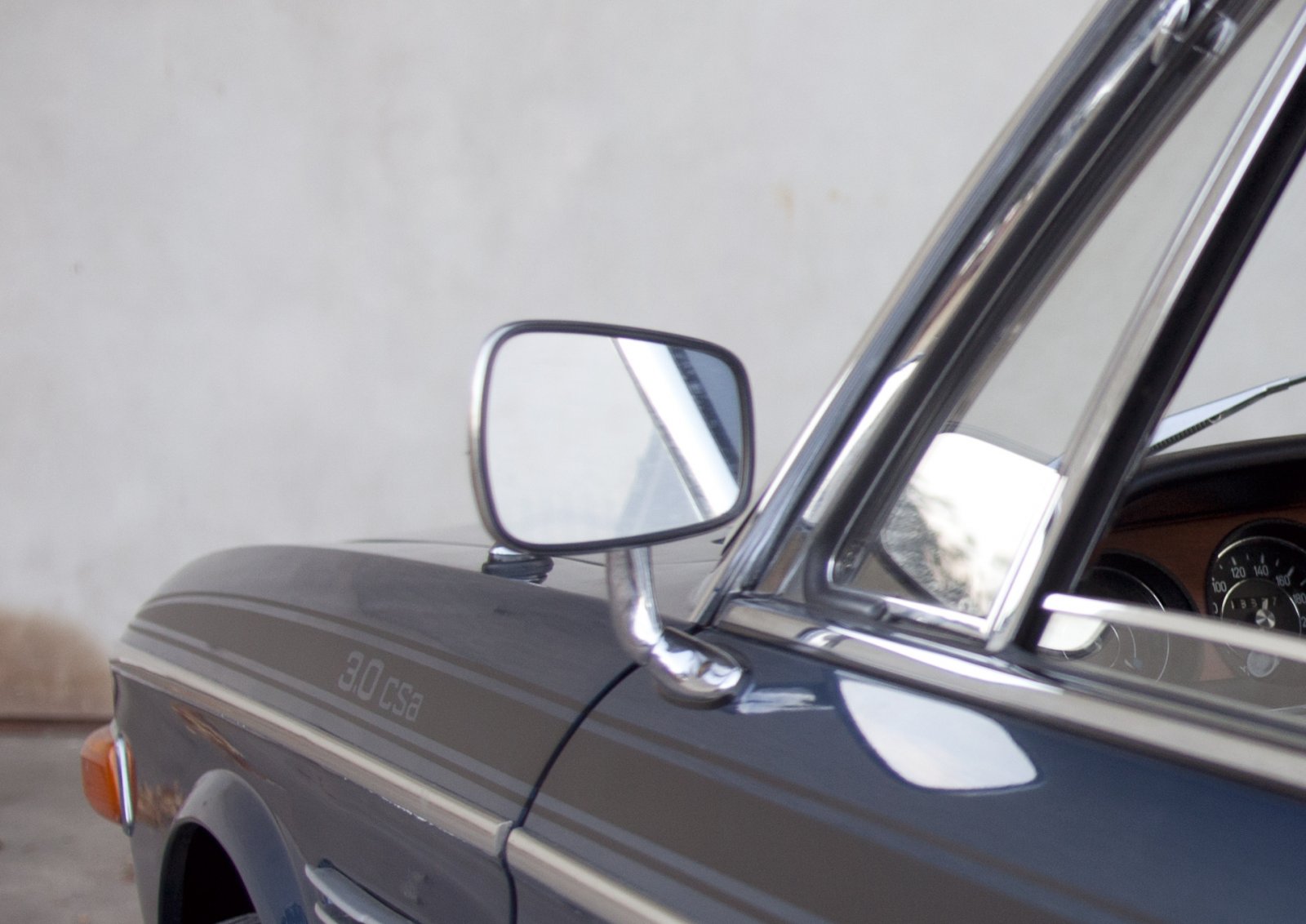

hello everyone,
thanks
remydedez,​
I saved these photos back in January because I liked the mirrors and hadn’t seen them before. They look to be the same type as yours. Unique to the French market, perhaps?
