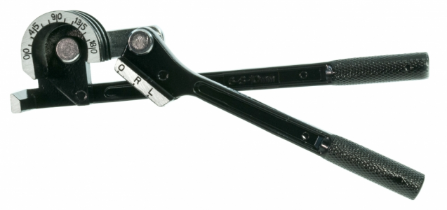

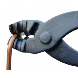

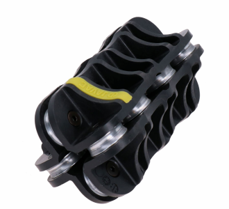

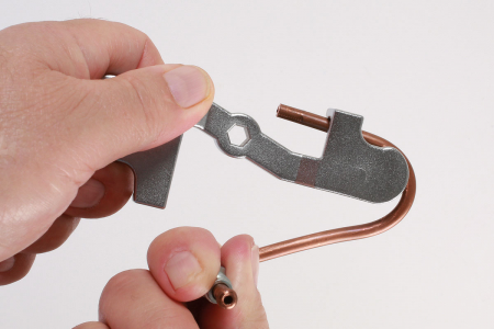

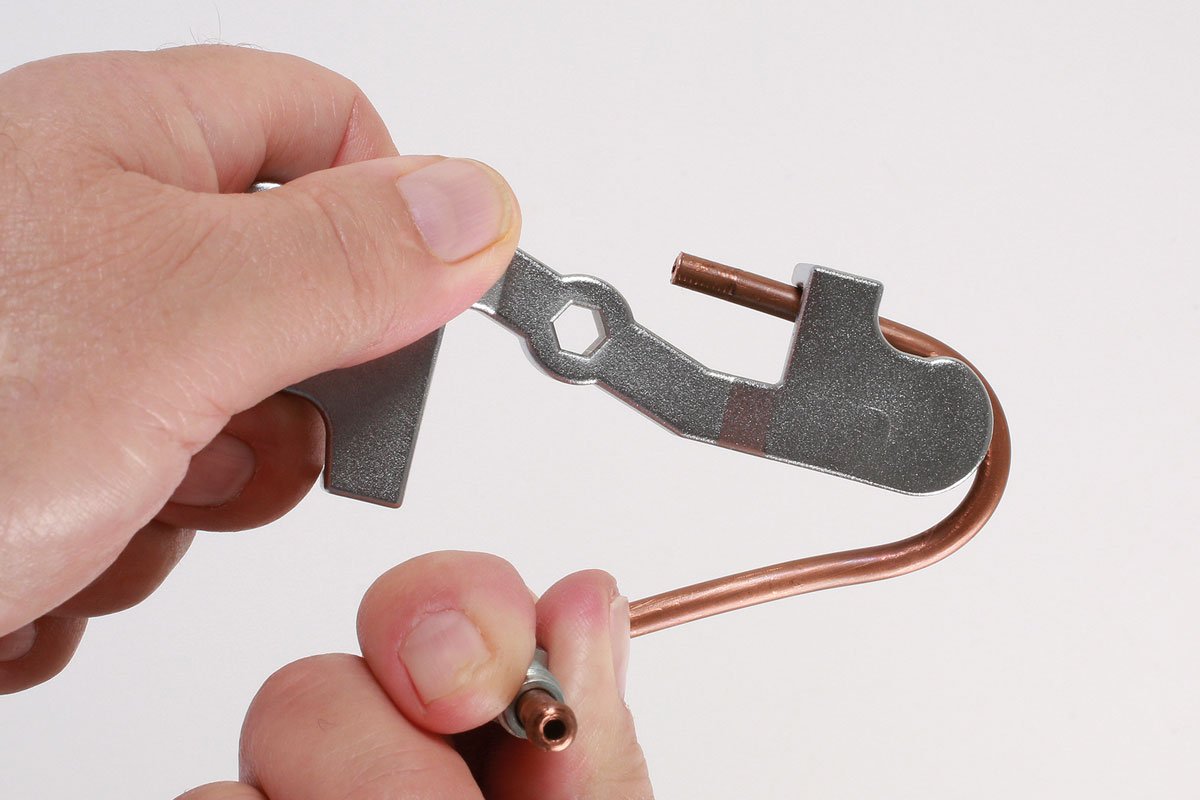

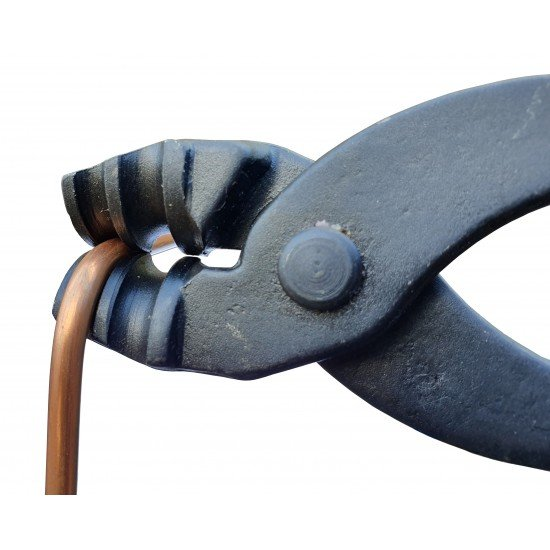

So many different shapes so you can find the best for you.
Also BMW has own tool which was available at shop some time ago.
bluecoupe30!
2,151
1,305

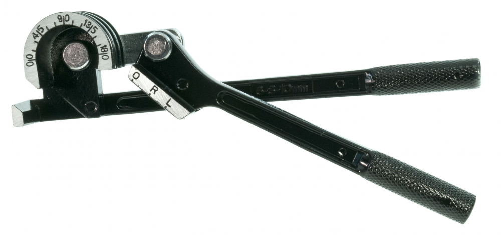

I have used a brake pipe bender like the one shown above in the upper left from Krzysztof's post. I found it left a mark on the pipe. So, I put some cover like duct tape on the pipe at the location I wanted the tool to grip. Still made a mark. You may do better, but I was surprised that this was the price to use this style of bender. Best to have more than one type do do the job. Eastwood has a few different styles. Oh, and some tools cannot fit the small brake pipe, 3/16 or 4.X mm?

Heating up might help bending.
Some used just a pipe to bend the brake hose on.

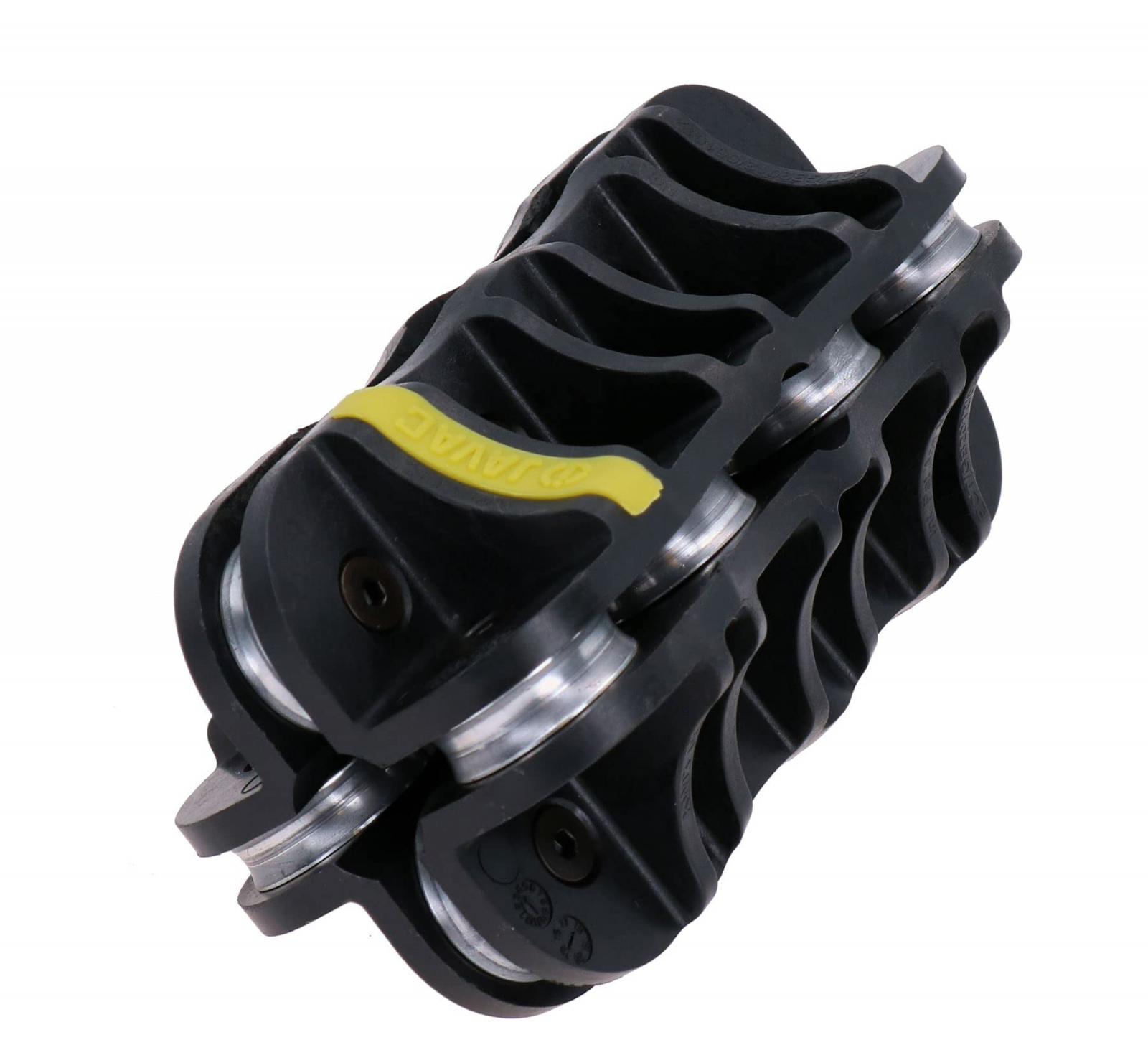

Not much of experience but I have seen someone on YT using something like that. But it is not always possible so one axis rollers could do the job as well.
