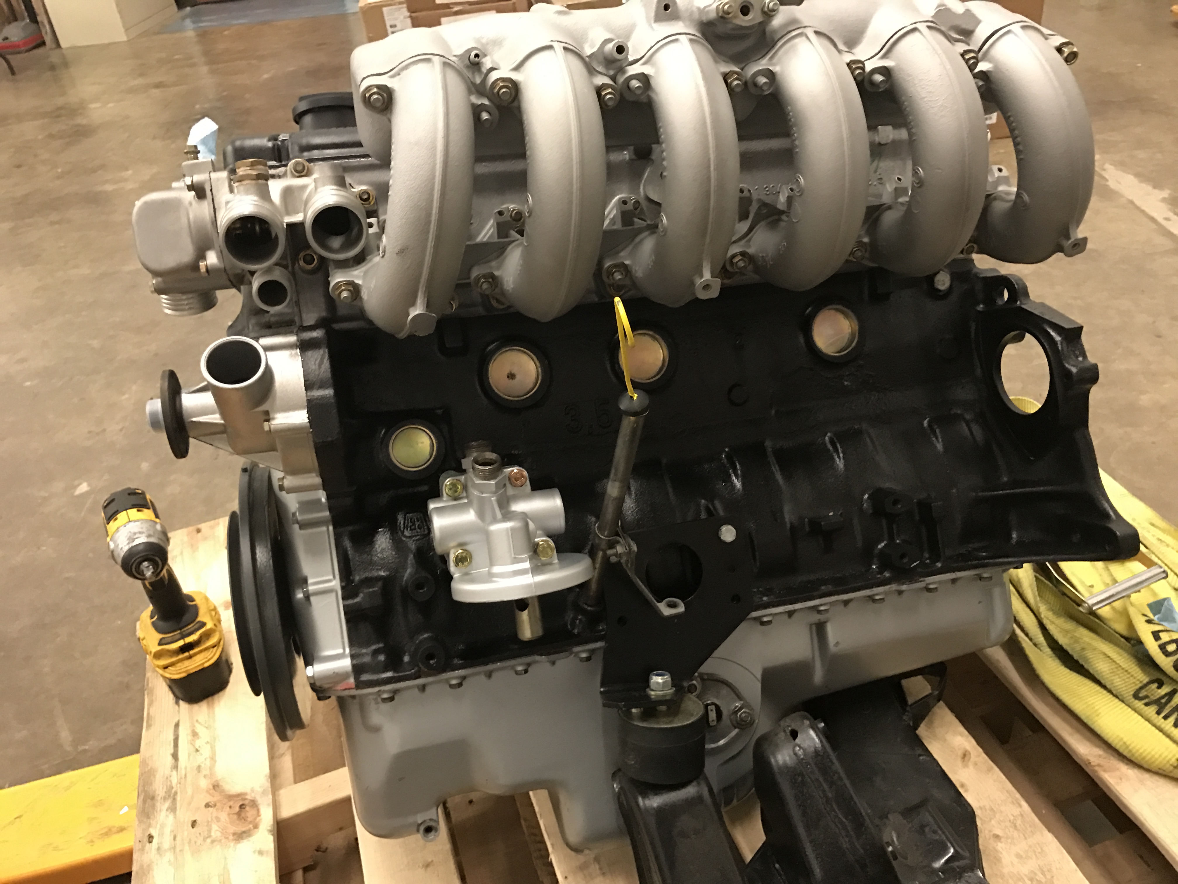

Sf don has answers, parts and could point you in the right direction for anything else, he's taken allot of the guess work out of my build
all of those new bolts, powder coated manifold, etc. makes a real visual difference Peter. looking GREAT + Don is the mentor
