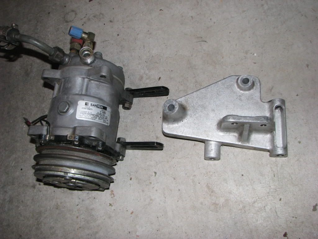

I have clarity on everything except which bracket I would use to attach a Sanden style 709 to the stock Euro M30 which never had a York or its bracket on it.
Seems like this one would work ona 508, but can't find it anywhere.
The style below is available on Ebay and it looks just like the one CK uses on his kits (http://www.coupeking.com/?post_type=parts&p=5110) but does it fit a Sanden 709?
It appears to me the style that Steve used (below) is to be attached to the OEM York bracket, not in place of it, correct?
Appreciate any pointers in this regard. TIA.
Seems like sorting the damned bracket was the hardest for me part which is why I adapted the York. I would have preferred to have scrapped it. I am not sure if those brackets will fit, but I do know that a 508 and a 709 Sanden share the same mounting geometry.

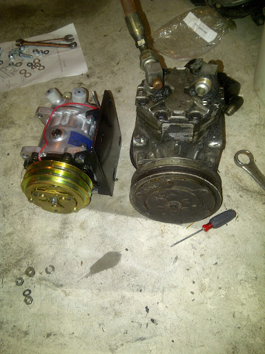

Luis - It does not look like either of those brackets will work. I have the second one but the "ears" on my compressor appear closer together than that shown in your photo. They measure ~50mm between them and ~82mm outside to outside.
Chris - I have a mixture of both fittings (using r134) and have had no leaking problems.

Thanks for the pics Sven. That compressor is the E24 style, same as used by CK. It's just not as plentiful and cheap as the Sanden's.
I welcome any other pics of other brackets and compressor combo's.
The second picture from sven is the stock BMW bracket that is on any E34 535i (and I imagine E28 too) -It's also your pic from 'ebay'. If you have any 'pick a part' places by you, you should be able to find it easy and cheap. I actually just pulled the air conditioning out of my E30 (it has a B35 M30 swap) on Sunday and was going to throw away my bracket (well, recycle it). If you want one to experiment with, I can mail it to you - you're not too far away from me and snail mail should work.

Afeustel: There appear to be two compressors that are very similar but have a different mounting method. The one you describe for (some?) E30's, I'm just going by online parts catalogs and Ebay listings, have a different mounting in that they have two threaded bosses with a flat, square top, as seen on this photo from an Ebay listing ( http://www.ebay.com/itm/A-C-Compres...ies&fits=Make:BMW&hash=item564c58e039&vxp=mtr )
And those appear to use this mounting bracket:
The compressor that Sven shows appears identical, except for the top mounting consisting of two ears, rather than the two bosses. My assumption is that ether one would work as long as it's paired with the appropriate bracket. Does anyone know otherwise?
Luis, you are right...my bad. It's just the housing shape and size that are similar, which are both smaller than the Sanden and others. Sorry about that.
