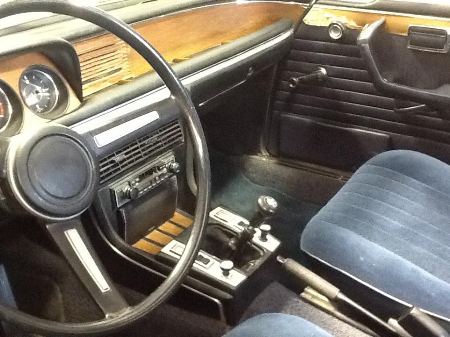

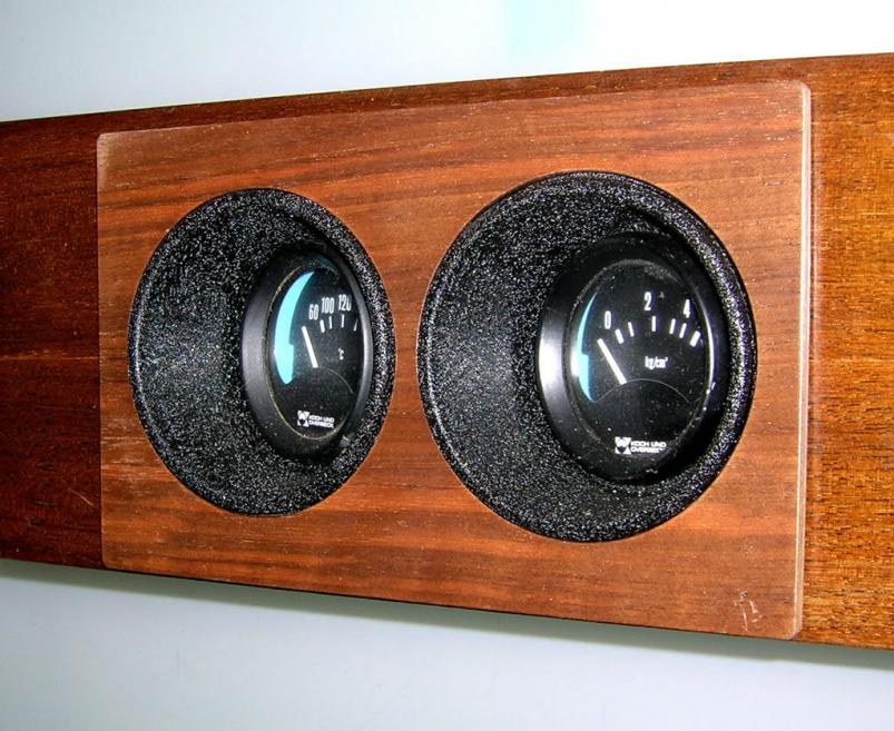

as I know cherry wood was used at my 1973 CS dashboard. I want to fit an Oil-Pressure/Temperature gauge like shown on the foto.
Anybody knows exactly which kind of cherry wood was used in 1973 by BMW?
I know it is cherry....but there are different cherry woods on the market.
Thanks Ulrich
ae
are you sure it cherry
most were done with french walnut which looks like your picture
just a thought
wood
Alan is correct, French Walnut...the cut they originally used is a plain, flat cut, and the finish after almost forty years, would usually sun bleach to a more red tone that has led many to think cherry or mahogany. The photo, I'm guessing, is what you want, not what you have...standard walnut dash, and the custom gauge surround looks a different tropical species...and yes, do the search...

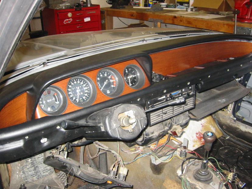

Just as an experiment, I uploaded these photos of my dash. The chart on the upload screen says the maximum size of a jpeg file is 97.7 KB.

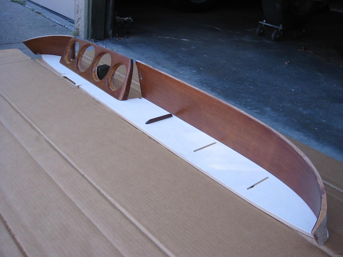

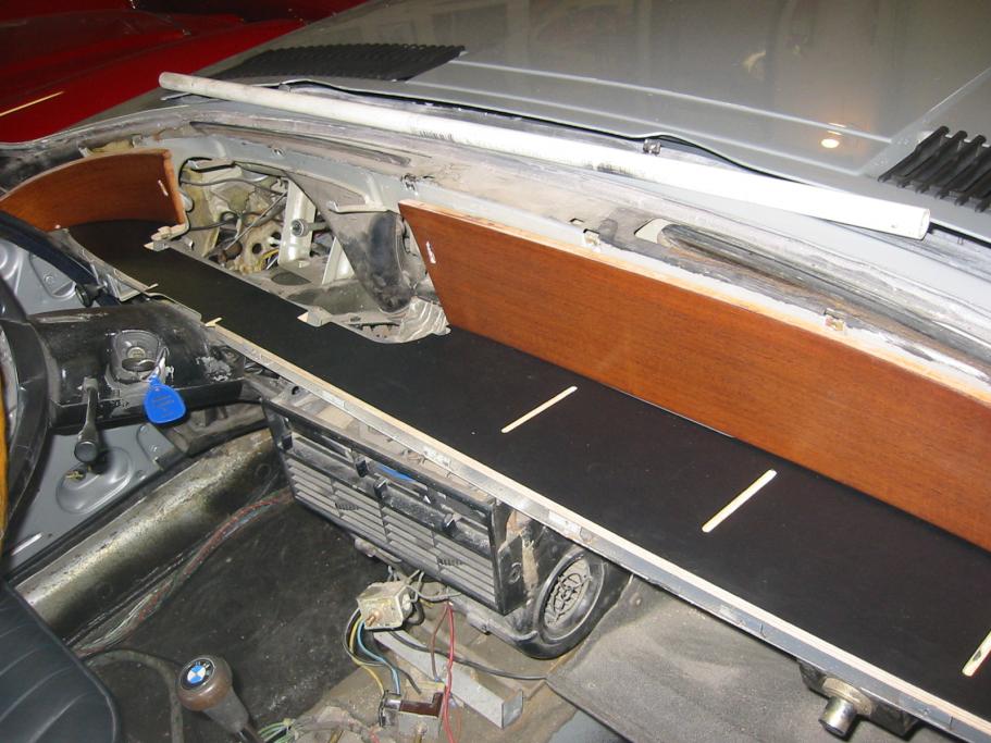

12doplumbing said:
that's not solid wood? Maybe it's the resolution
No, it's veneer applied to new plywood by Madera Concepts. They were able to re-veneer most of my old wood bases, but the dashboard pieces had too much water damage to be re-used.
I think you are a pioneer in using solid wood on an e9.
