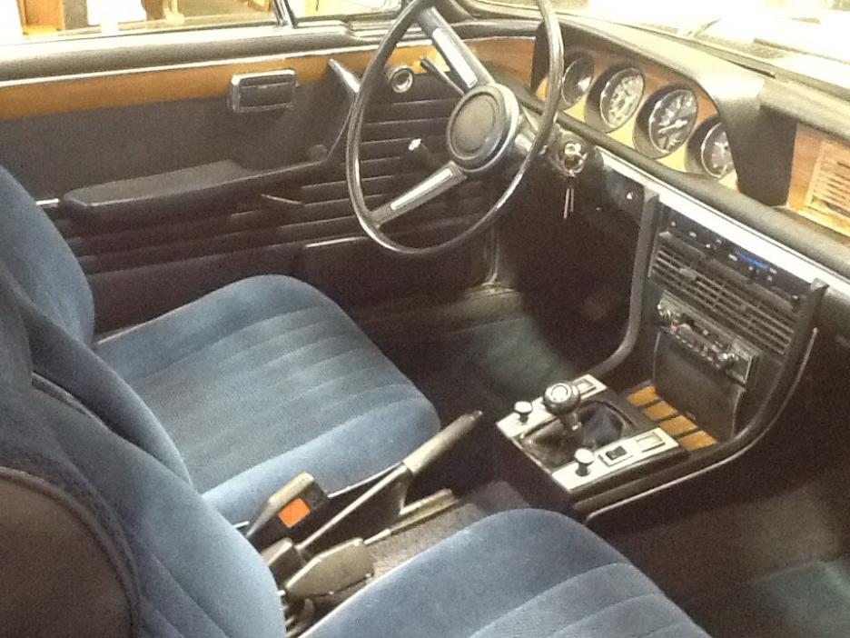

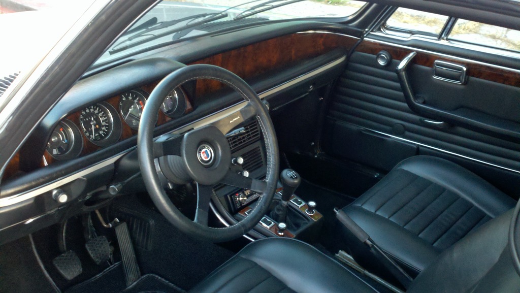

Chris Robbins has the nicest wood on his La Jolla Independent built CSi.
The dash is laminated plywood set up on a buck to make the curves. As long as the plywood under the veneer is good the veneer will bend easily to fit the dash shape.
Nicest, huh? I'm up to the challenge.
It's a big challenge; that's beautiful.

Well, I'd challenge the use of the word "nicest" in the above sentence. Beauty is in the eye of the beholder, and while I respect that adawil2002 and Chris Robbins might like burled wood, I remain a purist.
The genius that designed the coupe chose French walnut, and I think they knew what they were doing. Perhaps it is appropriate for a Jag-you-are, but to my eye, burled wood just looks pretentious on an early BMW - too formal, too stuffy.

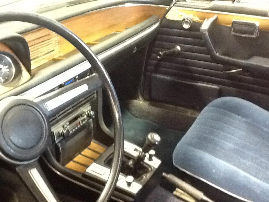

I would agree, window moters atc, not exactly perfection but as to using a solid piece of wood for the dash, far beyond my skills. If you can do it, go ahead. it will likely loom awesome.
wood

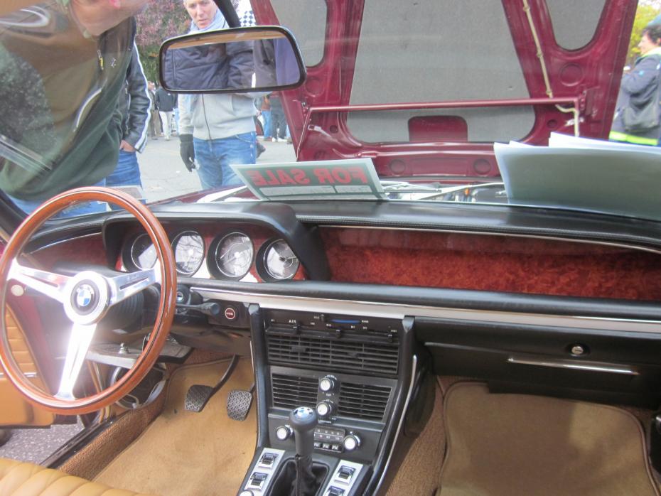

I've designed wood and upholstered furniture for almost thirty-five years...and rebuilt a few dashes in the last few...I'm with jmackro on the "what I want mine to look like", much in same way that I don't plan to delete my aluminum beltline trim..but that's what makes horse races, I guess. I'll proffer a few ideas about wood...
Once a tree is cut down, its dead...all of the Murphy's oil ads about your wood is alive is BS. It does react to temp and humidity, and move, and solid wood will shrink and expand side to side, but negligibly in length..the cracks in that hardwood floor almost always are plank next to plank, not the ends where they butt together, right? And the larger/thicker the wood, the more movement...and that is for properly kiln-dried lumber (7-9% moisture).
Veneer has very "little memory" for movement, which is why most cars historically used veneer. It is thin, but not to be cheap...for uniformity, strength/stability, and most of all beauty...and durable if finished properly.
The same piece of solid walnut for the passenger dash would be apprx 8.25 X 4.75 X 32" gross...the curved end(s) will have tiny short-grain that will curl, and bust off or fall off as it moves while screwed to a torquing metal structure (your dash/bulkhead), especially after being sawn to .50" thick. Solid burl (think wood tumor or abberation) is brittle as there is no directional grain...like cutting grilled polenta... Steam bending works with straight-grain woods like oak, ash, teak and even walnut, but not with without great difficulty of set-up..some people in WI still do some oak in the US...
As to buying a dilapidated used set, if you are copying a less than perfect set, your fit will also be less than perfect. Used sets tend to be really good (that are usually still in a car), or the ends are potato chips, as moisture broke down the 40-year old hide glue(like most of the ones that I have purchased)..the long, fragile door pieces usually warp at the ashtray...rear "door" pieces are usually ok.
I think you can make all pieces from solid walnut(I was going to do teak, as its similar to the finished walnut, and I did work in Thailand) except for the L & R dash pieces...and the guage surround end grain will go much darker stain than the face.
Sorry so long (this IS the short version..), but if it was easy, everyone would already be doing it...

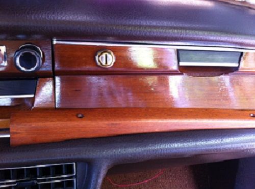

Mercedes also used walnut for the W108 W109 chassis 250-300se sel which is a similar to that of our coupes and also a car of the same era.

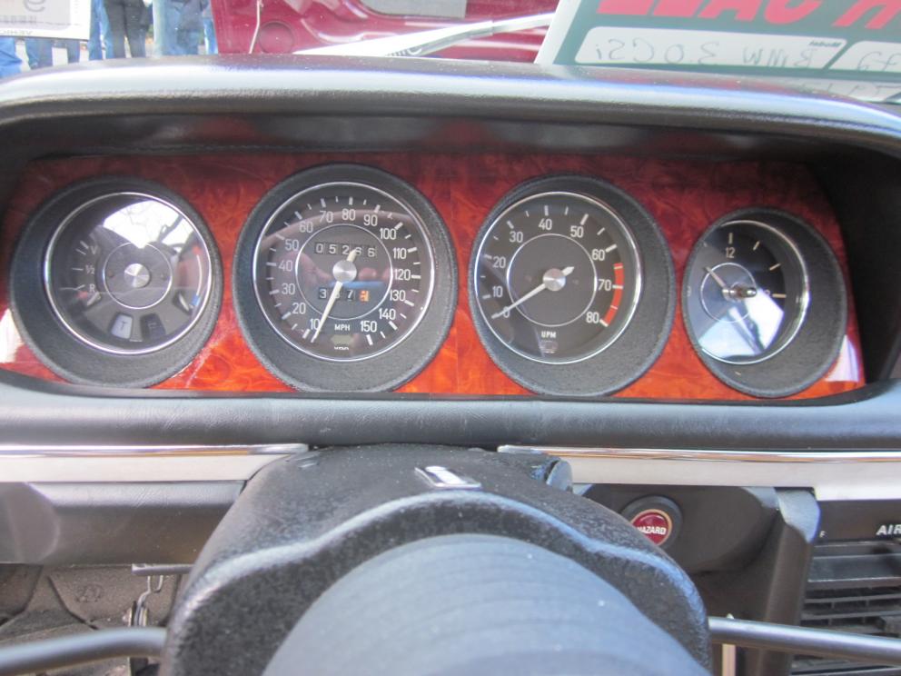

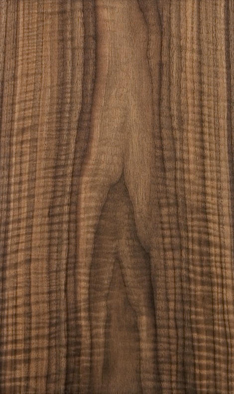

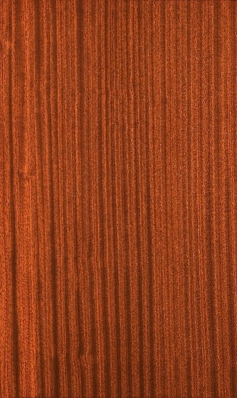

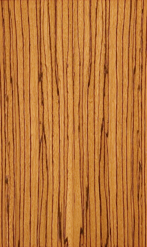

my suggestion is to use a lightly figured wood - either plain sliced / flat cut or quarter figured. this is a flat cut figured walnut

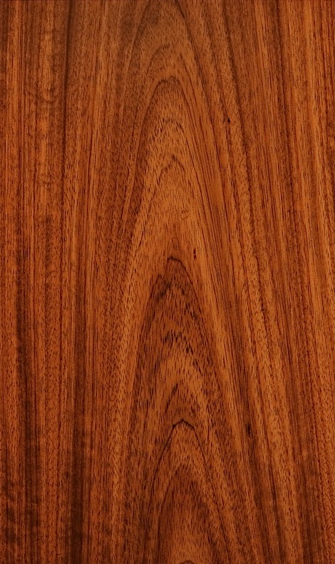

here are a few favorites
zebrawood (quartered - non figure)
sapele (ribbon stripe - quartered - non figure)
santos rosewood (quarter - non figure)
etimoe (flat cut - non figure)
black limba (quartered - non figure)
