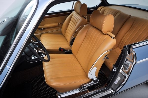

Which leather color is this ?
rsporsche
10,702
3,737
Atlanta, GA

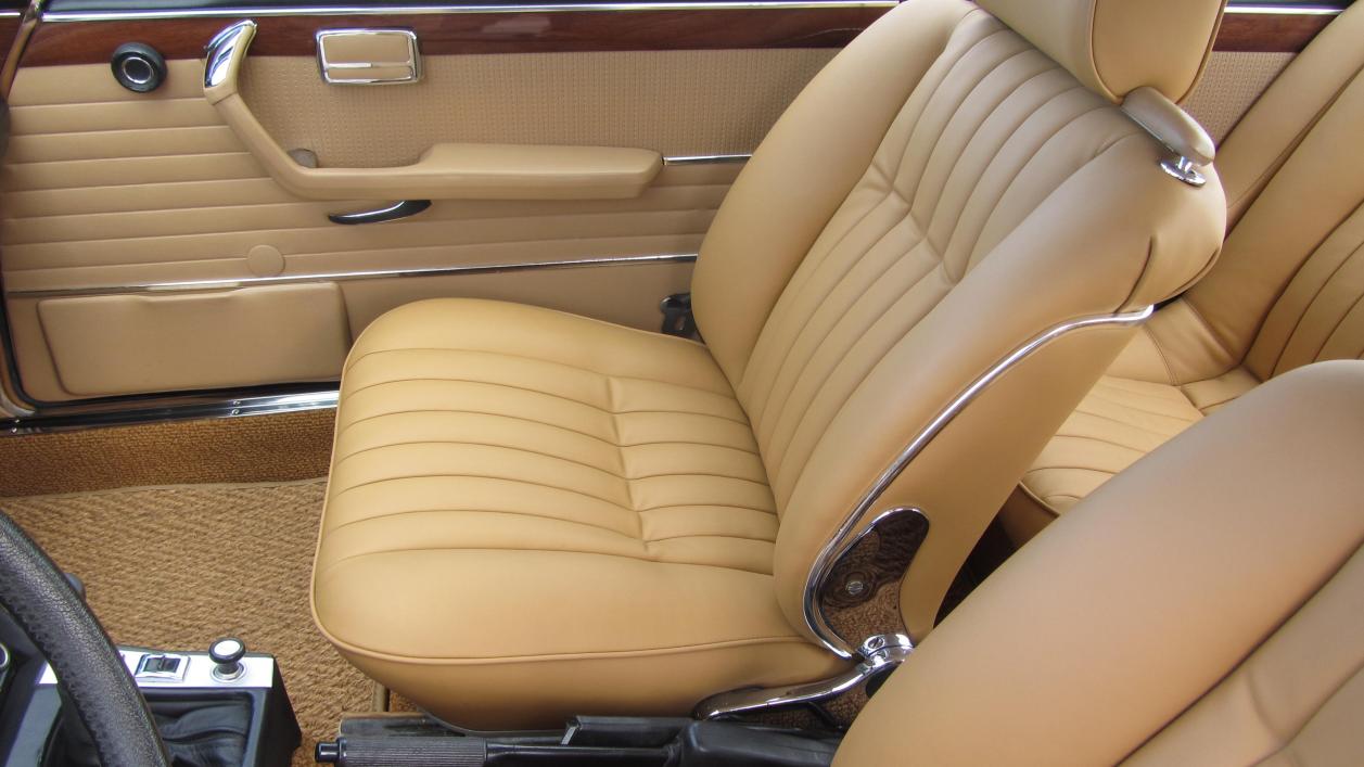

it looks too light compared to the original saddle tan. my guess this is one of the GAHH leather colors.
rsporsche
10,702
3,737
Atlanta, GA
my guess would be 0521 light sand, 0526 light natural ... or maybe 07 saddle. i do know that the 07 saddle is much lighter than the BMW saddle
p.smitty
160
0
Spokane,WA
seat color
I just had my seats redone in that very same leather. It is indeed a GAHH product. The color is 07 Saddle. Very "buttery" and soft.

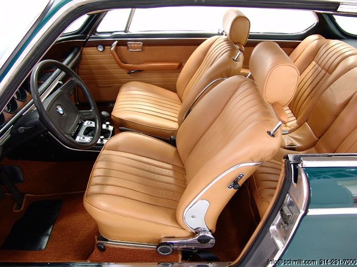

I've noticed that some of the recovers look a bit loose. Are you guys paying to have the "tuck" about 4" from the crevice of the seat? This car appears to be missing the tuck.
bert35csi
1,436
142
san francisco
Yeah, the "tucks", "plucks" or what have you are essential for correct looking original CS seats. Many recovered leather seats are missing the tucks either on the seats, seat backs or both. Many upholsterers are not aware of them.

Can someone tell me more about the 'tucks and plucks'? I'm going to be re-upholstering a pair of front and rear seats in my '74 CS over the winter (reusing the front seat bottom upholstery and installing new on the front side of the backrests, as well as removing and reinstalling the rear seat upholstery after refreshing a couple of the panels on them).
I've done a few Porsche Recaro seats, so am not a total novice, but this will be my first attempt on the BMW design seats.
Thanks for any guidance.
The 1st pic shows the original factory tucked pleats on both seat bottoms and seat backs. The 2nd and 3rd pics show the lack of tucks on the seats. They look kind of odd without the them. Tucks or plucks are not sewn continuous across the entire seat pleats, but rather each horizontal and vertical pleats are plucked from within to the interior seat springs right at the center of each pleat.

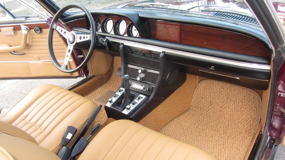

You are correct. The 'saddle 07' color seats seem a bit "naked" without the "tucks". I finally put my short shift kit in tonight (Getrag 265) and was able to compete the console. I can start taking pictures of my now "complete" interior. Will take/send pictures tomorrow.

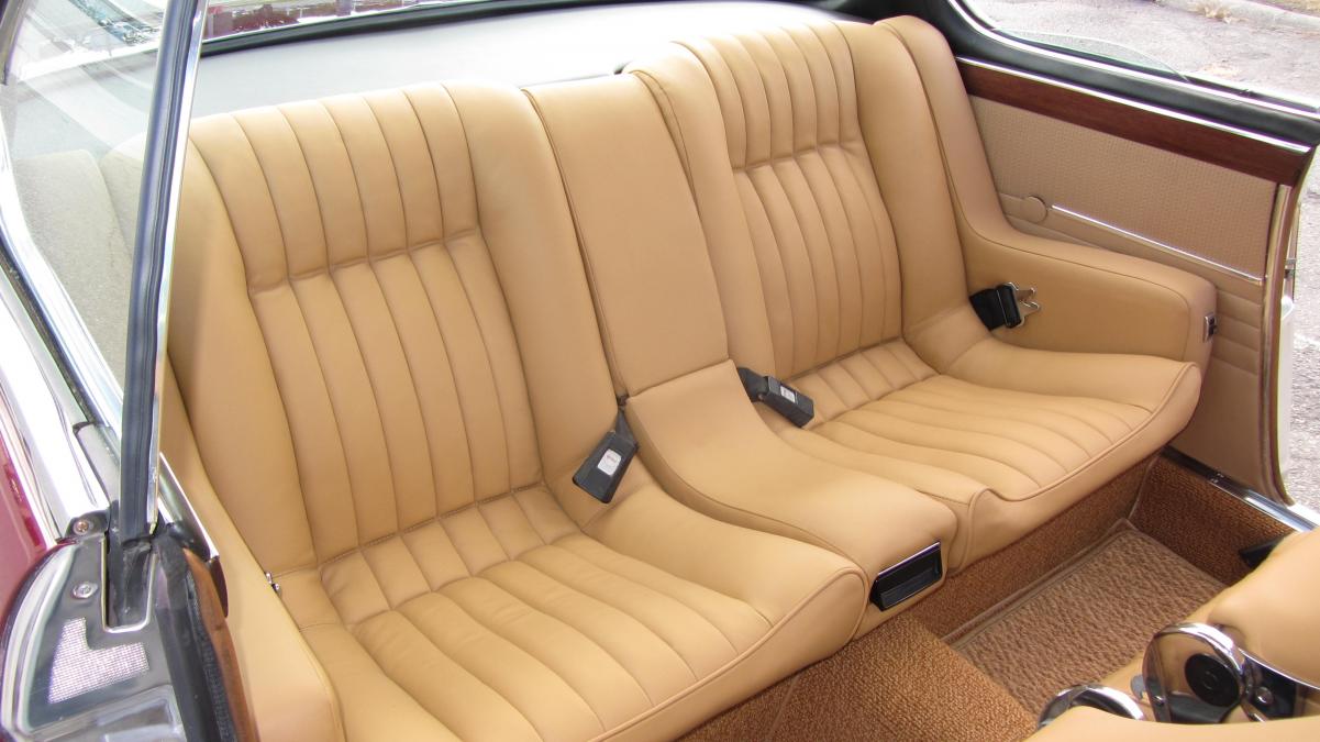

I recently saw Pat's interior and it really does look exceptional. The shop that fit his GAHH kit took extra effort (and time) to get the tucks to look correct. Although the shade of tan is a bit more "buttery" than my original saddle it still looks very good. As for the wood, I think the shine is pretty subtle and compared to my matte finish is just fine in my book. Overall Pat's car looks really stunning in malaga/saddle.

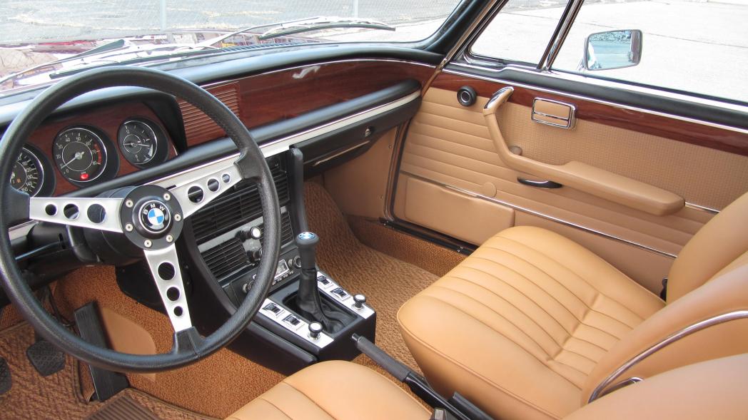

More seat tucks from 72CS
GAHH Saddle 07.
