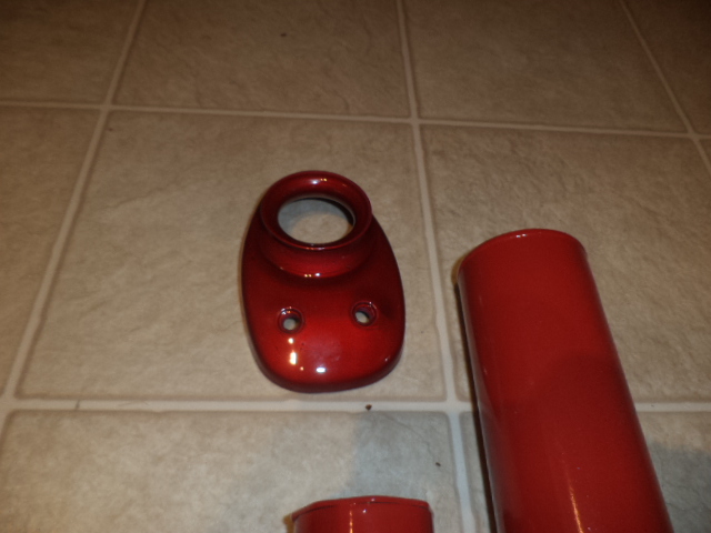

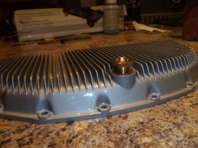

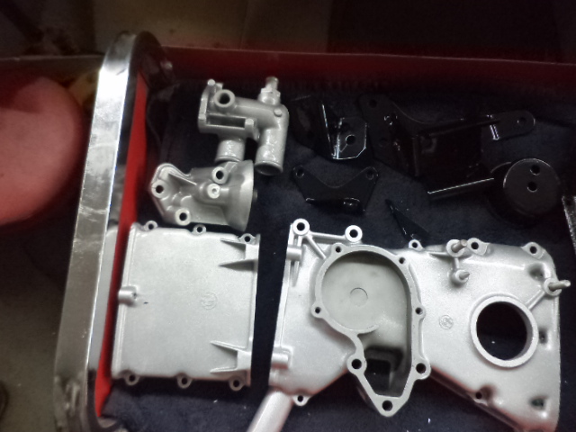

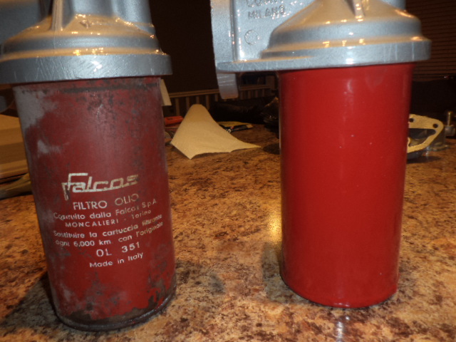

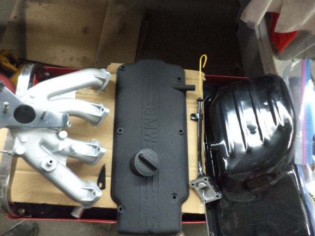

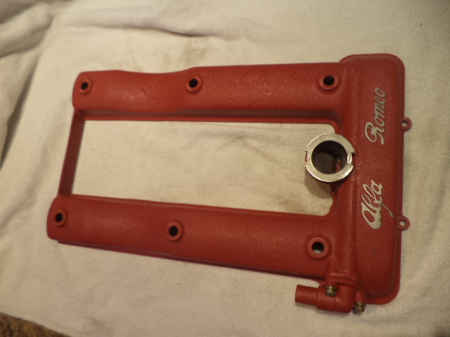

I have been powder coating all y own parts for quite some time, using both an oven and infared lights for bigger stuff. I like it for all sorts of parts, especially because of the different colors and textures that you can get from wrinkle and translucent colors. As far as the subframes go and a lot of the undercarriage stuff, I use POR-15. It will stand up better under tougher conditions. I like to drive my cars all the time. Engine parts, trans parts and trim stuff looks great powder coated. I can glass bead the part in the AM, powder coat it right away and in a couple of hours, bolt it on.
Here are some pictures of some BMW 2002 engine parts for my son's car, some Alfa stuff and some suspension parts for a 911 that I did. Springs can be powder coated without any issues
If anyone has any questions feel free to email me [email protected]
Thanks, Rick

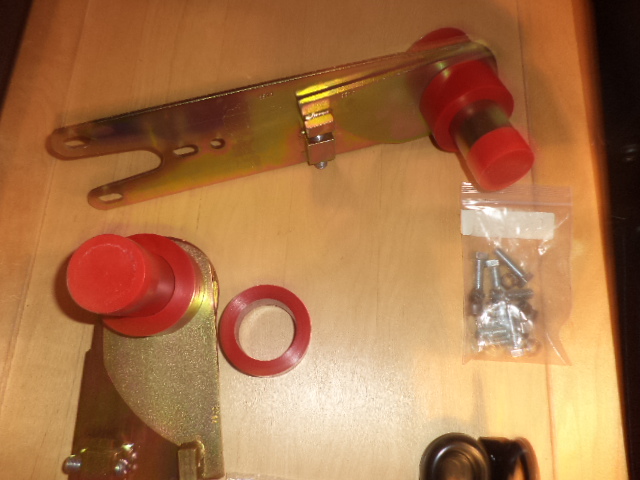

Great job! Are the last two pics plated or powder coated? If coated, what is the name of the gold powder? Does it have color shift in it to look like cadmium plating?

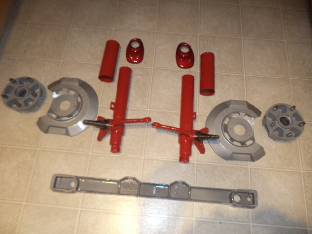

No they are plated, I actually grabbed the wrong photo Here is the Porsche suspension that I did
