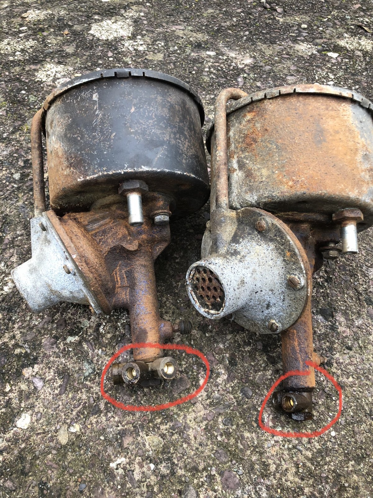

Should I remove the “banjo connectors “
Beforehand or is it okay to send the servos with them still attached ?
I removed mine, as I didn’t want them to go missing.
Okay
That is what I was thinking too .
The drawback of that is I would then need to find my own seals / gaskets for them.
Did you purchase those seals somewhere ?
What material is good to seal against brake fluid ?

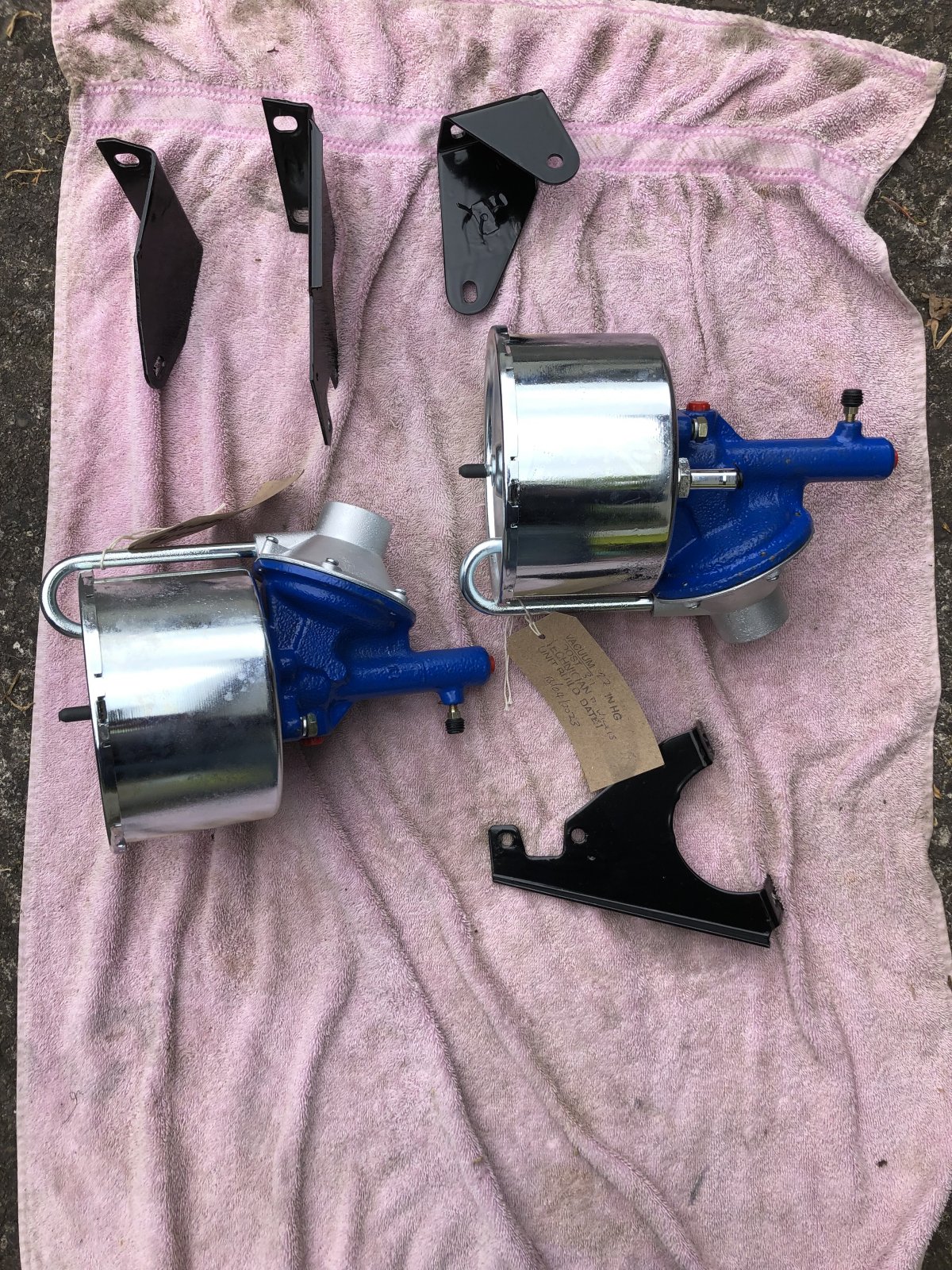

I sent mine off and got them rebuilt by past parts uk
They did a great job on them , now I haven’t actually got my car running yet , so as such they have not been road tested but I was definitely happy with the service they provided.

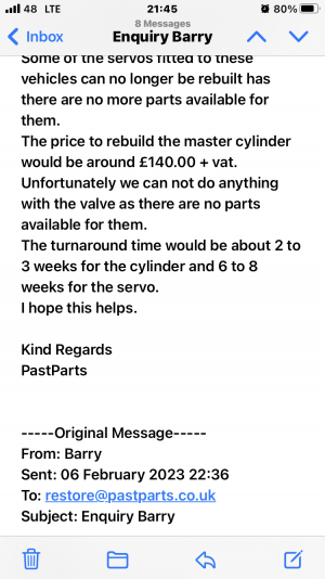

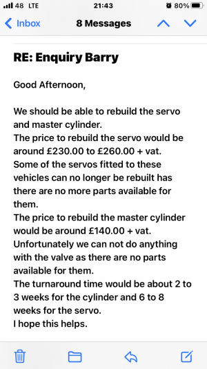

I had asked them if they did repairs to the proportioning valve also , but they don’t.
Because of Brexit you will have to pay import duties to get your own parts back , which is a bit sad , but I don’t think we have any options to get them done in Ireland.
Plan ahead also as you are looking at approximately 6 to 8 weeks turnaround.

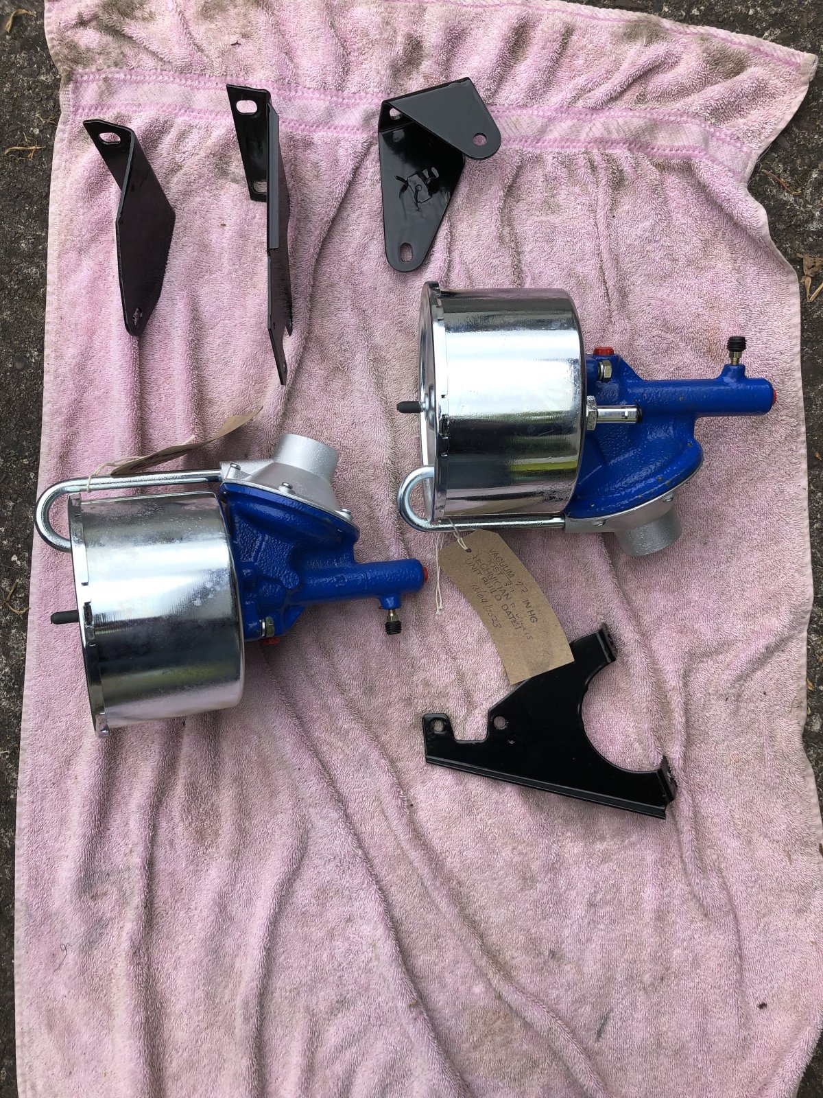

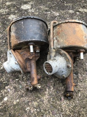

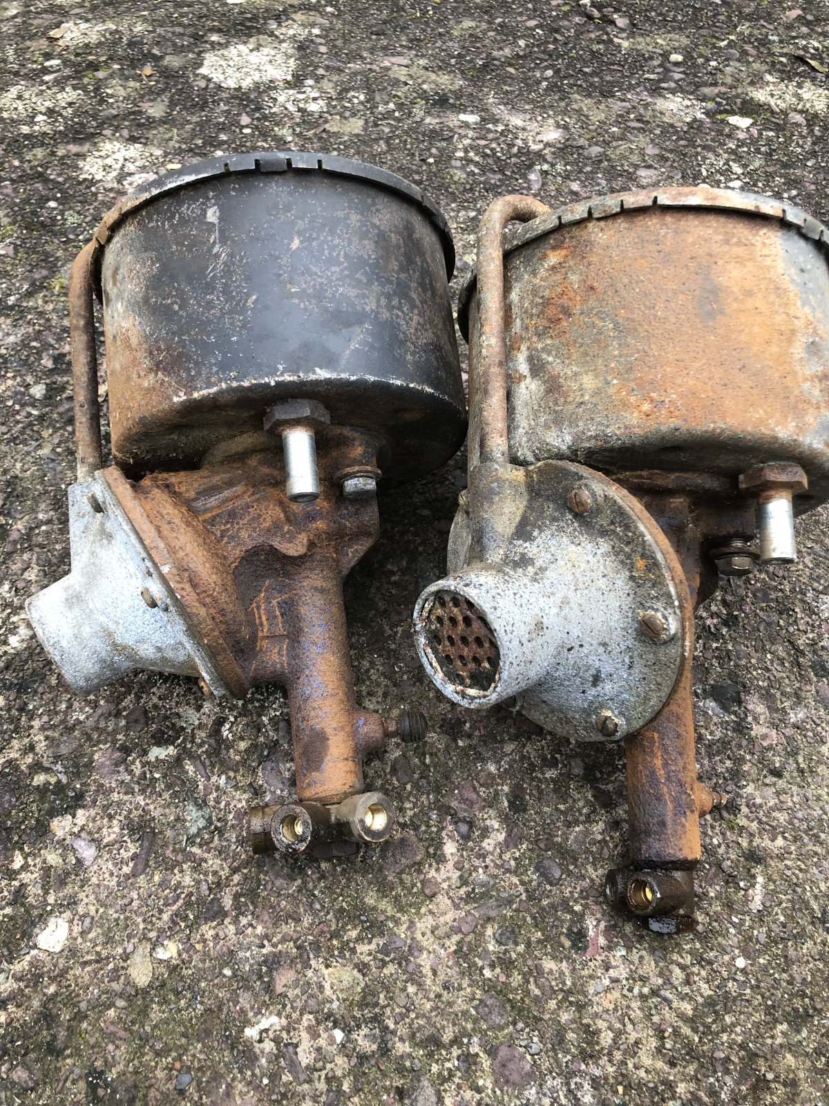

Here are before and after pics :

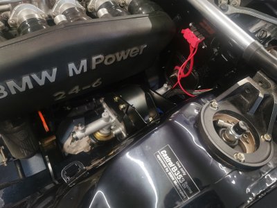

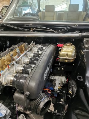

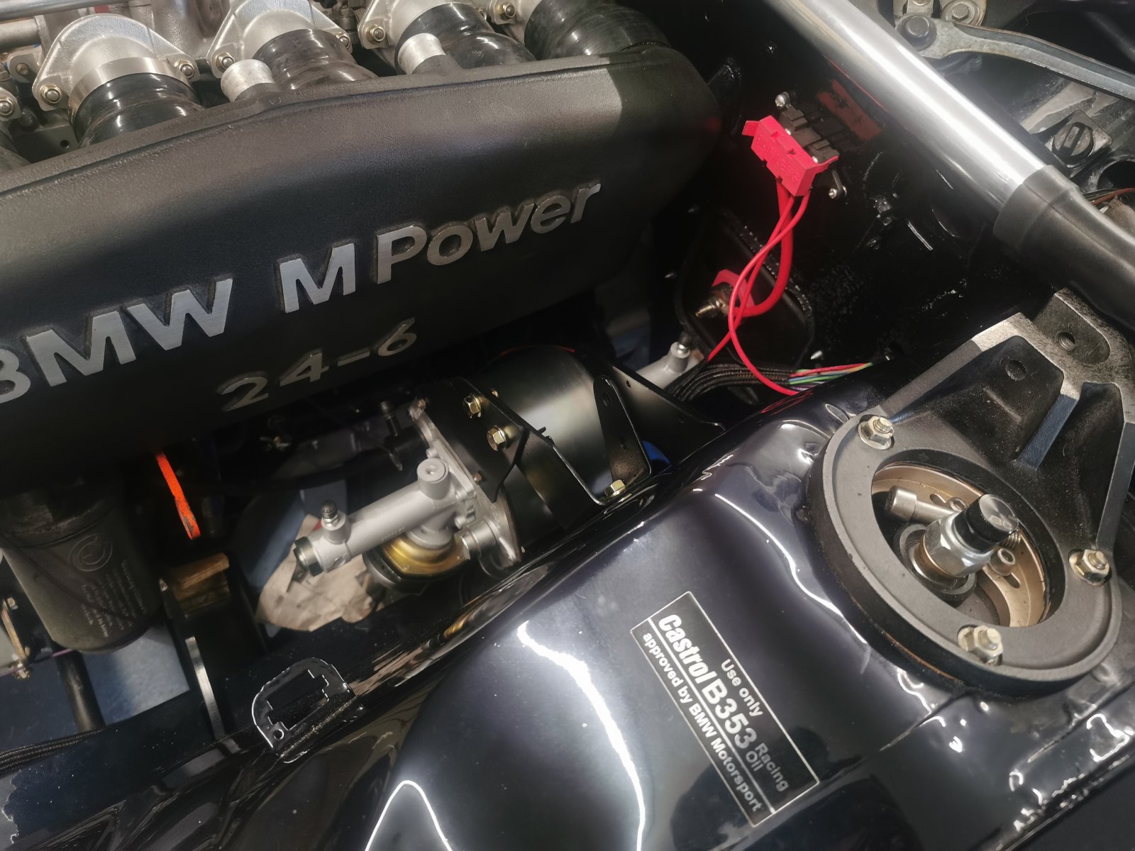

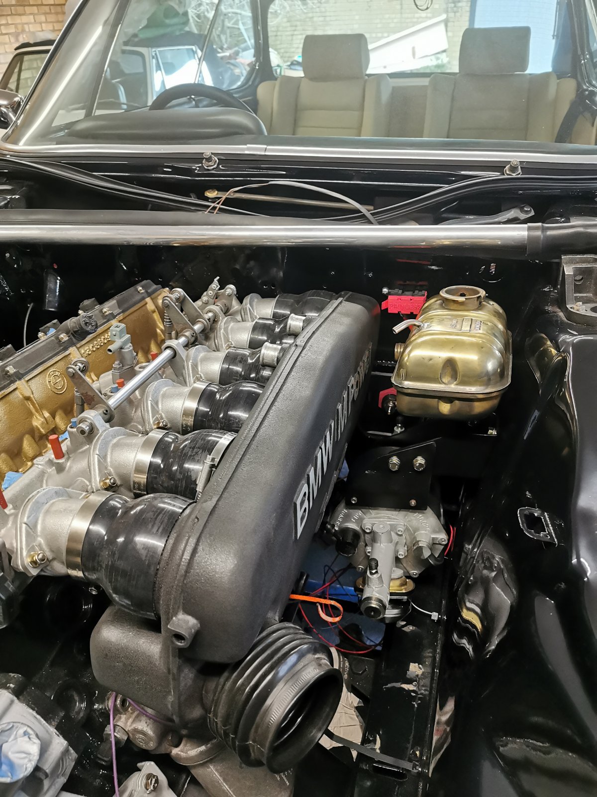

This was my solution. Twin circuit booster from the same company @Rek purchased from. Only issue I had was that the outlets are 3/8 UNF rather than M10. I have reused the original banjo bolts and unions from the bmw servos but retapped the banjo bolts to 3/8 which is about 9.5mm rather than 10mm. Frees up a lot of space, is lighter and less than half the cost

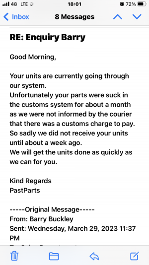

Another question. I have sent the servos and the master cylinder to Pastpart in the UK . I have just found out that they are being held pending payment of customs charges. did that happen in your case. Thank you, Seán.
Hi Barry,
Hi Seán
Mine were also in customs when they got to the Uk.
I was not aware of it at the time though.
Past parts took care of it themselves.
I only found out when mine seemed to be running late on the scheduling.
I only had to deal with customs myself when they were coming back into Ireland.
Hi @nosmonkey , thanks for the tip, I'm considering this. How did you go with the brake lines? Were you able to use the existing ones, wondering if they would be in a different position?
