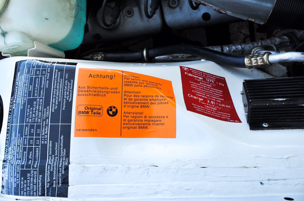

Here are some of them in my ‘73 CS.

The problem is that there are many different sticker sets available and most of the ones I have seen are not correct or are not correct for a given year. The tire sticker Carl sells was never on a US market coupe, there are two or three red A/C stickers, the oil sticker is the one that is most often incorrect. And the paint stickers for 72 and earlier coupes are in Italics and aren’t available either. Mo would need photos of guaranteed original stickers with dimensions to accomplish this.

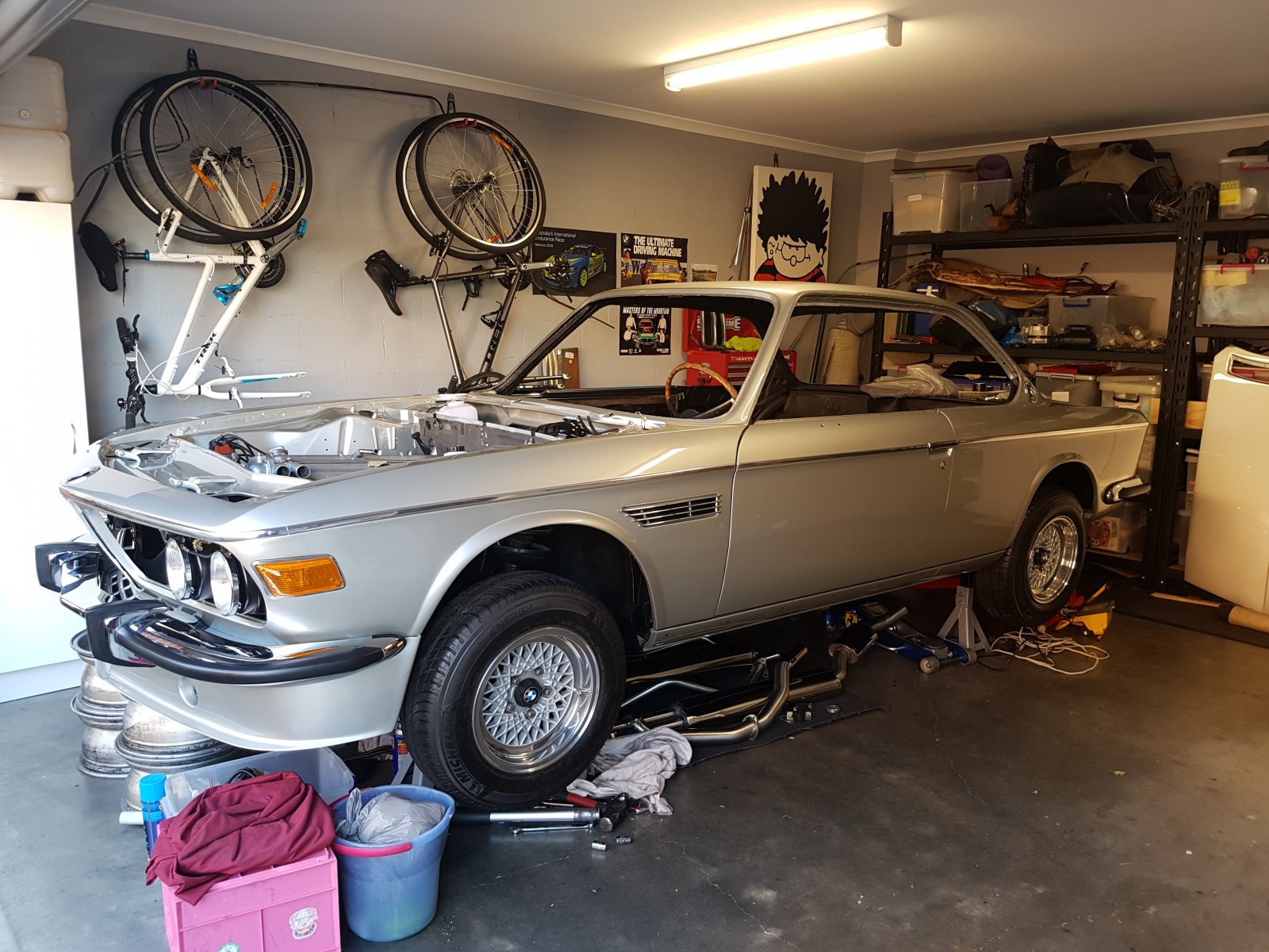

I am in Melbourne Australia restoring a 1969 2800cs e9. Looking for under bonnet decals especially the main sticker shoView attachment 57037
wing the model 2800cs. can anyone help? Cheers
Nice car! I believe your oil decal is different but other decals should be the same. Fuse and tire pressures may also be different -- 2800 owners may share wisdom.....
