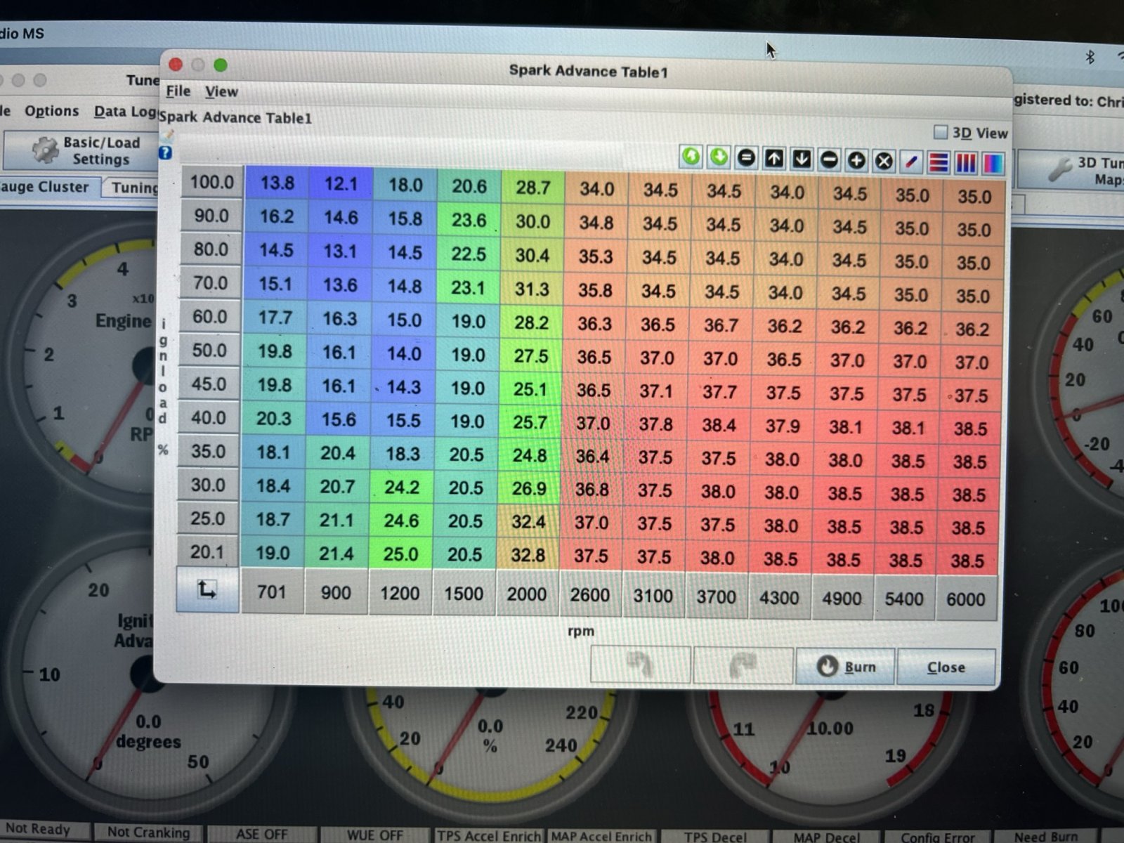

Agree, very difficult to determine if small changes in advance make a difference. I’m all in by 3k max 36 degrees, idle is 15 which the webers love. Next up will be a dyno to really see what it wants jetting and timing. An afr gauge is ultimately unreliable - to many changes in readout when temps and humidity varies.
