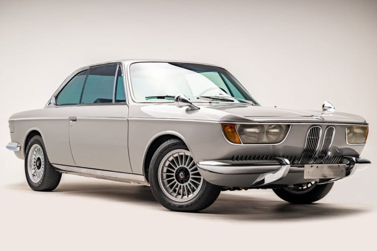

I think it looks ok on this car:
That tire is wider than mine and mine rub on the inner fender. No power steering makes parking a pain and narrower tires are so much more nimble. YMMV
What I'm reading says they're both 7.7" wide, which makes sense they're both 195s, and yours (195 70R 14) is 24.7" diameter vs 24.2" for the 195 60R 15.
It’s not the diameter, it is the width, 195 vs. 205 is 10mm or almost 1/2 inch wider. Maybe it won’t be an issue. The Maxilite wheels have a step on the outer rim and the spokes have sharper squared edges unlike real Alpinas.
