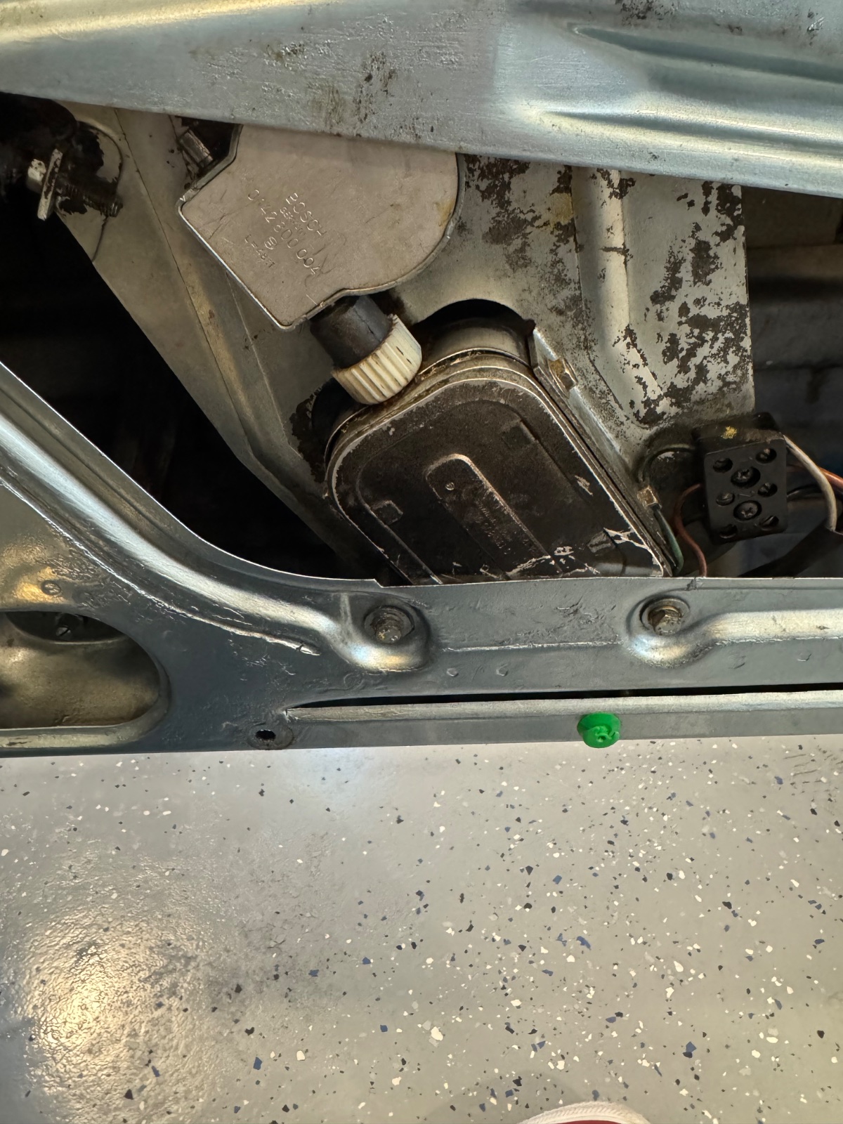

Also take a look on that black spiral spring mounted directly on the pivot of power mechanism itself, it might be also dirty & sticky.

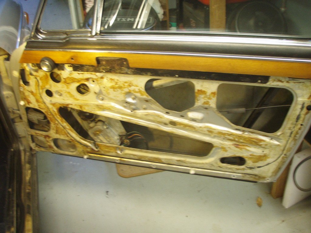

Some info here on how it's all mounted.

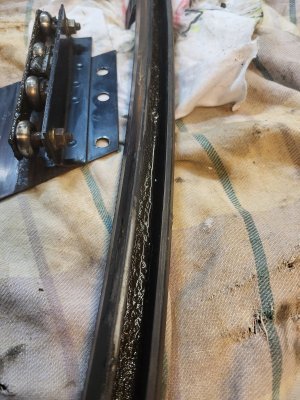

I guess your tracks look like this on the inside:

Yes, my track looks like that. Going down, very smooth and fast. Going up, it sounds like something gets jammed in the front rail.

I have an HBChris question... when did the sardine motors get swapped out? I have a 73 Euro and I do not have sardine motors.
