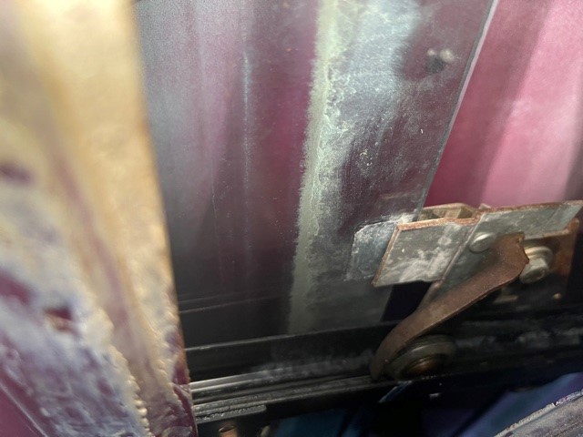

The back bracket was not holding, but the front one was - so instead of removing everything I just pushed the glass out of the bracket, cleaned it really well with window cleaner and some nail polish remover, then shot some 3M Channel Bonding and Sidelight Adhesive in there, snapped the glass into place and rolled it up and left it overnight. Seems to have worked, hopefully that's it. But here's what it looks like for all the noobs like me. There is a large spring that will pop out on you when you remove the door panel, it goes over the window crank handle.

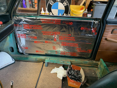

I've started to use adhesive rubber/tar backed window flashing as a super water barrier / insulation layer. Cheap, effective, and easy to work with. Photo shows its use on a 2002, for reference. Available in different width rolls... I use either 6" wide or (9"?) wide.

Maybe I am not clear what we are using the 3M bonding stuff for. From your pictures, you are missing a rubber gasket that wraps around the window where the back bracket holds the window. Adhere the rubber to the window with 3M gasket adhesive, slide into the bracket. No need for glue between the window and the bracket.
