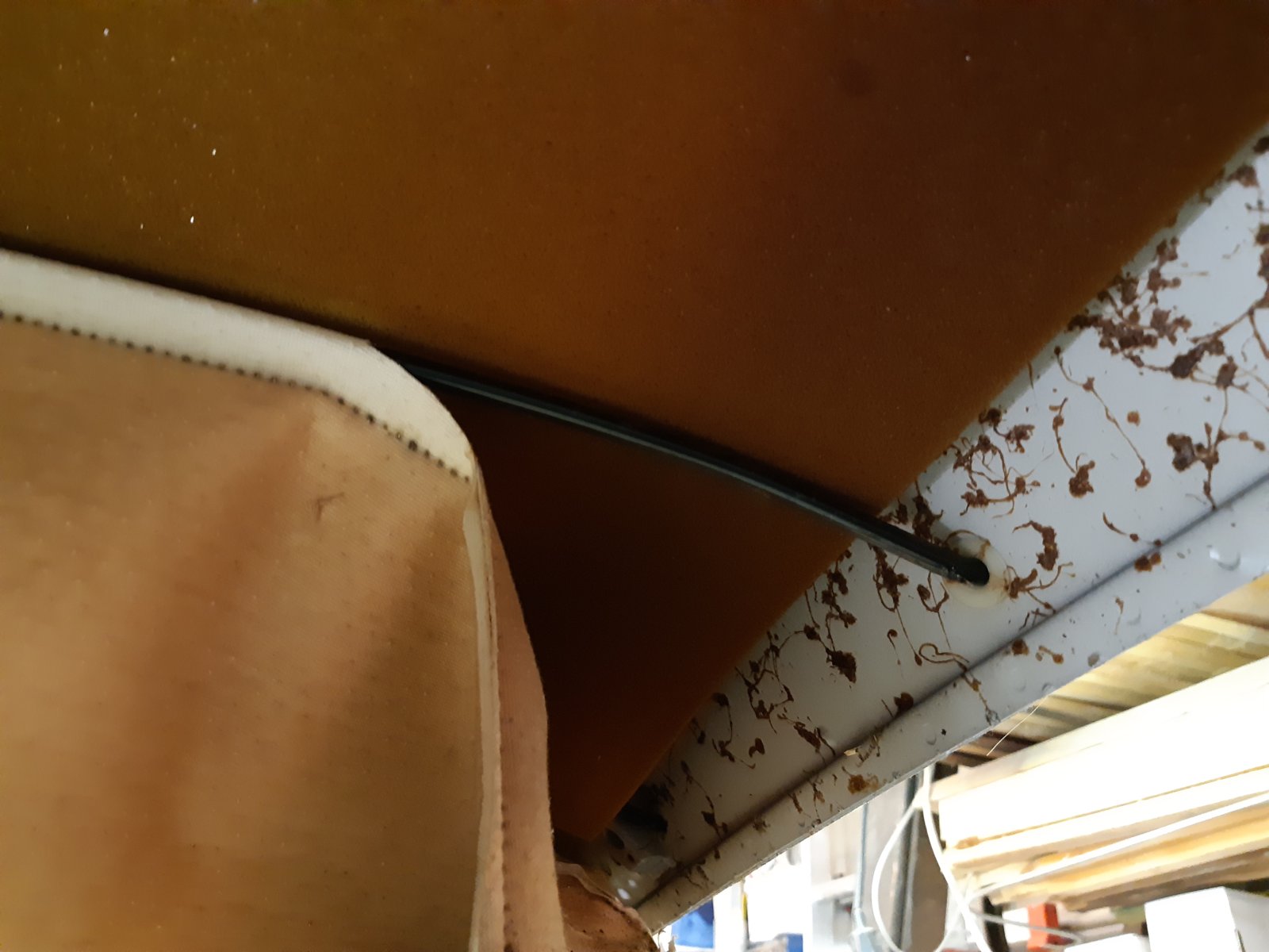

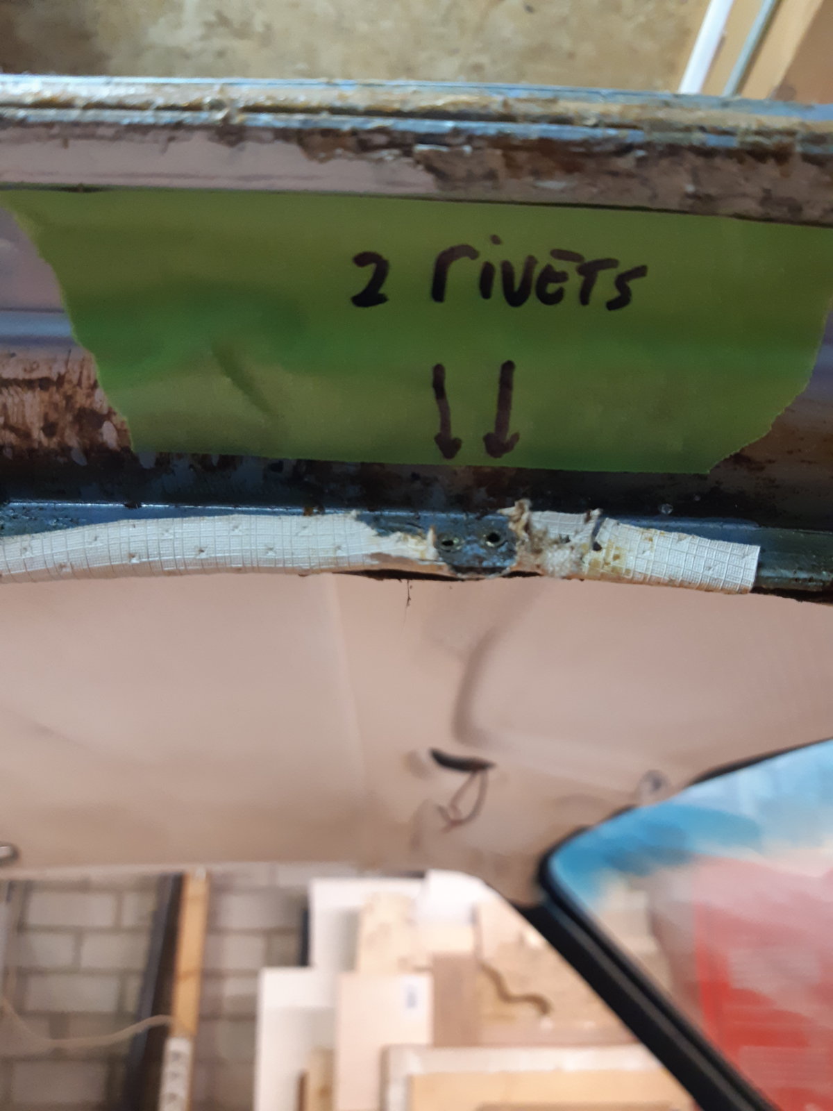

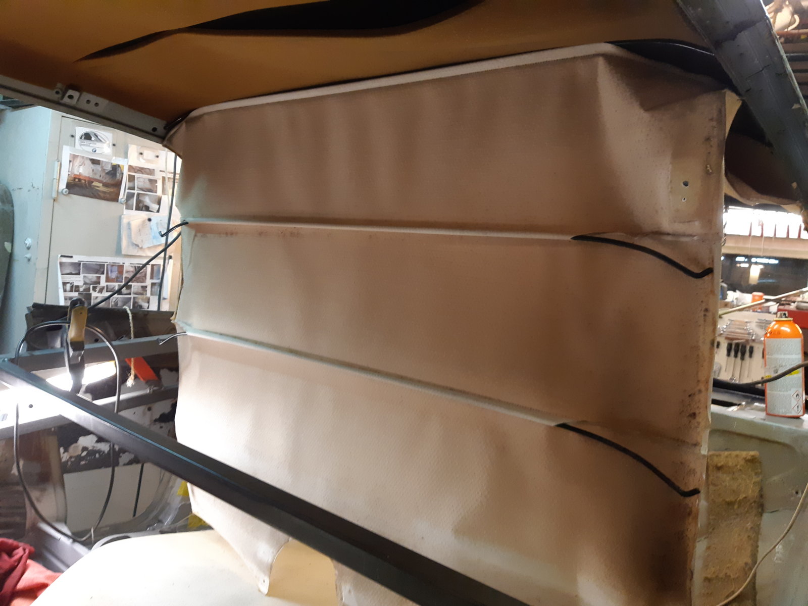

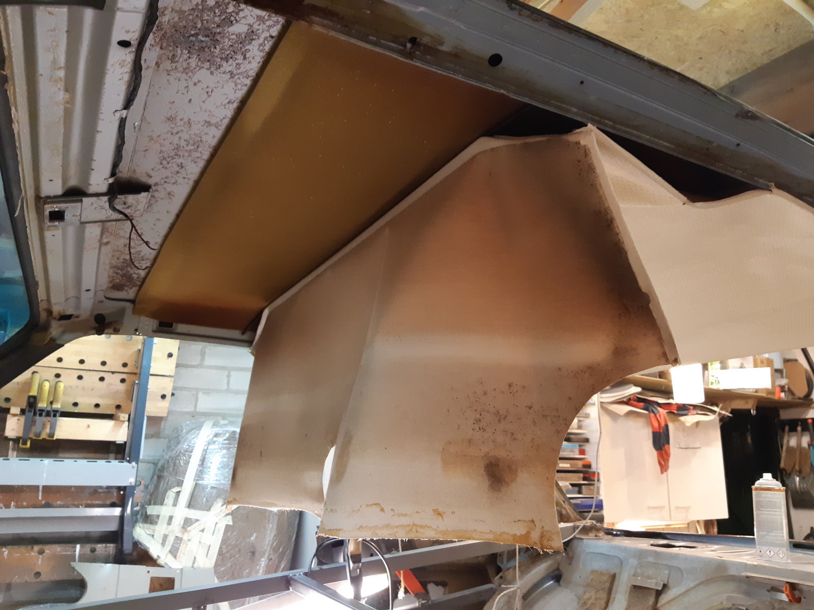

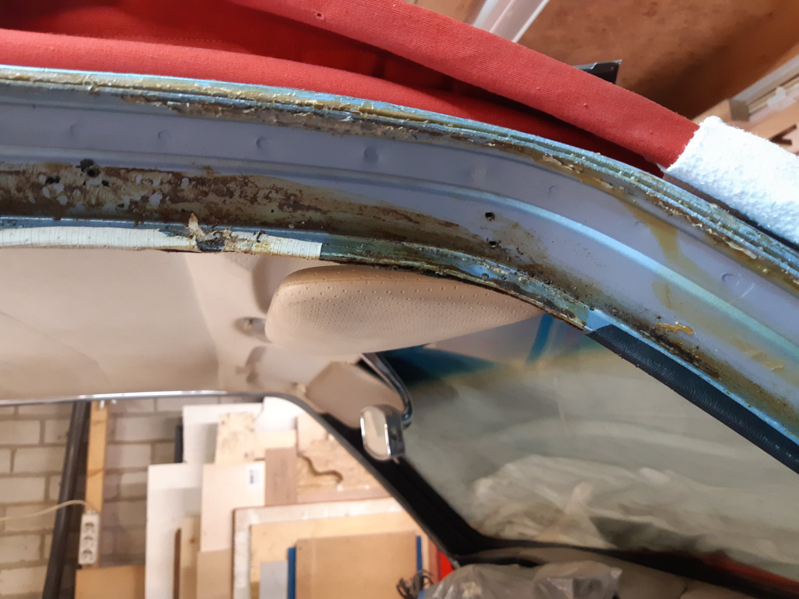

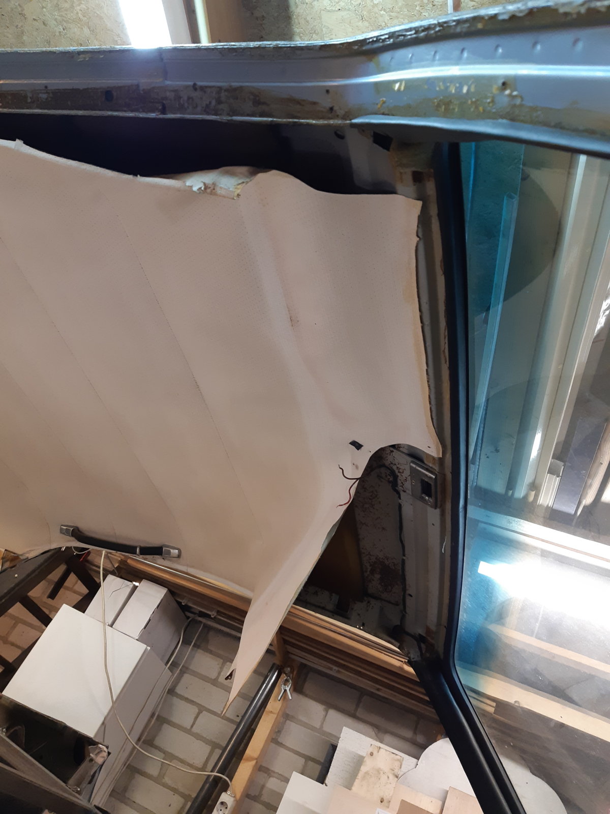

Here's some pics that may help you from my car (which has no sunroof as you'll see.) Important hidden things are the 2*2 small rivets hidden under the roof trim. I also think that it requires the rubbers & alu trim to be pulled i think).
roof+A-pillar; just left of the middle are 2 rivits normally that are hidden. I think it is the same for sunroof cars. In my car it located the textile headliner and also the front headliner panel.
after removal of panel, sunvisor mounts and rearview mirror (no sunroof car):
pull glued textile
To unhook baleens, push them up in the middle; pull them out of the plastic guides. this actually is very easy, and creates much more access to the roof.

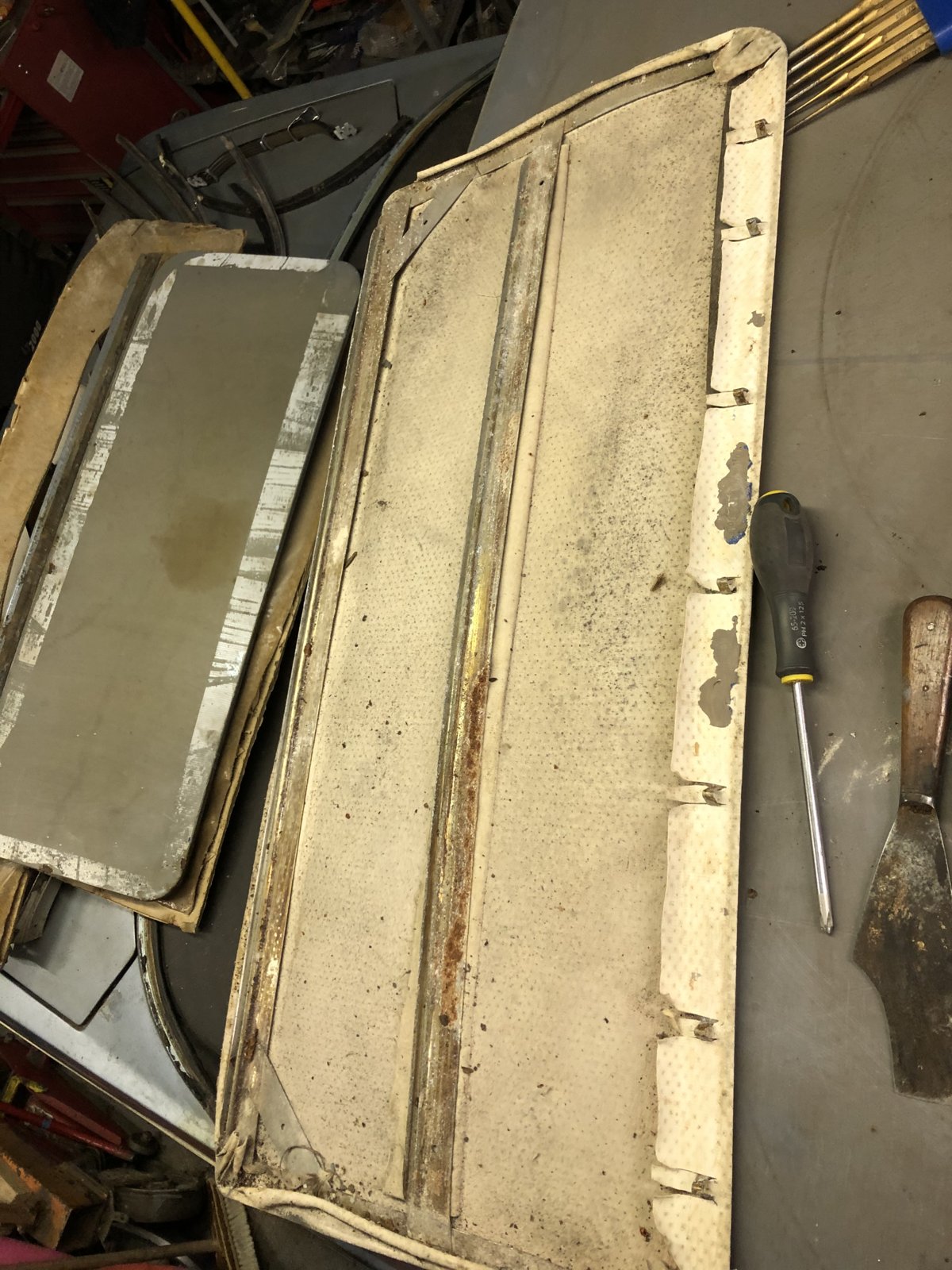

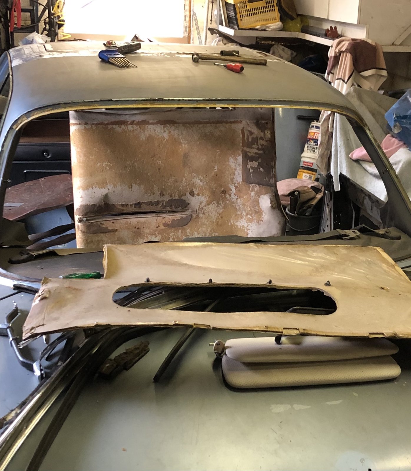

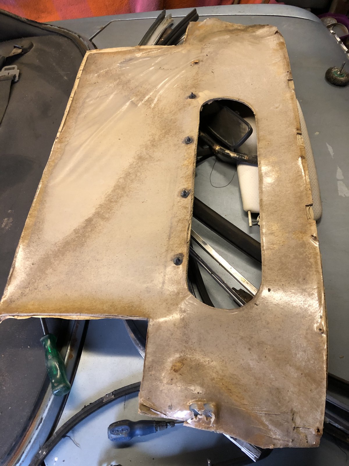

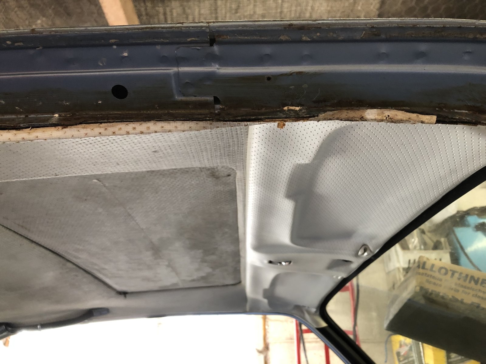

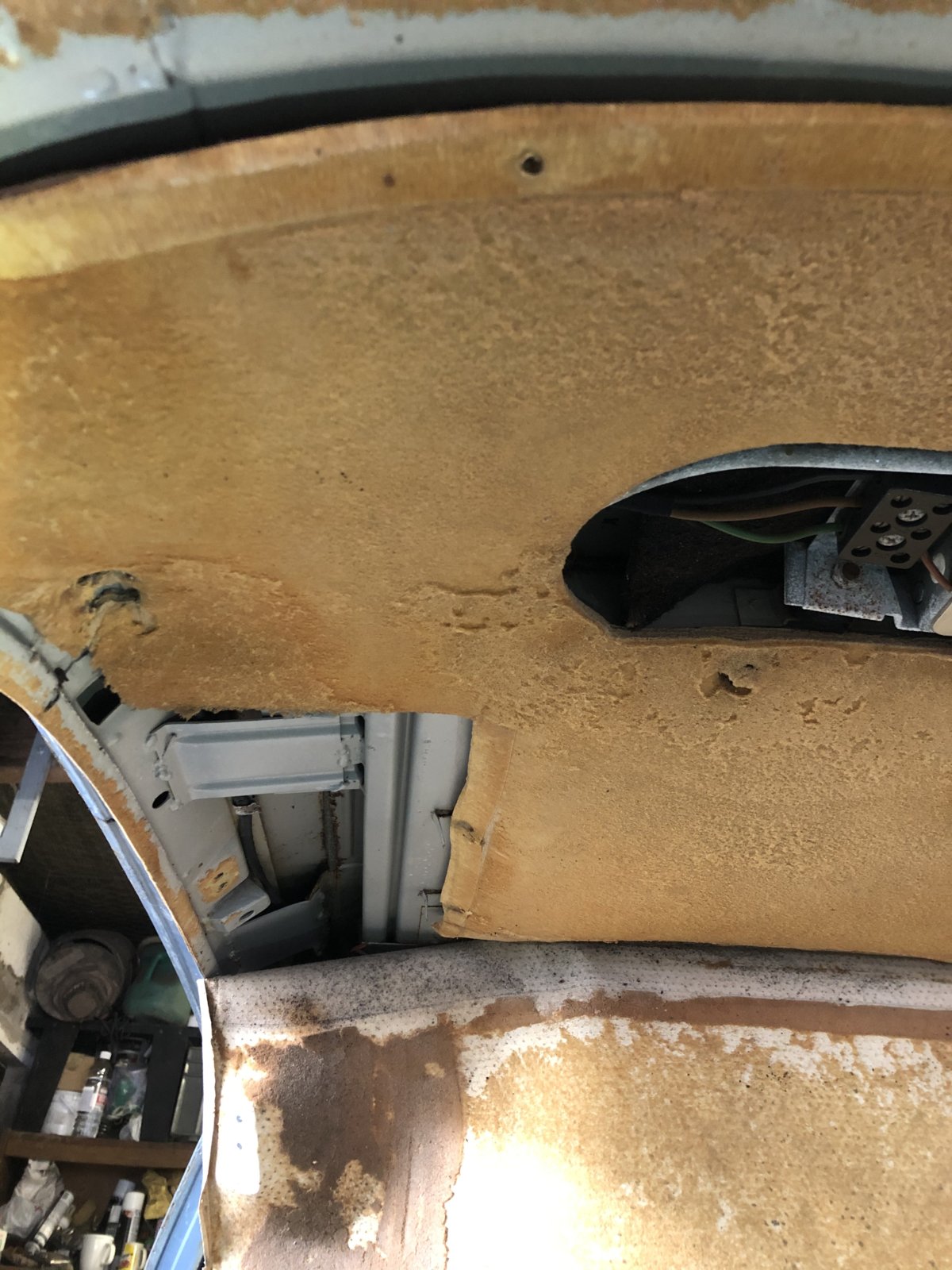

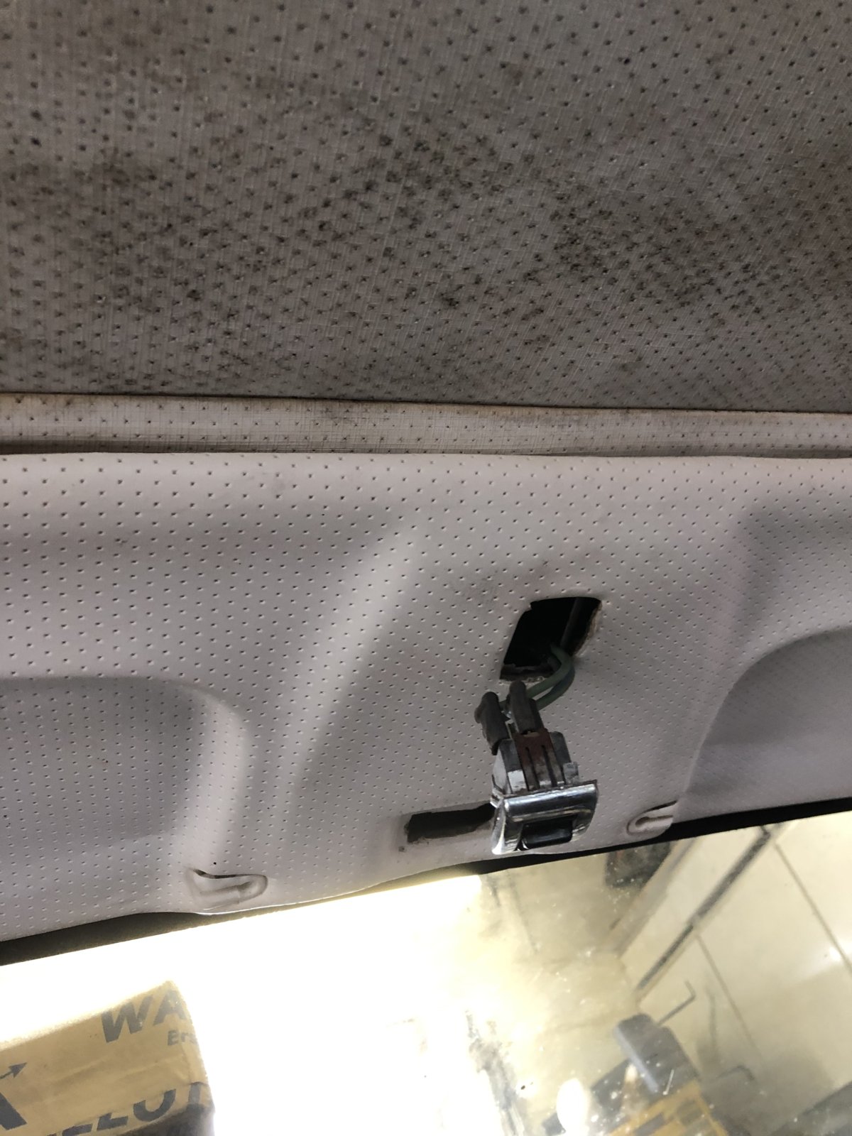

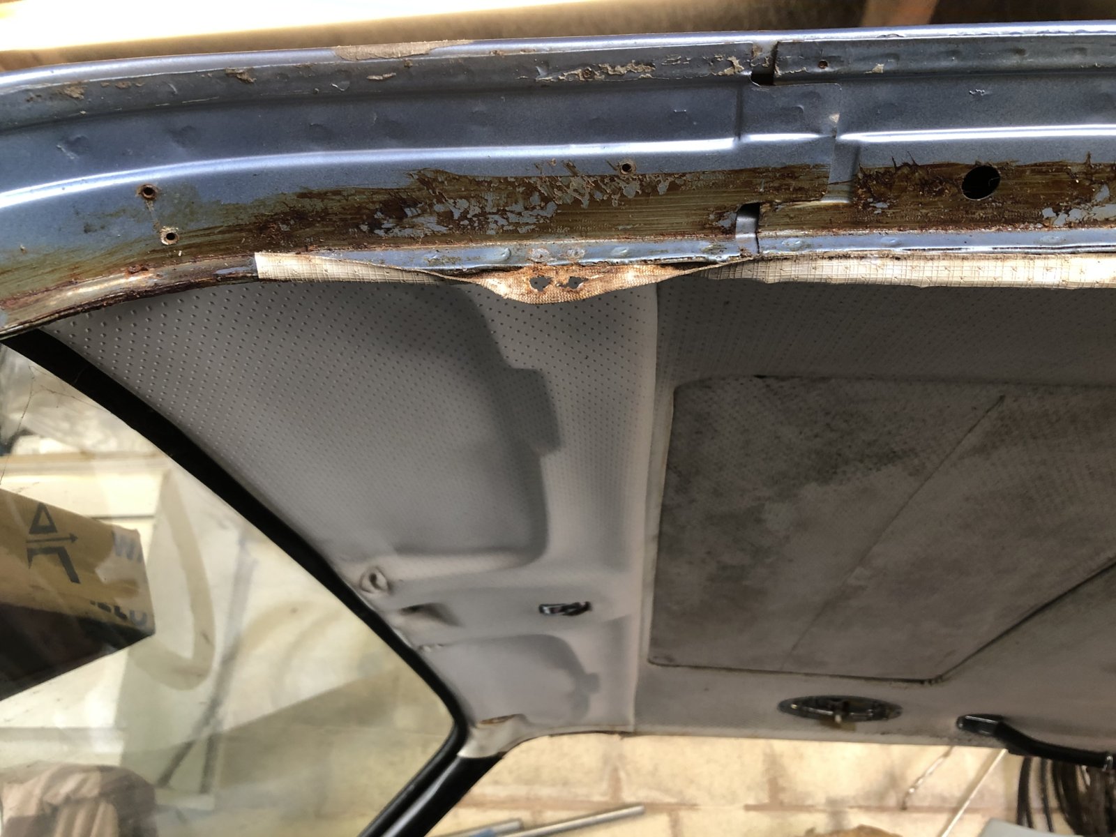

Okay , so I just got my headliner out .
It turns out that the sunroof cars don’t have baleens ( I have never previously heard that word before today ) they have a large board with foam glued to it ( all crumbled and turned to dust now ) and I think the headliner should have been glued to that foam .
Anyway I followed the advice so thanks again

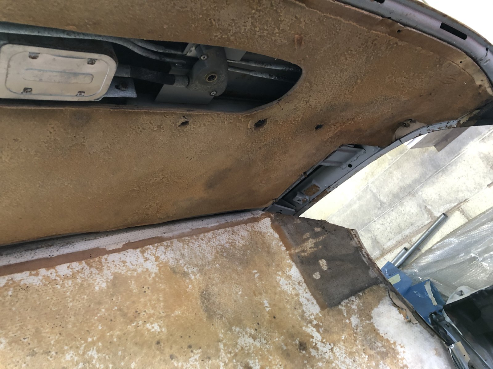

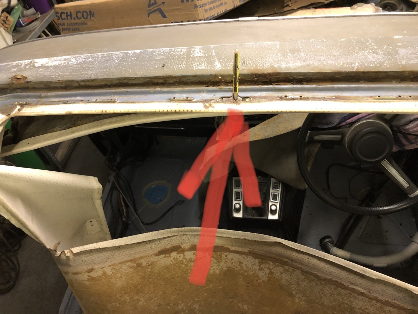

my front headliner would not let go from inside the car , so eventually after discovering that my sunroof motor spins but does not turn the cable drive to the sunroof , I then managed to manually move it enough to remove the sunroof from the car and once you take out the aluminium guides you will find 1 last screw and it was the one preventing the front headliner from coming out . It screws down from above into the front headliner, I put a yellow pencil beside it in the photo to show where it is , just in case anyone else needs to find it some day.
I am 99.99 % sure the headliner does NOT glue to the board
that is interesting, it looks like there was glue on the back of your headliner, so I guess I don't know
when we were doing mine I asked about this, not sure if I ever got a firm answer, but if it is glued to other than the edges I don't know how you would ever get it smooth, there would be a 'step' where it left the board to the outer edge
Replaced mine with MDF, put poly on it to make it water resistant, glued foam to it. I did not glue any foam to the headliner. I believe if the headliner is tight, it won't contact the board or foam anyway. The foam is for sound, I contemplated a thin X-mat instead but was fearful of the weight.
So rear glass out, front glass still in I presume.

Not glueing it would make putting it back in a lot easier too as it won’t be glued to the board slightly out of position .
I might have to remake my board too as it is well past it’s best before date.
