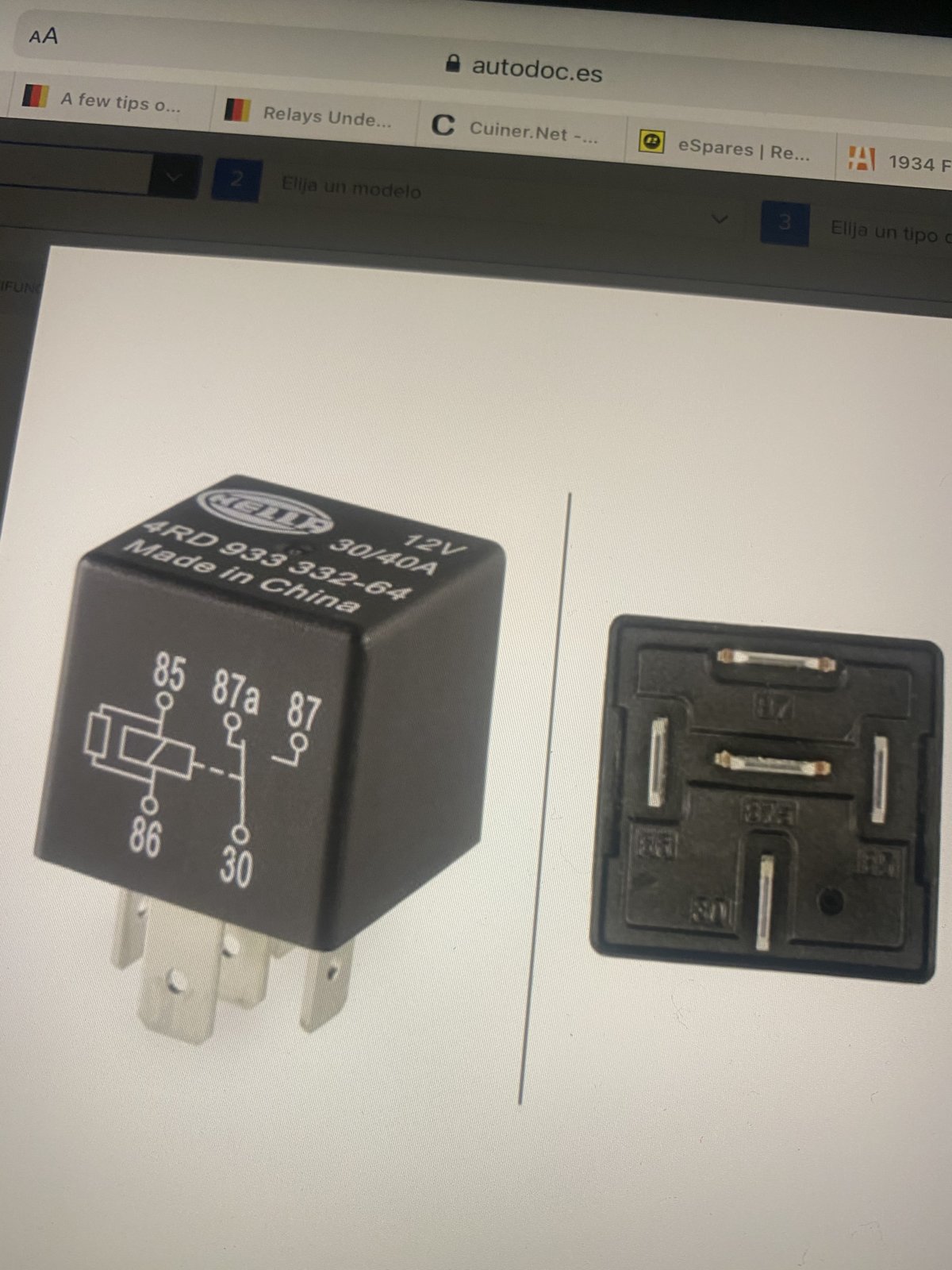

This ones I used for the windows (photo). But don’t need to Hella, those are better and more expensive

I bougth at painless Fan relay kit.
And the fuel pump relay kit.
Around $30 each.
