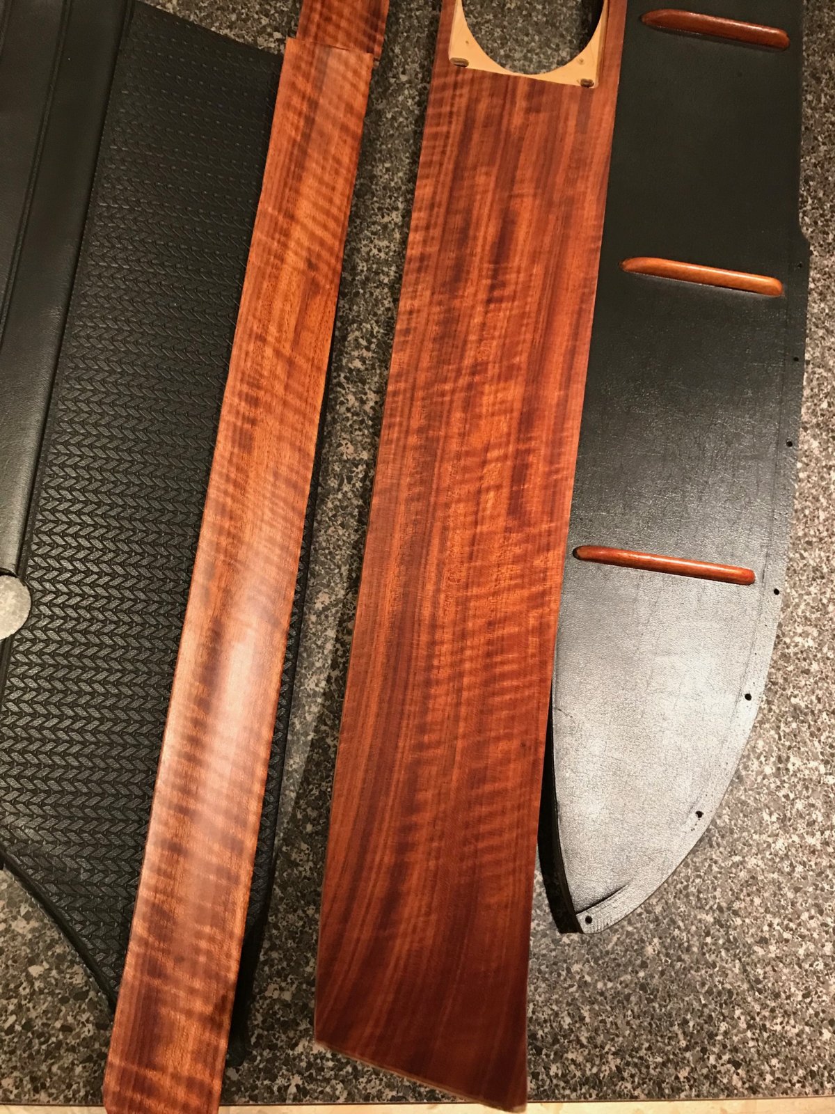

This is all new to me but I like to learn new things and this car has been great for presenting me with challenges. Things I have learned so far from bitter experience:
  1. Veneer does not like water, at least the stuff I used.
  2. Epoxy can burn. I had a swollen face and eyes like Mary Feldman for a few days, despite gloves goggles and correct face mask.
  3. The epoxy can be sanded and then varnished, or just polished. Just don't use wet n dry paper as thats how I found out about 1. above.
  4. Vacuum bags can exert a lot of force which can cause bending of objects if not placed correctly.
  5. When it does work, it looks quite good.
I used the epoxy for time saving, but on reflection I would have preferred using just varnish or lacquer.

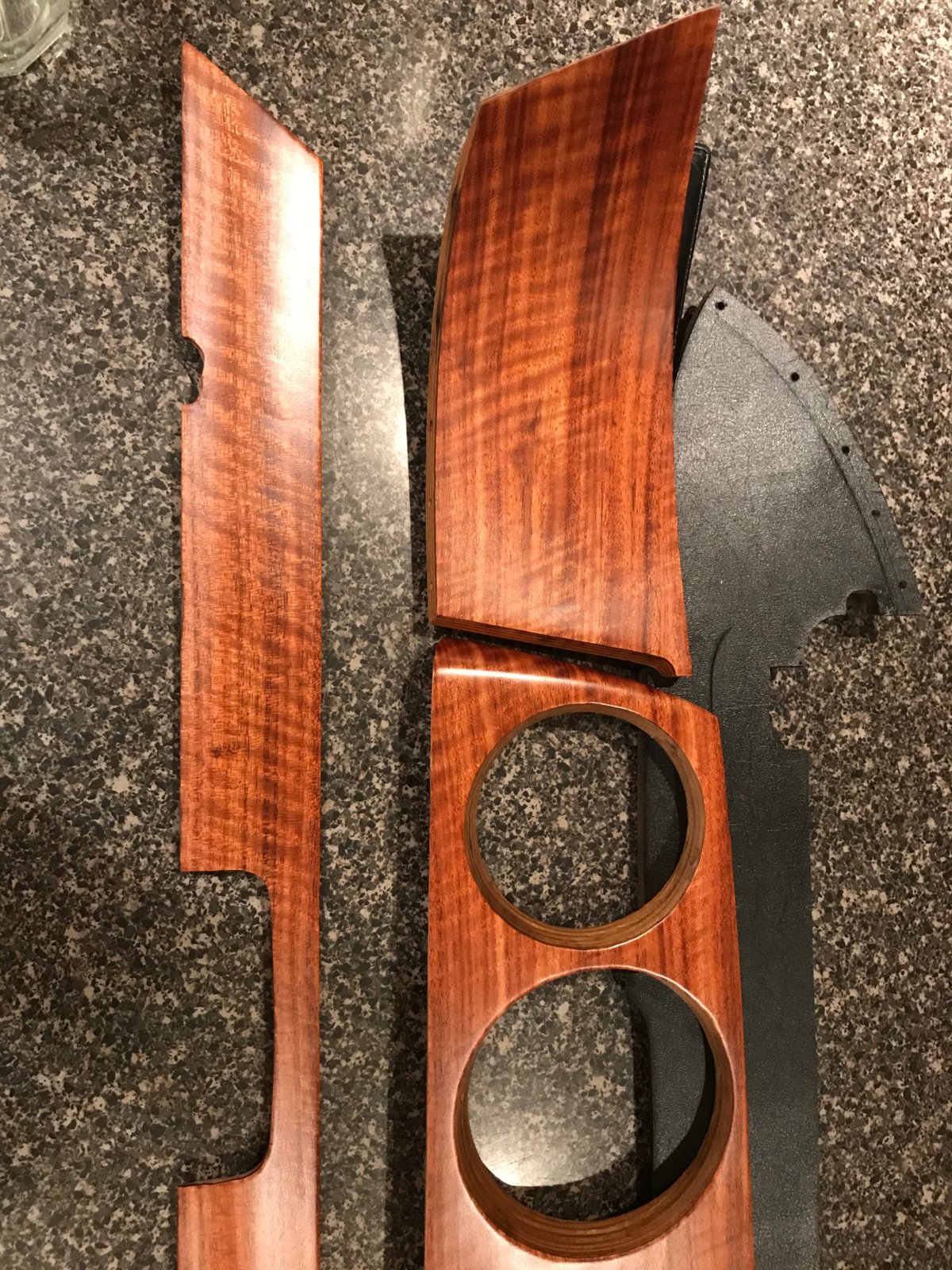

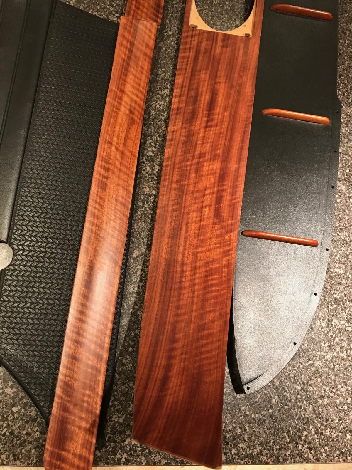

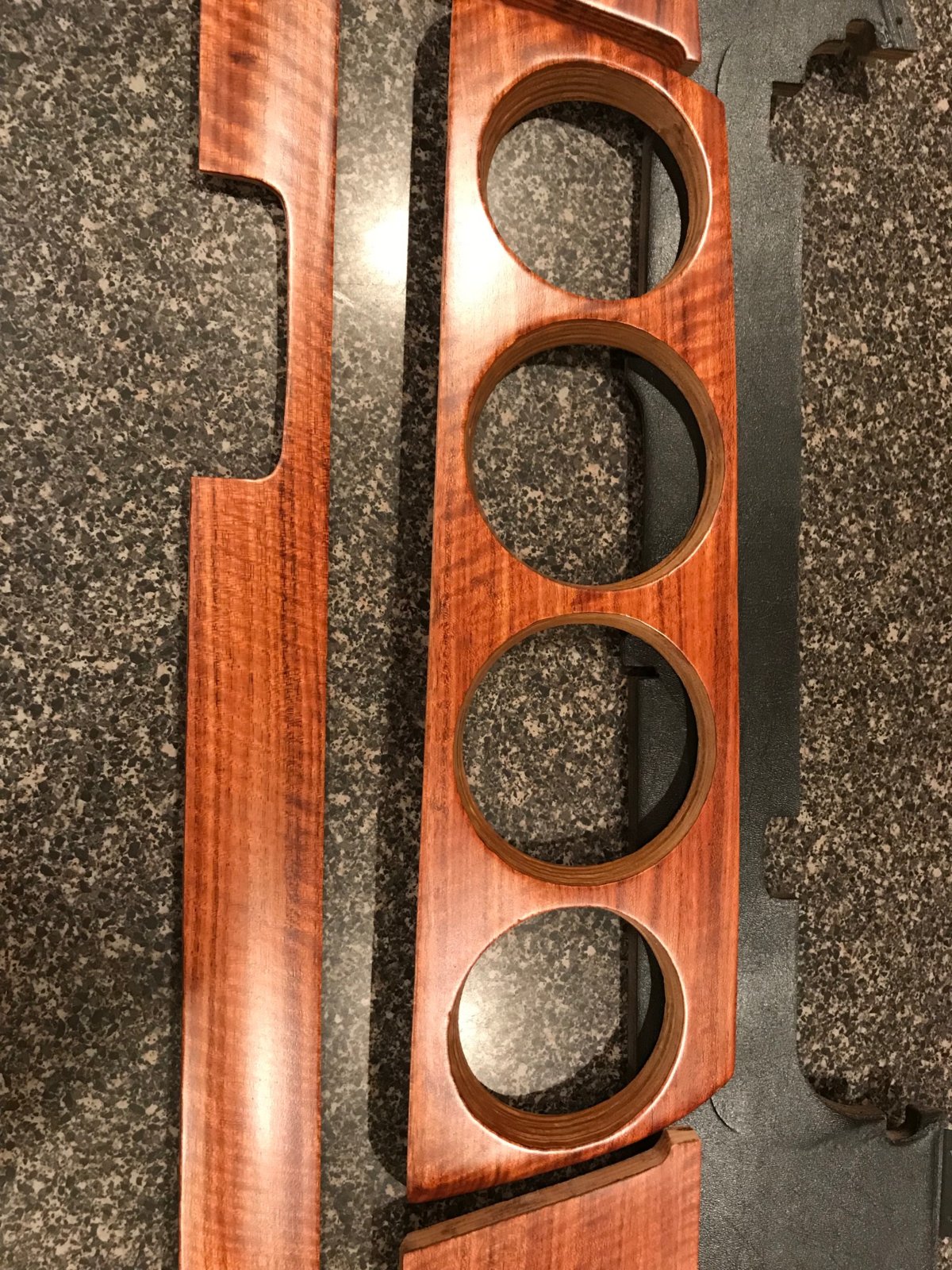

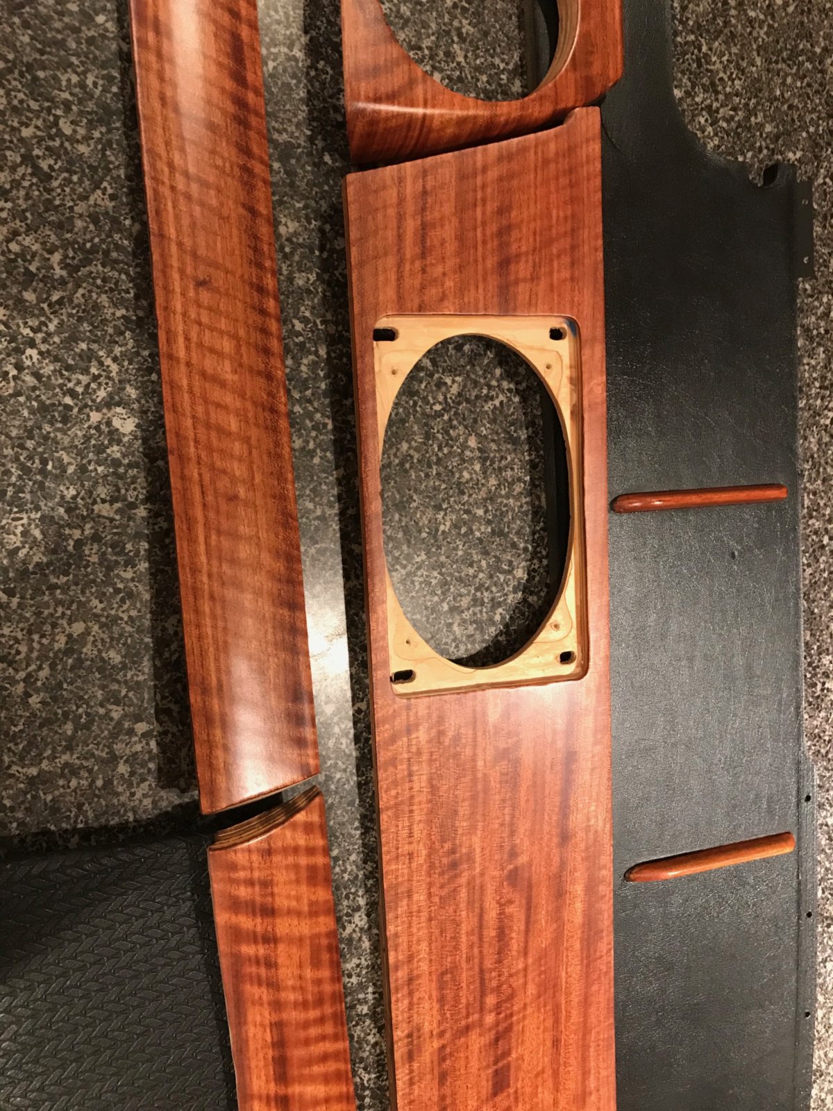

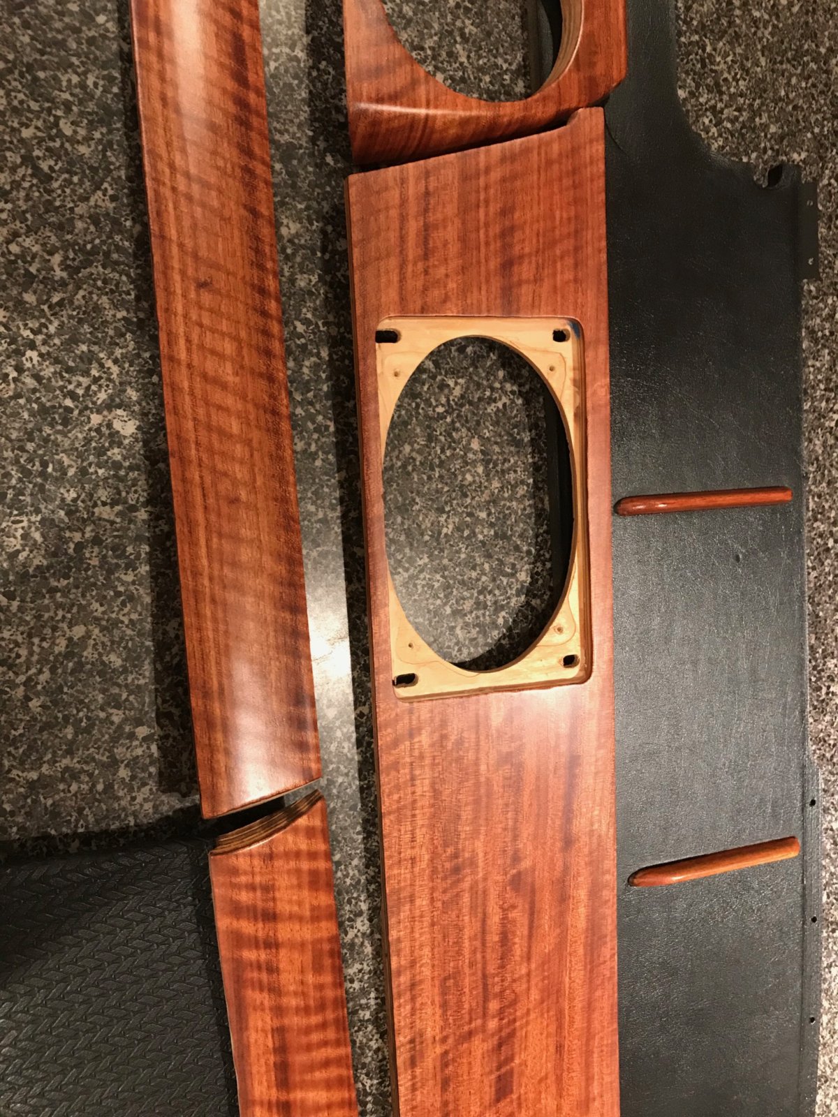

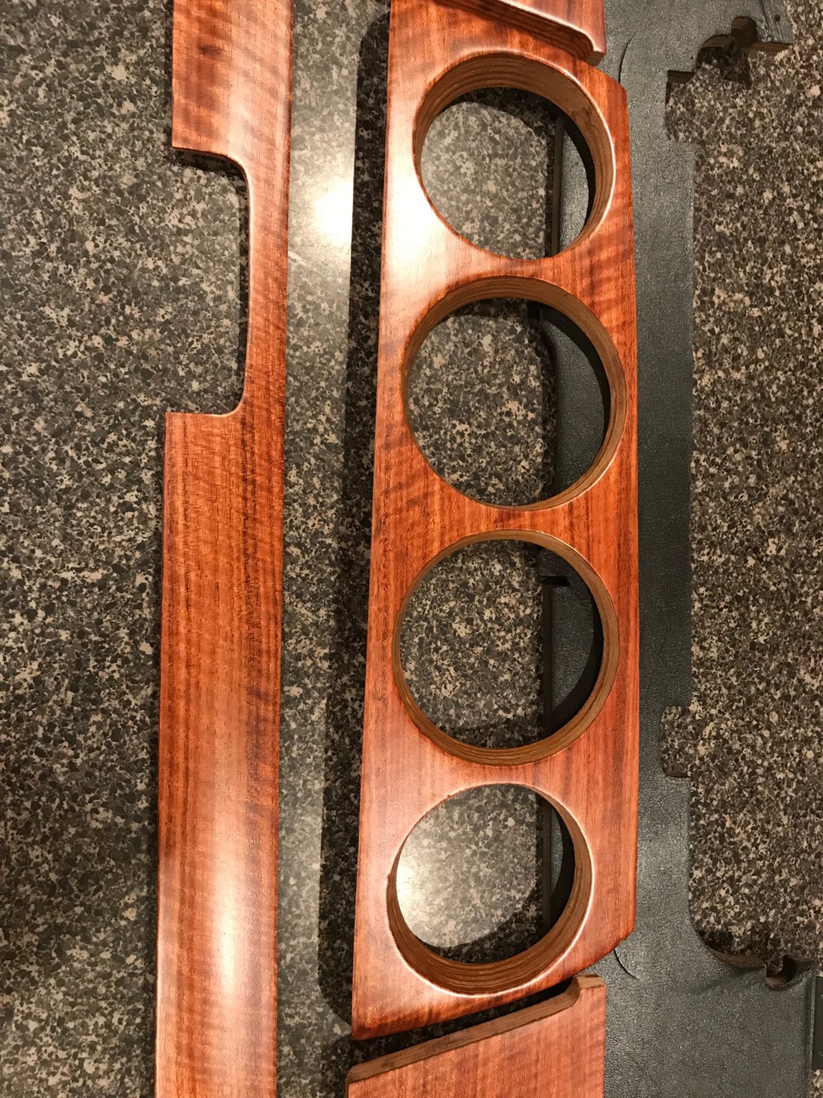

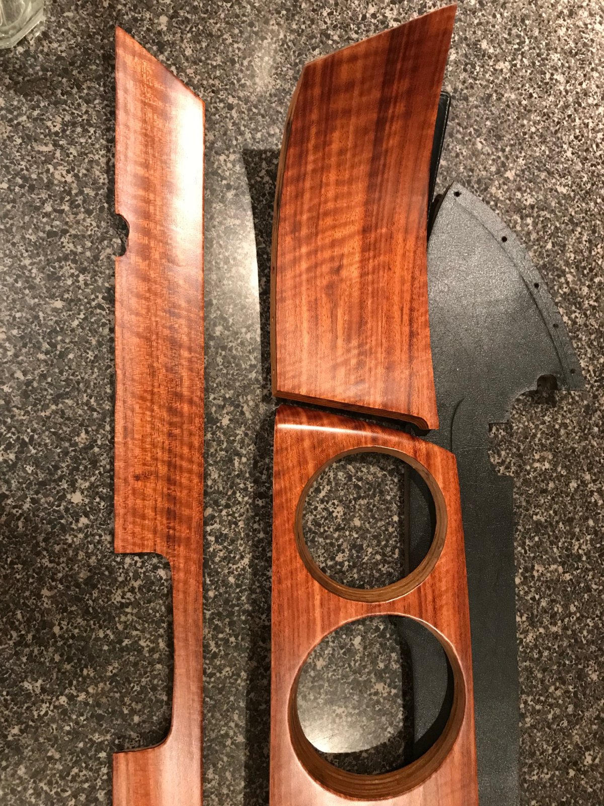

the finish was an automotive 2 part lacquer with a satin sheen. it was recommended to Gary by someone ... so i don't know the actual name. Gary did have a little trouble with air bubbles. the finish cost about 75 bucks a quart. Gary is working on getting his car home from the paint shop so i know he isn't spending too much time on the forum.
it is a lot of work to do this, Gary is an experienced woodworker and has built some custom furniture. it is not easy and i highly recommend sending to Bela if you don't have the proper tools. Gary has a vacuum bag that we put the door pieces in and the instrument cluster piece in ... but the vacuum will suck the veneer into the instrument holes and that can make it not turn out / ruin the veneer (we did a few experiments with spare pieces of veneer). we ended up making some plugs to fill the holes, then wet the veneer and shaped it in the bag ... then laid it up and put it back in the bag. the big curved pieces were laid up with a lot of clamps and backing pieces.
The finish is actually what would be the gloss of a 2 part automotive paint job.
This happens to be the satin version. The drawback with satin is that once you spray it on you can't touch it like you can the gloss. I mean if there is a spot or small bubble you can compound the gloss and get rid of small defects. If you do this with satin you will never get the finish to look even or satin.
The product is called Finish 1 and is sold by Sherwin Williams automotive.
It's 2 part. 1 Quart was $75.
It sands easily and can be used as a filler to fill the grain in the wood.
It takes about 3-4 coats to get the grain filled.
Original walnut in the coupes was filled grain. Smooth with no little holes or pits.
This finish will hopefully avoid the cracking and crazing that we all see on the original walnut in our 40 year old cars. That finish was lacquer.
That is the primary reason I chose to use this finish. It will also handle heat and cold better as it can expand and contract without cracking.
