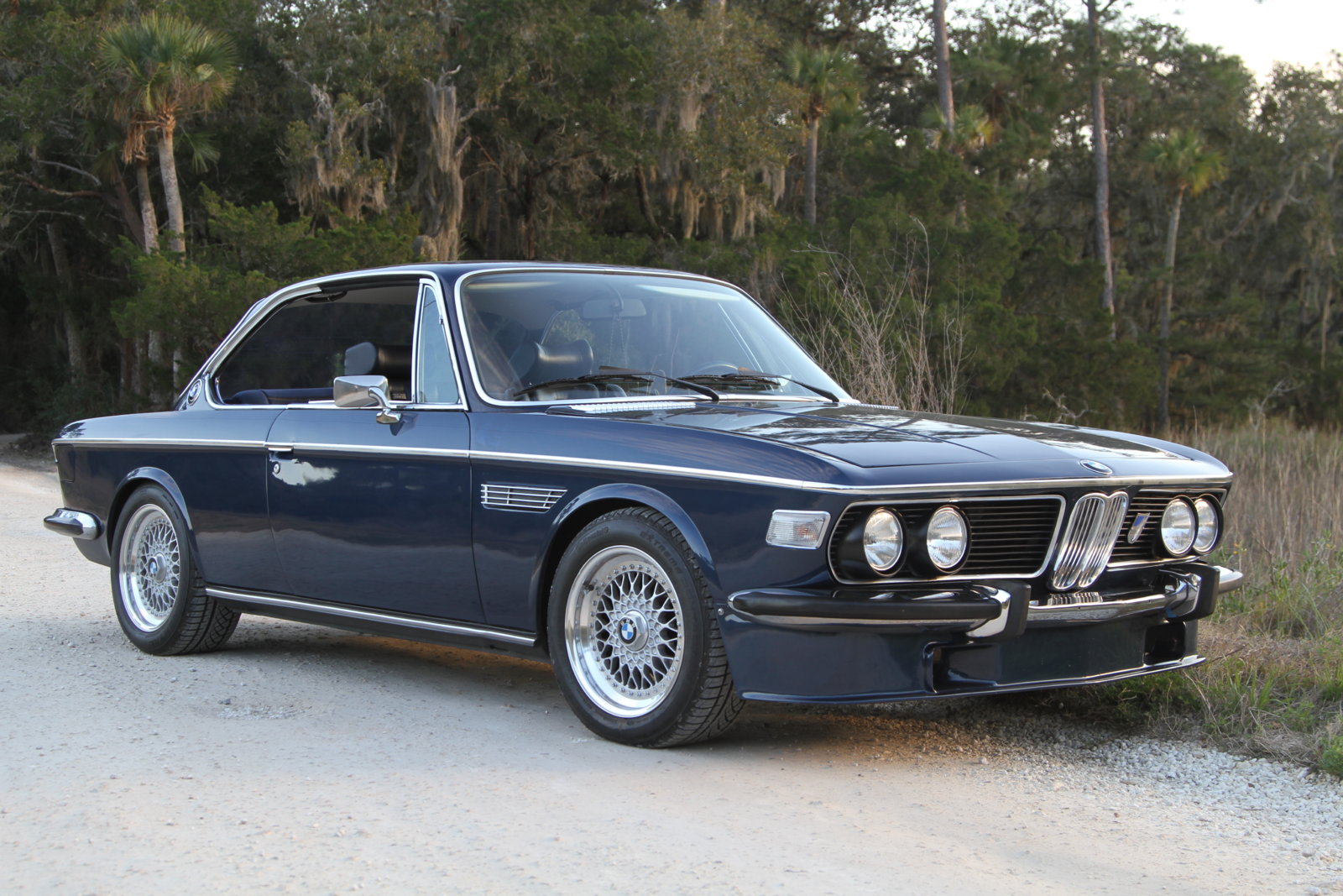

Working on book about rebuild.
m5bb
2,086
920
Peachtree Corners, GA

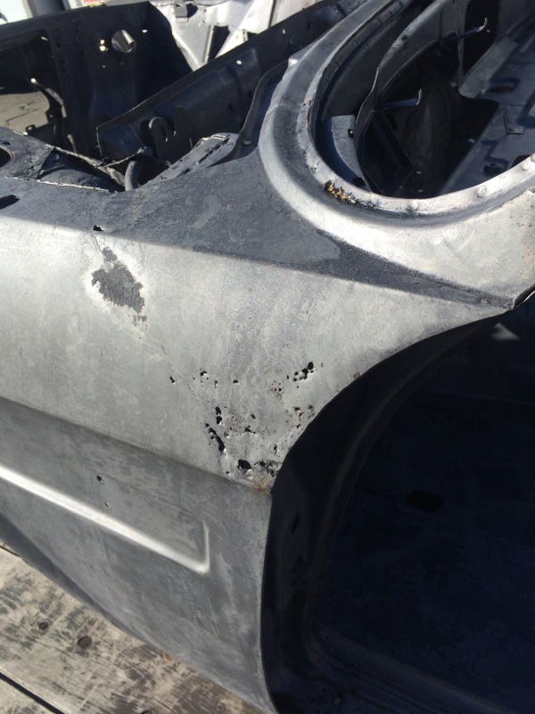

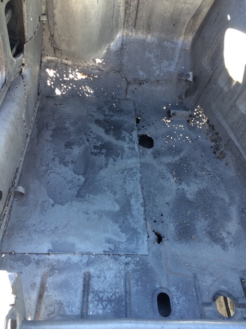

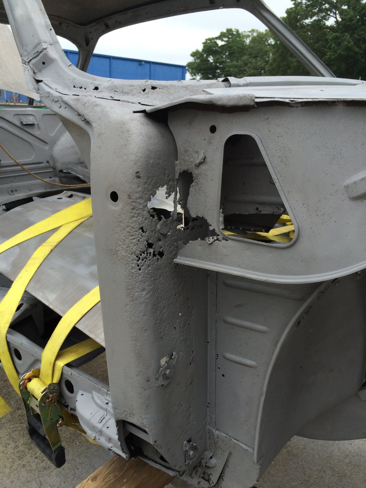

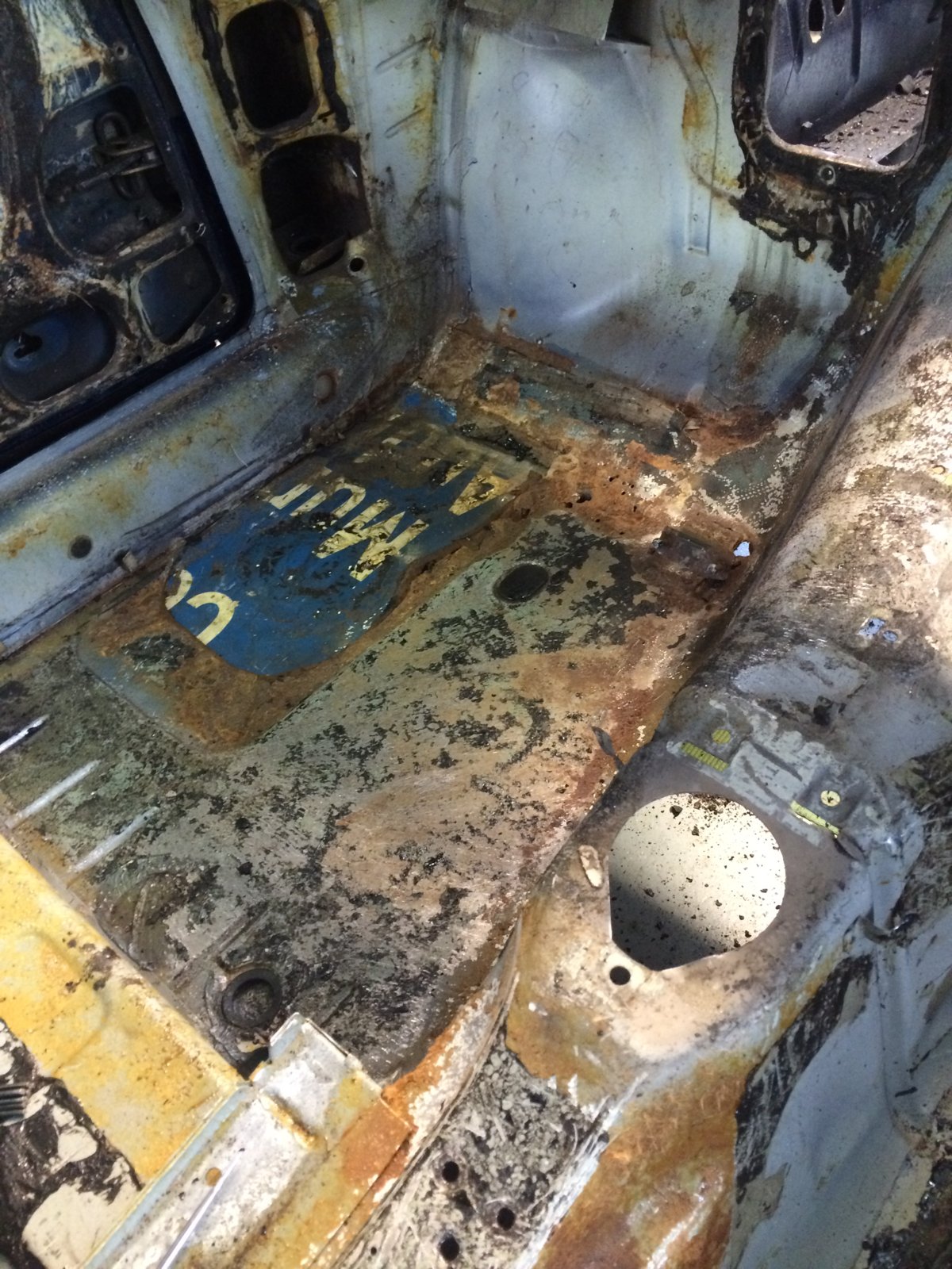

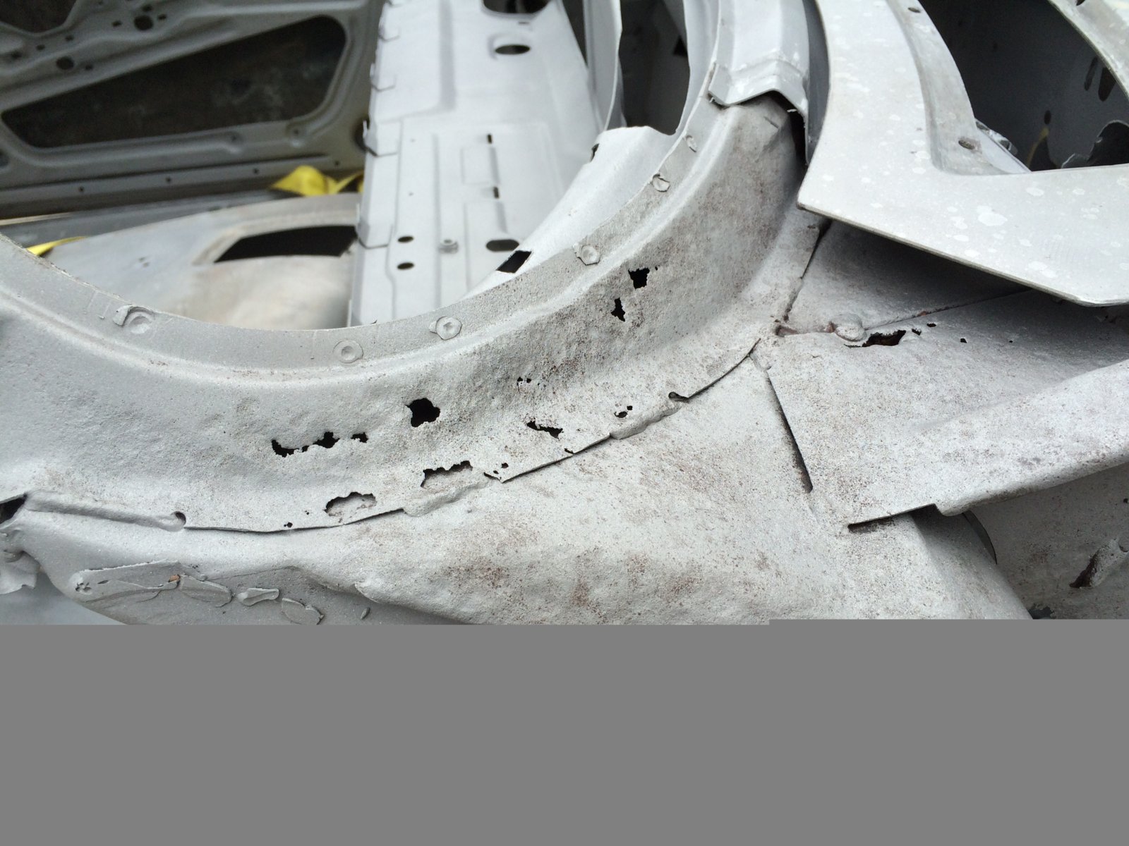

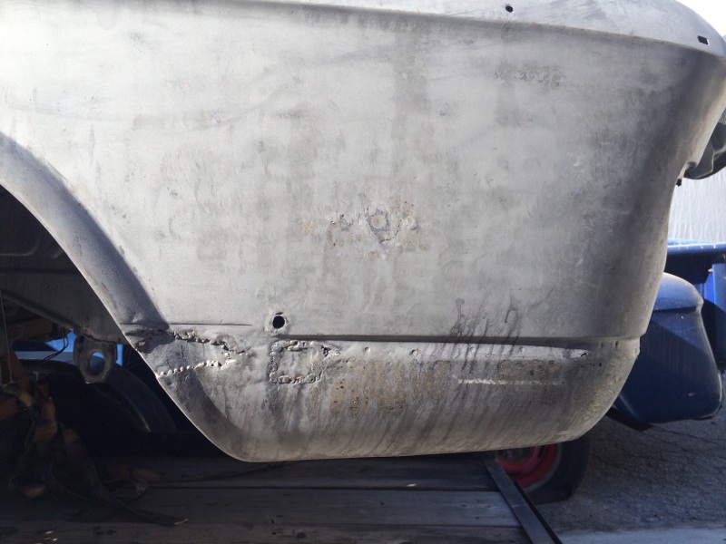

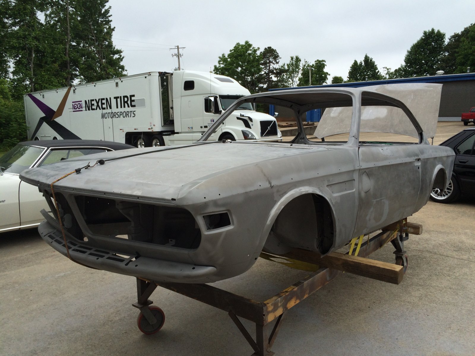

I'm slowly going through the thousands of photos I took for my rebuild.
I took the car completely apart and put it together myself.
See the road sign patch in the floor.
Body after soda blasting.
Fender removed.
Found these from 5/16
Wow, am I glad I made it!!!!

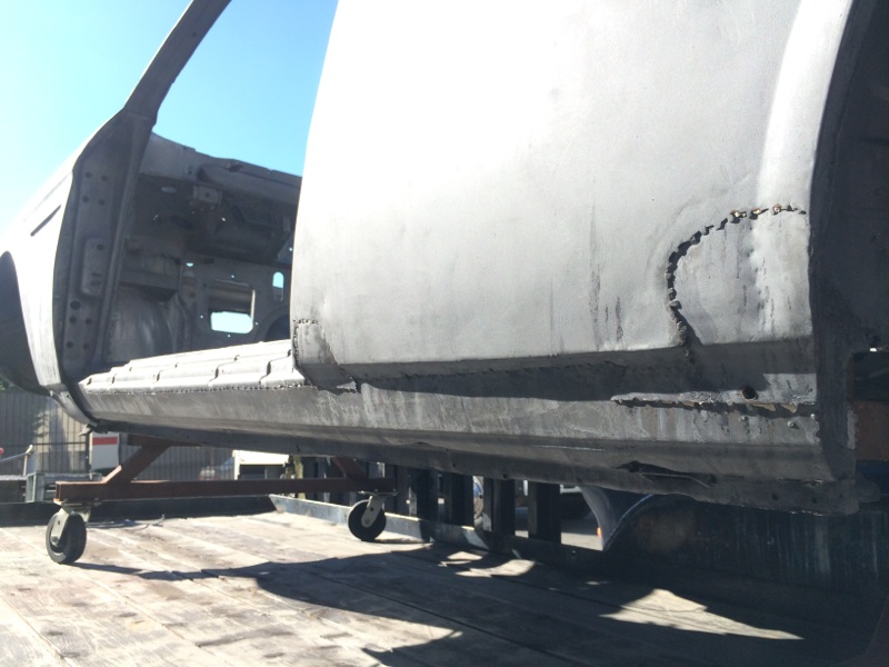

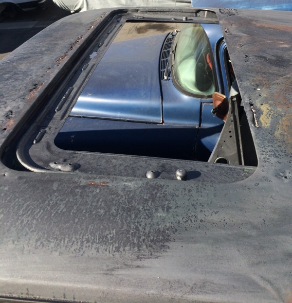

We both have been down this tough path. Once the coupe takes it's acid bath, then the truth is revealed - well, at least until the fenders come off. A few guys in SoCal have watch the progression of this project over a number of years and it's close to being painted and hopefully ready to show and drive early next year. Paul Cain had a great comment when viewing it at this stage. He mentioned you get to see all the sins of the past all at once, all the lousy, makeshift, patchwork metal repairs that were done through the 80's and 90's. And you get to go through all the pain of fixing them all in one swipe. It's really the only true way to make a coupe rust free. I think the most surprising aspect to me was how weak the roof metal was around the sunroof, seems the water never cleared out of there very well at all - but there could be other reasons.

Wow, I think yours was worse than mine. I haven't posted the rocker photos yet though? Some of the disappointing details that show up is just how bad a job Karman Ghia did building these bodies. Can't believe the quality control guys at BMW accepted them for assembly.
