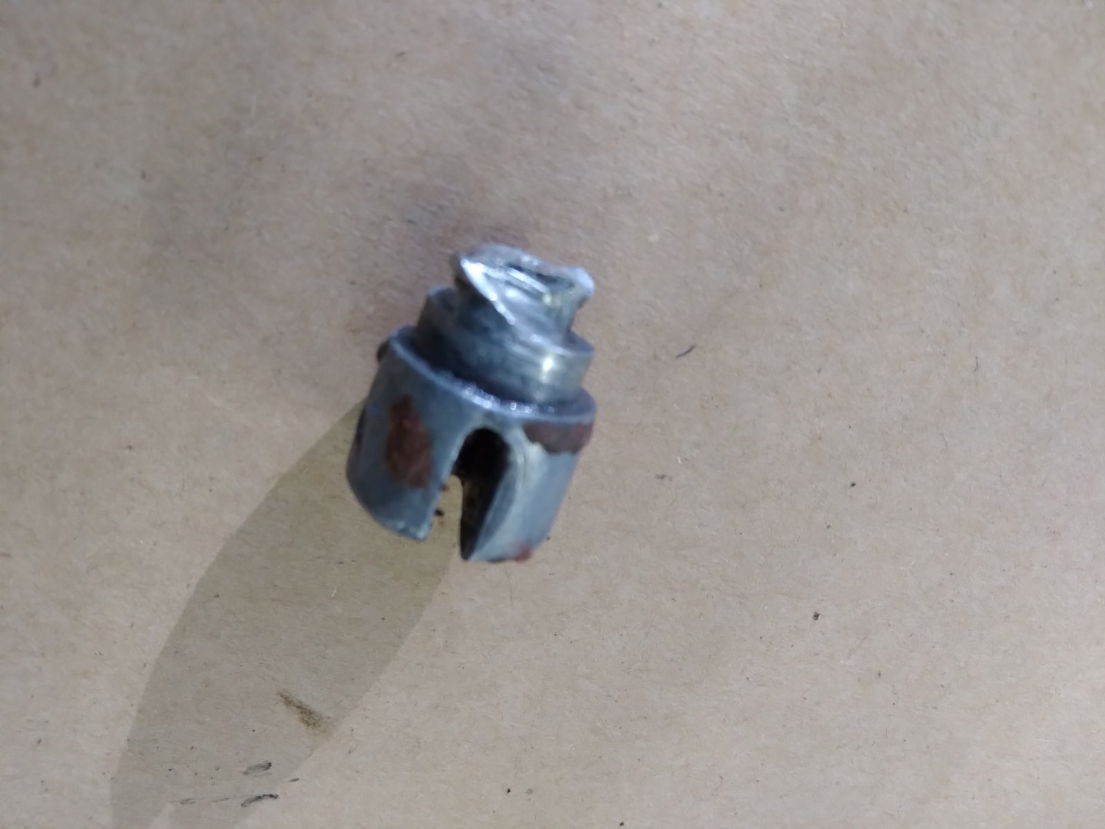

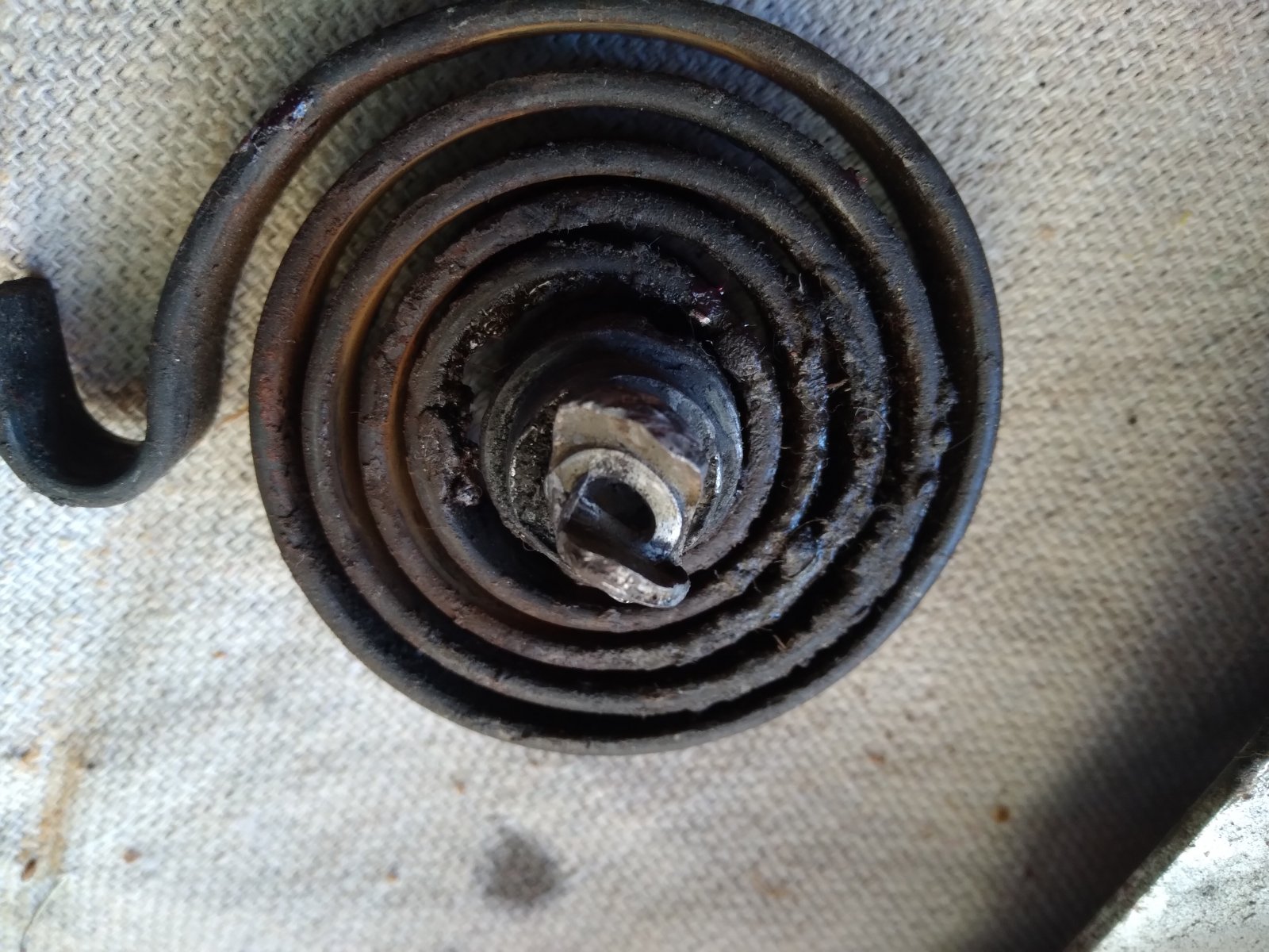

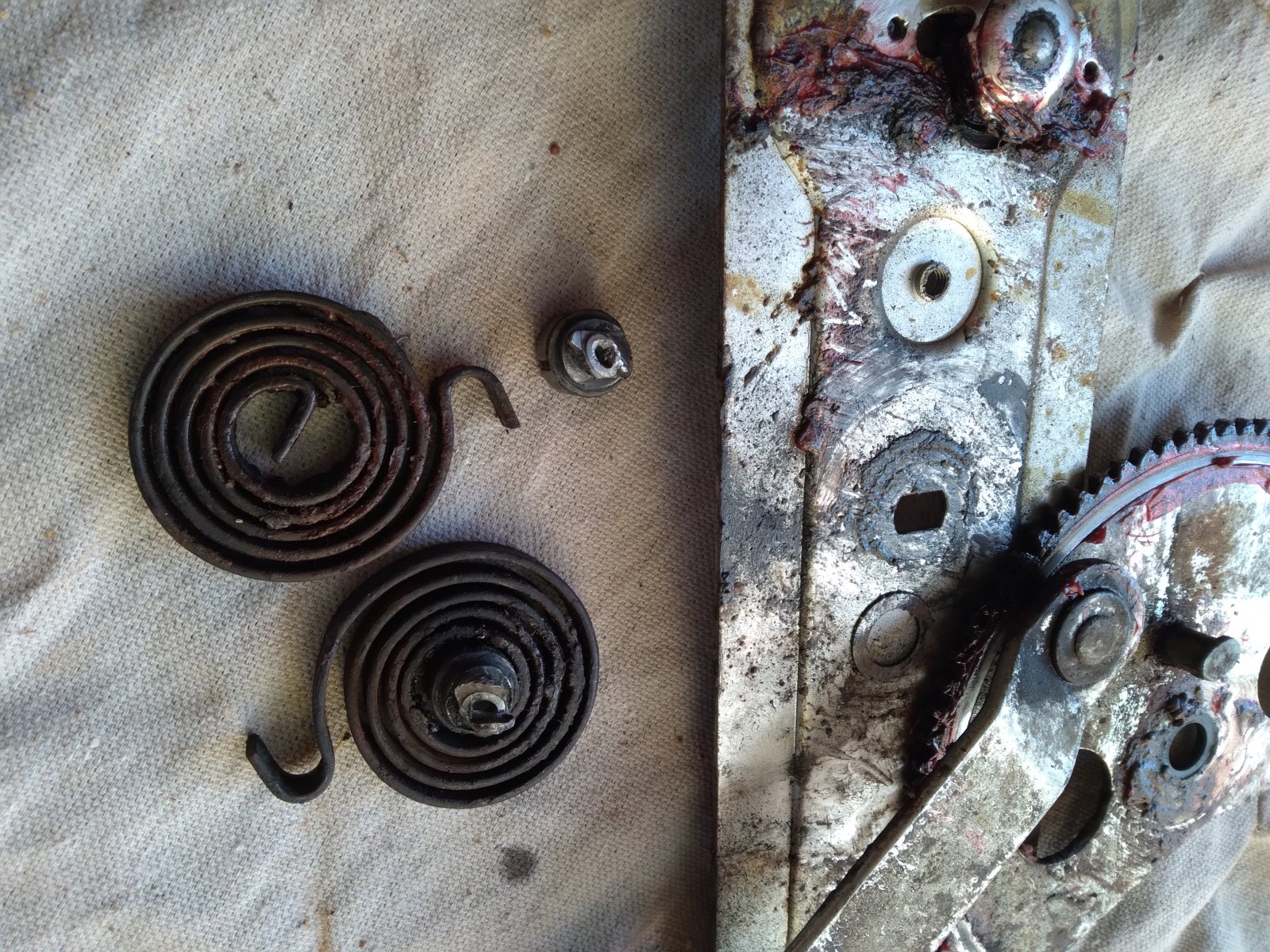

The silly pot metal spring holder sheered from baseplate, the same way my passenger side reg did last year. Argh.....

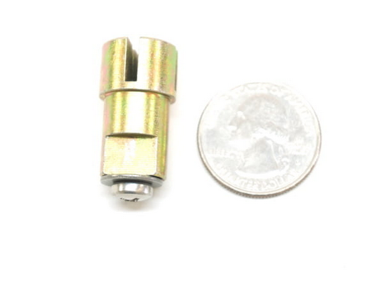

Sure, the original pot metal spring post sheers out of the base plate. These replacements bolt into the original location where the original was 'swedged' in.

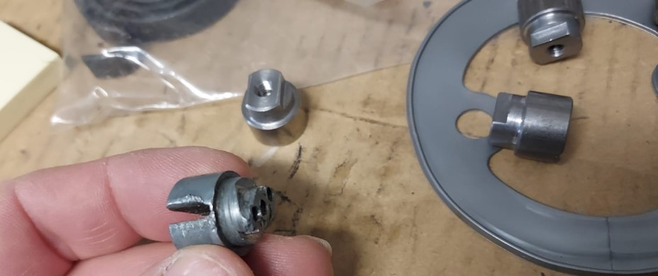

I have made that part also for the right door. It is still working. I was able to find a new regulator for the left door many years ago and it is still working too.
Pelican part arrived yesterday (wow, fast!) and installed after a lil fiddling. Took much longer to reinstall reg back in the door. Only one configuration that will let reg install.
It was a very Zen, kung fu, jedi process....tried my patince well but then ultimately was victorious! Sheesh!
