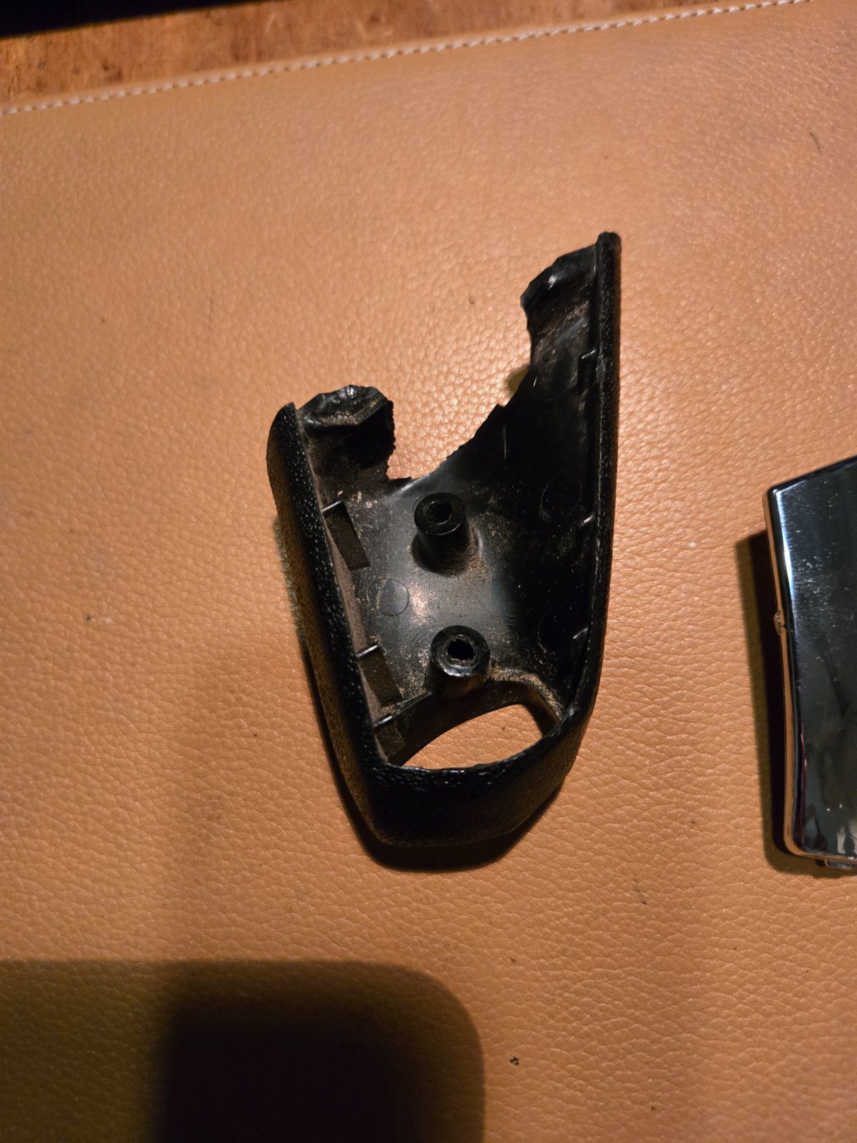

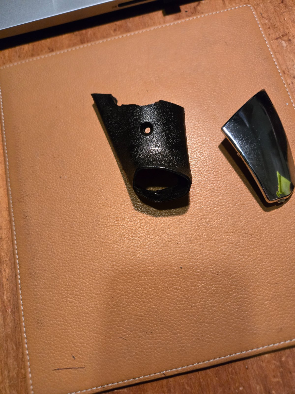

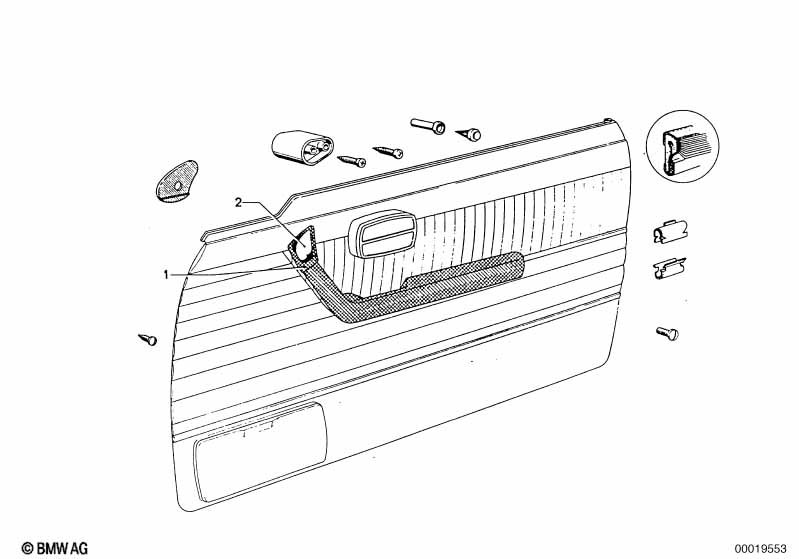

So my sister - who I used to love - yanks the door closed and breaks off half of the upper part of the passenger arm rest. Looking for a replacement. In black preferably (but I’m willing to consider dyeing the right part in a different color). Part number is 51 41 1 815 236. (#1 in OEM schematic below)
Please help save the family!

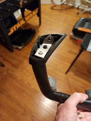

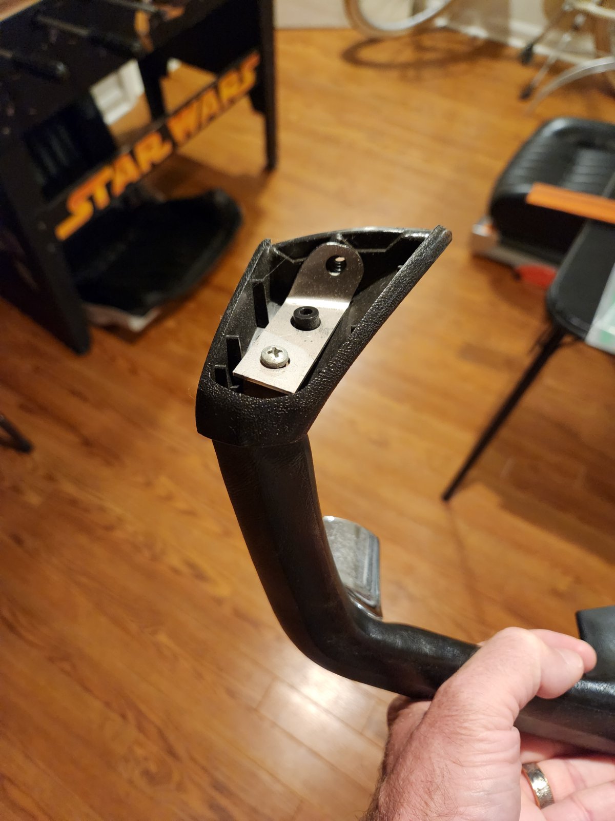

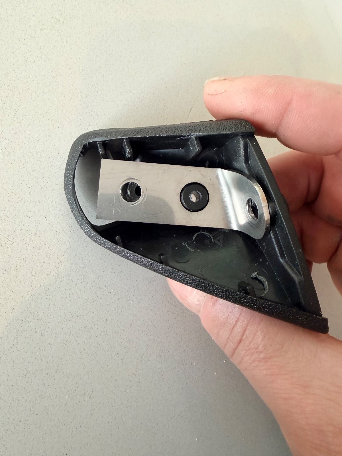

That plastic interface is problematic. Everyone should buy the metal angle bracket that Walloth CoupeKing sells to add more strength in that little plastic piece.

I think Walloth don't sell them, just Coupeking.
Or fab your own if you have a vice and a drill: it's one fold, three holes.
15 minutes, piece of thin cardboard, a hammer, steel plate (anything you feel is solid will work) and a drill.
Nothing beats creation - Well worth a beer if you manage it.
- Take a piece of cardboard. Roughly cut it to about the max shape that fits in the opening. Place it in and push the fold in by hand, so that it touches the bottom mounting boss. Mark the fold line on the cardboard.
- To mark the hole locations, use one of the following ways: measure them out (the engineer's way) or smear some toothpaste/oil/something sticky on the boss and screwhead and lightly press the carboard on top.
- cut/drill/stamp the 2 holes where the toothpaste marked the paper for the bottom screw+boss.
- When you have made the 2 holes, then you can position the cardboard down and over the locating boss. Now you can accurately mark the vertical hole: remove and drill/punch the hole. Trial fit the cardboard template.
- If you're happy, then copy the flat cardboard shape onto a steel plate, still keeping it as oversized as possible. Copy the foldline. grind/cut the metal plate.
- Fold, and drill the 2 holes.
- mount, and check if the marked vertical hole about lines up. If so, drill and reinstall for check.
if the holes are just a tad off, you can drill them oversize and use a (bigger) ring under the screwhead.
When satisfied general fit, trim the edges to whatever shape you desire, but remember: the more steel you leave around the fold and between both screw points, the stronger it is.

Yes, you guys are right. Now that you remind me I bought them at CK along with Paul's parking brake lever mod kit and different mount reinforcement bracket.

Ditto Rob! The CoupeKing parts solve 2 common problems. They are both sister-proof....And don't let anyone pull down your sunvisors...

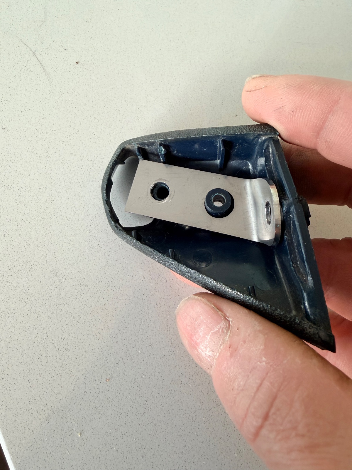

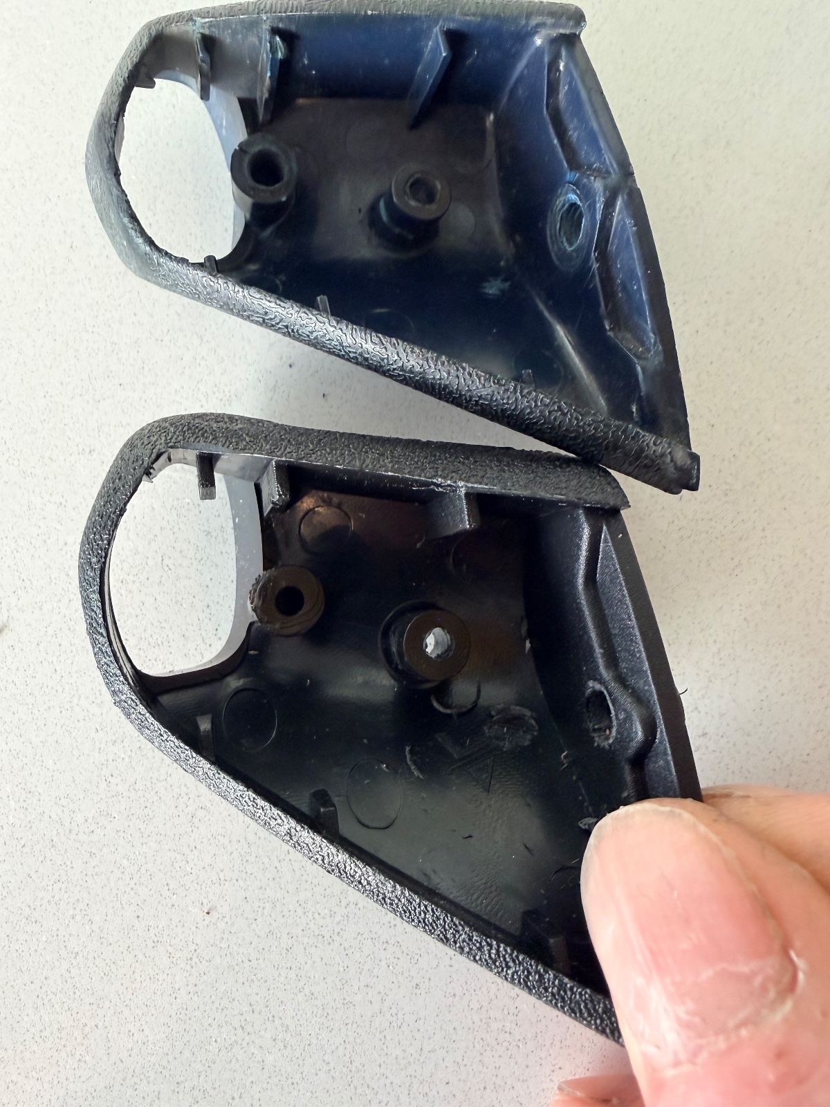

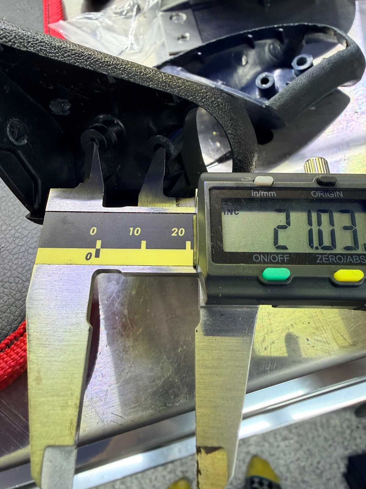

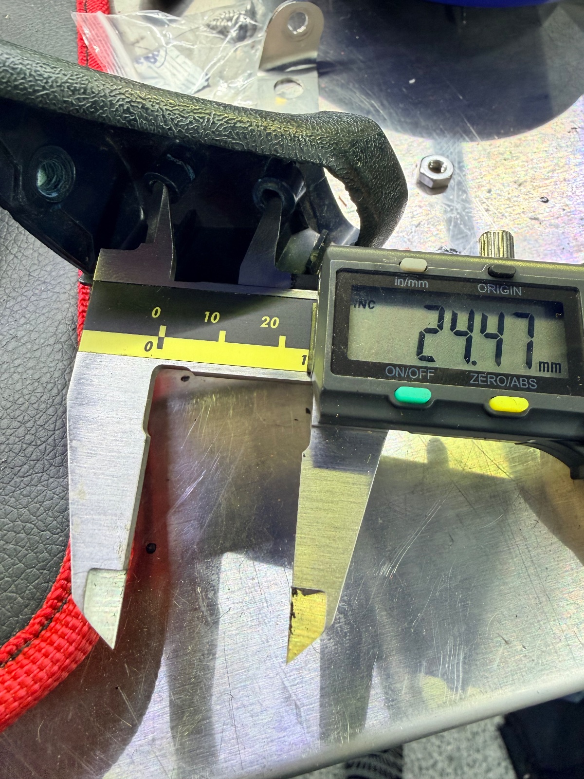

I agree with Koopman that although this additional metal part is an awesome add, it shouldn’t be as expensive as it is. That being said, also want to bring attention to a difference in the original parts and any newer plastic armrest part from W&N. One of mine broke (passenger of course) and I had ordered a replacement from W&N, but they weren’t sure they had it in stock. In the meantime found one from another member here. So I had both parts and installed the original spec one I had purchased from forum member. I had the door panels off today and thought I’d see how the new W&N part fit. Turns out that the hole locations are different between the two meaning the CoupeKing metal bracket won’t fit without redrilling holes. So, in the future, if you’re adding the metal bracket either make sure you have an original spec plastic armrest piece or be prepared to modify that metal bracket. In the pictures below the original is the one with the wider-spaced holes.
