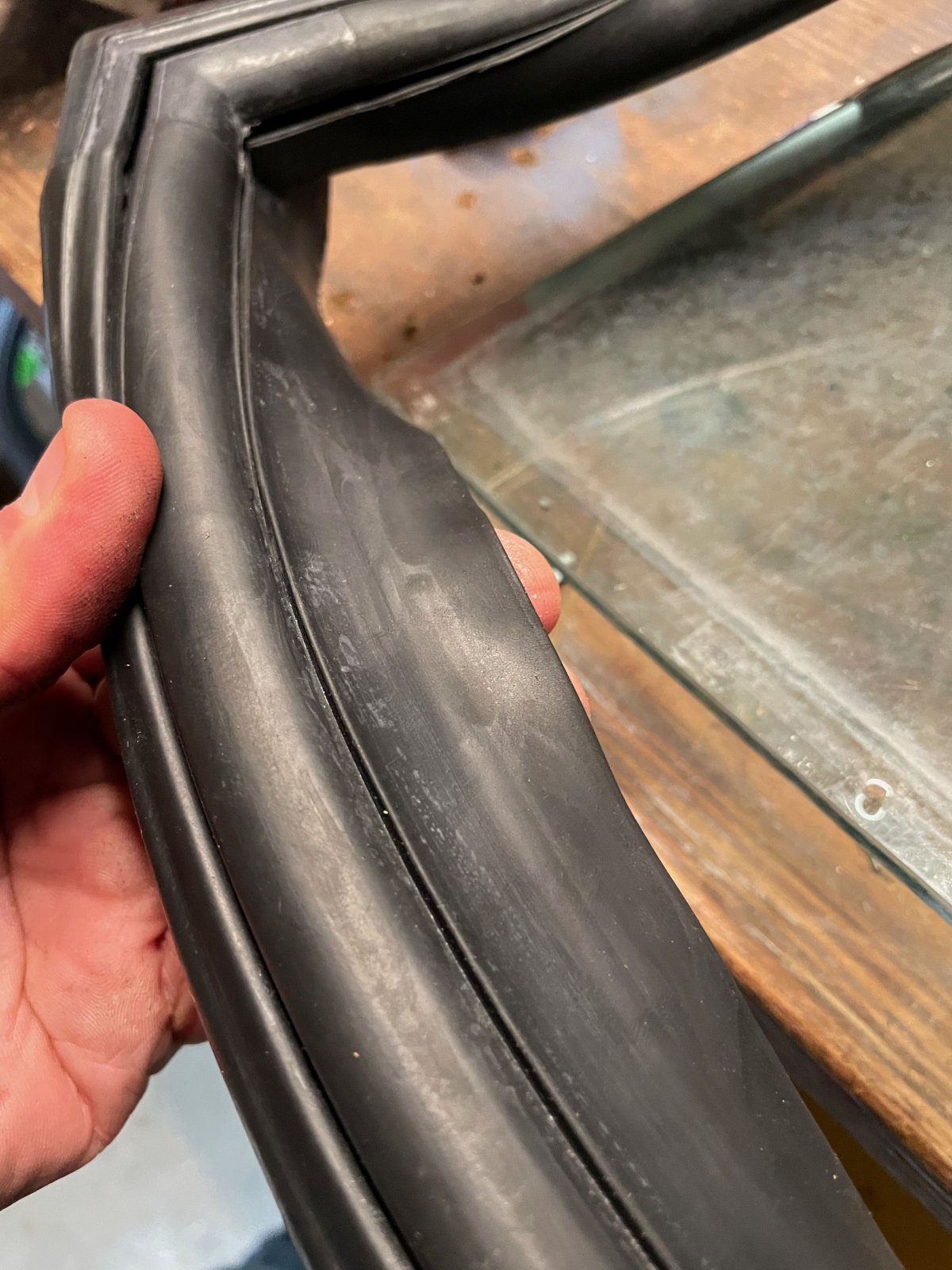

I made my rear windshield gasket out of the front windshield gasket. It took some doing, but it went in fine. It’s exactly the same profile just bigger and the corners are rounded on the front as opposed to squared in the back. 3M instant sealer works great and no way you can pull it apart.
I would say that getting a 90° corner at the bottom of the rear gasket was the most difficult part. A bit time to consuming as well. But there is no alternative, and mine was trashed.

I am an extra front, where and how did you cut it? I just tried to put the gasket on the widow, It seems like top to bottom (the short sides of the rectangle ) it fits, the long sides of the rectangle are too long, cut in the middle and pull together then contact cement?

This was NOT easy! Took me many hours with lots of little cut and splices. What you don't want to do is cut it too short. The 495 3m instant cement can stick two pieces together almost without detection if the pieces are cut squarely.
The top is relatively straight forward. I fitted the top corners and worked from there.
It is making the bottom corners that will be the challenge. You have to create 90 degree bends from curved pieces. Having the old rear gasquet helps define what you need to accomplish. also you can experiment with it.
.I would insure you have the corners to your satisfaction before cutting the centers to fit.

But it can be done. I wasn’t terribly concerned about leaking because not likely to see much rain. Also enough windshield adhesive should do the trick.
