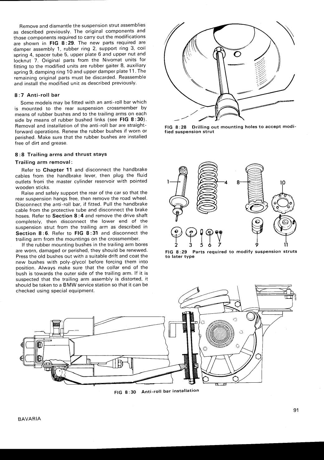

Not all models were equipped with rear anti-roll bars. See language from page below. I recall seeing at least one rear axle carrier that did not have any pre-welded brackets that would support sway bar bushings and, of course, a bar. Is your vehicle so equipped?
Another consideration. Do you really need a bar? For reasons beyond the scope of this post (e.g., traction, over and under steer), the front suspension usually benefited from a thicker bar and the rear, a narrower bar. Sway bars work as a combination with tire width/adhesion/pressure and springs and shocks and vehicle weight distribution. They also add weight.
