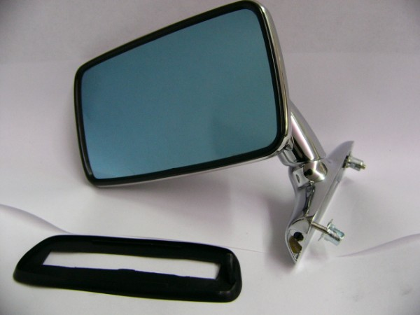

Does anyone have or know where I can find the black plastic exterior mirror surround?
Thanks In advance.
Thanks Don. I can use a couple of those, however i really need the hard plastic trim that goes around the complete mirror glass.

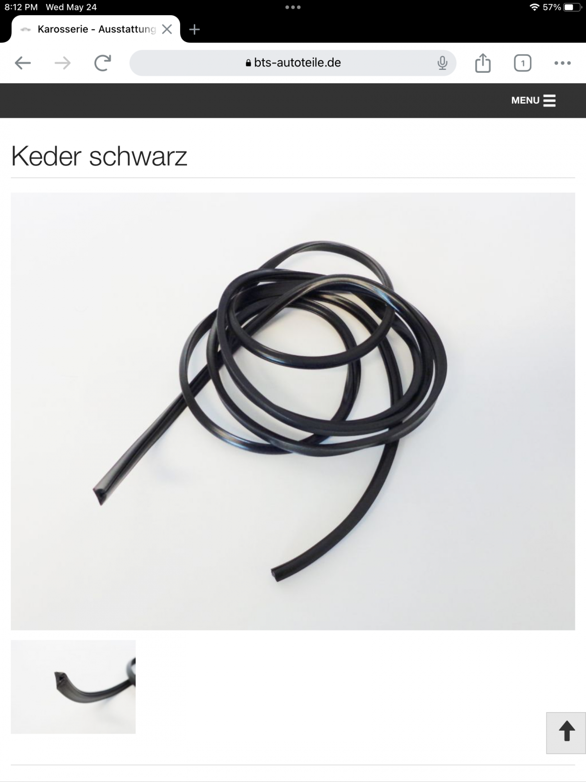

Here ya go…

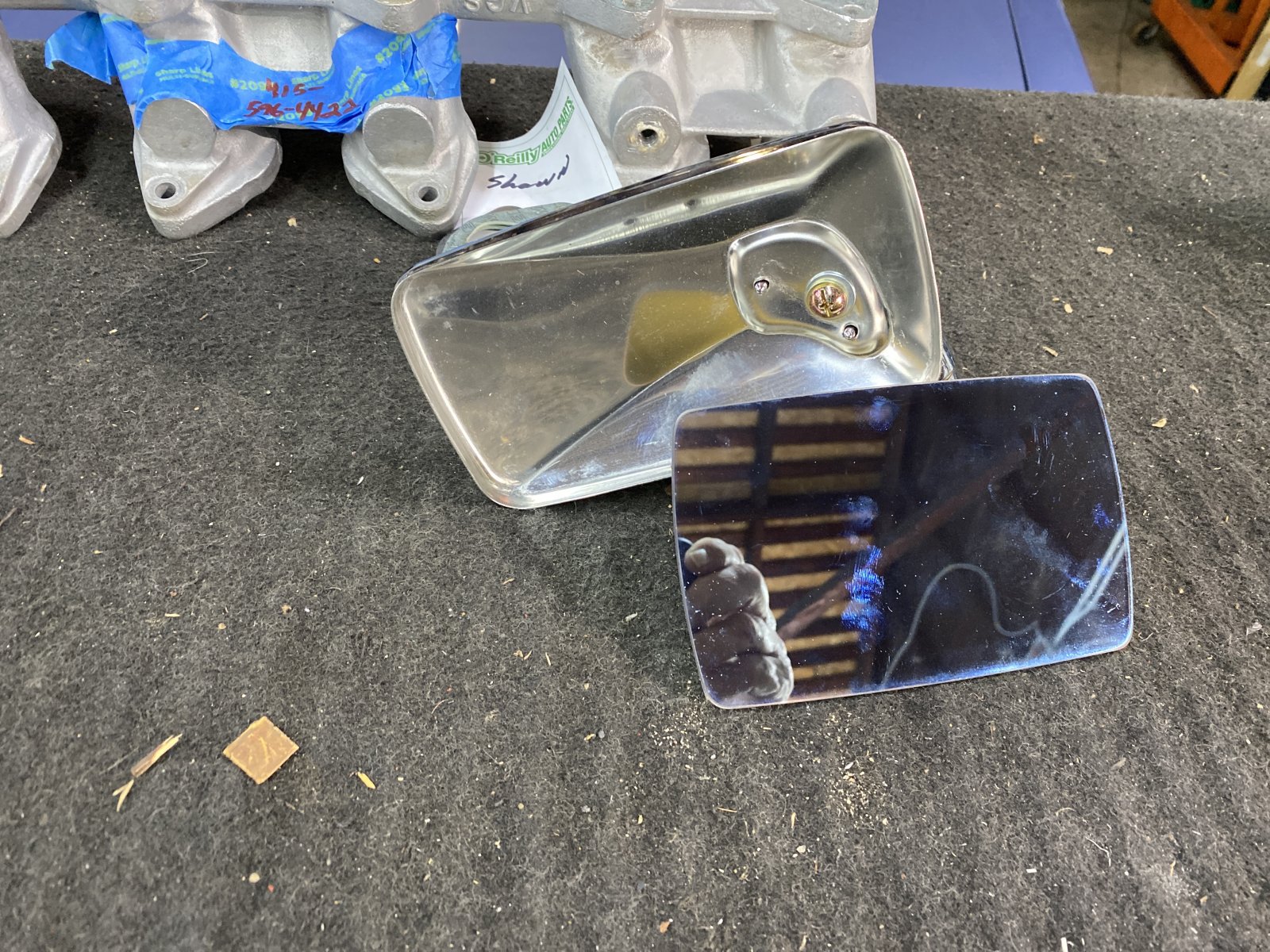

I've done a trap mirror, but didn't think you could replace a flag...there's not a spring inside to allow the glass to push in and spring back against the seal?...or is there a way.?
I took the old trim out a small piece at a time. Very brittle so pieces were easy to break.
Once I had the top and one side removed the mirror came out easy.
Once you have the new trim back on the mirror the glass with the trim fits right in.
Of course i had a new glass installed at a local Glass Co. The cost of the new mirror glass was $37.50.
Don, Have you ever replaced these?
Actually no- I have the spare glass and the blank mirror but I have new 7 mirrors on the shelf so.... maybe later.
Critical to match replacement glass and mirror body. There appears to be 2 sizes of flag mirrors.

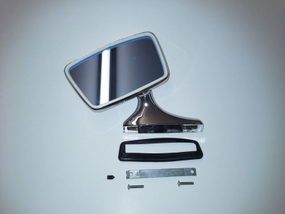

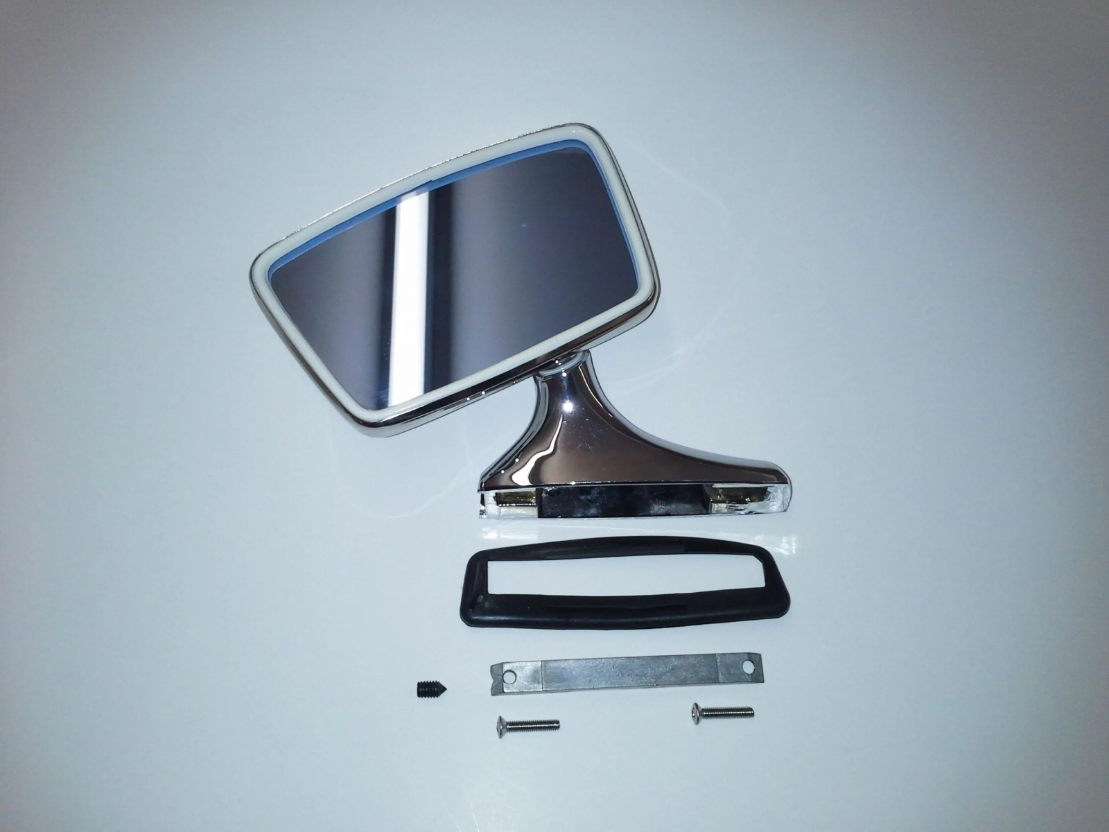

Hi,
I have seen two of these being used:
Trapezoidal shape
Rounded-corners rectangular
