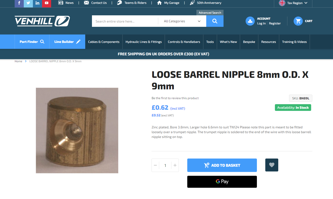

You can get the spec and have one made close to you. I have ordered one and it was a fraction of the price people are charging.
For reference this particular part is steel rope 2mm gauge, with a standard sized barrel nipple on one end. I guessed the length at 3 m as I couldn't be bothered to measure it.
Don't get excited but here is an image of my nipple.

I am sure that a 6er cable is easily made once the spec is known. I feel sure that BMW don't make their own Bowden cables.
