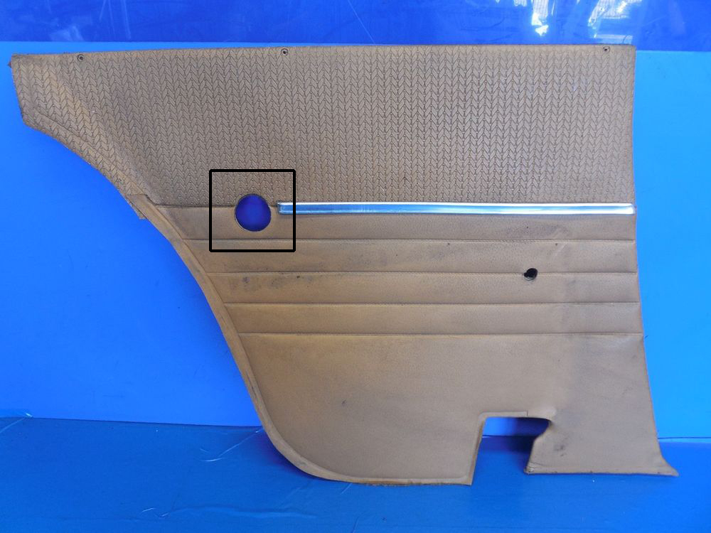

It's the cover for the hole that's marked. My car didn't come with it because it was reupholstered without including the interior trim. I see they still sell black covers, but not red ones. I guess it would be easy enough to paint, but I'm not crazy about paint on vinyl. Doesn't this always seem to peel?

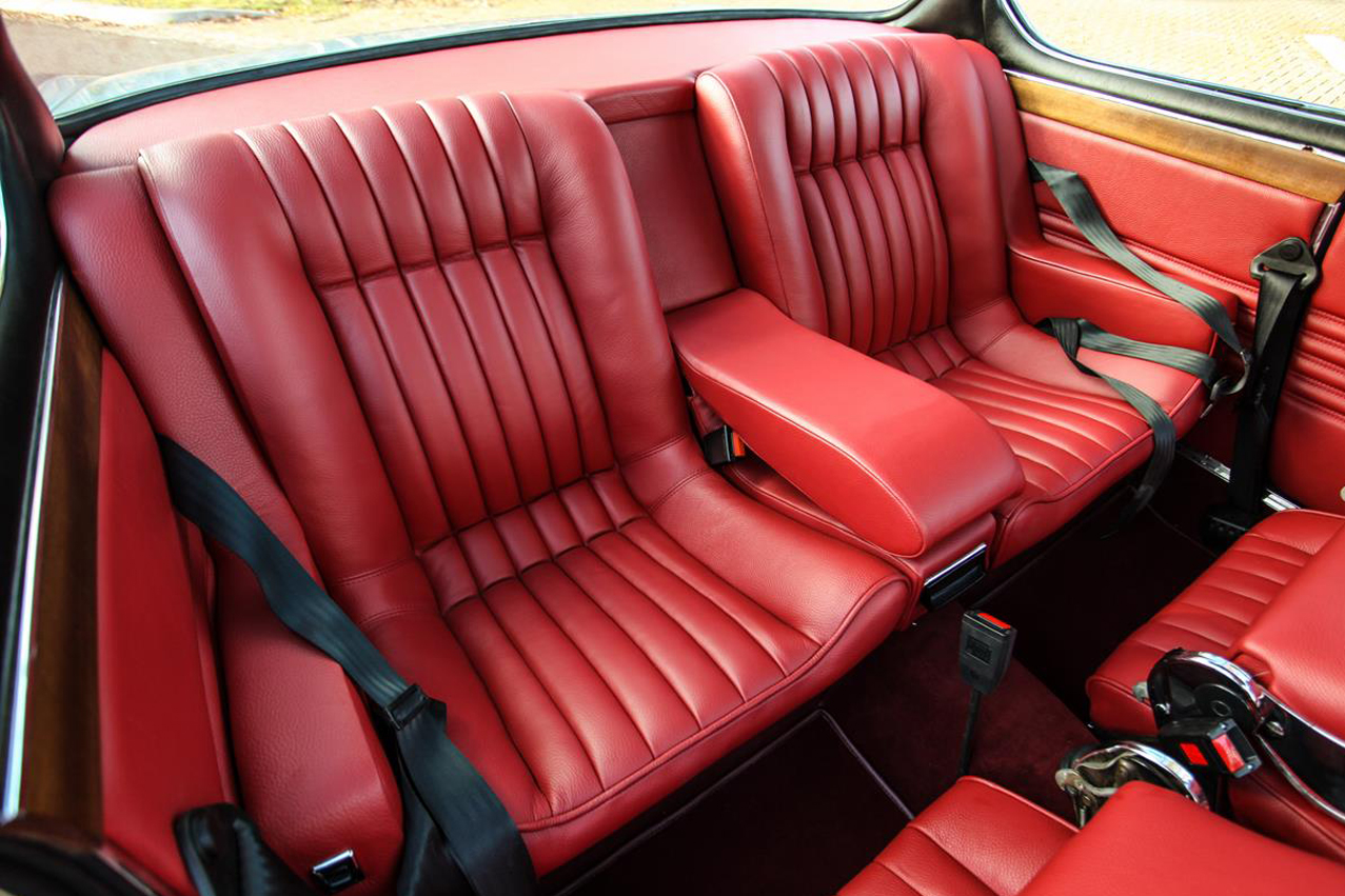

first - VERY pretty interior.
paints such as SEM color coat are formulated to stick to vinyl. and they stick quite well. we use the storm gray to paint our floor boards / elephant skin in the trunk. i use the satin black for my interior. its all about the prep ... there is a surface treatment for cleaning vinyl and a different treatment for leather or plastic. i can tell you that there is a significant difference between doing the prep and NOT doing it. i haven't had any issues with peeling.
ok good to know. i see theres a flex primer and then the paint itself. anything else required for prep? as for the the trunk, I'd like to get around to that. any particular reason you decided to paint rather than order the vinyl material thats still available from BMW?
the thing you need to realize is that color coat is a flexible coating. here is some information from SEM's website
https://www.semproducts.com/product/color-coattm-aerosols

the second part of your question - why not replace the elephant skin in the trunk? first, is that the new product does not match the original that well. to do the entire trunk you will need at least 3m of elephant skin. and then you either have to remove a gazillion staples and re staple all of the elephant skin on the trunk floor boards ... then you get to the rear trunk panel, the pieces that are adhered to the inside of the fenders ... then the 2 panels on either side of the tool box on the trunk lid. in my opinion, if your panels are not ripped or have damage to them, i would clean them and maybe repaint them.
thanks for the tips. the trunk has one square missing from one of the wheel wells. not sure why someone would cut a 2x2" patch. the piece that sits behind the tail light is all rotted, so I would have to make a new one of those. and lastly the wood panels are a touch warped. perhaps mixing and matching may be my best path preserving the original material where I can.
the rear tail light panel is terrible material. i built one and covered it with new elephant skin. i can send you a full scale PDF of the panel that you can cut out of waterproof automotive panel board and put together from 2 pieces ... then you could wrap it with your elephant skin. i can email you the pdf with a few instructions on how to put it together
all of my panels had been covered in regular vinyl by the PO, so i covered all of them ... if you do that, you want to invest in an upholsterer's air stapler. one thing you will find about mixing the wood panels is that the screwholes aren't necessarily in the same place from car to car.

Your interior is beautiful! Almost makes me regret I didn't go with red leather for my car, it's stunning when done right, as yours looks to be!
Hi will. If it was my car I would get a piece of the red vinyl and after spraying with glue ousing a heat gun stretch the vinyl tight over the cap.
It's a good idea, but I may just skip the cap. I'm already nervous about poking holes into the leather for the trim pieces.
