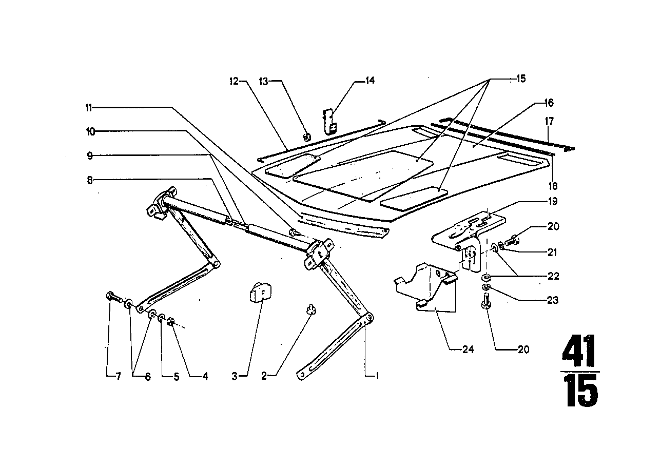

I'm looking for the parts that make up the hood prop support used on the CSL cars. Specifically the prop rod (support), the bracket that is riveted to the underside of the hood, the rubber grommet (holder), the stow hanger (bow). See RealOEM diagram below with part numbers. However the bracket that is riveted to the hood isn't given a part number.
I've been told the prop rods were all hand made, same with the bracket. The support is the same as the trans vent hose carrier E3/9. I have seen the prop rod listed at 33" long.
My hope is someone out there had a CSL correct template and has made these parts before and would be willing to sell me them?
Some relevant links for anyone interested:
Support: 51231819625
Holder: 51231819628
Bow: 24111203865

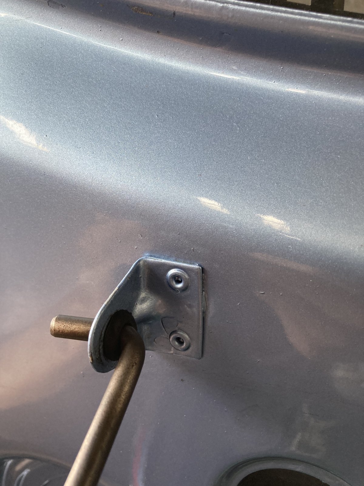

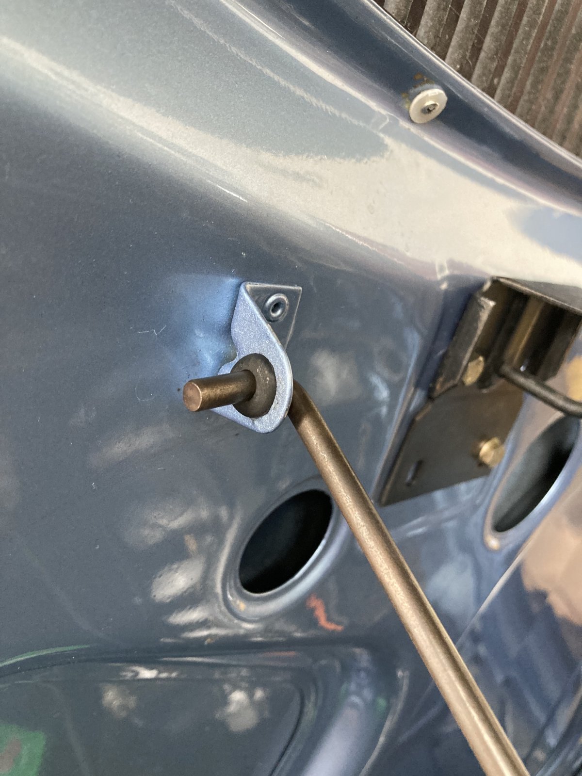

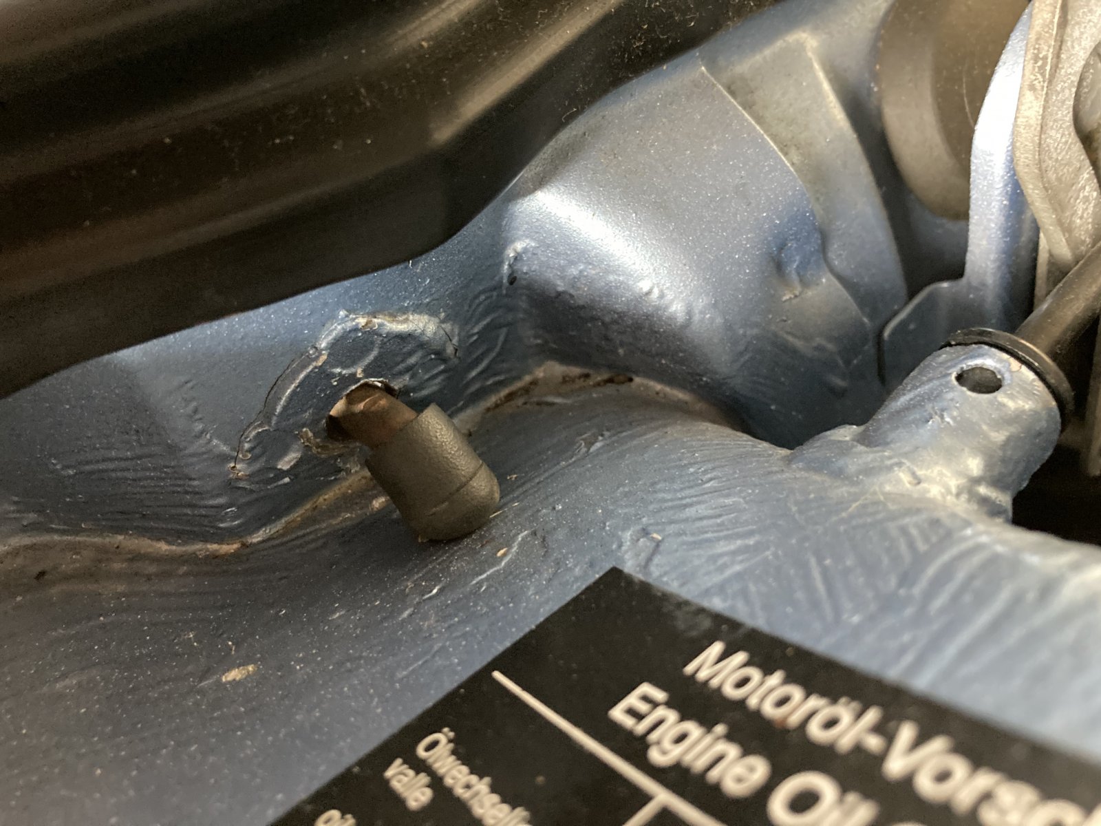

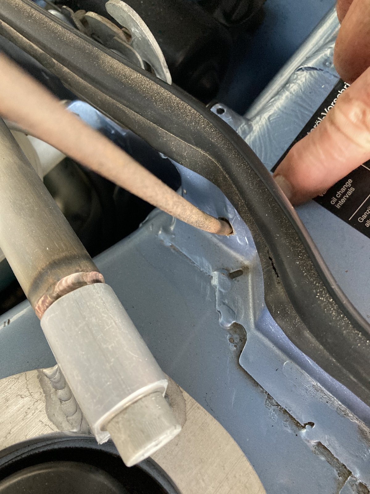

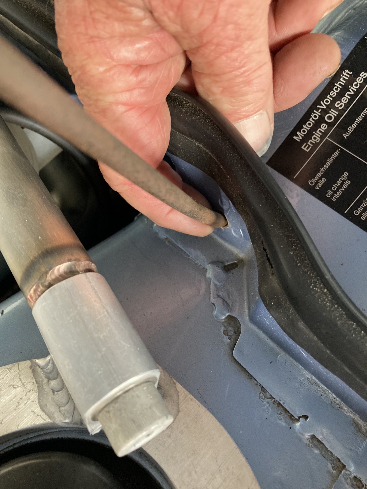

I dug up some photos I took of hood prop rod on Carl Nelson's CSL car in his showroom. Not sure is the holder (rubber grommet) and the bow (trans vent hose carrier E3/9).
I'll just fabricate these parts for myself, but figured I'd ask here in case someone has made some in the past?

Looks easy enough to fabricate the rod out of some 3/8s to 1/2 inch aluminum rod & make a hood bracket out of some 1/8 aluminum from an old road sign. would likely be better than the 'factory' steel one.
